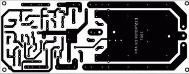

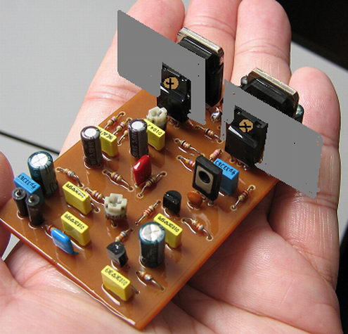

K here it is, cleaned up and with fatter pads..
Orientation is right for photoetching, think you have to flip it for toner transfer...
Print at 300dpi, you dont have to extract the file just open in in winzip or winrar, select it by clicking with right mouse button, and click print file. It came out fine when I tested this procedure now...

Dx amplifier was made thinking about you.
As old computer heatsinks are easy to find...also computer small fan blowers...they are cheap.
Beeing very small, you can install 6 units inside to produce a nice home teather.... or amplifiers using input filters working as crossover....one for bass, other for treble and other for mids.
Also small enougth to be included inside automobile amplifiers that already have switching power supplies.
Small to be included inside a speaker enclosure, to produce an ative speaker.
Very small boxes can be made...Dxyingclone can be produced.

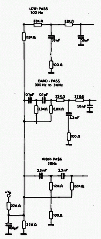

One simple input circuit, something alike this one...adjusted to work
fine to your personal needs...will provide you the multi frequency amplification.
100 Watts can be produced using 35 volts symetrical supply...and even more including more output transistors (with emitter resistors) and bigger voltage supplies.... this may produce two nice bass units.
Other four amplifiers, working over 8 ohms, a very standard Dx units will provide you more 200 watts of nice sonics amplifier.
Minimum power of 600 watts can be constructed, Ximple and Xcheap!

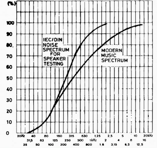

Audio spectrum..of modern music says that...
Power proportion of music is around
50 percent for woofer
35 percent for mids
15 percent for highs.
Beeing this way...Dx amplifier in a multi frequency system, will fit fine.
Also audio quality is extremelly better when using dedicated amplifier into a reduced bandwidth...less distortion and higher quality of reproduction...also amplifiers can be tweaked to turn optimum their reproduction into some pre decided range of frequencies.
Separating speakers, you will be inside the orchestra...a real surrounding system....instruments will came from different directions.
The speaker price will be lower, as you may choice lower power units...matched with the bandwidth needed.
Small speakers, used to Mids and treble can he hidden..to avoid problems with your wife...beeing low powered (because of power proportion you have inside modern music) you will be able to use very thin wires to run your system...do not worry with capacitances.... Dx amplifier is stable with 2.2 uf conected into it's output...so...some picofarads will not turn it unstable or will make it reproduce mufled sonics.
The use of small heatsinks...computer chips heatsinks, will provide you noiseless fan blower work..also fan can work with reduced voltage...for example....8 Volts DC.

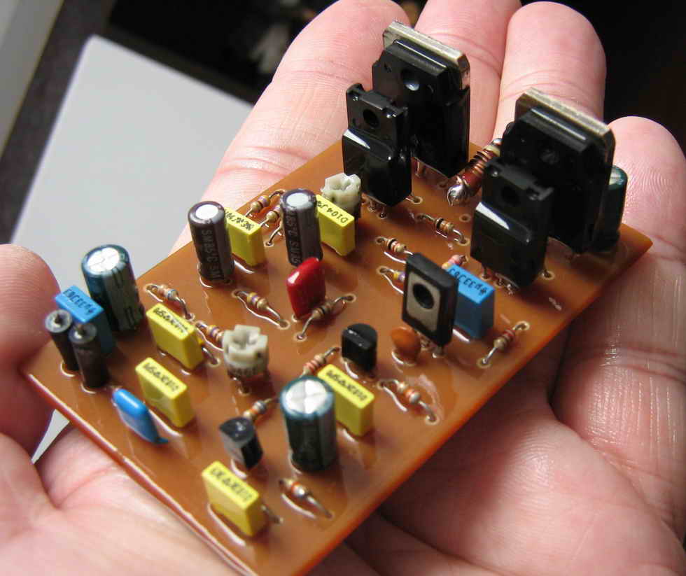

I'm playing around with a vbe-multiplier now, mounted on main heatsink.
Trying to bias much higher now - before i biased at 30-40 mA , now i'm trying ~80 mA.
It doesn't seem to stabilize.
Also i noticed when driver-temperature goes up, bias goes up.
The thermal compensation is probably not tracking fast enough (it takes a lot of time for the main heatsink to heat up when bias goes up, so the thermal compensation is reacting too slow).
Only solutions i can think of now is mount thermal compensation to driver(s), or mount drivers to main heatsink.
Any thoughts ?

Now you see why i runned out from those things.
To make it simple and less problematic.
Related all those things... my first preference is to give to the output transistors, heatsink more than enougth...and to help with a fan blower to double guaranteed to drive the amplifier hard.
My second decision is those diodes, because they have more junction to reduce bias under thermical action.
Third is to intall the VBE multiplier into the heatsink..the good place for it as you know Klaas.
The fourth idea, may work fine...BUT...will be awfull that transistor over the other (maybe imoral..ahahaha!)
Maybe a negative coeficient resistance may help, if placed in the VBE base.
You choice the better option to you.
regards,
Carlos
regards,
Carlos

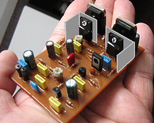

To avoid those bias drift, because of the drivers...install
Small heatsinks on them.... as the temperature rise that interest us, to produce action over the VBE multiplier, is the output temperature.
Of course you already perceived that...not too much intelligent decision from me....hehe
Force those guys to be cool!

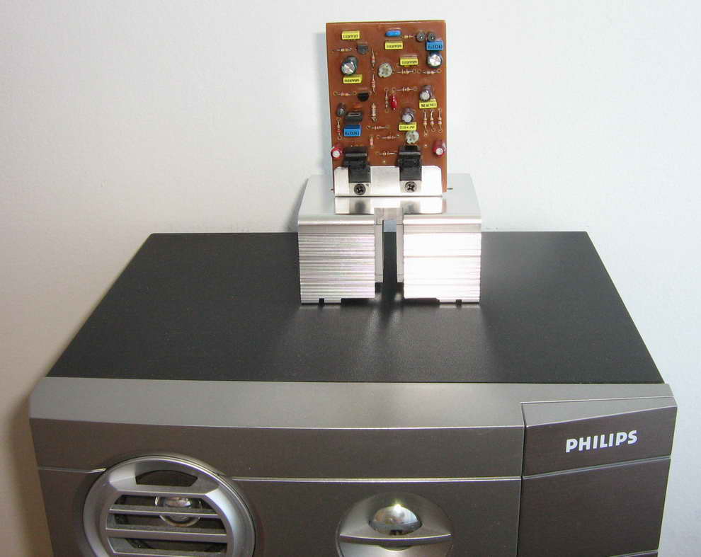

The "L" shape one is very pretty too.
There's a lot of nice shapes that will match the needs there.
Dinaminc Power there, will not go over 1.5 Watts each driver...so... 1 square inch is enougth to each one of them.
If you decide to use "L" shape or something better, you will be able to reach a heatsink capacity that will be more than double than one suggested by that flat square inch aluminium plate.
" Dx amplifier is Hot "
regards,
Carlos

Hi Klaas, As Carlos suggests,
Mount the sensor device 'piggyback' on one of the output devices.
Cheers ........... Graham.
