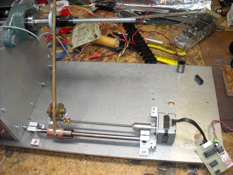

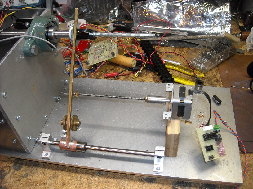

Here are the latest shots. I'm working on the traverse mechanism.
I'm at odds as which way to drive it. Low is easier to set up, but I believe high will give more regidity to the arm.
I'm using two pulleys so I can wind bifilar.

May I suggest that you add another linear guide to your traverse mechanism? That´s what I did in my machine, with two guides and one screw the whole assemly became rock solid, in opposite to how it was with only one guide.

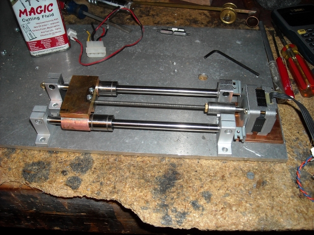

Still creeping along.
I got the second guiderod and built a new shuttle assembly. The bearings will press in the copper tubes when complete.
Leadscrew is zero lash with a spring tensioner under the shuttle.
