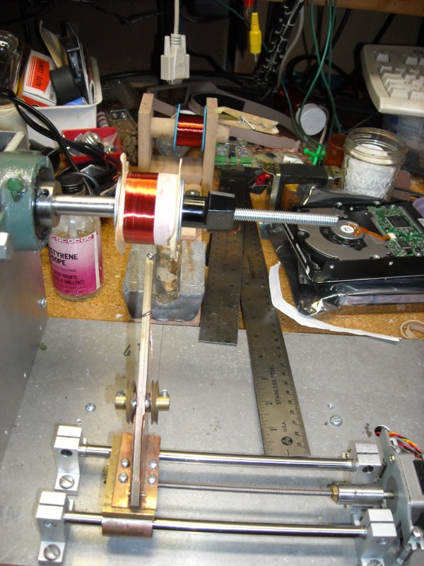

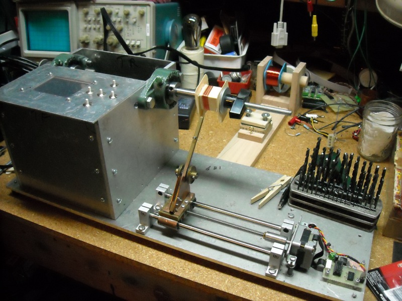

Ok, I´ve wasted huge amounts of magnet wire on failed transformer projects the last few weeks but that has more to do with me raising my ambitions too quickly rather than with any shortcomings of the machine. I should of course have started with a few simple chokes and coils rather than trying to make a pair of sectioned PP output transformers...😱
Anyway, me and the programmer is currently working on a speed control for the spindle and traverse. Not much luck so far, I can get the speed down to zero but there us no useful range between zero and full speed. We´re working on it, slowly.
I´ve also ordered some parts for the wire tension servo mechanism. Instead of only using a stepper with shorted (or DC-magnetized) windings as a brake I´m giong to let the Arduino drive that stepper forward in the exact pace to keep the spring loaded "dancer" in a preset position. Might require a lot of coarse language to make this mechanism work...

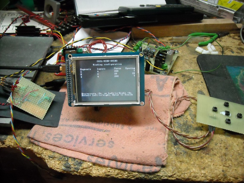

Well, the four line display got real crowded so I switched to a TFT display.
Unfortunatly this does not solve my synchronization problem. Depending on the number of turns and wire size, either the spindle will stop before the traverse, or the traverse will stop before the spindle. I can't seem to get them to stop together. It is a linear error.
I'm about to make a correction equation that will fudge them into synchronization and ignore it.
I can print the wind parameters before it starts winding, and everything looks correct. The only thing I can see is the possibility of the acceleration throwing it off, but I'm seeing a 14% error in 500 turns (not a likely configuration,but still it is an issue) and that is way too much for acceleration to account for.

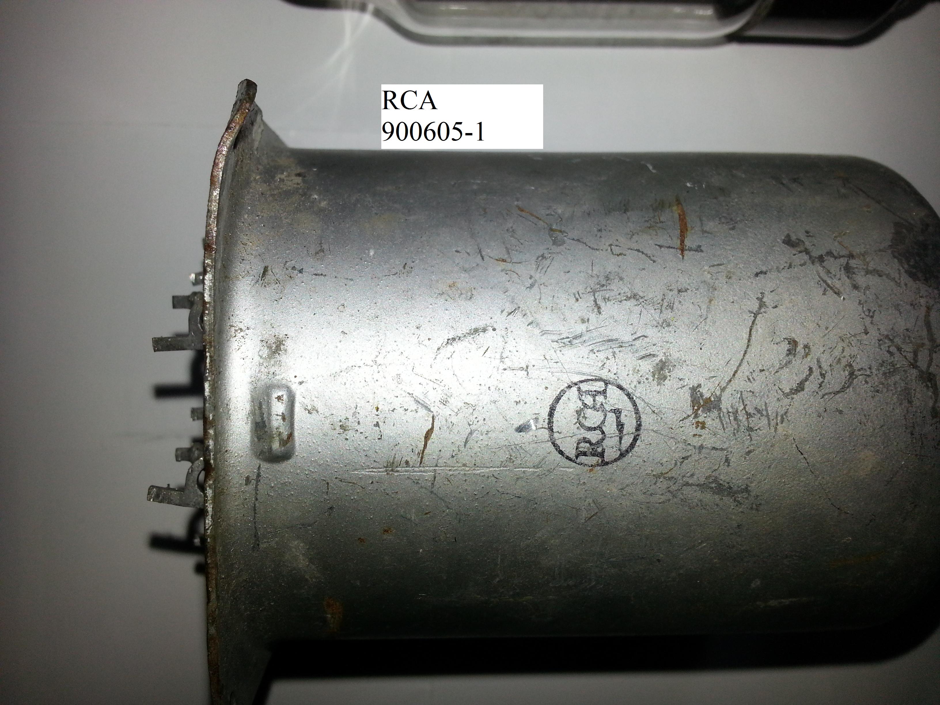

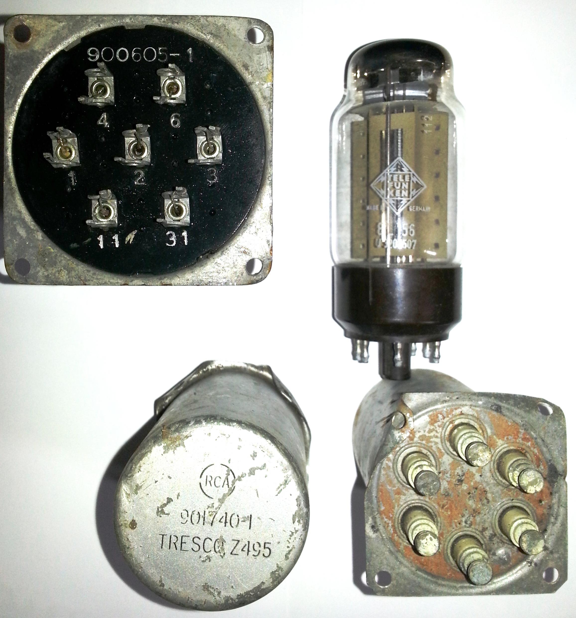

Output transformer from RCA 76-B5 broadcast mixing console (1939-).
"The output transformer is 901740-1 . The DCR readings are 2.64Kohms and 212ohms."

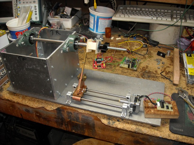

After beating my head against the wall for nearly two months, I think I finally found my problem.
I updated the Arduino compiler from 1.04 to 1.05, and updated the AccelStepper library from 1.20 to 1.35 and the problem decreased by an order of magnatude. I'm now getting a total error at 300 turns of less than one turn, which may well be due to acceleration synchronization.
Now to go back and clean up the mess I made of the code trying to figure out what I was doing wrong and then I can work on the acceleration factors.

I've found the limitations of using the arduino MEGA-2560 with AccelStepper (Insufficient horspower) and have managed to get someting that I think will work, although I had to strip out some features.

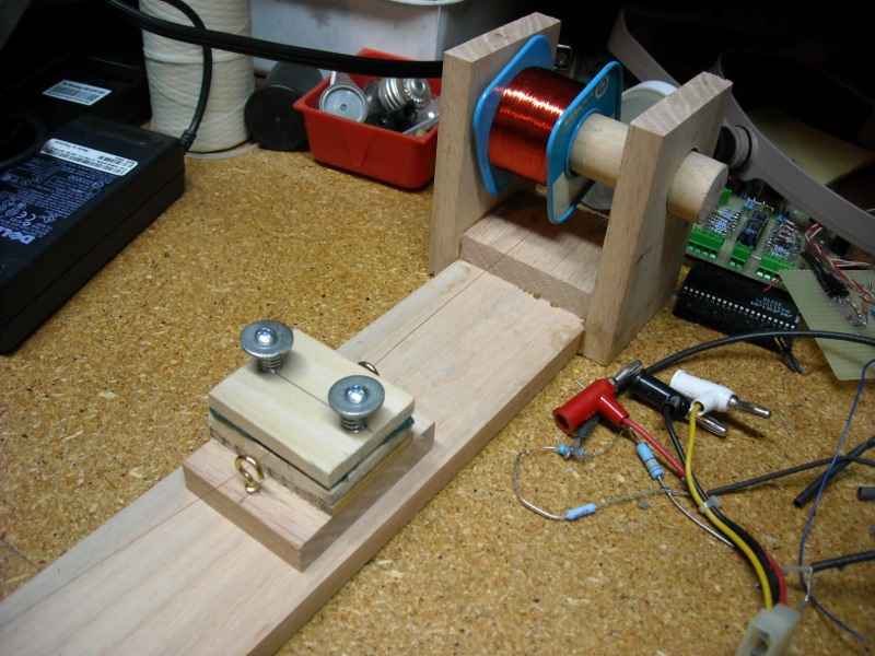

1. This was a trial run to test the winding tensioner. It looks good.
2. Close up of wire feed and tensioner.

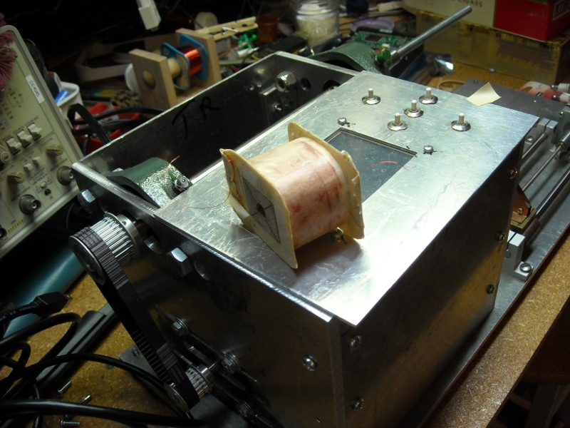

I finally wound the coil tonight.
First try last night was a mess.
I ended up using Bamboo paper instead of tissue paper as it is stronger. Craft Paper is "Right Out", as it is way too stiff.
As is, it is pretty poorly wound but it will work for a first pass to get some measurements.
I'll have to figure out how to bond out the leads and try to keept them straight.
