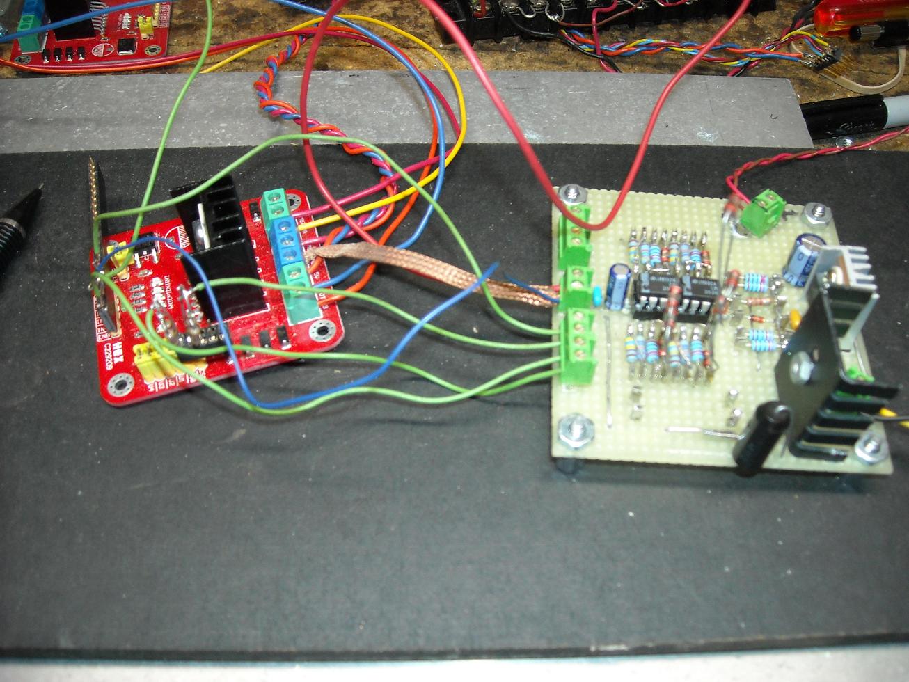

No hardware progress in the past 10 days as I fried my Arduino. I'm not sure what happened as it was running fine stepping the shaft and then there was a slight snap sound followed shortly thereafter by the 3 terminal regulator spewing its guts.
The USB interface chip went so no sense in trying to fix it. The regulator probably dumped 12VDC on the 5V circuitry. It was not on the computer USB port at the time so no damage to my main computer.
I just wonder if the stepper is somehow putting transients on the power supply that managed to get through the regulator and damage the board.
If so, I need to add some transient suppression.
I built a new 8V pre-regulator (7808 with heat sink) to drive the Arduino from the 20V supply. So hopefully there will not be a repeat of the event.

Sorry to hear of your mishap. What chip is it on your driver board? It may or may not have in built catch diodes to catch the back emf. Great to hear that the project is coming along well, will you post your code once finished? I would be interested in using it to modify my cludge of a winder. I would keep my DC spindle motor and add an encoder though.

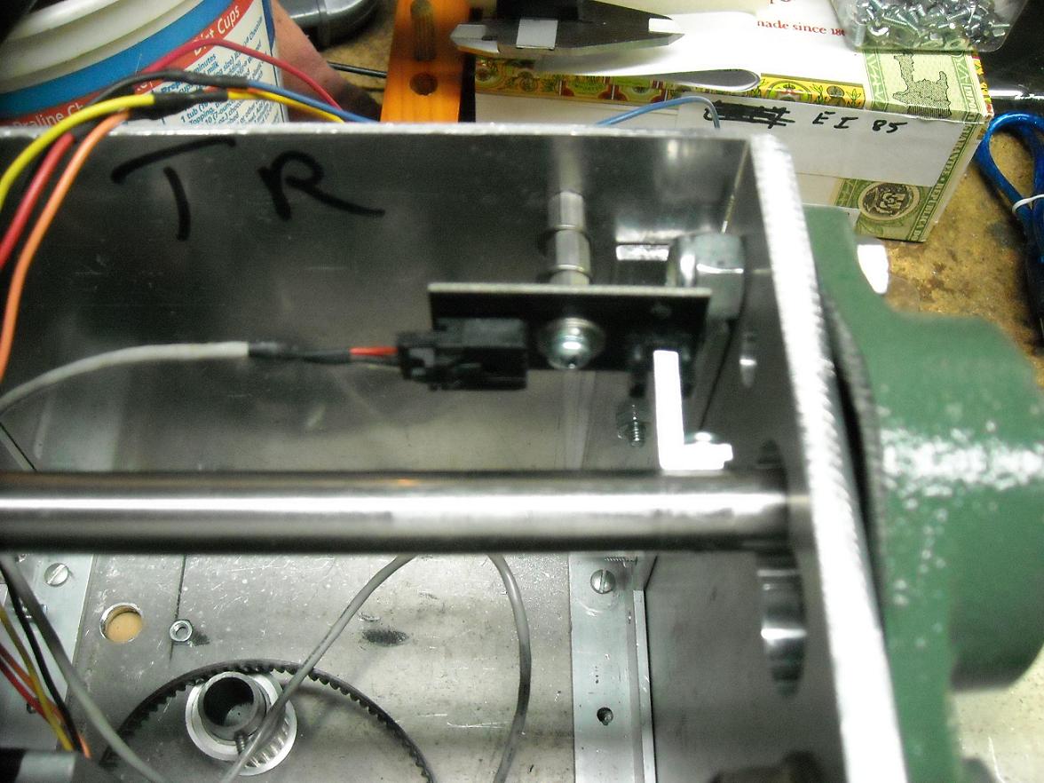

Opto-Coupler and Interrupter in place on the shaft.
The shaft is hardened to some extent, much more so than water harden drill rod. I busted off a 6-32 tap tonight tapping the hole for the screw to hold the interrupter in place.
It was a bugger to get out and re-tap and I spent most of the evening working on it but finally was able to clean it out and finish tapping it. I should be able to start on the buffer tomorrow, and begin testing the turns counter (redundant to the stepper count).

The heatsink on the stepper controller is way too small. I guess it is good for 3 or four watts max. If I am runing two motors at 2A each per winding with two windings, that is approaching 24W dissipation (figure 3V drop on the H-Bridge switches).
Question is whether use another heatsink, or find a way to mount it to the al plate and use it to carry away the heat.
