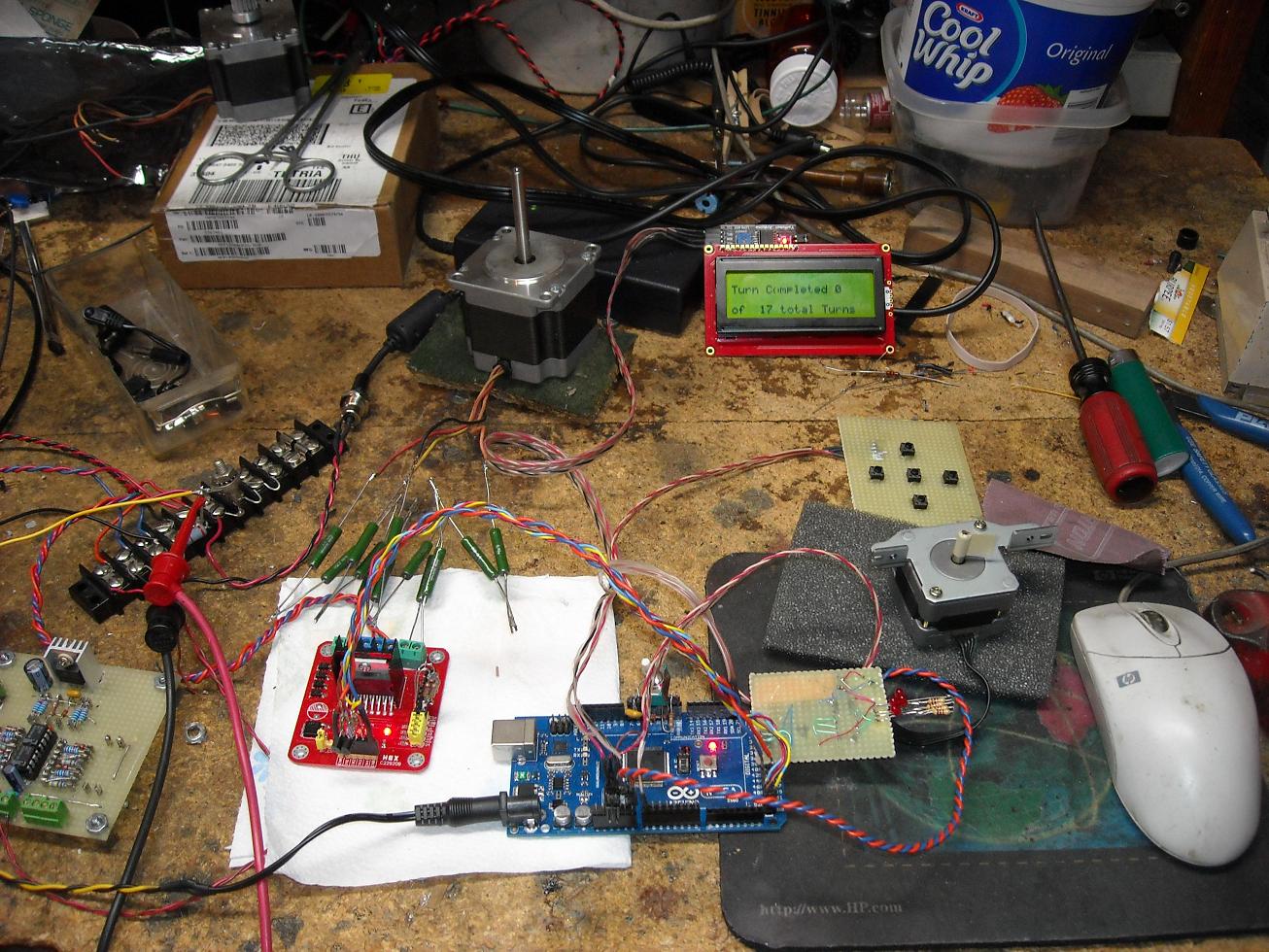

I'm using a NEMA17 motor for the traverse mechanism and a NEMA23 for the spindle. I had hoped to use a NEMA34 (overkill) that I salvaged about 20 years ago, but it is toast.
The NEMA23 should have plenty of torque based on the tests I've done so far with the NEMA17.
I have limited programming experience, but think I can muddle through.
The NEMA17 starts having problems at 300steps per second (200step/rev) and I think it may limit my winding speed. I'm concerned about running too fast and losing sync, so I may need to use an interrupt routine with a opt interrupter to keep track of rotation. One possibility is to use two sensors with slight phase offset to insure I can track direction.
I've been looking at interrupt operation of the Arduino today.
First indications are that I can run three motors simultaneously,but I have to be very careful to keep the main routine lean or everything slows down.

I got the code far enough to test the synchronization of the motors. I think the acceleration factors will need tweaking to get it right, but it is close for a first pass (5.8% error is not near good enough).
Feature creep has taken over the project and it looks like I will try to implement multi-section capability before I integrate the controller and hardware.
Good news on the NEMA23 motor, it should be plenty powerful enough. Even running at .5A/winding (resistive current limiting) I can't hold the shaft and stop it from turning. I estimate it should operate around 2A based on the physical size, resistance and inductance measurements. So it should have plenty of torque without using reduction pulleys (which would slow it down).
I plan on using a comparator to measure the voltage drop across a sense resistor to limit the current rather than using resistive drop, but the initial test of the comparator feedback looked wrong so I set it aside for now.
I'll get back to it once I have the code ready.

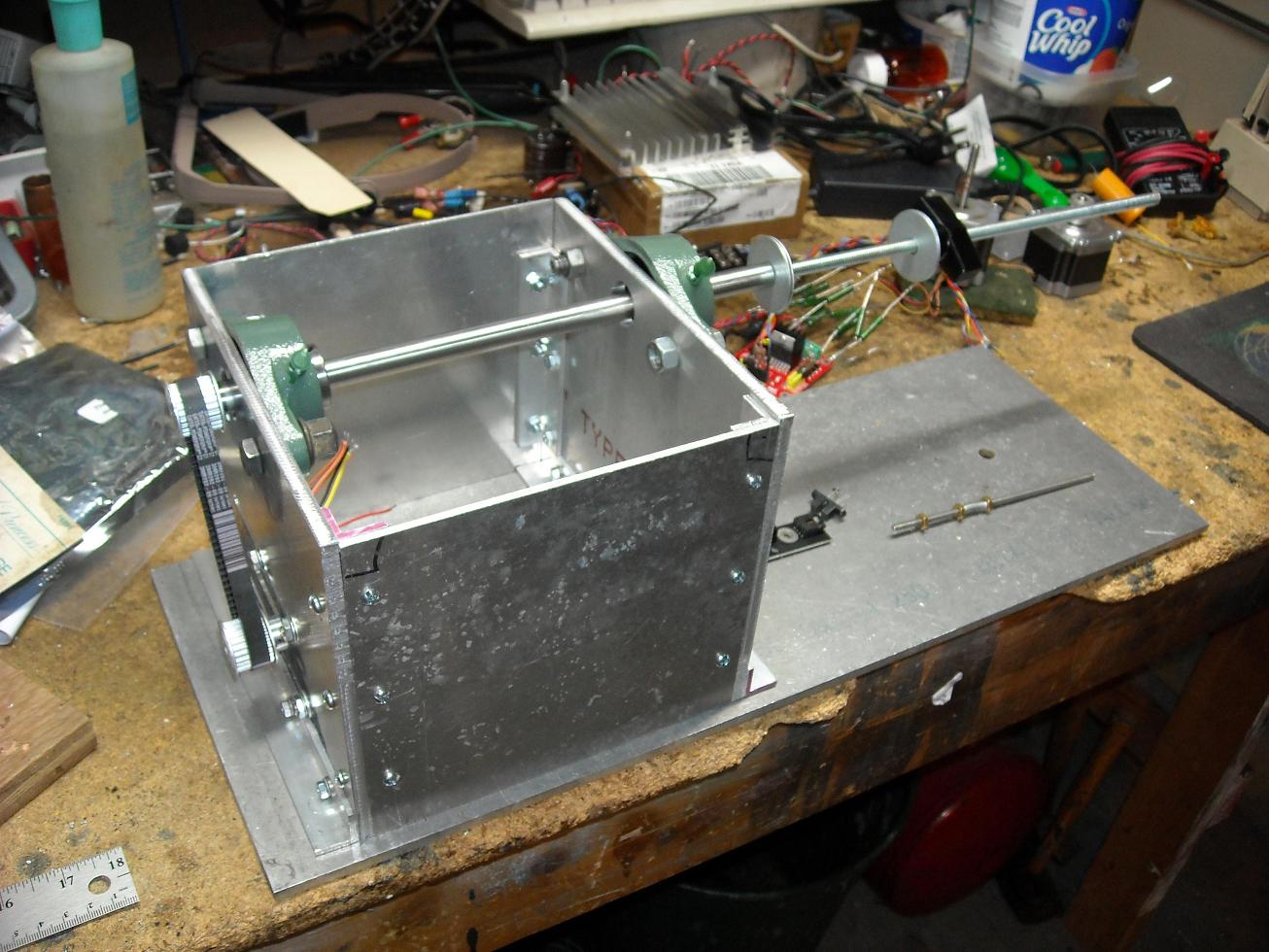

Latest on the chassis is that the basic panels and angle brackets for assembly are cut and fitted.
I'm interleaving working on F/W and working on the mechanism.

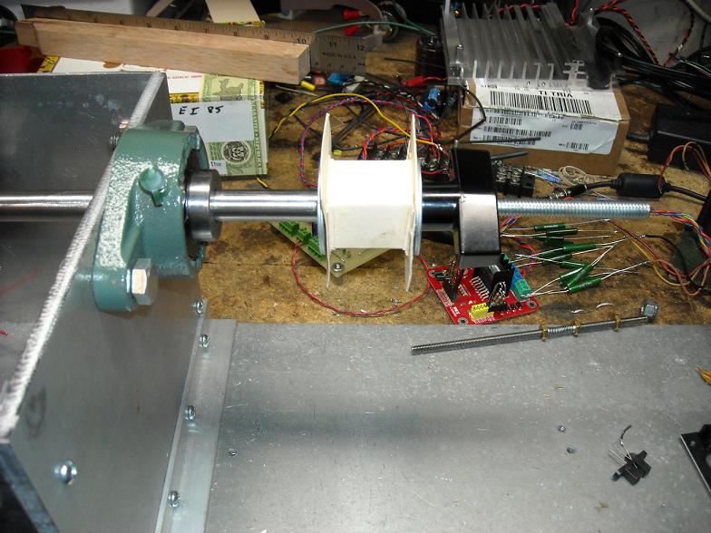

How large does the spindle and clamp need to be? This is what I'm currently thinking of, with a bobbin for an EI85 core in place.
Currently I plan on setting up for a max of EI-150, which looks like it is much larger than anything I anticipate winding.
Beyond the length of the spindle clamp rod, the size of the core effects the distance from the wire feed mechanism to minimize changes in wire feed geometry.
Any thoughts?
Any thoughts?
