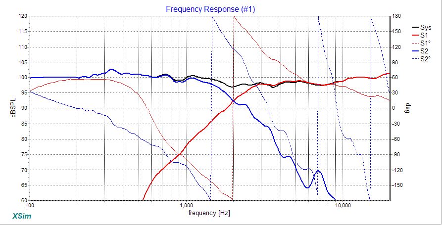

When doing simulations, I always think validity is improved if more than 1 person arrives at the same result. I just had a chance to sim up my files albeit with slightly different baffle diffraction effects from Dave Bullet's, but I come up with just about the exact same results using his schematic values. Phase alignment is just about perfect with a nice simple and clean topology.

Attached is with my files and Dave's xo in XSim.

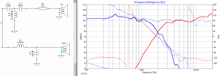

Thanks. To be fair, my design wasn't actually mine. It was Douglas' topology with some adjustment values for increased BSC and a shunt resistor on the woofer capacitor just to help the slope for phase alignment.
I also like when other converge on a similar outcome using different tools and maybe tool setup methods. Provides some confidence.
I attach the RAW SB Acoustics measurements "factory" and data, plus the FRD files I used applying the baffle step and diffraction ripple of the enclosure meeting kristians layout preferences "in box" (woofer above tweeter).
NB: I lack the knowledge on how to apply an enclosure response to a factory impedance curve - so I used the SB acoustics ZMA files for both
(Remove the .TXT on all files)
If that is appropriate, here's an alternative..Phase alignment is just about perfect with a nice simple and clean topology.

I like the phase tracking on Allens XO.

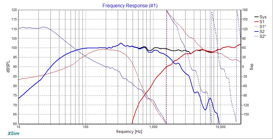

I would be concerned with the files he's using or perhaps the woofer delay because I don't get the same results with my files. See below using Allen's values.
Phase is not well aligned and the FR looks a little too quiet from about 1500Hz on up.

I used your files, but you had 2" of delay figured in so I brought it back to 1/2".
Incidentally, the 1500Hz trend is intentional, and has been discussed elsewhere, but it's simple to revert.

On what basis did you conclude that 1/2" is more appropriate?
Probably adjusted the setback to align the phase.
