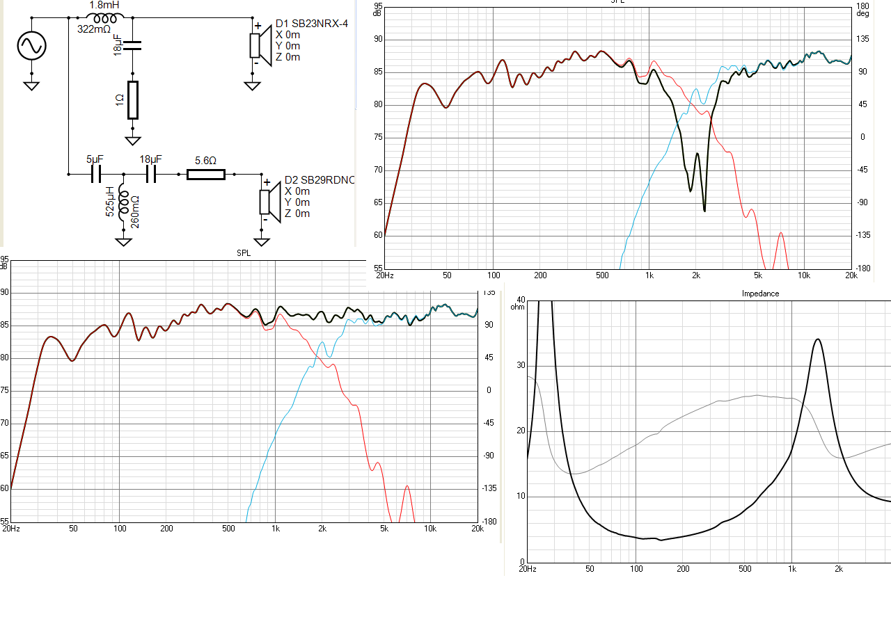

Douglas, I generally don't take any xo seriously when it is only showing system phase and not the individual driver phase. I think this should be especially paid attention to in this thread because it was one of the OP's original concerns.
In XSim you can get the driver phase by a small checkbox on the dialog when opening the curves in the SPL window. XSim doesn't store window configurations so we have to open them manually each time.
The fact that your woofer response is actually greater than the summed response around 1000Hz tells me that phase alignment between the 2 drivers isn't actually very good.
I'm prone to agree.
If you have a thing about current, I have a thing about phase alignment.
Really??? I would have never noticed 😀
Also the tweeter response doesn't look like it is maintaining the 4th order roll-off any more although it's a little difficult to tell without the target curve added in.
That's because I had to revert to 3rd order to get rid of that ringing in the shunt inductor. You may be able to clean it up and still get your curve.
Again, asking as little as possible from the tweeter below about 1600Hz I think is vital to the success of this design.
Okay, makes sense.
But I like the way that you've used the parallel capacitor in the tweeter circuit to tame the slight rising response. Nice.
Think of it as "sibilance control"... a minor inefficiency for a better purpose.

Here's my attempt. I targeted a net 87dB sensitivity. Although the woofer is stated at 92dB - I have assumed a narrow baffle and being high off the floor, you wont get much boundary re-enforcement.
I have redone the FRD/ZMA files - based on SB Acoustics measurements plus applied baffle step and diffraction ripple on a 962(h) x 274 (w) baffle, placing the woofer 825mm from the floor and tweeter below it at 667mm from the floor. The assumed listening axis is the woofer (being on top) and Z offsets for crossover modeling are 4.15mm for tweeter and 39mm for woofer, with an assumed 3 metre distance.
A net volume of 42L (excluding port), tuned to 33Hz (FB) will give you an F3 of 37Hz.
PS: of the 3 crossovers (excluding mine), Douglas' modeled the best but didnt' have enough BSC in my opinion and tweeter needed a little more padding.

Well technically it is stated at 92dB for 2.83V/1m, and as it is a 4ohm driver that's 2 watts, it's a little misleading, the woofer sensitivity is more around 89dB. So the 87dB target sounds pretty good to me.

Thank you for your effort! I've noticed you haven't accounted for the driver placement in Xsim, does this not affect the phase and mag response of the system?

In VituixCAD you enter the Z offset in the driver tab not in the crossover. That's why all drivers have Z=0. Since I had already accounted for rolloff in the baffle diffraction response, I didn't enter an additional Y offset either.
