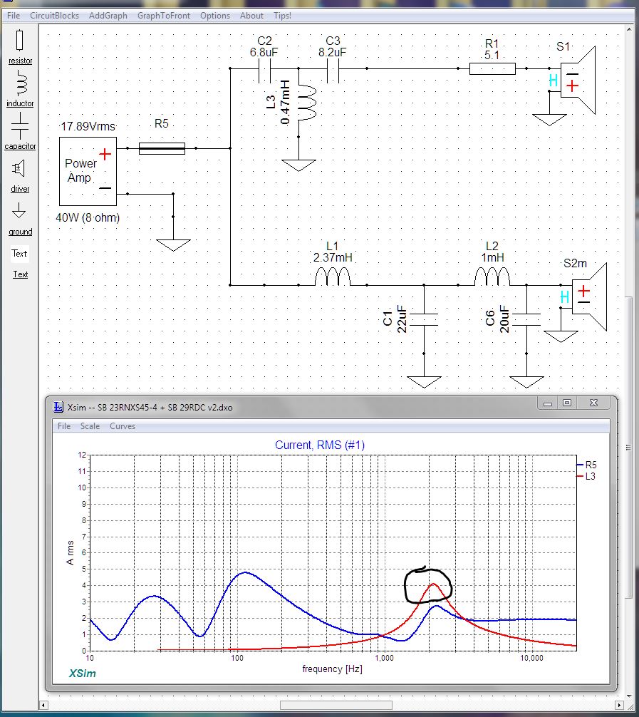

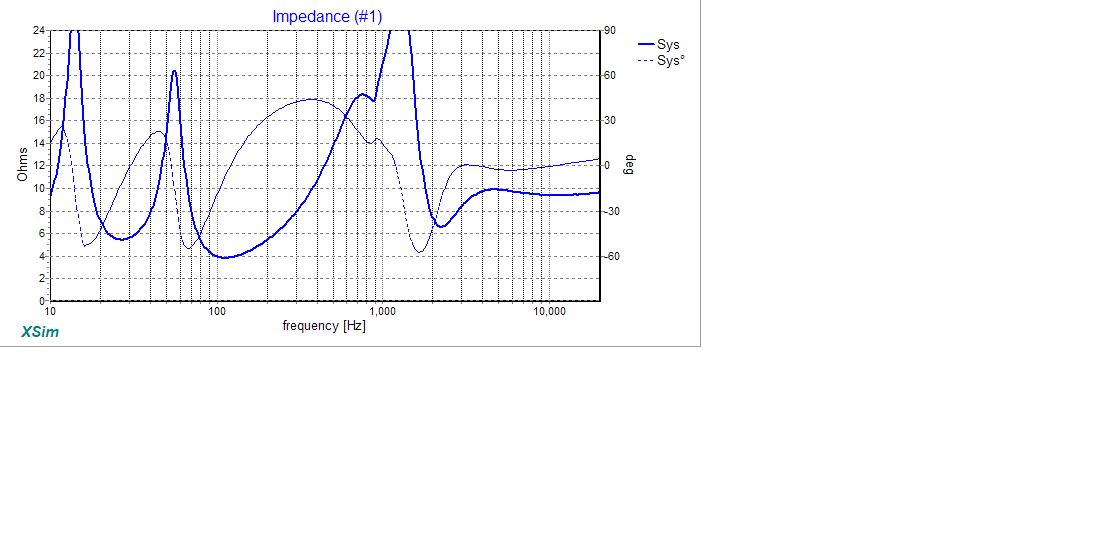

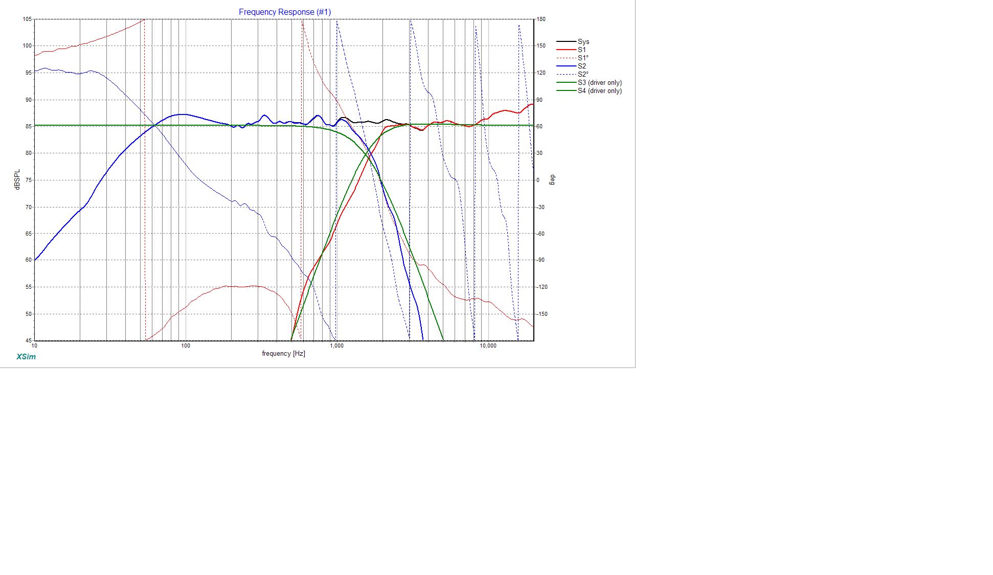

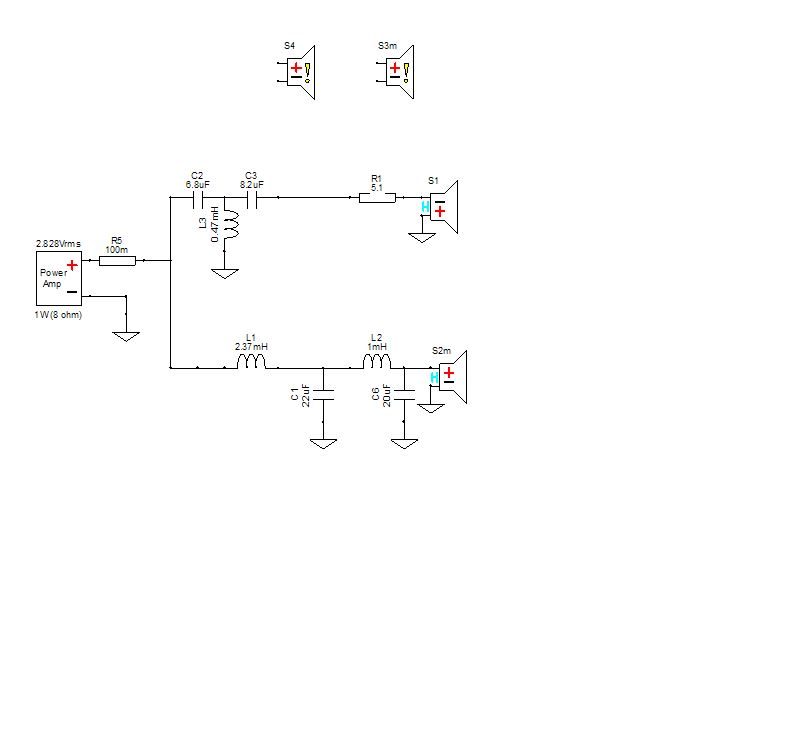

Back on topic, I took some more time to have another go at the xo and attached is about the best I could come up with. Still a few tiny little problems but hey, what can you do?
This time I added in some target curves (in green) for an LR4 xo at 1600Hz which is nicely acieved this time with 3rd order electric on the tweeter and 4th order electric on the woofer. Tweeter polarity is now reversed. Phase alignment is perfect right at the xo point but diverges a bit as you go plus and minus in frequency.

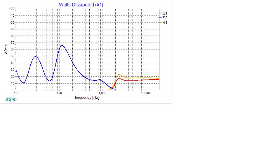

Current draw and watts dissipated are with 40W this time corresponding to where xmax is achieved on the woofer and producing about 103dB at 1m. The current draw is high at about 100Hz and through the tweeter inductor L3 going to ground but remain under the max 5amps that you can get from a 100W amplifier. Not perfect but better than last time.
The 1 resistor in the tweeter circuit actually sees more power than one would think so if the speaker is actually going to see these kind of SPL levels, doubling up resistors in parallel to achieve more power capability might be a good idea.

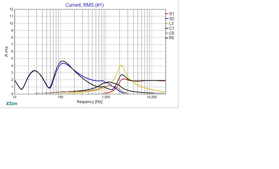

Thank you. As I suspected it's resonating quite strongly at about 2.7khz
Load up the DXO, open the current panel and get curves for R5 and L3... The thumbnail shows what happens if you open C3 or R1. Note the scale on the current plot... Yep, that's 45 amps.
I gotta say, that's a first for me.

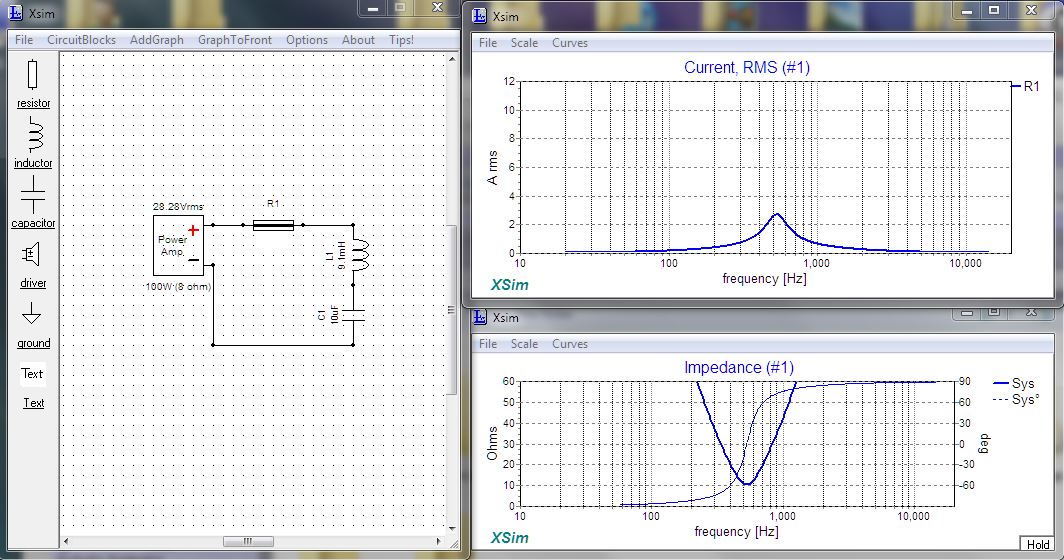

What does this have to do with crossover design, other than as a warning not to run a crossover without the driver hooked up?
Don't know for sure, just yet...
Any unloaded low or high pass LC filter becomes a series resonant circuit, and eddy currents between the two components can be quite strong... In this case the resonance is strong enough to actually affect current in the filter that is not coming from the amplifier and I would imagine that would have a deleterious effect on sound quality.

Sorry for the confusion ... it took a bit to suss this one out.

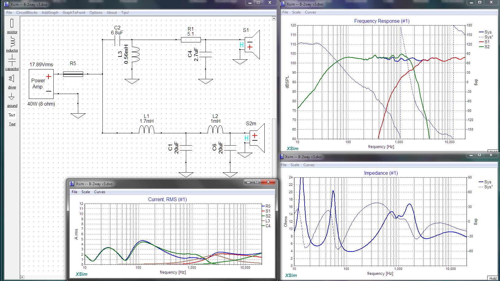

The first thumbnail shows what I was obsessing about. It shows that c2, l3 and c3 were very close to resonance and L3 was actually handling more current than was being taken from the amplifier. In my radio days we would call that "ringing" or "near resonant" behaviour and it represents some degree of instability that I was thinking might actually be audible in a speaker.
The second thumbnail shows a re-worked tweeter circuit that doesn't ring... I also added a little RC filter to even out the very high frequency response a bit.
There's nothing particularly wrong with @JReave's design ... it's just that I'm not fond of parts getting a mind of their own 😎

High and Low pass LC filters are series resonant circuits, when operated with out a load and they will behave like one given the chance. (See the thumbnail)
Resonance in a series LC circuit is characterised as a very low resistance (fractions of an ohm) and the circuit itself appears as a resistor to the other components around it.
Below resonance it appears as a capacitor
Above resonance it appears as a coil
Near resonance this can fluctuate ... or ring.
This instability could be audible in some cases and you don't want the crossover getting a voice of it's own and colouring the sound.

Douglas, I generally don't take any xo seriously when it is only showing system phase and not the individual driver phase. I think this should be especially paid attention to in this thread because it was one of the OP's original concerns.
The fact that your woofer response is actually greater than the summed response around 1000Hz tells me that phase alignment between the 2 drivers isn't actually very good. If you have a thing about current, I have a thing about phase alignment. Also the tweeter response doesn't look like it is maintaining the 4th order roll-off any more although it's a little difficult to tell without the target curve added in. Again, asking as little as possible from the tweeter below about 1600Hz I think is vital to the success of this design.
But I like the way that you've used the parallel capacitor in the tweeter circuit to tame the slight rising response. Nice.
Allen, yes indeed, my files include baffle effects on both the the woofer and tweeter as well as a modified woofer impedance response for the woofer in a vented enclosure, so a full 6dB of baffle step loss although I'm not 100% sure that is what the OP will need.
