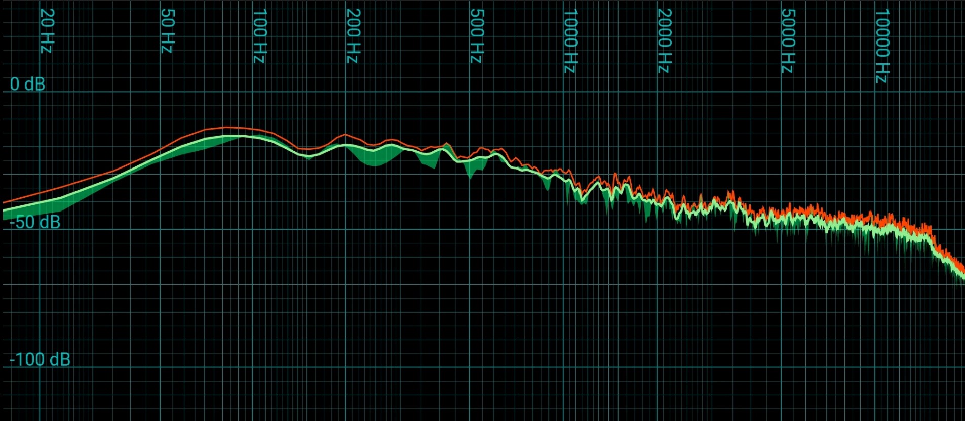

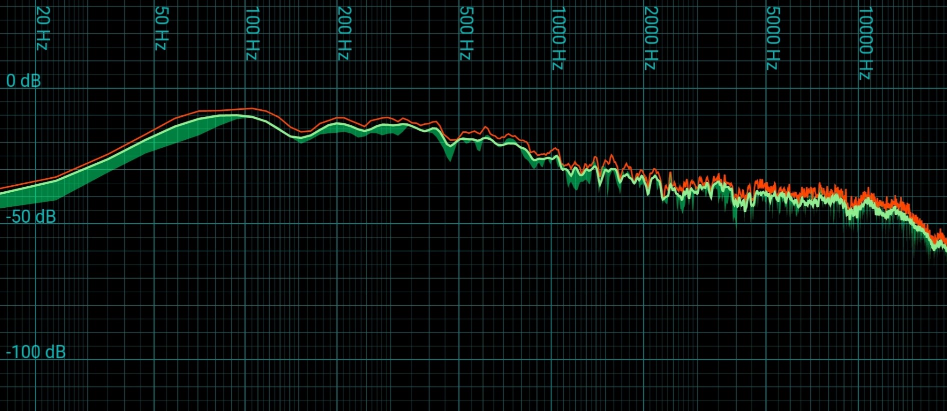

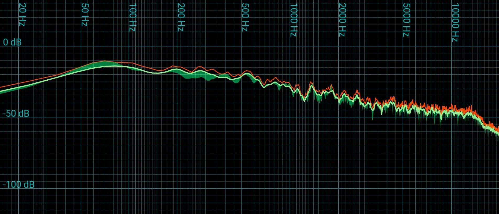

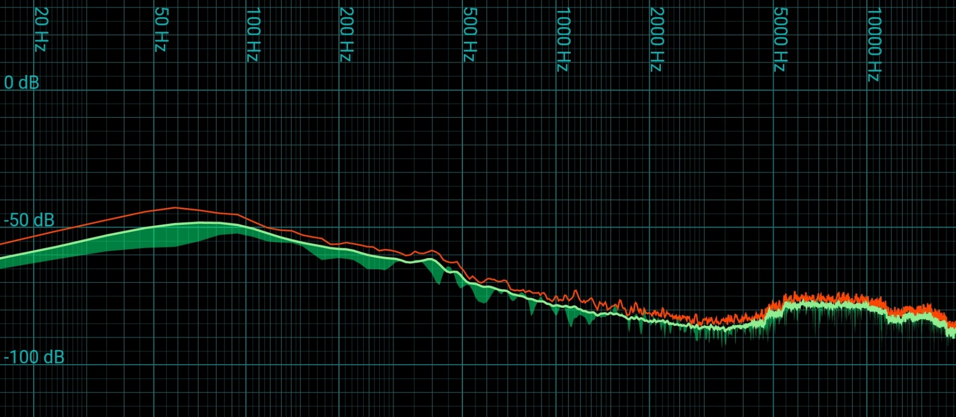

I assembled the crossover and connected it to the speaker and ran a quick pink noise FR measurement, and a background noise measurement. The pictures below are the screenshots from the audio analyser tool I used with my microphone from approximately 0.5m from the face of the speaker.
I live in the country side so i can also go out in my garden to do some free field measurements, to see how close the model is to the real thing.
If you have any suggestions for what I should measure, I'd love to hear them. I only have a microphone, amplifier, and a multimeter at hand.
PS the first image is the baseline measurement, the second is with a pink noise generator running.

I would prefer to have a little more bite in the higher frequencies, as you can see in the graphs its lacking in that region. In person it also sounds a little dull as you might imagine.
I didn't solder the crossover components, I just twisted the leads together, could this be a reason why the highs are so low?
The whole midrange and treble looks far too low in level. Everything should be flat from about 200hz and up.
I haven't been following this thread much but IIRC people have been simulating the crossover for you? There's obviously far too much baffle step correction and the large inductor needs unwinding to bring the midrange up.
If you just keep simulating and making new crossovers it will take forever guessing what the right level should be, and will cost a fortune in components.
If you could unwind the large inductor and only have that component inline with the woofer (don't bother with the tweeter) or any other components. Just keep unwinding it, bit by bit, whilst taking measurements (don't cut the wire because you may need to wind it back after the new crossover is simulated). Until the frequency response is flat from 200hz and up to about 1000hz. Once you've done this and measured the inductor, someone can input this value into software and use that as a reference. Obviously in the software it will look like the speaker has a rising response, but will be flat in reality.

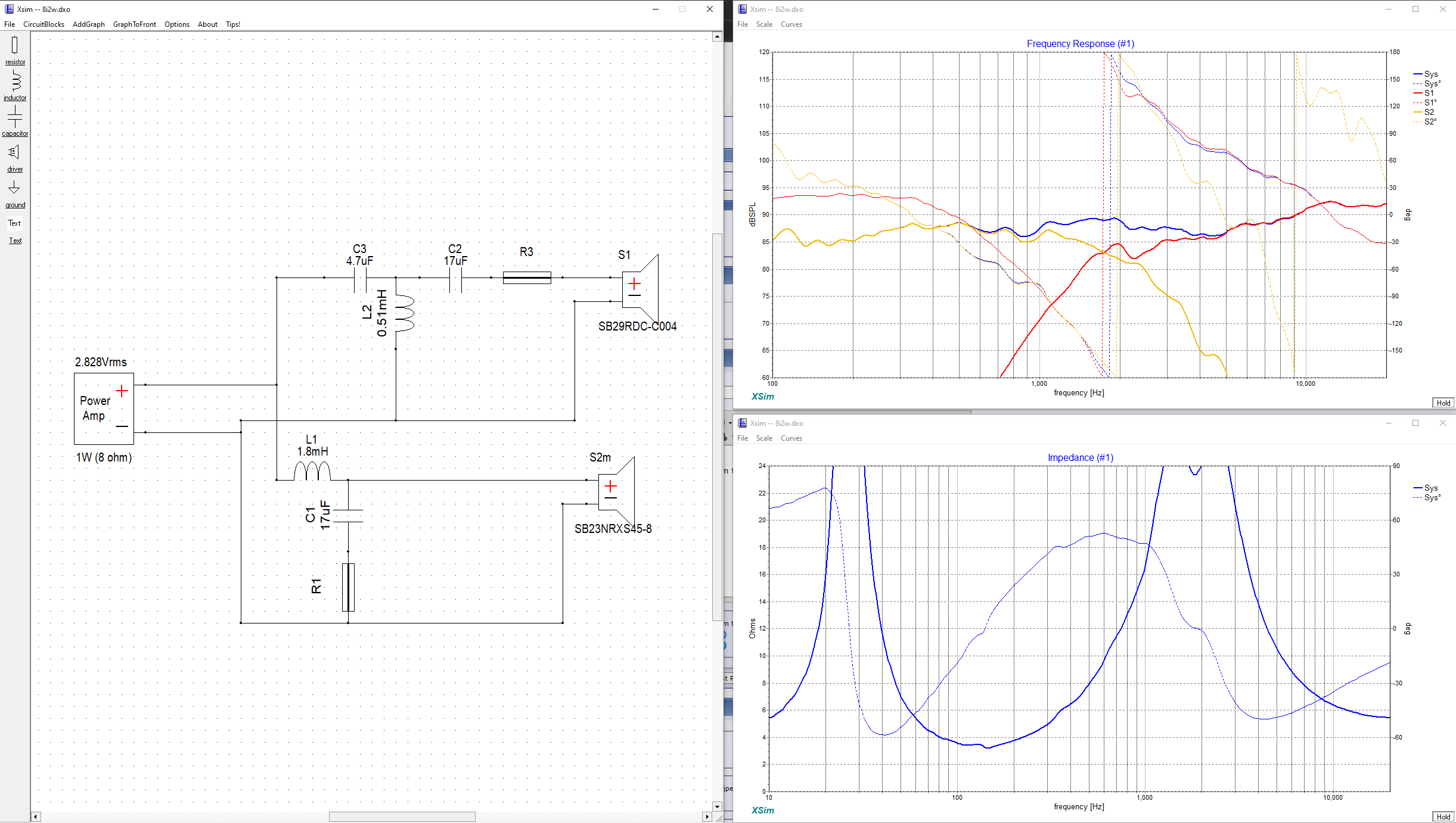

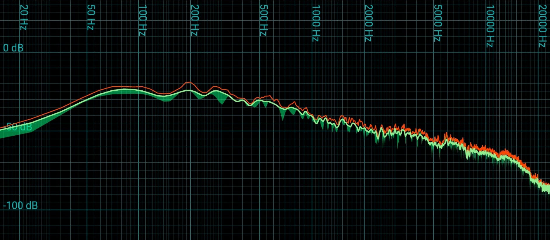

I've removed the 5.6 ohm resistor from the tweeter, this results in an incline at HF. I've also removed the 0.68 ohm resistor from the woofer side. They resulted in the below images. Next I will try unwinding the small inductor as that increased the sound level at a higher frequency range than a decrease in the large inductor's inductance would. This should result in a smoother incline.

Don't bother messing with the small inductor. It's the 1.8mh you need to unwind

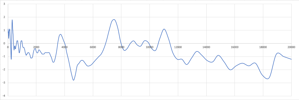

This is the microphone's response btw. This might explain the low level measurements of the HF range a little.
The y-axis is in dB.
Oh, are you saying it's not a calibrated microphone?

If you've removed the tweeter resistor, this shows your measurements are very wrong. The tweeter should measure with higher SPL than the midbass.
I have a pair of mission 710 that I am using as reference for the mid to high range. So if there is anything wrong with the measurements the error will be constant.

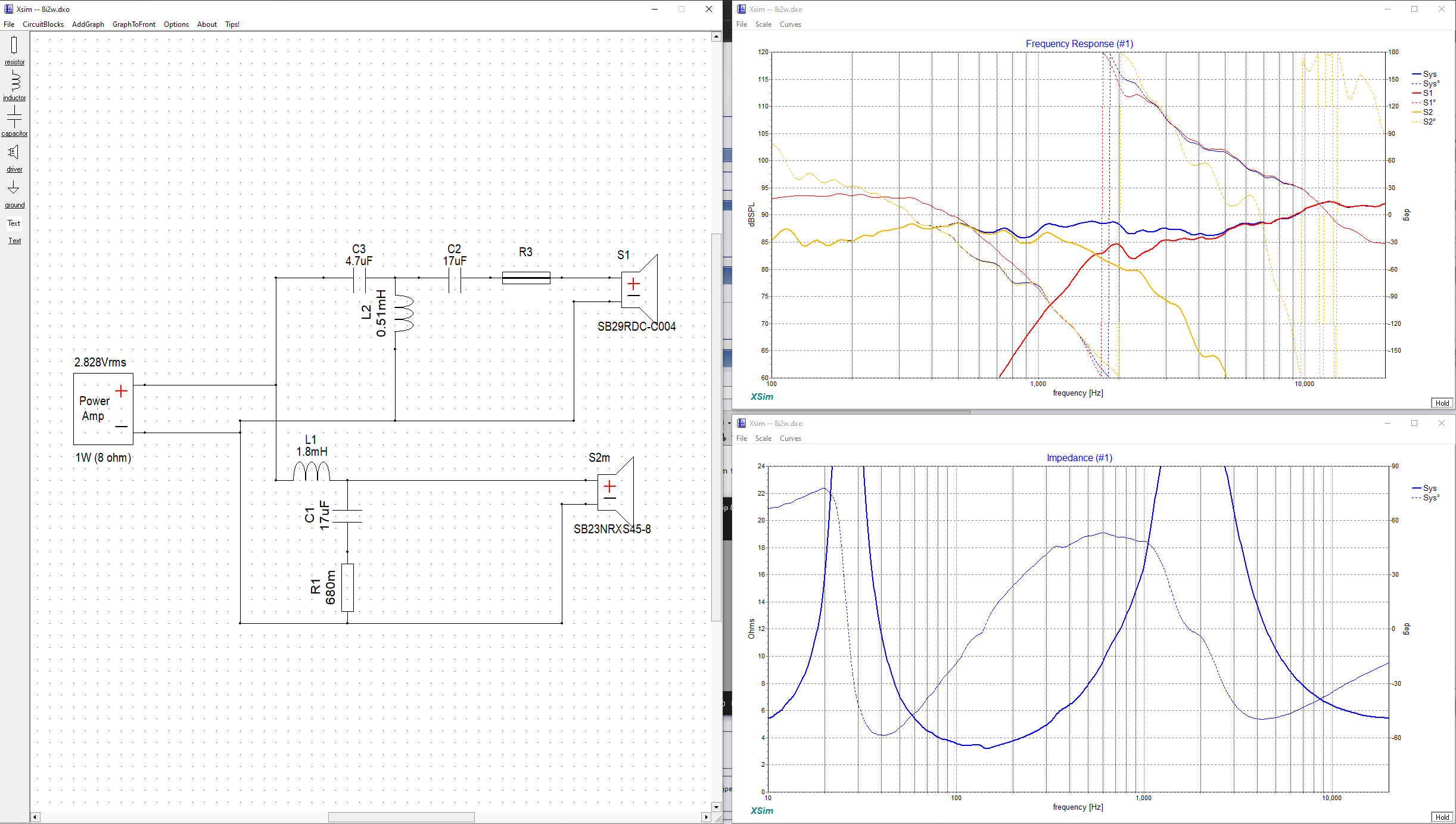

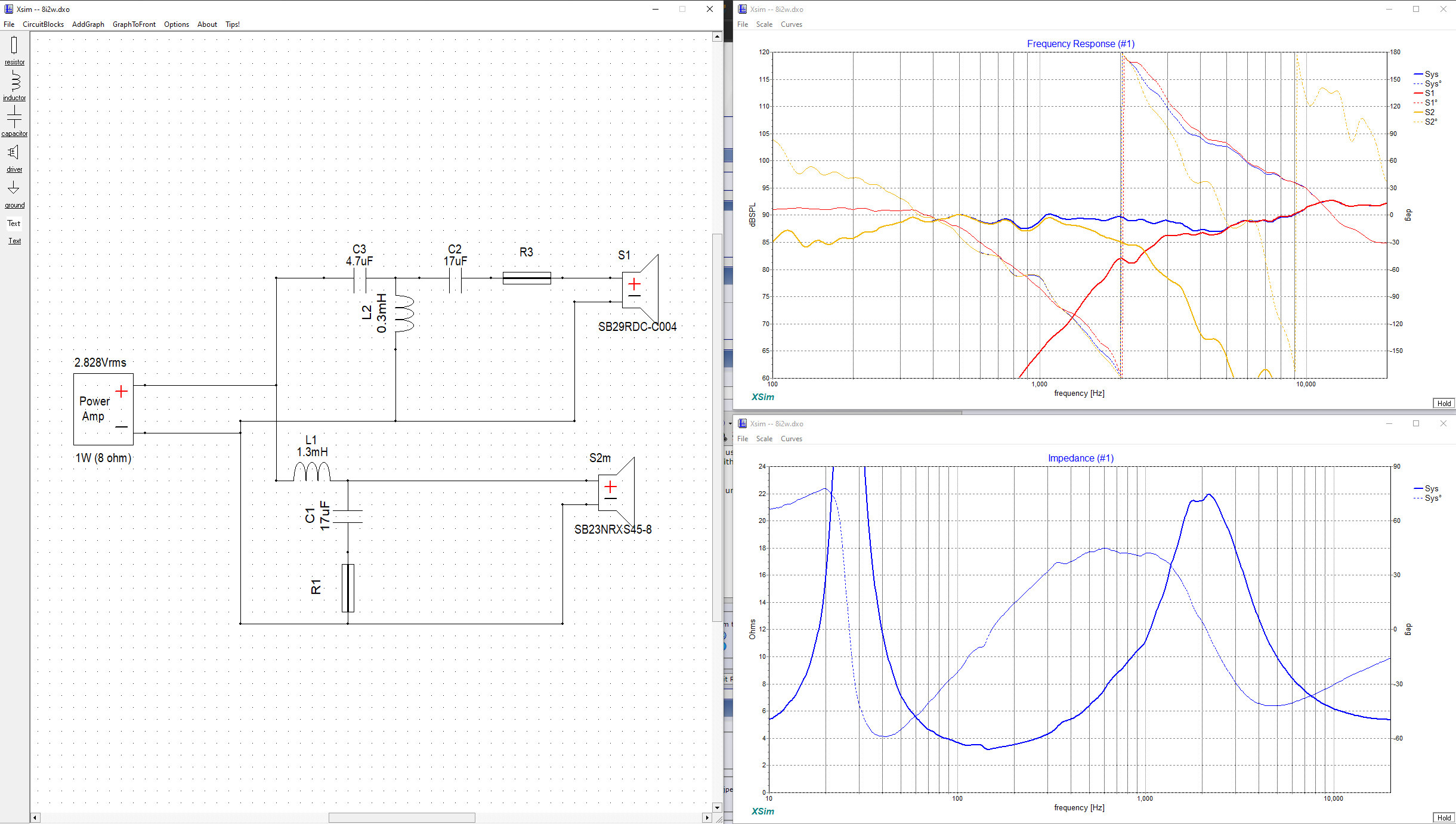

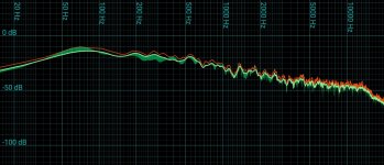

So far I've removed the resistors, and unwound the large capacitor down to 1.3mH, and the small one to 0.3mH. I've attached the simulation, and the measured output, plus the measurement with only the resistors removed for comparison.

I wouldn't unwind the inductors or mess with the crossover any more. You need to get your measurements right first.
Have a good read of post #110
I've found my mistake, and its very stupid. I have been using pink noise to measure the speakers up until now, pink noise has a downward slope with frequency, thats why the measurements are sloping.
Don't mess with the crossover components... yet.
First - you need to have reliable data.
Re-read the articles linked in jReaves post #110. It is vital you get good consistent measurements. These should be done without any crossover in place. When measuring the tweeter - use your multi-meter on the test signal to ensure no more than 0.5v is output from the amplifier. That's a perfectly safe level to get reliable full range measurements unless you are in a very noisy environment. Alternatively, you can increase level but increase the starting sweep frequency in REW. Personally I feel safer with 0.5v input. Try both sine wave and white noise
