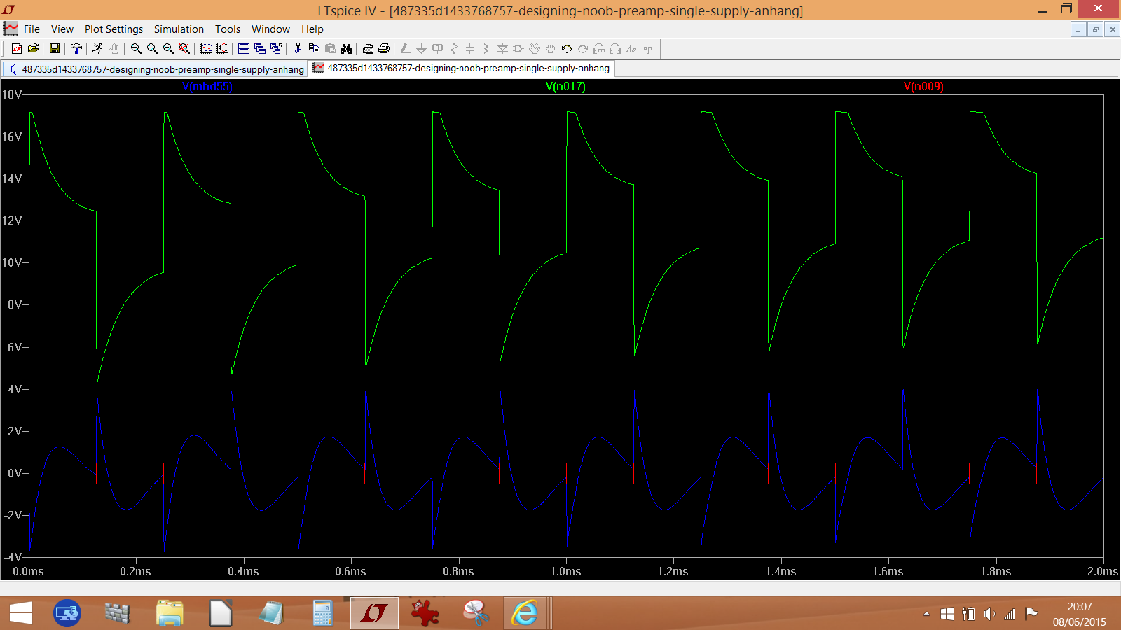

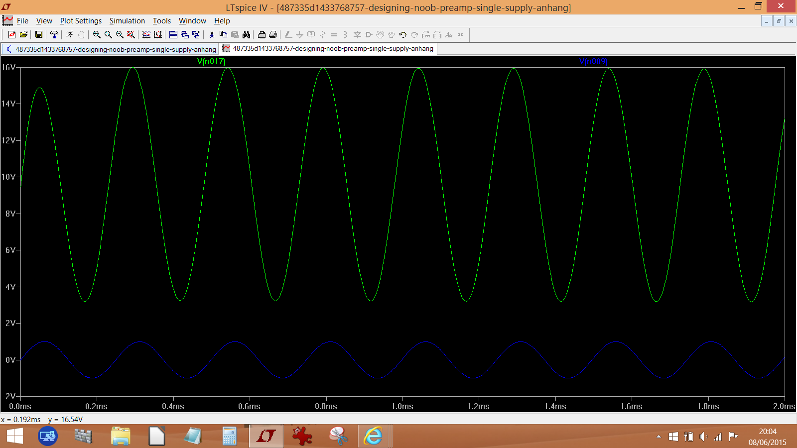

I've tried the sim and the stand out thing I notice is how much gain there is at around 4012Hz. The first image here shows the second opamp output vs the input signal. The second image was a squarewave test at the same frequency which shows clipping. The highly distorted waveform (which is 'normal' for high order filters) is the output of the final high pass section.
That massive gain could account for any odd 'shaped' noise you hear and at 4kHz its right at the most sensitive part of our hearing.
I'm no expert on filter design and their calculations but you certainly have a massive gain at that frequency in that second opamp stage. The noise created there although attenuated by the circuitry further on, has already been added into the mix.
As I say though, I'm not really the one to ask on filter design. All I can think of is that if that really is the filter response you want then you must look to minimise noise by choice of opamp and rescaling values as I mentioned earlier. Whether that would be enough though given your high efficiency speakers I wouldn't like to say.

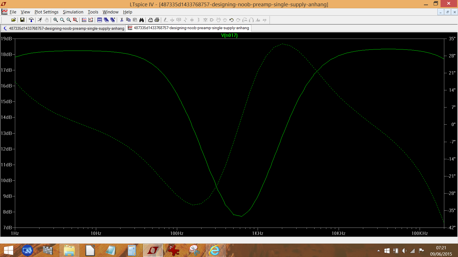

Well the gain is high above 4k as well if you look.
Just set the sim to 'AC Analysis' and look at the second opamp output and you will see a gain of 18db. That high gain means high noise, particularly with the resistor values used.
It also means that first stage is going to clip easily.
