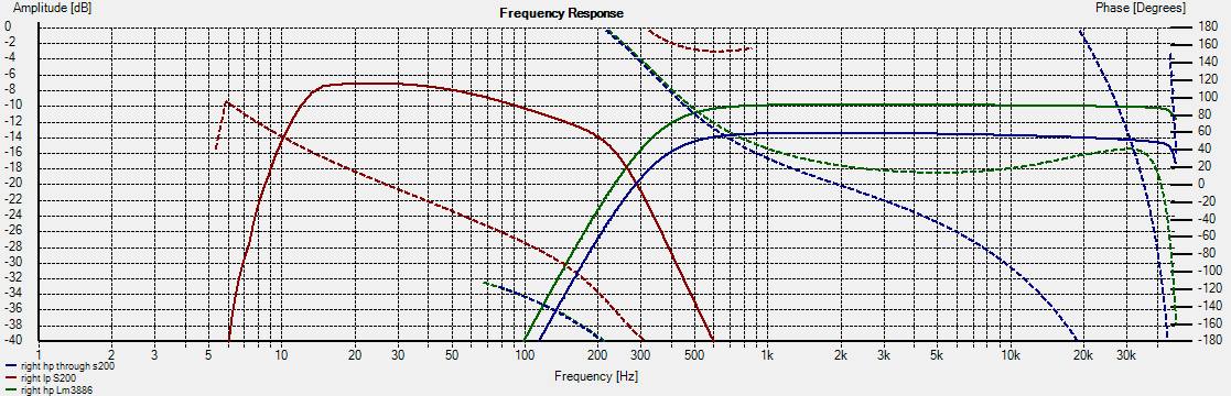

You are still stuck in your "filter-only" approach. That is never going to provide any useful results. The only way is to start with the individual driver SPL responses and move on from there. It is the combinations op driver SPL plus filer response that is to provide the final acoustic slope. It is the acoustic slope you have want/ have to target.
To illustrate the point, the graph below (ignore the blue curve) is the transfer function of my active crossover. This when combined with the actual drivers responses results in a 4th order accoustic bessel rollof. The filters are based on 3rd order electrical but as you can see they are far from standard 3rd order slopes (at least the low pass). If I used standard 3rd order filters, or 4th order for that matter, I would not get anywhere near the response that I do with these built for purpose filters.
Tony.

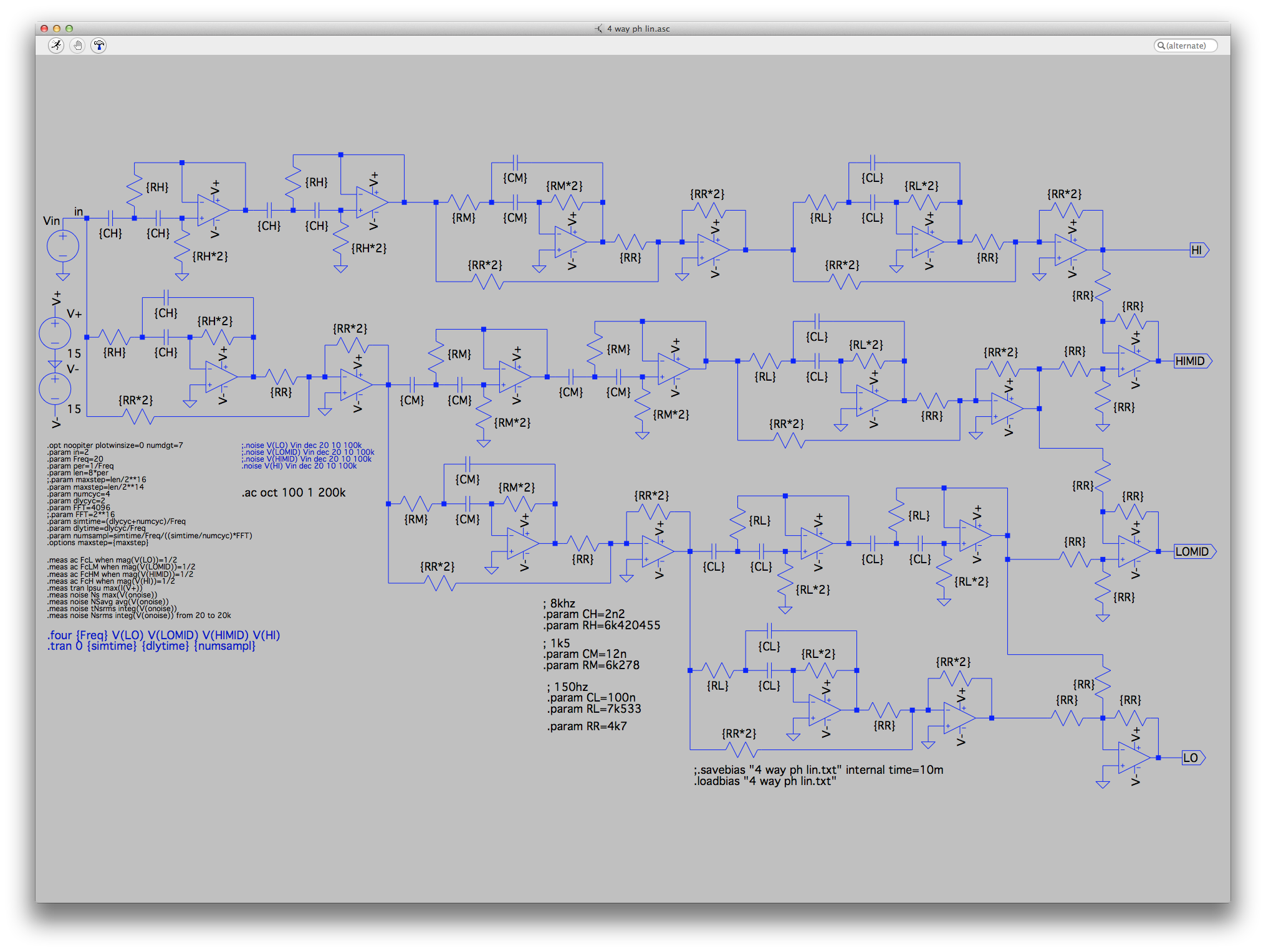

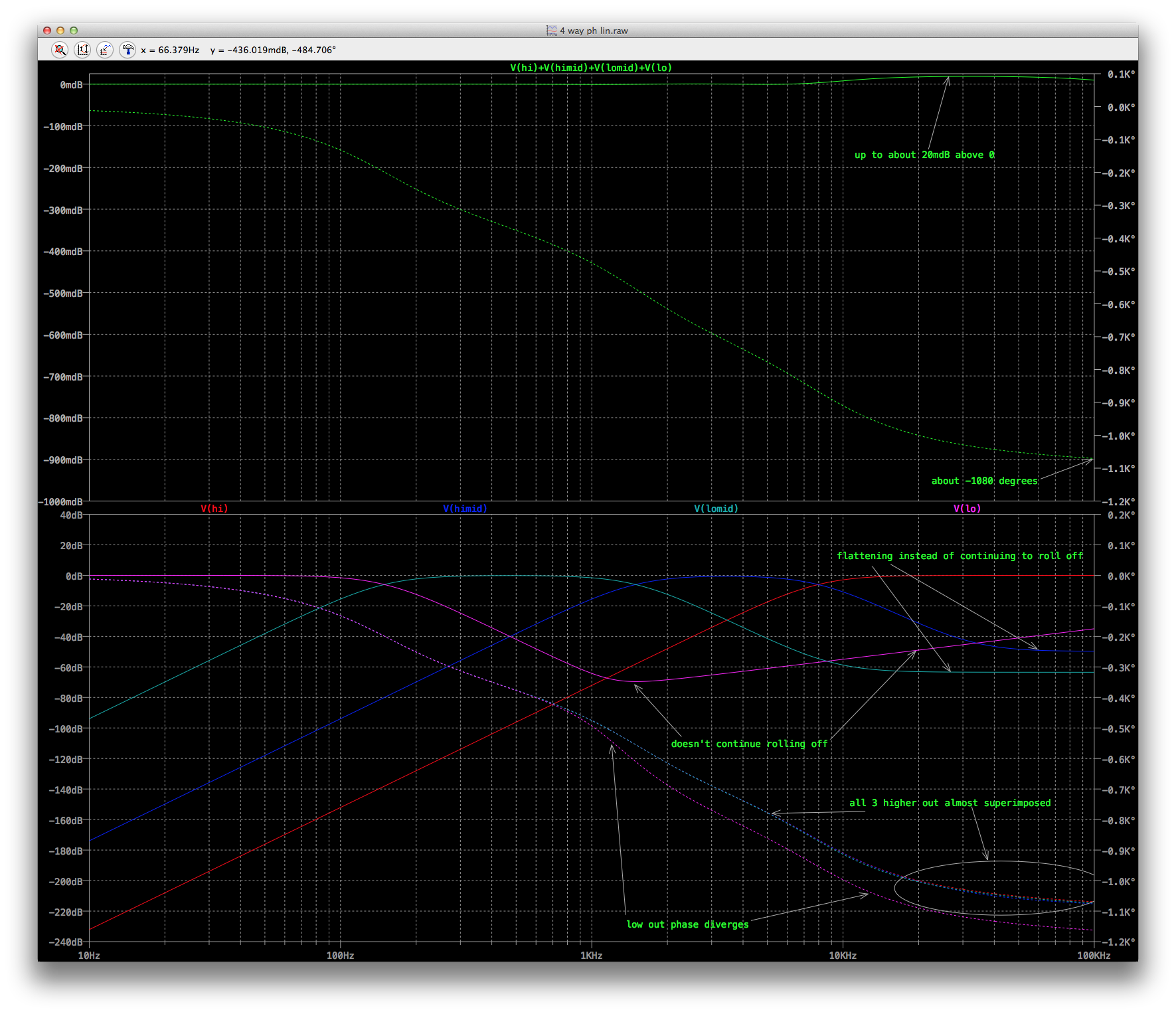

I tried looking at more sources for info about all-pass filters and wikipedia has a wiki for that:
https://en.wikipedia.org/wiki/All-pass_filter
And it so happens that they describe one that is exactly the same as what I tried using, and they also show the same formula that I used for it: 1/(2PiRC)
Perhaps the formula is not the wrong one for that topology but rather the topology I'm using isn't the one that I should.

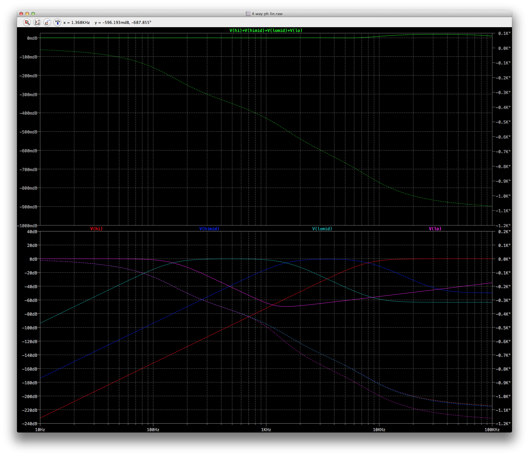

Here is a 4 way phase linear simulation, based mostly on a 3 way published in an old elektor (87).
I simulated the 3 way version from elektor and the results are mostly the same as an other previous elektor publication of a 3 way without the phase linear topo.
What is gained by trying to be phase linear doesn't seem worthwhile. At least it's not too much more complex in a 3 way, but with a 4 way the part count gets way up there.
I can see that for each band in the 4 way, we have 6 or 7 opamps in the signal's path.
There are some advantages, such as using only one type of band filter, low or high. So in this case I used only high pass. And the rest is all delay/all-pass.
It's supposed to be "phase linear", but I'm not sure what this is supposed to be like on a plot, as I can see the plotted summed response shows the phase going way beyond 1000 degrees at hf. This is quite a delay, and I'm questioning this "phase linear" concept.
The combined plot of the 4 curves show the obvious flaw in the response in the high frequencies, especially for the low output, which shows a level coming back up instead of rolling off. And this is probably the major contributor to the slightly elevated level above about 8khz in the summed response. It's only in the order of about 20mdB, so it's really negligible, and this goes into a subwoofer anyway, which isn't capable of reproducing this, and the level is low on the low output at those frequencies.
The combined plot also shows that for the 3 higher bands, the phase response is pretty much superimposed, but a good part of the phase response from the low output above 1khz diverges.

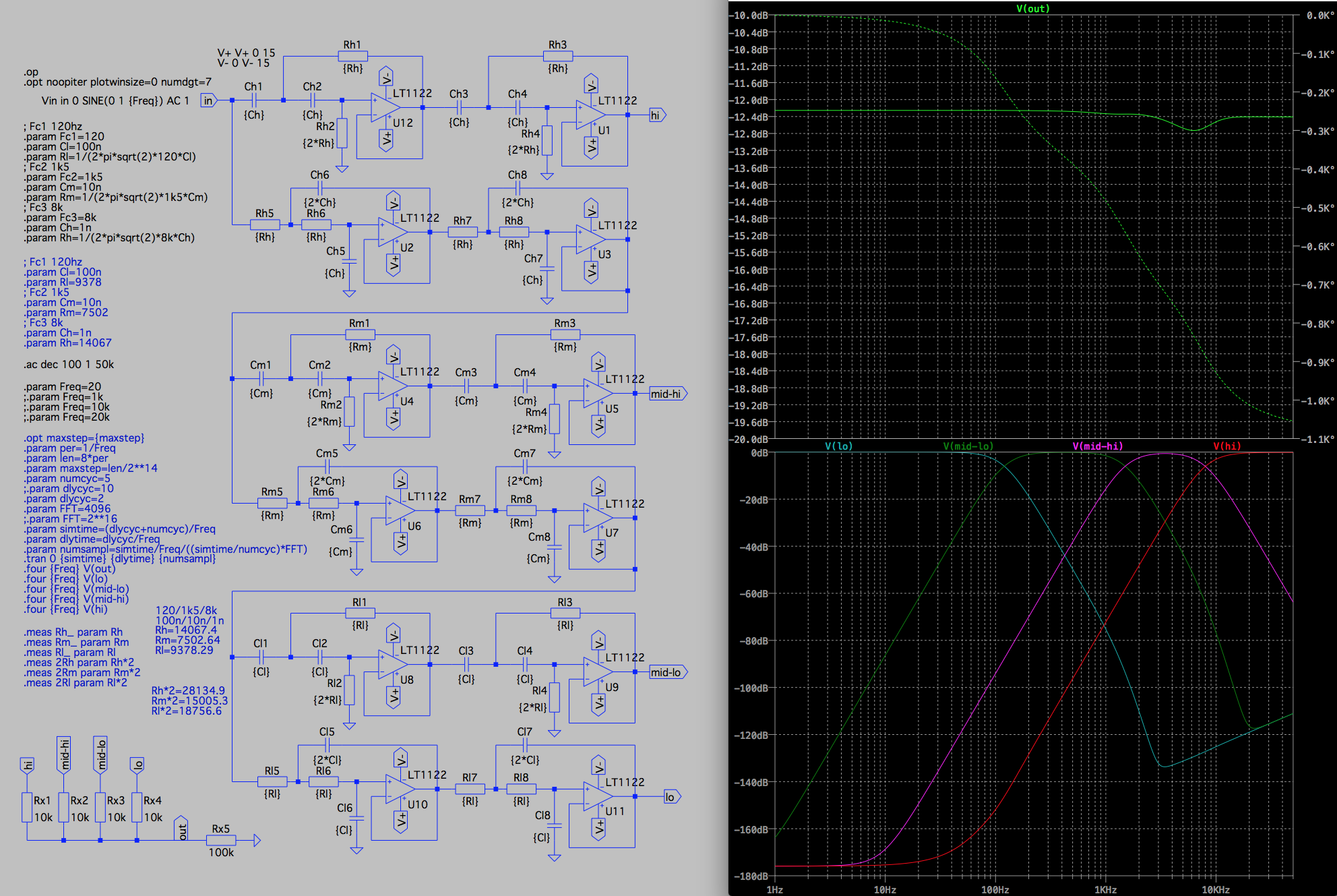

I ran many various simulations, with various topologies.
Although the state variable topology would be very nice, finding the 4gang pots isn't an easy thing to do, expensive and not guaranteed to be good enough.
So I don't think using the state variable topo will be helpful.
I don't want to do DSP, so analog filters remain the only solution.
I tried sallen-key filters with all-pass/delay cells, to try the phase-linear approach, as also described in some old elektor article, but that didn't seem much better than plain old regular method like what Rod Elliott proposes, so I went back to that type of topology and simulated a 4 way filter.
I used the LT1122 opamp to simulate this, as it was easier and that model comes built in with ltspice. Simplifies things.
The crossover frequencies came down to:
120Hz
1k5
8k
The caps are chosen and the resistors calculated from that. I have it all in a spreadsheet, which makes it easy if a change needs to be made, and to find the best resistor combinations to get the closest values to what was calculated.
I simulated with simplified common values, like on the E24/E48, and the errors don't really show much, but still, picking much closer values can be done, using all available values all the way to the E96 set.
All it's missing is output buffers, and reluctantly I suppose simple pots can be put there for adjustable output levels for each channel.
The output buffers can be balanced line drivers, so this can be made into a stand alone unit. With a built-in psu, it's a full fledged device.
Without sufficient financial means to go all the way, this can suffice to get it done and have something that works. Maybe not for a 100% flat response as is, depending so much on speakers (and the room). I think with a pink noise generator and some kind of spectrum analyzer, some adjustments can be made to make it work.
In any case, this beats any passive filter method.
And this could be kind of viewed as a prototype, to try it out and debug it.
