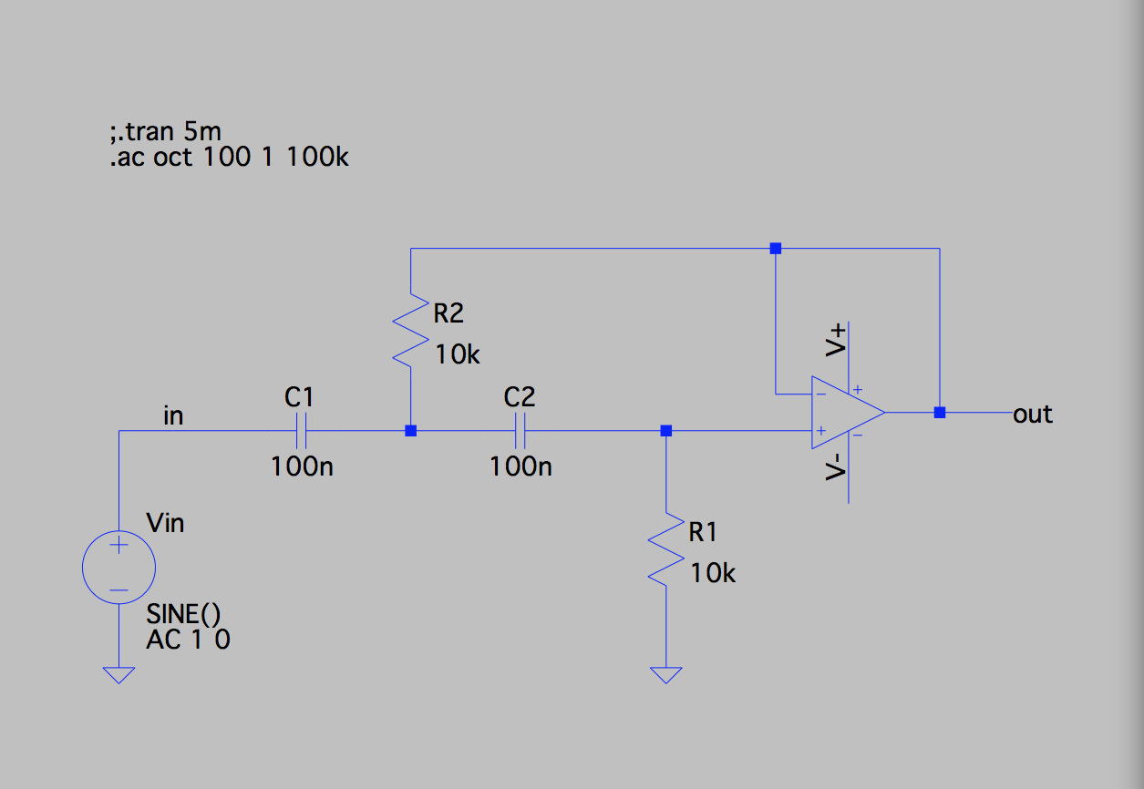

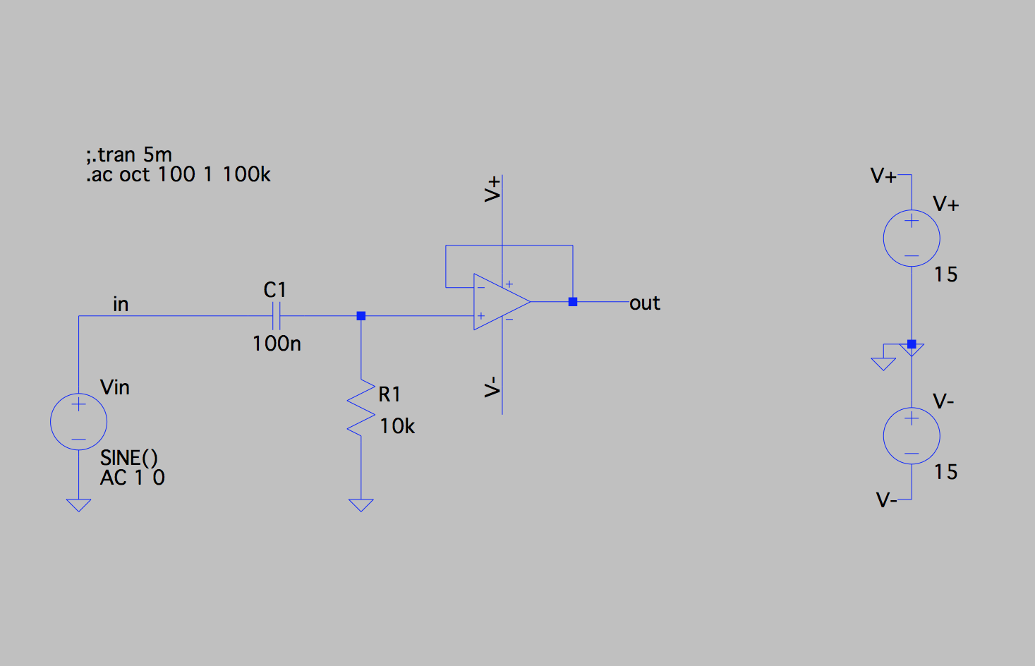

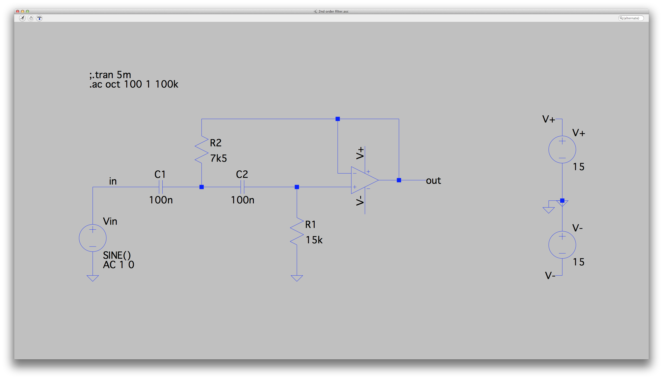

I found this formula in a filter description in an article and the topology has 4 1st order filters in cascade to obtain the 4th order linkwitz.
But now I think I will switch to cascading only 2 2nd order filters instead, which saves a lot on opamps and simplifies a bit the circuit.
For that topology, I am looking at an other description in an other article, unrelated, and the top factor is a bit different.

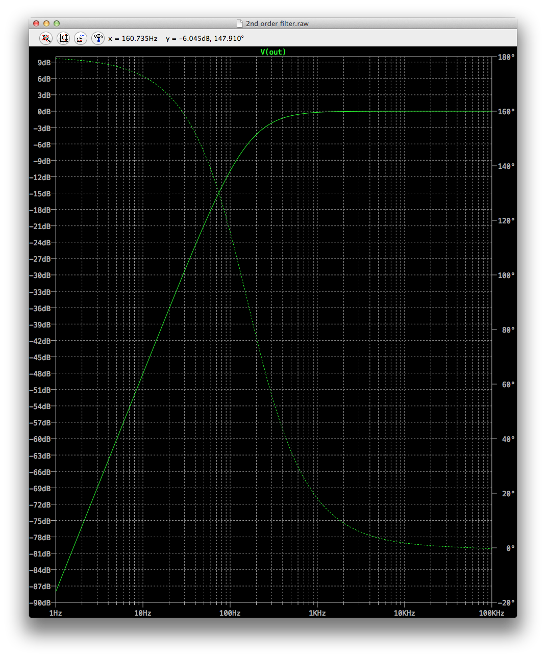

I am attaching a picture of the simulation that I'm putting together which is for one 1st order cell only. I am rusty with ltspice and going through a re-learning curve, so I don't know yet exactly how to do all of the proper simulations.
That formula with that top factor including a 1+ was what I found in that article, where they used those 1st order cascaded 4 times.
The design I will work on next will be 2nd order cells, and having 2 sets of RC, there are 2 formulas, one with the top factor being sqrt(2), while the other is sqrt(2)/2
I am no math wiz, not even close, so if I'm mistaken or am using formulas that are wrong, this is the time to correct it.

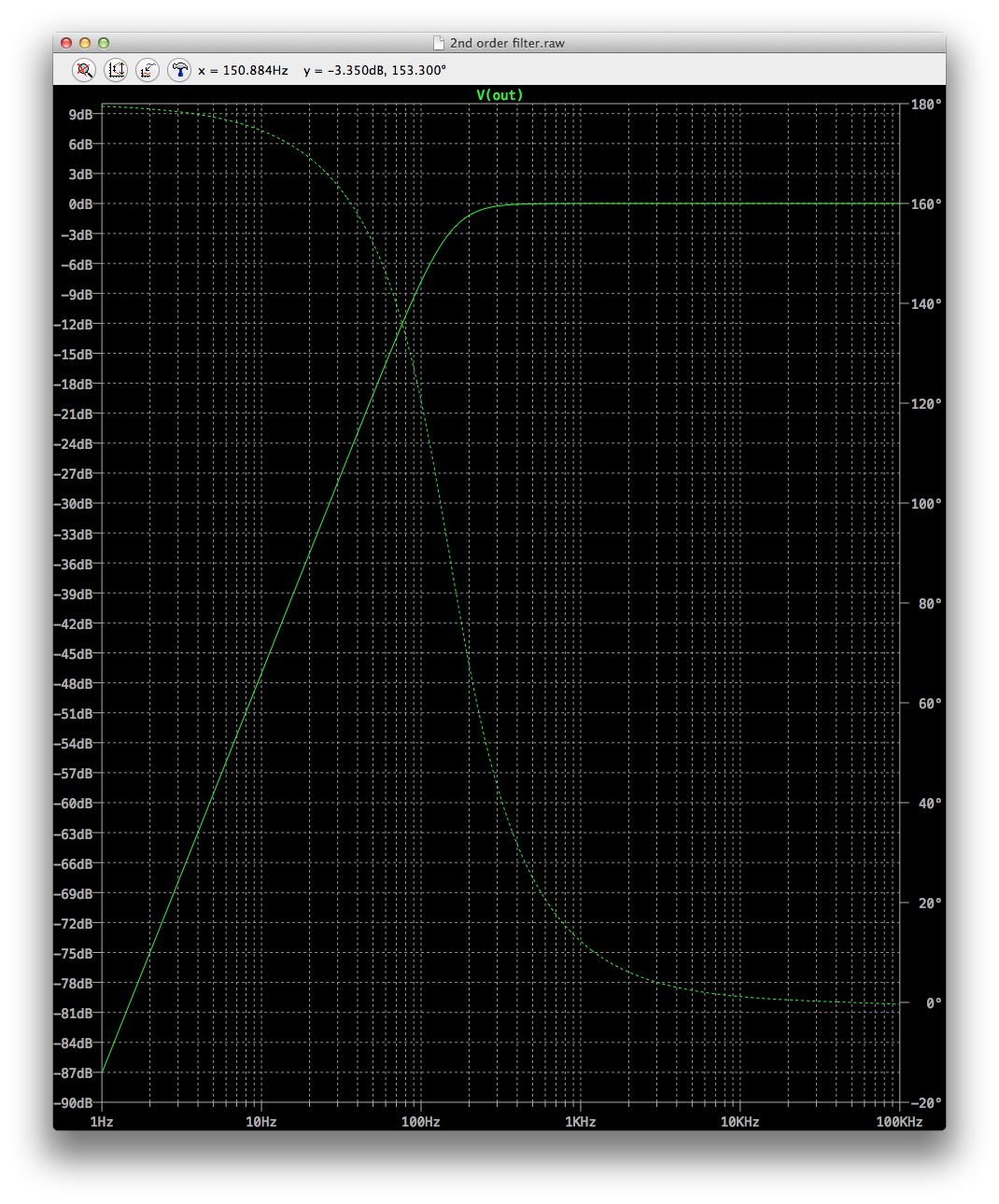

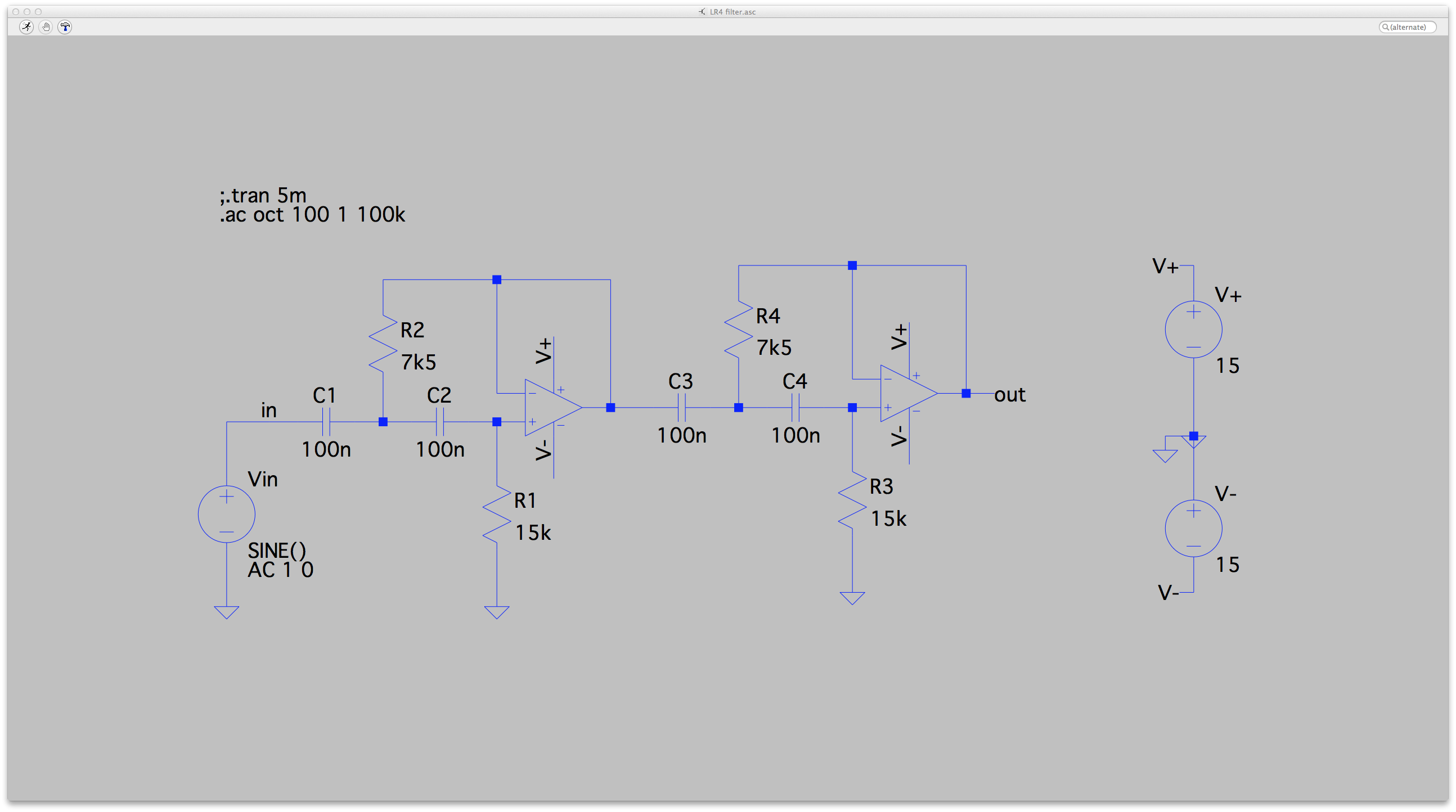

I switched to the 2nd order filter in a simulation (see attached)
And this time the formula reads:
F = 1 / ( 2 * PI * R * C )
using 10k and 100nf for the R and C, the simulation result looks like it agrees with this calculation.
I don't know how to add vertical and horizontal lines on a plot to point to the -6db in the response, so I just pointed manually to it. It's not right on the spot, but close enough to see that the frequency at that point is about 160hz.
And that's basically what I got in the excel sheet with this formula. So I suppose this is correct.
Someone can tell me how to add lines on a plot?

The graph you have attached shows lines in both directions.
Can't you see them?
The -6dB looks ~160Hz and when you go down to 90° phase it too looks about 160Hz.
That C in the RC filter is acting as a filter capacitor. it is not a coupling capacitor.
Using a poor capacitor will add distortion.
The resistor and/or capacitor ratios are not correct.
If you want a Butterworth roll-off you need a Q=1/sqrt(2) to create a B2
Two B2 cascaded give an LR4 for a final Q=0.5 and phase at -6dB = 90°
You are using the wrong formula for the 2pole filter. You have shown the single pole RC filter formula, as in post30.
Spice has used the wrong values you inserted in there to create a Q=0.5 filter and that has a ~160Hz -6 dB point but the roll off shape/rate is wrong. It is not Butterworth.
I still don't see where you got that 1+sqrt(2) factor, I think you misread the source doc, or the source was wrong.
I was referring to adding lines where needed. In this case, I would add 2 lines crossing at the -6db point to project the frequency of the crossover.
Those lines present are just the grid that I turned on.

I didn't use the 1+sqrt(2) for this latest example with the 2nd order. I used it before for the 1st order with only 1 set of RC.
This time with the 2nd order with 2 sets of RC as shown, I used that formula with only the 1 on top.
What Am I missing?

Your new formula is wrong.
F=1/{2PiRC} is for a single pole RC filter.
I took that off of an old elektor article from the french elektor of mai 1987.
And that was from the same topology as my last simulation, to which they provide that formula. I wonder what I missed there or did they make a mistake? Perhaps in the translation from the original article in english that was published in april 87, which I don't have.

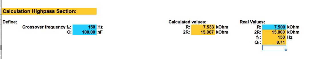

I can see now one thing that I did miss. In that previous simulation, I was looking at the -6db point, which was apparently in agreement with that calculation and thinking like it was the LR4, but it is not the LR4, it's only the SK2 2nd order that makes only half of the LR4, so I should not be looking at the -6db point but rather the -3db one.
I used that excel sheet from that linkwitz site and used that in a new simulation (attached), aiming for a 150hz frequency, which I do now see on the plot at the -3db point.
The slope should now be fine right?
I'll cascade 2 of those next and then we'll see what an all-pass and the subtraction does.

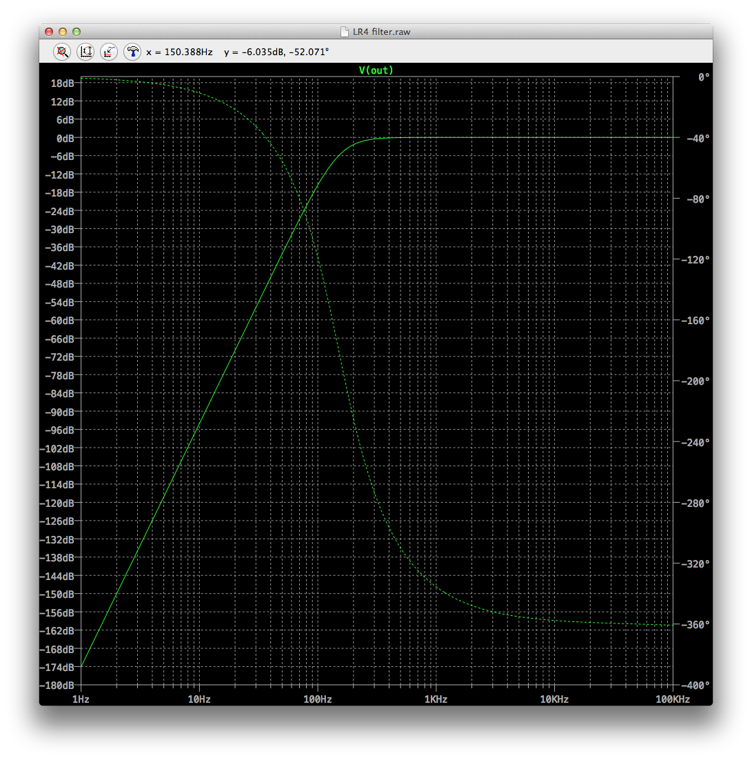

Here we go, 2 of them cascaded.
Same 150hz frequency, now at -6db.
Not too bad so far.
Am I on track now?
You now have a set of resistor and capacitor ratios that give the B2 roll-off. The formula for that circuit will be in some or maybe all of those links I posted for you.
There is an infinite variety of C & R ratios that give a B2 but the one in the sch is the easiest to get accurate ratios since identical, or 2:1, (1:1 & 1+1:1) is all you need to ensure.
