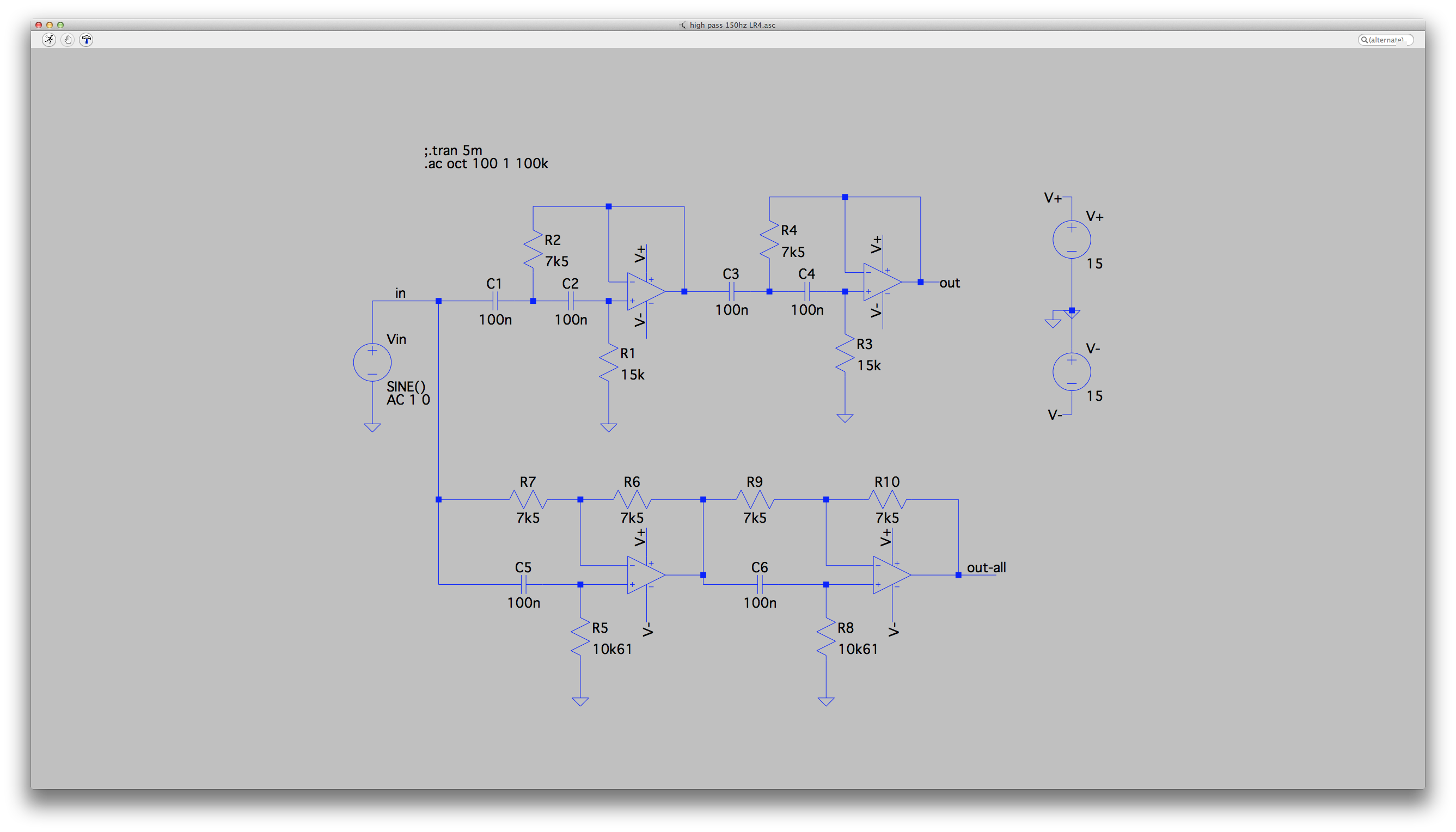

I switched to the 2nd order filter in a simulation (see attached)
And this time the formula reads:
F = 1 / ( 2 * PI * R * C )
using 10k and 100nf for the R and C, the simulation result looks like it agrees with this calculation.
I don't know how to add vertical and horizontal lines on a plot to point to the -6db in the response, so I just pointed manually to it. It's not right on the spot, but close enough to see that the frequency at that point is about 160hz.
And that's basically what I got in the excel sheet with this formula. So I suppose this is correct.
Someone can tell me how to add lines on a plot?

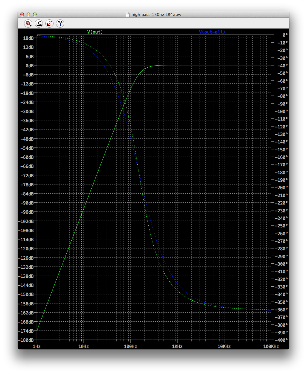

I can see now one thing that I did miss. In that previous simulation, I was looking at the -6db point, which was apparently in agreement with that calculation and thinking like it was the LR4, but it is not the LR4, it's only the SK2 2nd order that makes only half of the LR4, so I should not be looking at the -6db point but rather the -3db one.
I used that excel sheet from that linkwitz site and used that in a new simulation (attached), aiming for a 150hz frequency, which I do now see on the plot at the -3db point.
The slope should now be fine right?
I'll cascade 2 of those next and then we'll see what an all-pass and the subtraction does.
compare the curve of the roll off for these two. You will see that the lowQ version has a soft knee and the B2 has a sharper knee.
Left click on V(out)on the plot to show cursor1. A second click gives cursor 2, if needed. Then point the crosshairs onto the dotted line now visible, and move to desired point. (on LTspiceIV, anyway)
Brian.
Thanks, that's a step in the right direction, better than trying to draw a line, but I can't edit the values to point it exactly, so I can only drag it manually and can't make it exact. The values in the popup that shows up aren't editable and won't point the crosshair, we can only drag it...
You now have a set of resistor and capacitor ratios that give the B2 roll-off. The formula for that circuit will be in some or maybe all of those links I posted for you.
There is an infinite variety of C & R ratios that give a B2 but the one in the sch is the easiest to get accurate ratios since identical, or 2:1, (1:1 & 1+1:1) is all you need to ensure.
2:1 is nice and easy. I picked the 7.5k and 15k, to keep the res values fairly low. This should work and at the same time minimize their noise contribution.

I added the all-pass filter and I don't understand why I can make it match the slope of the phase response to the LR4.
From what I understand, the corner frequency is calculated with 1/(2*Pi*R*C), and although it makes for a res value that's not standard, I can make it match the 150hz corner like in the LR4. And the phase does evolve almost the same, but not quite. The slope isn't quite the same.
I read that the phase response was supposed to be the same, so I am missing something.
The 2 resistors in the negative feedback must be the same, for the flat response, and they don't influence the slope of the phase response not the corner frequency. I even tried different values there, and it doesn't change anything as long as they're the same value (R6 & R7). So all there is left in the RC combination, which brings the corner frequency properly with the values found with the formula. But then the slope isn't quite right. It's close, but not close enough.
The main challenge in this topology with the subtraction and the all-pass is the matching, and that will require good component tolerances. We can get pretty good matching using resistor networks, perhaps even make use of the highly precise divider networks. The cost climbs fast, but a compromise should be feasible.
From what I understand, the corner frequency is calculated with 1/(2*Pi*R*C),..................
That's the wrong formula.
What you have shown is for a single pole passive filter.
You are planning an active multi-pole filter.
Read ESP, Linkwitz Ti etc.

I've been reading, from more than one source, but it seems some are giving wrong info. I need the all-pass to have the exact same phase response to match the LR4 filter. I'm close, but not close enough. I took that all-pass filter and the formula from the same source, so then they must've been wrong somewhere.
I've been experimenting and varying the RC constant, to no avail, the slope of the phase shifting isn't quite matching the LR4. I did make the corner frequency pretty much match the LR4, using that formula, but it's not correct for the phase shift.

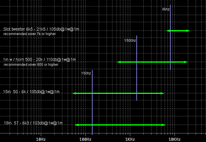

I made up a little graph collecting the data from my speakers' specs and put the xover frequencies I've been planning for, to have an overall view (attached)
Plenty of overlaps, and my choice of xover freq were also influenced by what ranges I would prefer hearing from which sprk.
