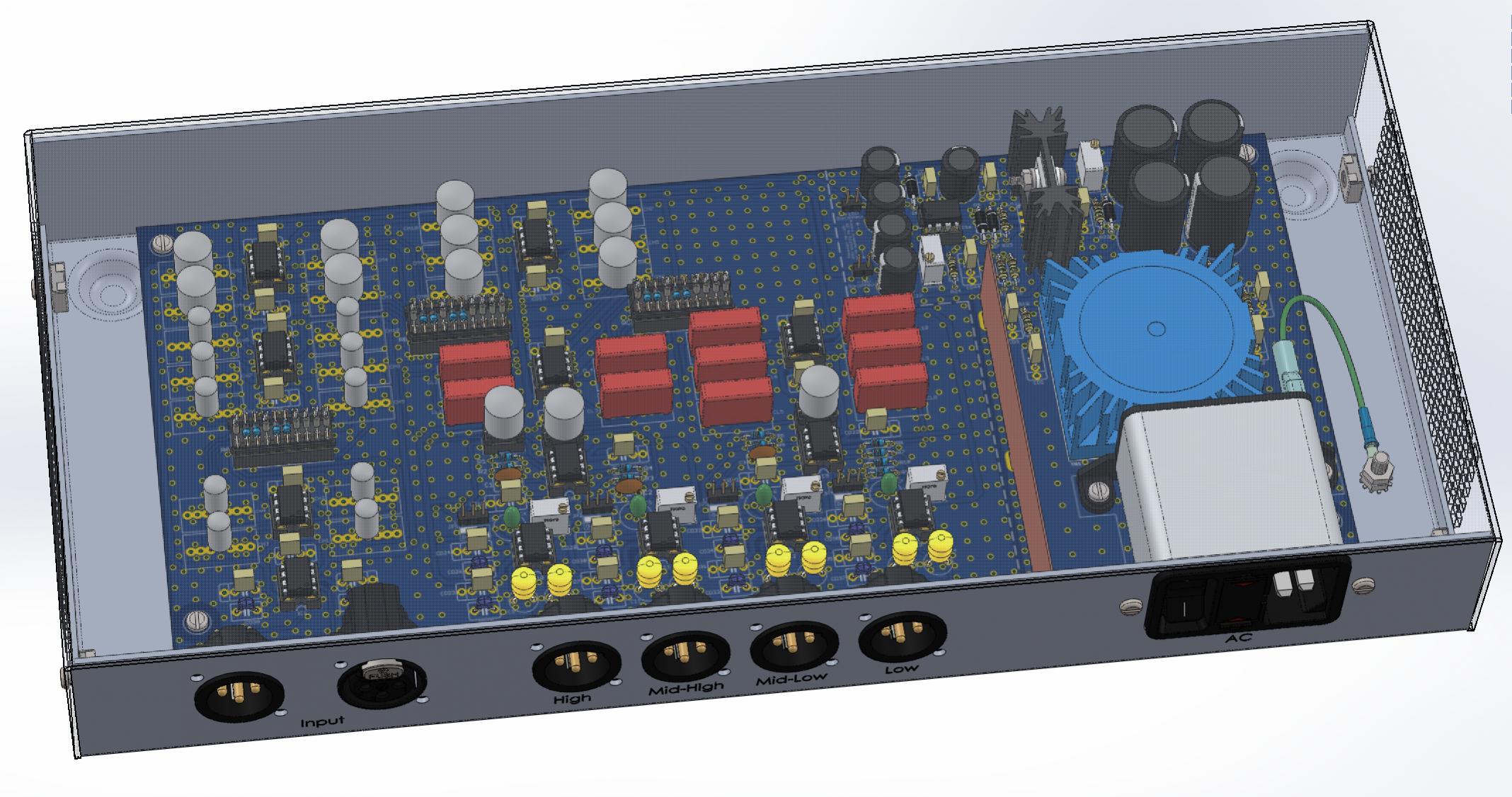

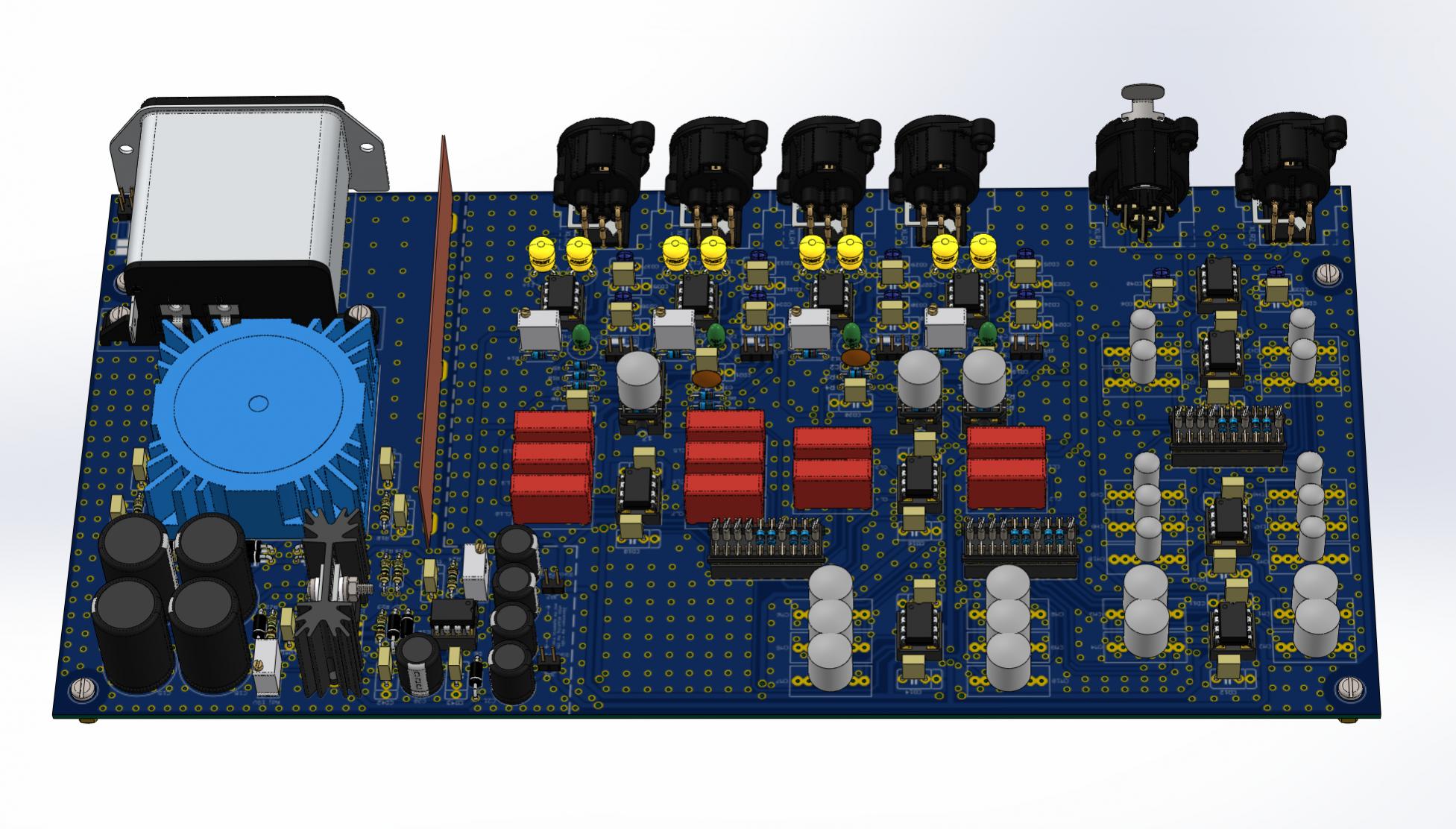

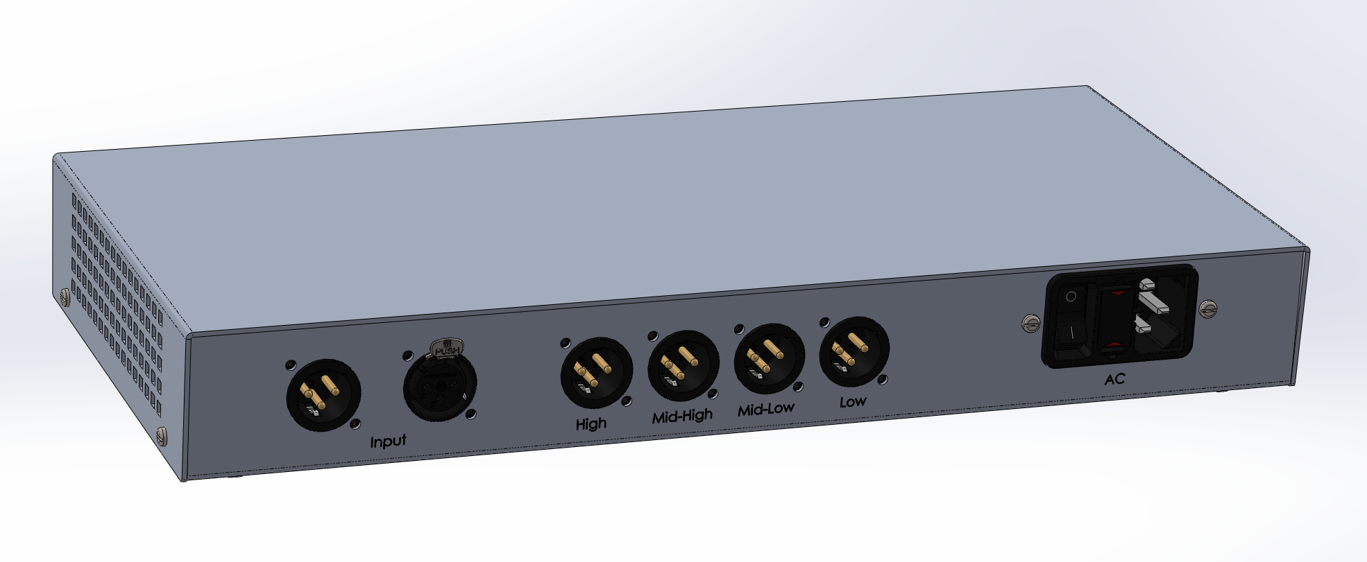

It wouldn't look too bad in a sheet metal aluminum case, especially if anodized.
I would go for black anodization.
A sheet metal case is simple to make, for a properly equipped sheet metal shop.
Case would be 2 parts, top and bottom, with just 4 screws to assemble it.
Removing the top allows easy access to everything, to tweak levels, PSU voltages, change/rotate component sockets as needed. Then close the box and no more accessible things to fiddle with that would alter how it works. No knobs or switches to touch, only the on/off switch on the power inlet module, with access to its built-in fuse in case of need.
The C14 plug allows using whatever power cord is used in the country where it's to be used, with the other end plug matching what is used locally.
And before plugging it in the first time, the voltage jumpers allow easy selection for the local line voltage.
The PSU output jumpers are left out at first powerup, so the +15V can be adjusted, and then the -15V tracking tweaked to match it. Then power it off and wait for cap discharge before putting those PSU jumpers back on, before powering up again with everything online.
Easy to check the PSU voltages with a digital meter while the jumpers are off, with the jumper pins bare, but being careful not to short them with the meter's leads while measuring.
Before plugging any amps in the first time, the proper operation of the filters should be checked and levels might be good to be set low, so they can be raised afterwards when amps are plugged in and a signal passing through.
Assembly could hardly be made any simpler and easier, with only one wire inside the case, the ground wire, which needs 2 crimped connectors.
Then it's only quick and simple assembly, once all parts have been soldered on the pcb.

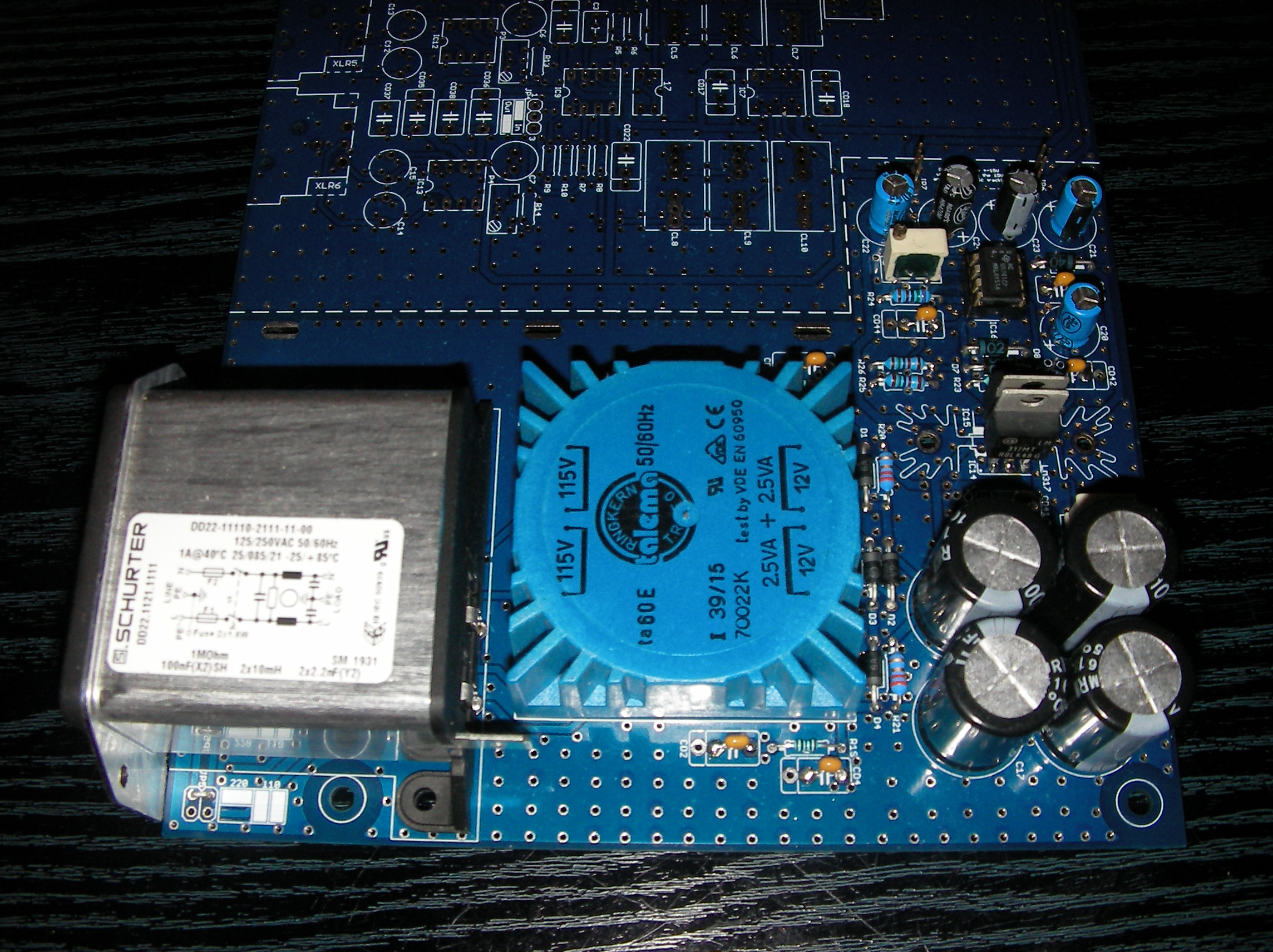

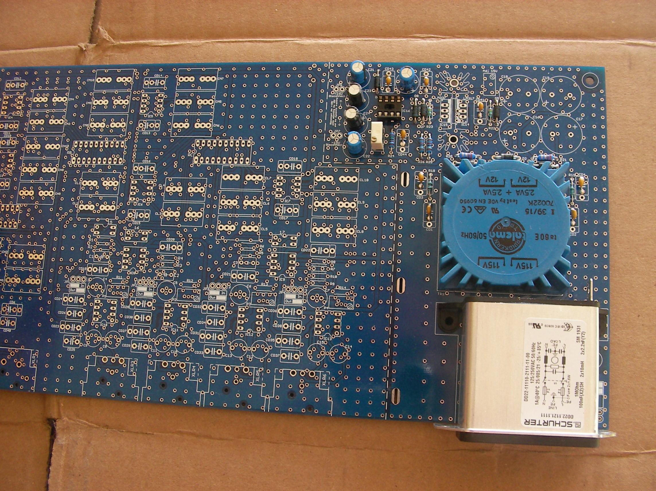

Here are a couple of photos of the pcb with most of the power supply related parts on it.
I'm missing a few things still, including the fuse drawer for the power inlet module, and hopefully I'll get this early next month, so I can finally test that part of it.
The pcb was made as a prototype and the vias aren't tented. But the next iteration of that pcb will have all vias tented and they will be smaller. The pcb will look different at that point.

I posted all the schematics and board designs a few posts earlier, about post #93ish...
One small change I do plan to make later in the pcb layout is to make all the vias smaller and tented. Other than that, I'm not planning any more changes so far. Testing might reveal something, maybe, we'll see about that. If tweaks are required, they'll be made then.
The PSU has an extra opamp to make it more symmetric in its behavior, so its voltages are staying as equal as possible all the time. The extra opamp is a tracking system to force the negative side to track the positive one.
This was done to minimize the chances for bad behaviors from some types of opamps that don't like it when their rails aren't equal. Some tend to stick to a rail when their supply rails aren't the same. The opamp I chose isn't known to exhibit that bad behavior, though others might want to build this with other opamps and having a better behaved PSU should help minimize odd behaviors.
Plus a PSU with rails tracking each other during power up and down should minimize pops and clocks...
One of the most important design goals was to avoid any loose wiring, and I think this was achieved, with only one short wire that can't be avoided, the ground wire to the case from the power inlet module. Should make it an enjoyable and clean build. I just hate wires all over the place..

SpookyDD,
I am a big fan of active crossovers - and am sure you will love the result.
I am much less sure about the PCB around that mains connector and on board transformer. You would seem to have ground fill around and under the transformer and power connector.
This need not be a big issue, but you must be very careful to have appropriate clearances between the mains traces and low voltage traces. This includes the ground.
Any fault between those mains traces and the ground fill will propagate to the rest of your system and in the case of such a fault create a hazard through the whole of your sound system being at mains voltage.
OK, that might come across as alarmist. Just looking at your layout, it would seem you have only a minimal clearance (a fraction of a mm) between the ground and mains connected traces.
If the diagrams I am looking at are correct, I implore you to reconsider connecting this to the mains!
I hope that the PCB's you had manufactured address this issue.
IEC-60950-1 and other standards give sound advice here. Most manufacturers use somewhat greater clearances to be sure.
As a general rule, I would be looking for a good 5mm clearance between the mains connected parts and any LV part. (Remember that the creepage distance for mains voltages must include transients that will be seen on the mains - for 220V mains the transients the standards consider are 800V pk and 1500Vpk for class I and II).
In your case I would have stopped that ground plane well on the "low voltage side" of the transformer.
I hope that I have not been unnecessarily alarmist - and that I have really misundersood the plots of your PCB traces.
Now you got me wondering if I left out some detail. I assume you're thinking about stray magnetic field from the transformer getting into those ground planes in the pcb below. I didn't worry about that, but that may require a little more thought. That transformer is toroidal, so far less to worry about than those legacy E-I types. I'll have to give that some thought. But I surely will find something out soon, maybe, when I flip the switch. I should be getting the last few things needed for that shortly (I hope. With the quarantine and all...)
Which low voltage traces are you referring to? The ones on the secondary side?
I think I may have to tweak some details there, to get some galvanic isolation, but the ground I'm not sure about, although perhaps a ground lifter could be inserted, but on such a small powered thingy, not sure that will do much, and I didn't worry about possible DC on the mains...
I guess that's something I need to review some more and possibly needs tweaking, with some larger isolation, for those traces. This is for 220V mains after all.
Could you point to specific areas of concern?
And not have ground planes in the high voltage areas then?
If something was done wrong, then corrective action is required and something must be learned in the process.
PS: you do love vias, don't you!
Those are meant to tie up the ground planes as much as possible, nothing wrong with that, is it?
But for the high voltage mains related area, I would welcome any input..
Should I push back the ground plane away from the high voltage area? That is one question.
But there is one spot where I don't see much that can be done: the voltage selector jumpers, which have a regular pitch of 2.54mm (.1").
There is nothing wrong with the vias - it is a feature you chose and is a nice thing.
The clearance between mains connected traces and ANY low voltage part needs to be able to withstand not only the peak mains voltage but also transients on the mains supply as these occur.
As noted above the transient standard used for commercial equipment is 800 / 1500v
You should have close to 5mm clearance between LV and mains traces.
I would push the ground fill back to achieve this.
I am not seeking to be nasty - i think this is a good looking design.
I am sure you will end up with a great XO
But there is nothing LV at all anywhere near the HV stuff, except perhaps that ground plane, so I guess that's what you're referring to.
But now I'm also thinking about something else too, with such a power inlet that pretty much insures there is a ground connection, logically the presence of the ground (earth) would be assured, but what if someone was to plug that nicely grounded power cord in a wall plug without the ground, then that earth link wouldn't be there and that would make the ground float on the device. I think I need to think some more about that aspect of it.
At least this prototype should serve to smoke out possible "bugs" or omitted safety details.
So that's something I'll have to tweak for a revised version. But for now the prototype should server its purpose to smoke issues out.
No offense taken at all, of course. This is constructive criticism and it's one good reason to post things like this on forums and share the work and whatever can be learned from it.
I'll try to re-think that HV area in the layout and tweak that ground stuff.
One other thing to think about is that extra shield I have placed between the small signal and the PSU area. It's also grounded, but now I'm wary of the grounding scheme. Will require more thoughts. And probably more tweaks there too.
I'll have to do all the tests on that prototype pcb. Hopefully not too many issues will come up.
One thing I did with the mounting scheme is to not have the ground on the mounting posts, but there is solder mask there anyway, and I had planed on using plastic mounting studs..
