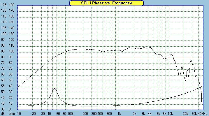

Good question.
I am not, however, promoting a complete loudspeaker design here. The baffle used in the testing may or may not be the baffle for any given application.
The impulse response is useful to determine what might possibly be baffle and what is transducer response. In this case, baffle dimensions are not infinite and might even be considered small.
Before I just assume the need for baffle step correction, I would like to see the near field response of the enclosure and low frequency transducer and then compare it to a far field response. Would you not agree that enclosure design will have some importance to determining baffle size?
Baffle step correction destroys sensitivity. I would prefer a system that does not require it.
I am open to see what may come with the W5-704, used either with or without my modifications and two-way design.

Mark:
I'm confused, how can they be time aligned without having the voice coils aligned vertically and without any sort of electronic delay?
How can the phase be so flat? If you look at the phase of the raw driver, don't the driver's raw response phase shift significantly throughout the frequency range?
For a long time I've been wanting a speaker with "just a cap on the tweeter" but I've always thought that I'll have to use some method to move the tweeter back so that the voice coils will be vertically aligned, such as using a wave guide, or at least some sort of offset baffle shape?
Every time I start prototyping speakers, I always first just throw a cap on the tweeter and try various diff. values.... Without your modifications the top end of the W5 wouldn't be nice enough for that approach to work very well, of course.
Would you discuss the narrow "beaming" directivity that we would expect to see using a 5" driver this high?
Oh! I see the SCALE that you use for the phase is far different from what we're used to seeing... THAT's why it looks so "flat". Sorry I didn't expect that and didn't look at the scale before I made my last post...

First, what application uses .FRD and .ZMA files? Is it speakerworkshop? If so, wouldn't .IMP files be better?
Second, my purpose with the phase response was to show the tweeter onset lead. This is just a little over 200 degrees. I also wanted to get this on the graph without shifting center point for the frequency response graph.
Next, voice coil location has little to do with apparent acoustic center. Somebody long ago just made this statement and it caught on. I hope that any designers out there will have stopped thinking about time alignment by location of voice coils.
Next, I missed Chuck's post when I made my last reply. The breakup or vibration mode pattern of each model transducer is unique. With a paper diaphragm, glue applications (including puzzle coat) are ineffective in controlling vibration modes. Also, for the transducer model specified, there is a clear mode at around 12 kHz. That mode may be caused by the way the plug is air mass loading the diaphragm. If this is the case (and I do not know if it is), then attempts to correct it by changing the cone may be ineffective.
Last, there should be no selling of loudspeakers made using my modification designs (including my new plug concepts). This is a diy forum and the information is supplied for the purpose of making loudspeakers for the use of the person making the loudspeaker.

MarkMcK said:First, what application uses .FRD and .ZMA files? Is it speakerworkshop? If so, wouldn't .IMP files be better?
Sure, whatever is most convenient for you, I'm happy to use Speaker Workshop, I was just wanting to take the files and plug them into some speaker simulation software while I'm here at work - I have bits of free time throughout the day between calls and I am trying to learn how to use these various programs currently. I would also like to see if I can use my little Audax tweeters, like the one that I sent you some time ago (
Audax 3/4" Textile Dome Tweeter ), since I have at least a dozen of those on hand already. The other thing I want to do with the files is: figure out which woofer I want to use with the Tang Band serving as a sealed mid. The reason I had asked for .FRD and .ZMA was to use with the PCD 6.20 excel spreadsheet, but I've also installed Speaker Workshop here too, so that's fine.
I had just failed to notice your scaling and, foolishly, thought that you had pulled of something no less than magic, in creating a simple design with very little phase shift...Second, my purpose with the phase response was to show the tweeter onset lead. This is just a little over 200 degrees. I also wanted to get this on the graph without shifting center point for the frequency response graph.
Well ~ sound does travel faster through an aluminum voice coil than through air, but, despite knowing that, I guess I thought the A.C. was further back than it is? Hopefully, before I would publish my own DIY design, I would do measurements to ascertain that the acoustic centers were aligned, either through physical placement or phase shift in the crossover.Next, voice coil location has little to do with apparent acoustic center. Somebody long ago just made this statement and it caught on. I hope that any designers out there will have stopped thinking about time alignment by location of voice coils.

Excuse me for my denseness, but how do you convert a .PS2 file to an .FRD or .ZMA?
I don't know what Christopher's point of reference is, but the phase response of my simple two-way design is excellent. More important than the phase response is the impulse response. That is the test that is important.
There are also negative consequences to equalizing to correct for change of space loading when the baffle ends. Transient response and "phase" response will become worse, particularly for onset performance. If the enclosure or eventual system design would benefit from equalization, then do so. It is not clear that BSC is the best technique or assumption for determining the correct amount, order, or shape of equalization.
Mark

Whilst I agree with your second point that applying a blind 6dB of BSC is not the most informed way of doing things, I would also say
your first point does not seemed the most informed. In a small box
the "onset" will rise ~ 6dB between 150 Hz and 1.5khz far field :
There is nothing in the hemispherically loaded response that
suggests BSC will not be needed. Which goes back to the
original question ? the responses shown are flat farfield
which leads to the assumption of a large test baffle.
I can see why people prefer to ignore BSC, "throwing" away 6dB
seems like sacrilege, but it is sticking your head in the sand IMO.
🙂/sreten.

sreten said:Whilst I agree with your second point that applying a blind 6dB of BSC is not the most informed way of doing things, I would also say
your first point does not seemed the most informed...
"It is not clear that BSC is the best technique or assumption for determining the correct amount, order, or shape of equalization."
I think that's Mark's key point in regards to the BSC discussion; saying Mark does not seem "informed" is amusing, but probably not accurate.
I also think that using resistors is not a preferable way to address the baffle step issue. My choices would be: enclosure design and driver(s) selection, and, lastly, in the crossover design (but not with resistors).
I agreed with the second point. I disagreed with the above.
Its simply wrong, for the reasons stated. I do not really care
whether people "dislike" BSC in principle or not, but stating
myths exist about BSC and then effectively stating a myth
about BSC does seem to me an "uniformed" opinion.
TBH I think Marks bag is improving drivers, how they are used
is a different issue. Personally I think the best approach to
BSC issues is at line level in the preamplifier, or an
equaliser between pre-amp and power amplifier.
🙂/sreten.
Please people, there are rules to valuable argumentation. The idea is to reach a more informed perspective. When you allow participants to start arguing against the person instead of against their arguments you have failed.
Baffle step exists. Baffle step correction does not exist. What is termed baffle step correction is simply equalization. It does not matter whether you equalize speaker level or line level.
The use of the term "field" is problematic. It is used, for example, to denote types of measurement. You can measure either near or far (or anything in between). It also seems to have generalized to mean other things.
We can talk about the direct and reverberant or ambient sound. Direct sound is not effected by baffle step. Ambient sound is. Ambient sound is also decay sound and not onset. Equalization effects both. If you equalize for the ambient sound and the direct sound does not need it, then you make inaccurate the direct sound.
Also, if you have chosen a ported design (this includes the new age tuned TL designs) and you provide low frequency equalization, you also upset the tuning. I would advise including expected equalization in the tuning for the vented loudspeaker. It seems to make sense to me, but I have never seen any online contributions where this is done.
I will not label people as "idiots" and other derogatory terms, but I also know that it is not productive to argue with people who are dogmatic in their beliefs.
I would like to try something new. Can we talk about the benefits and disadvantages of designing a loudspeaker that will minimize baffle step? What about in-wall mounting or shallow enclosures mounted on the wall?
We can also add a bass module. The two-way design I presented using the modified woofer is of sufficient quality to justify the added expense of bass augmentation despite the inexpensive cost of the two-way design. This will also decrease low frequency distortion.
My reason for returning for one last time to Tang Band transducers was because the W5-704 comes close to being wide band and not needing bass augmentation. It can certainly benefit from it, but compared to four-inch full range applications, it is listenable without.
Mark
Mark
My only point was you should not simply ignore BSC if you are
after some sense of ultimate accuracy. It should be factored
into the design like the other variables and can lead to design
choices (e.g. a wide baffle) that might otherwise not be taken.
FWIW I have no interest in simply disagreeing with someone on a
personal level, I do not have the opinion everyone has a right to
hold an opinion even if it is wrong, technically speaking with the
correct terminology there is usually one way of looking at it correctly.
Your other assertions do not necessarily follow :
You say direct sound is not affected by baffle step, this is only true
nearfield and does not apply to typical farfield listening positions,
consequently applying BSC is not fundamentally flawed.
This seems to be a fundamental difference in the way things are
described. What I disagreed with previously also implies that BS
does not affect the direct sound. As far as I'm concerned if the
direct sound in the first wavefront (and everything else for
~10ms in room) it is undisputed that it is affected by BS,
as anechoic or freefield measurements show.
(See Seas site for drivers measured in boxes and the BS)
You say BSC does not exist but BS does. BSC is the part of the EQ
due to BS and I cannot see any point describing it any other way.
(C= compensation not correction, BS cannot be "reversed")
I do not understand your assertion EQ upsets vented and TL tuning.
Typical narrow baffle BSC affects ~ 150Hz to ~ 1.5KHz and has no
effect below say ~ 100Hz. Bass alignments are unaffected.
I've got no axe to grind. If one does not want BSC in a speaker,
the direct drive and simple crossover appeals, then fine but there
are inevitable consequences to that choice to be considered IMO.
As an example the "Ariel" design chooses to ignore BSC fairly early
on as the ~ 92dB sensitivity is part of its fundamental specifications.
Many builders seem to be very happy with it, though nowhere is
it pointed out to the prospective builder BS has been ignored.
My opinion is that it should pointed out and left to the prospective
builder as to whether they accept that design choice or not.
At the least point them in the direction of :
http://sound.westhost.com/bafflestep.htm
🙂/sreten.
