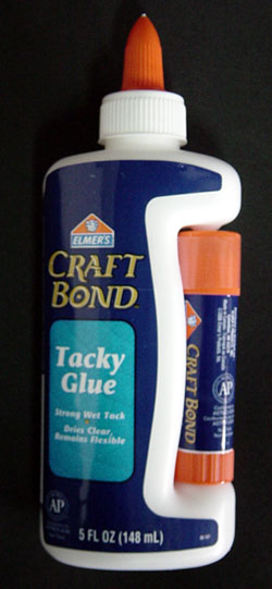

I completed performance work on the transducer but never wrote it up. That will take a little time. Until then, I present the simple details for the basic modification.
There are three glue rings applied to the cone. For this modification you may use even Elmer's Craft Bond. The typical applicator tip opening on a bottle of Elmer's is 1.5 mm in diameter. This is a good diameter for the bead of each glue ring. As the glue dries it will settle and spread out just a bit.
The center glue ring is placed 5 mm in from the surround inside trim ID. (This is a very easy reference point on the front side of the cone.) Allow this first ring to dry. Then apply two additional rings inside and outside of the first. One wet edge of each new glue ring should just touch the now dried glue ring.
The dust cap is replaced with a simple cylinder plug. Diameter is about 31/32 inches. The cylinder is 24 mm tall (about one-inch). A very simple shape.
As I prepare the modification document, I will also recheck the design. This may result in refinements. If so, they should be easy to implement. The document will include the usual stock and modified performance comparisons.
Mark
Mark

I got some W5-704D when I ordered some during the D.O.T.D. $15 special a couple months back. They're not shielded as are the ones shown on the Part's Express page.
You said to use Elmer's Craft glue? It's different than the standard Elmer's White glue I guess? I went to a couple stores, didn't find it, think I'll have any luck finding some at Wal-Mart? Or would I have to go to somewhere like Hobby Barn?
Any particular reason you used that one instead of the GemTac that you used before?
