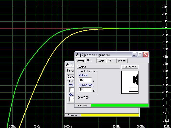

A well stuffed sealed box (+sub?) is probably the best bet.
For Vas = 12L a 15L vented box can work but its not ideal,
going larger does not help much. Might suit a (ML)TQWT.
🙂/sreten.

Dan, why don't you point out this thread over on htguide? A lot of the members there are cool and they should see this thread. Unfortunately, one of them [members] and one of the admins are both very lame and as a result I can't post there anymore.
Thanks to Sreten and dineubic for the postings about enclosures. Have the sealed or ported designs been made? If so, are there any near field measurements of performance? Same question for the TL design. The enclosure aperture and transducer are far enough apart that near field testing will produce good isolation.
By the photos, the TL enclosure has been made. Dineubic, did you want others to follow your TL design? If so, did I miss the needed details in your posting at the other forum? If not, would you be willing to post details here and there?
Also, the tests you published at the other forum lack certain performance details for the transducers already established by others. Can you test with more resolution? Would you include impulse responses for your loudspeaker design?
