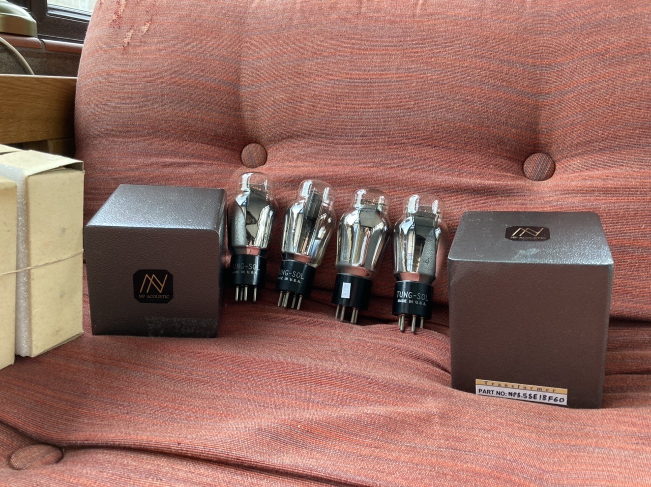

For your knowledge I have all sorts of transformers with all sorts of cores and I have no conflict of interest......
Here below my last buy. Again, you are wrong.

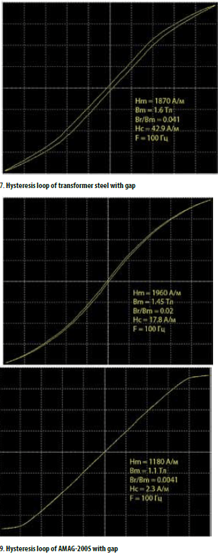

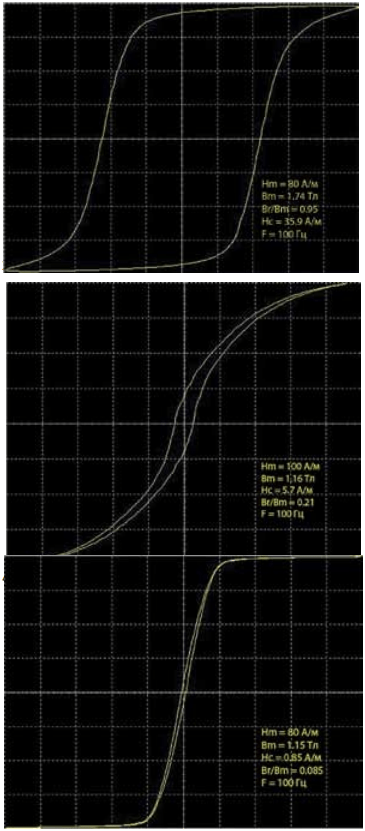

This happens:With gap, the area of the loop is easily 10-20 times smaller. Sometimes even smaller.
About nanocrystalline core. This is not about permability, core losses ect. but about B-H curve which nonlinearity directly affects distorsions.
Here is comparsion of B-H curves of:
- annealed cold-rolled transformer steel steel (0,3 mm)
- amorphous iron-based alloy
- nano-crystalline alloy AMAG-200S series MSTAN (russian 🙄 flat foop type nanocrystalline material)
without and with gap accordingly:
View attachment 1165524 View attachment 1165527

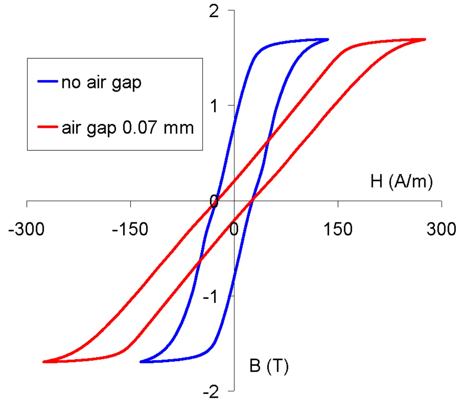

Histeresis loop indeed flatens with air gap as show above but final effect isn't the same. As core loss is proportional to loop AUC there is no doubt that core loss is the smallest with gapped nanocrystalline core.
That is not the practical case. In the practical case of SE amplifier, only 1 quadrant is used and Bdc>Bac ( plus, Bdc + Bac < Bsat) so the area for the AC loop is already more than 4 times smaller than that at the lowest frequency ONLY! Smaller and smaller as the frequency goes up.This happens:
0.07 mm airgap I never used it in output SE transformers except in tiny 2W transformers with primary impedance of 10-12K with small dc currents around 20mA. Easy to get with EI laminations in the form of distributed gap by interleaving the E's and I's. Hard to get with C cores with simple tools. But it actually proves my point about using an oversized core with tiny gap.....
The article linked before shows a large difference between gapless and gapped because a more appropriate gap has been used.
Indeed, so much less loss for nanocrystalline materials. In practice the airgap will be a lot bigger but even then 0,07mm is also very easy to do.Histeresis loop indeed flatens with air gap as show above but final effect isn't the same. As core loss is proportional to loop AUC there is no doubt that core loss is the smallest with gapped nanocrystalline core.
Btw indeed because Bdc you only use a part of the BH loop but your ironloss dos not starts at B=0T.
0.07 mm for the transformer of this thread is inappropriate. It is 0.5 mm for now. Quite a difference!
