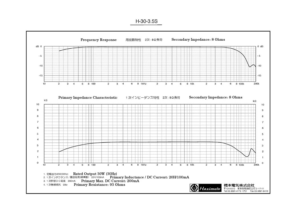

It says " Unfortunately, the non-magnetic gap destroys the main advantage of amorphous and nanocrystalline - the high permeability. It becomes exactly the same as steel, and even lower (sic!)...." Then he asks if it makes sense to use nanocrystalline and amorphous for SE amps at pag. 93 as you ask. Right, he is asking if it makes sense....he is not asking lets see how better it is! Unfortunately the comparison is made on a generic "same permeability" at 100Hz where the importance of the core is already much lower than 20 or 30Hz. No core in HiFi output transformer will run at 1.6T at 100Hz because that means it cannot go lower for the same power! Unfortunately, again, power loss is proportional to induction.... Pointless!!!
He is forgetting that in properly design SE transformer there is no zero crossing, and there is a minimum DC inductance by design that is already more than enough for small signal. So the fact that inductance for small signal stays the same for the other 2 cores is very little consolation, especially if we are talking about triodes that do not suffer lower anode load for small signals (no higher distortion). If the inductance of steel core at 10KHz is 10 times less as the author says, is it a problem? If the low frequency inductance is 40H, then this would become 4H at 10KHz. The inductive reactance would be X= 2*pi*f*L = 251 Kohm....the core is irrelevant.

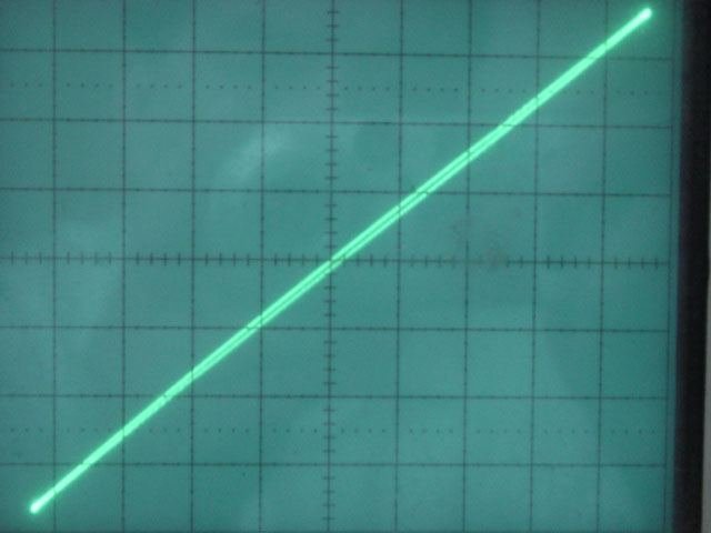

Below one picture shows frequency response and the relative reflected impedance of a good quality steel core transformer (Hashimoto). It's DEAD FLAT from 80-90Hz to 30 KHz, except at the extremes and it is not finished; the other picture is the actual hysteresis loop of steel gapped SE transformer (Tamura) when properly used within its limits.
If one has to use a substantially bigger transformer for the same job it will be more difficult to get the same behaviour at higher frequency because the core is the least of the problems!
Finally, he really needs to use funny probe signals, that have no place in musical signals, to show any difference because with the normal ones a difference cannot be seen. It looks like all the advantages of phase distortions live in the radio frequency range and more of the same useless features.......bla bla bla
As I have always been saying, for years before this thread, these low loss, high permeability cores are useful in PP amps. Physics has not changed, things have not changed.

Fochenkov: ".....the operating bias current in the SE takes the operating point from the problematic zero to a very linear section.".....(p.93).
You say: "He (Fochenkov) is forgetting that in proper design SE transformer there is no zero crossing....."
Maybe you understand how fruitless it is to discuss with you when you simply don't read well??
Yes, high permeability cores shine in PP applications, but that does not mean "by definition" that these cores have no merits in SE as well, as Fochenkov points out and our ears tell us.
I said that there is no zero crossing (we agree) AND there is a minimum DC inductance that is already more than enough. You are not even good at nitpicking....
