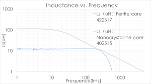

Finemet (nanocrystalline) is developped being high permeability, low loss material as an alternative for the older well known materials like permalloy.
Permalloy (in different grades) has nickel as main material content. Nickel as raw material is rather rare and therefore much more expensive.
Law of economics play their role.
maybe was used in audio by same esoteric properties 🙂
this is why I think this is a good thread, we can read different opinions about sound with this core
For high-efficient low-loss switching power supplies and inverters (e.g. wind/solar), often as replacement for ferrite.I do not know why Finemet was developed.

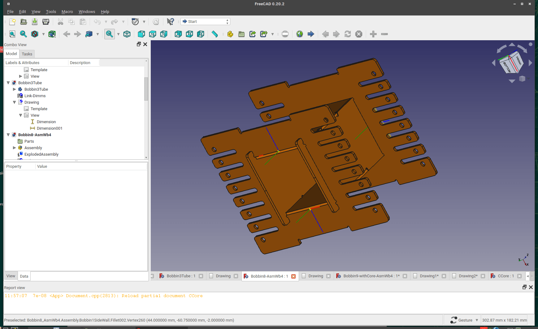

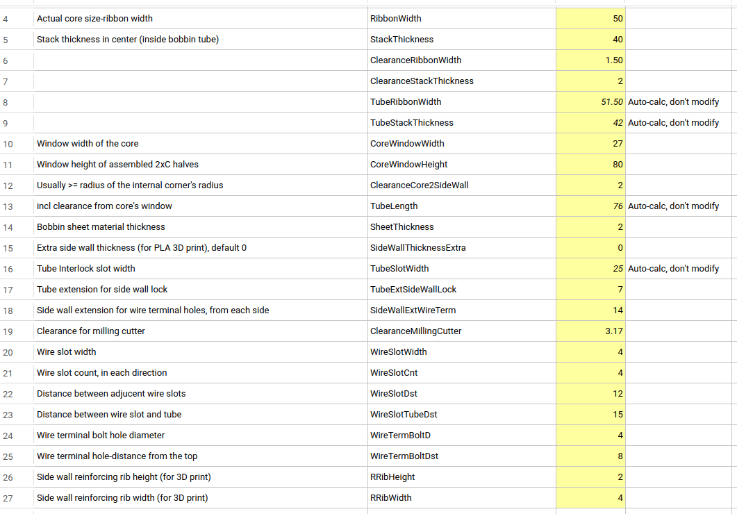

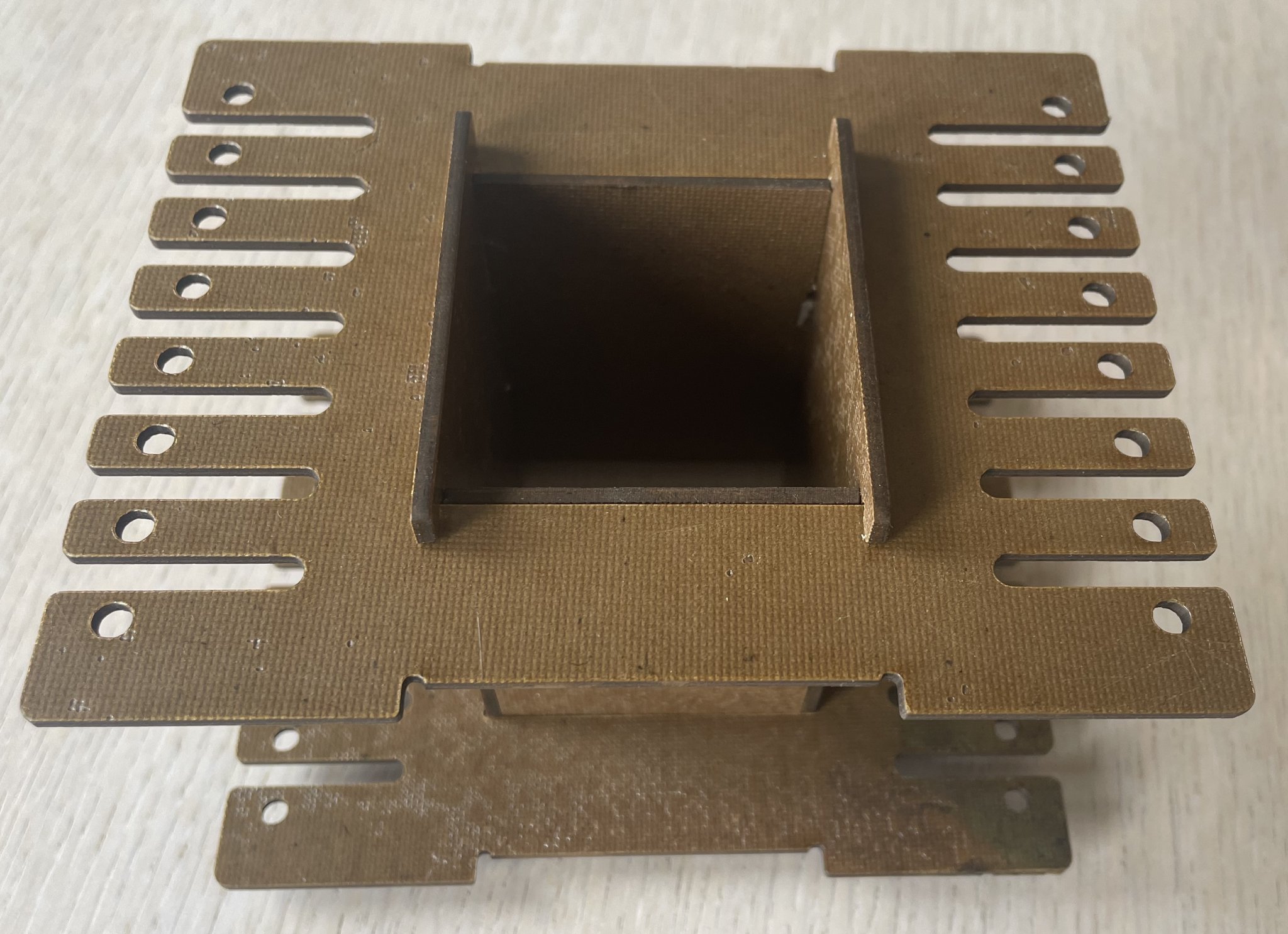

I made a freeware bobbin design tool with FreeCAD where you can enter dimesnions and get source files (DXF/SVG/PDF/STL), ready for milling, laser cut or 3D print. Need some spare time and few days to make a video instruction on Youtube.I've made quick test with 40 turns without gap because I need to order custom bobbins for this CC-400 cores (already decided to this size).
Awesome! Can you share this?I made a freeware bobbin design tool with FreeCAD where you can enter dimesnions and get source files (DXF/SVG/PDF/STL), ready for milling, laser cut or 3D print. Need some spare time and few days to make a video instruction on Youtube.
Yes, in a few days, need to make video manual on Youtube.Awesome! Can you share this?
while we're on the subject of the bobbin - does bobbin material (dielectric constant) makes any siginificant difference? FR4 has value 3.9-4.7, PTFE about 2 but probably isn't as strong as FR4
I don't think capacitance 1st layer - core will make any significant difference in this particular case. Go with 2.0 - 2.5mm FR4.while we're on the subject of the bobbin - does bobbin material (dielectric constant) makes any siginificant difference? FR4 has value 3.9-4.7, PTFE about 2 but probably isn't as strong as FR4
Effective capacitance depends on the voltage between core and the first layer. If the first layer is a primary layer with high ac potential the dielectric properties of the bobbin are worth considering but you can forget about teflon, pure teflon is too soft, and with the high amount of glassfiber needed to make it mechanical usable it will loose the dielectric advantages. Look at polypropylene or polystyrene instead. Those have better dielectric properties, but offçourse they can not compete with the mechanical or thermal properties of FR4.
It just came to me, If you know how to make a bobbin out of a flat panel, you could make the sideplates out of sturdy FR4 and use the translucent part of a CD case (polystyrene, Dk ~2.7) for the inner parts that are against the core and hold it all together.
