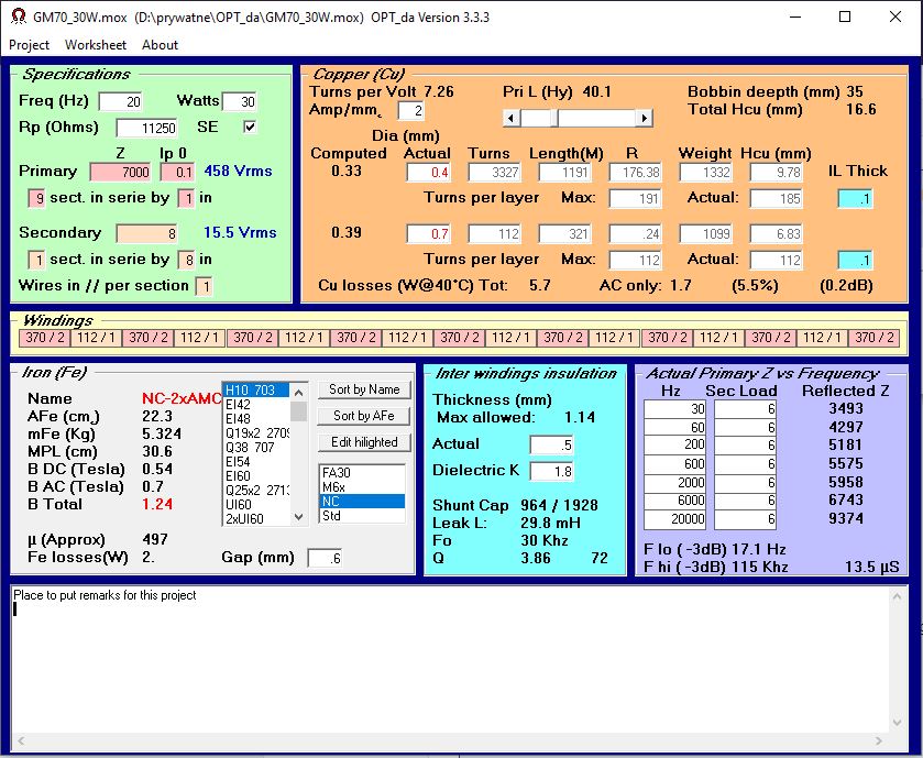

Ok to left behind distortion issue and back to my uncertainty lets take Bdc=0.3T and Bac=0.5T => -0.3T < B < 0.8T.
Is it OK for SE OPT to allow zero crossing?
I'm asking because potentially I'll move to GMI-30 tube (Rinternal=3.8k Ranode=15k Ia=100mA) and its hard to find sweet spot.
Because your zero is Bdc and hysteresis (here a straight line with very good approx., thanks to air-gap) develops symmetrically around it. In a SE OPT you only have one quadrant to work with. So negative values are not possible and you will get an anomalous behaviour at the origin (no zero-crossing). Your hysteresis will be "squashed" on the opposite side of saturation and that generates quite some distortion too. It will become symmetric again when Bac is smaller than Bdc which, for this transformer, can only happen increasing frequency.I'm sorry but I don't get it. In the situation I described (Bdc=0.3T, Bac=0.8T, Bsat=1.2T) I'm not reaching core saturation ( -0.5T < B < 1.1T ) so what is the reason of this high distortion?
I wish it were so simple because SE output transformers could be much smaller for a given application.
If your Bmax= Bdc + Bac is 1T, then Bdc for 100 mA should be no less than 0.5T, better if a bit higher.

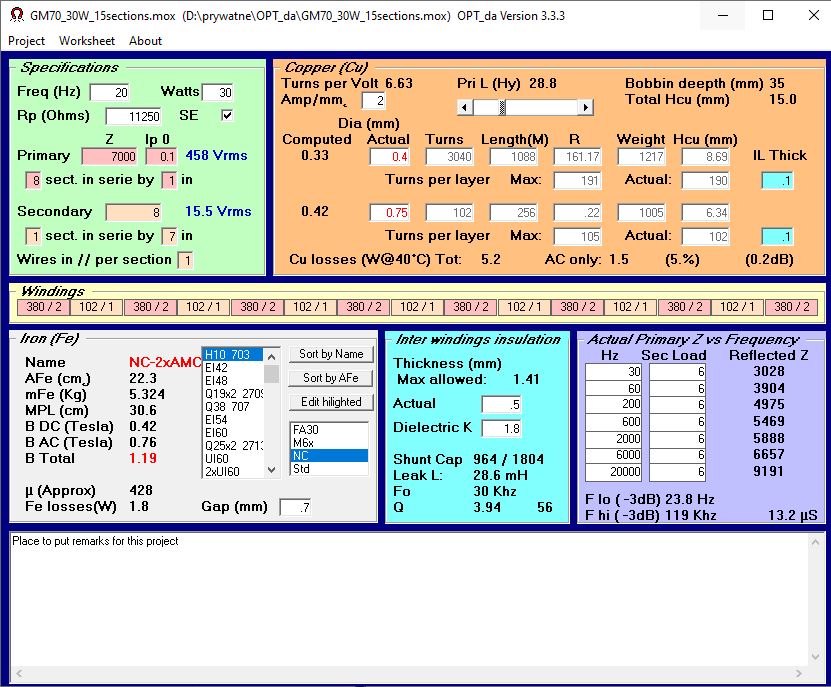

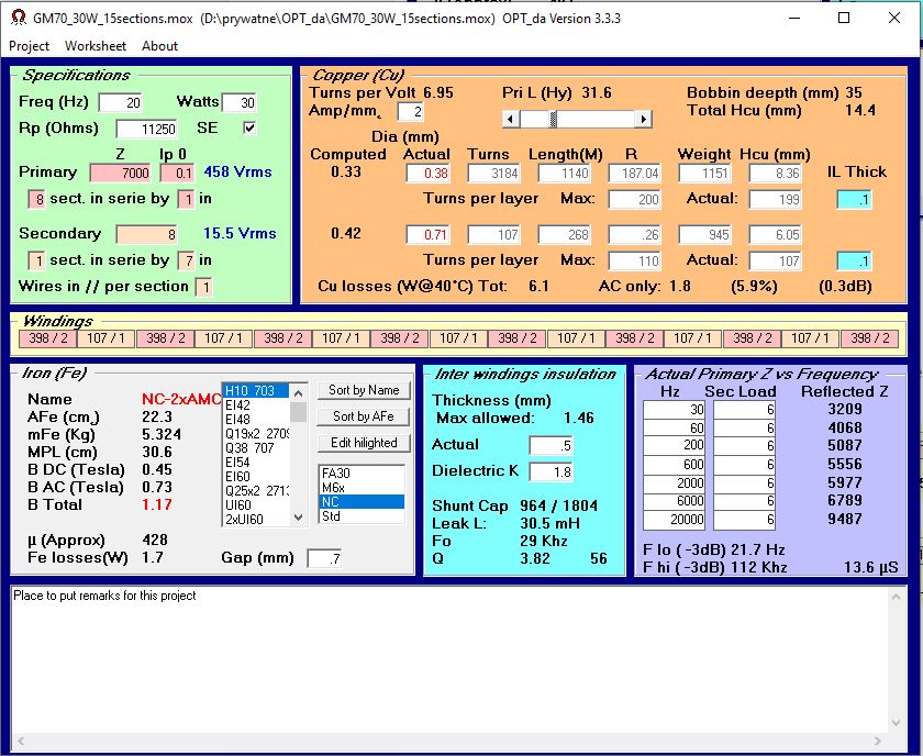

Is it good idea to move some layers from outer primary sections to inner ones to balance C and R of this sections?
eg:
from:
CORE - 4L (P) - 1L (S) - 4L (P) - 1L (S) - 4L (P) - 1L (S) - 4L (P)
to:
CORE - 5L (P) - 1L (S) - 5L (P) - 1L (S) - 3L (P) - 1L (S) - 3L (P)

At first glance, I would rearrange the primary to start and end with 3 primary layers.
If space and other consideration allow you migth consider
Core -2L(P) - 1L(S) - 4L(P) - 1L(S) - 4L(P) - 1L(S) - 4L(P) - 1L(S) - 2P(P).
Starting and ending with half of a midsections ampere windings would reduce leakage inductance to 1/4 .
At the same time it would offcourse increase P-S capacitance wich, if possible, could be counteracted by increasing P-S isolation.
8 P-S isolation layers instead of 6 would offcourse increase P-S capacitance and/or total winding heigth wich may be unacceptable.
If i, for whatever reason, would have to go with 3 secundary layers i still would always try to flank every secondary with half of the primary winding each side first, and only abond it if p-s capacitance and/or resulting undesirable Q dictates otherwise.
My first choice:
half (section) primary amperewindings - full (section) secondary Aw - full (section) primary Aw ...a.s.o.. ending in half a sections amperewindings.
