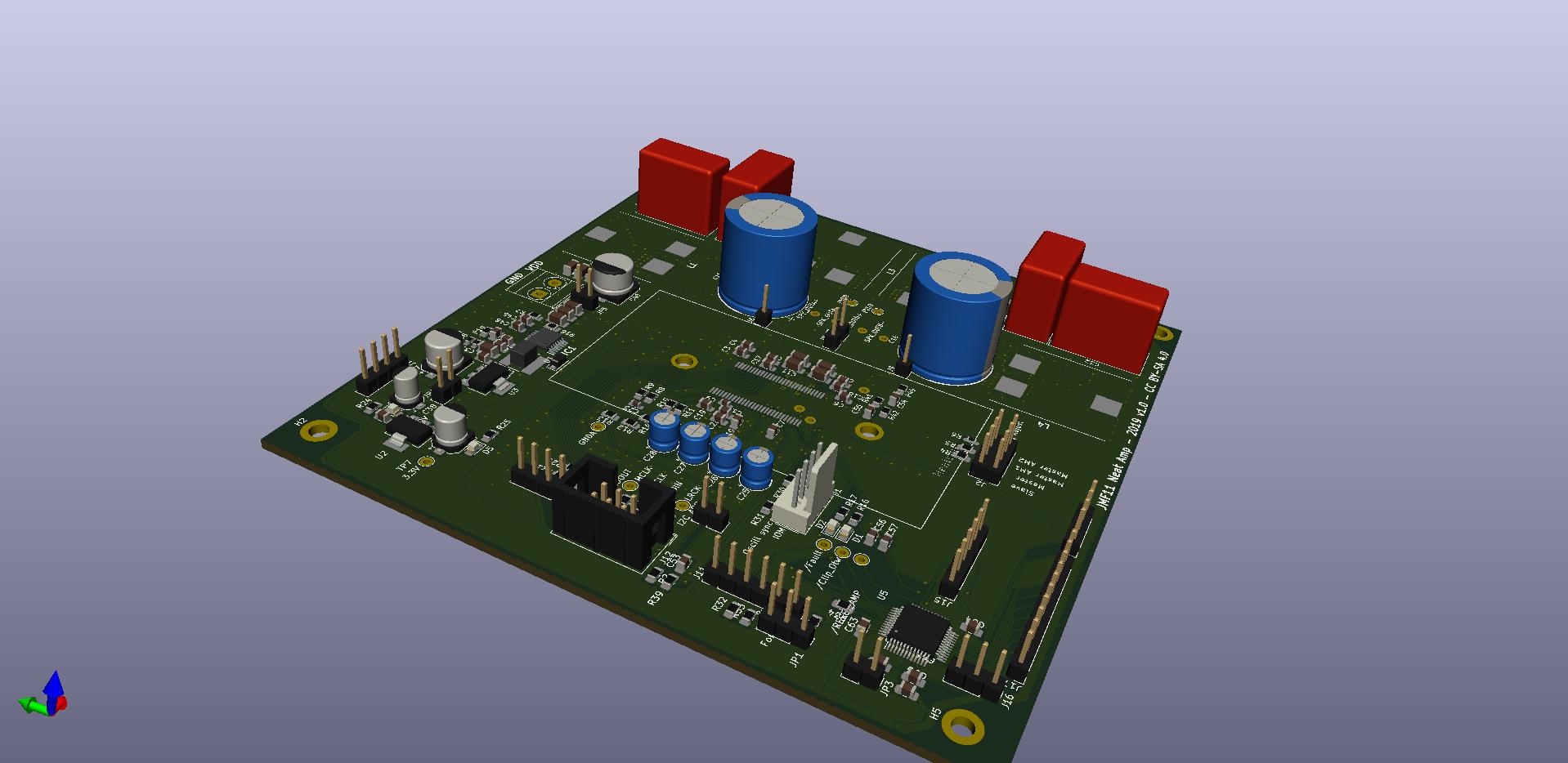

After some thinking and homework, here is the schemqtics of the TAS3251 with an on board micro-controller to allow for an versatile amplifier with I2S input.
The chosen uC is a stm32F030C8T6 chip (0.83$ and JLCPCB basic part).
The uC will be able to perform Master or Slave roles. In master role:
- board Power ON sequence: /RESET_AMP after sufficient delay after power reached a sufficient level,
- board Voltage monitoring: /RESET_AMP in case of insufficient voltage (about 20V for ex),
- board FAULT management: /RESET_AMP after FAULT
- Power OFF sequence: /MUTE and /RESET from a GPIO state,
- DSP registers programming of local board and slave boards,
- Volume management via board pot and update of volume registers with I2C for local board and slave boards,
- Software Mute function (via I2C).
Basic conf:
  • Connector: I2S (MCLK, SCLK, LRCK, SDIN, SDOUT)
  • Connector: I2C (SDA, SCL, GND, 3.3V - Grove pinout)
  • Pin Header: ADR, RESET_AMP, DAC_MUTE, FAULT, CLIP, GND
  • Pin Header Fred Adjust
  • Pin Header: Volume by external pot (+3.3V, AI, GND)
  • Pin Header: 9xGPIO (9xDI, GND) for various purposes
  • Pin Header for uC programming (same as pinout as ST-Link)
  • Jumper for ADR
  • Jumper for RESET_AMP / Reset controlled by uC
Additions to be populated if needed:
  • Connector: Oscillator Sync Interface (OSC-IOP, GND, OSC-IOM)
  • Pin Header: additional I2C
  • Pin Header: Aux Power 3.3V, 12V, 15V

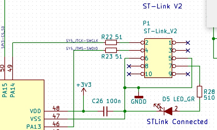

STLink
Great !
An alternative (or complement) to using a SWD pinout for the STLink could be to use the pinout of the cheap STLink V2 adapter (2$ on Aliexpress or Ebay) and to use a 2*5 pin 2.54 header on your pcb. This will allow you to connect your board through a firm and reliable flat cable which provide much better connection than ‘flying’ wires between the board and your STLink adapter. This may be particulary relevant in a class D power amplifier environment.
And this may also help DIYer playing with your amp without being equipped with a Nucleo or Discovery board to use as a STLink.
The new STLINK V3MINI ( STLINK-V3MINI - STLINK-V3 compact in-circuit debugger and programmer for STM32 - STMicroelectronics ) is very interesting too. Cable and connector are 1.27 pitch.

Hello,
About the price of boards, I had prtoposed the below thing. Still no intention to propose fully assembled boards.
To look if there would be some interest.
My intention is to have a set of 10 boards manufactured at JLCPCB with as many as possible components fitted. This would exclude "expensive components" like the TAS3251, coils, all through holes, connectors, headers... and some of the SMD.
I think that I would have 5-6 boards left. Would there be some interest if I was selling them about:
- Real cost rounded to the next 5€ (should be about 10 or 15€) + shipping to the person if booked now,
- Double manufacturing price + shipping to the person once tested and demonstrated as working.
This would be a board where about 70% of the components where already there, with some remaining SMD and Through Hole to be procured and soldered.
If interested, please let me know.
JMF
Remaining components would be the TAS3251, Wurth 7443631000 coils, Elna SILMIC II, EGPD500ELL242MM30H, B32652A3684J, Wuerth_74404064151, Heatsink, terminal blocks, pinhead headers, and few 0805 and 1206.
Can do the deytailed remaining BOM if some are interested.

OK will update for the STLink V2 adapter.
JMF
