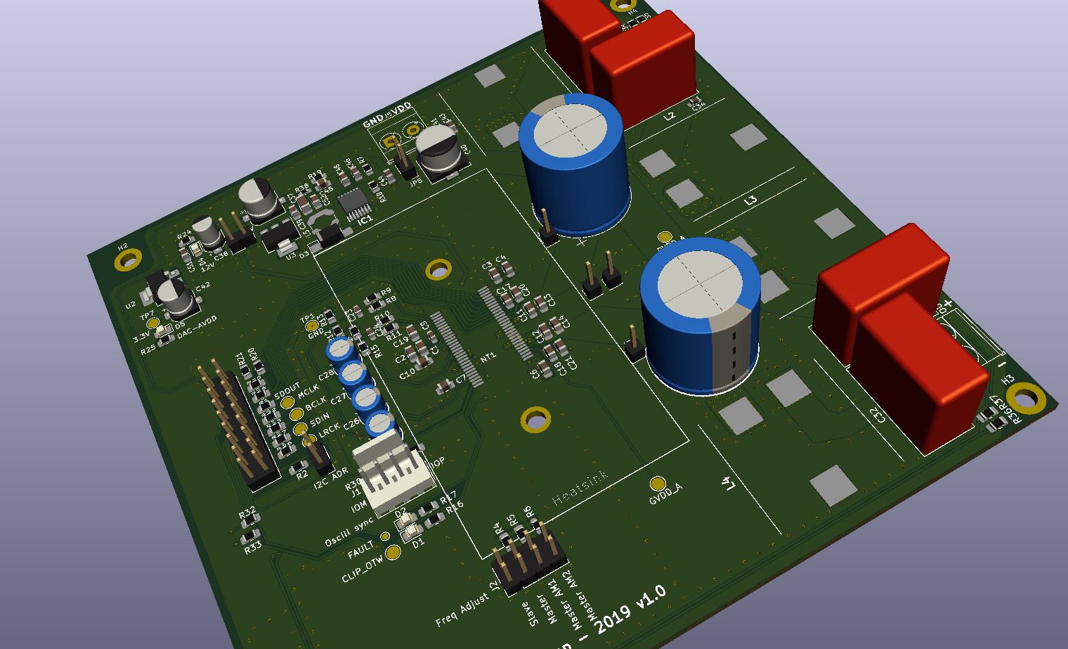

Hi all,
A small update here. After a loonnng summer, and lot of professional workload, a forced break helped move forward with this project.
I had some support from Doctormord and Voltwide to identify design flaws and possible improvements. I did my best to implement their advices. I double checked the things, and I'm ready to go to manufacturing. Time to jump now 🙂
The design intends to be compact, still cost effective for a DAC/DSP/Amp integrated option, with audio grade components (Wurth coils, premium/good caps, TI EVM level design).

GVDD_A testpoint breaks up the GND-fill alot, i'd put all testpins on the bottom side to have shortest connections. I'd recommend a testpoint with integrated VIA drill to have some sort of "locking" to the probe.
The DSP code needs almost no processing power, the most simple 8 bit micro can do the job. A board with wireless connectivity and an I2S bus would really add value. Something like a Raspberry Pi Zero W might be a good candidate. Maybe even a ESP32 would suffice. If you only need the bare basics to load the DSP code and control volume registers something like a Arduino NANO is okay. All options require quite some code for a full working solution.
@Doctormord: thanks => will follow your advice

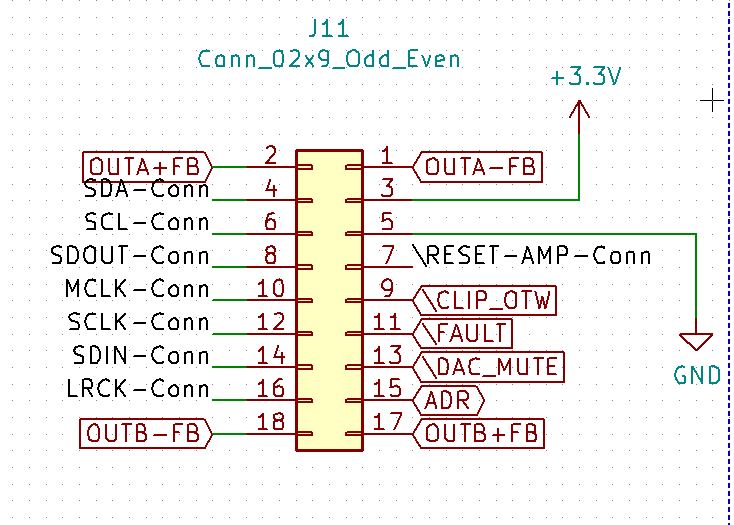

@tschrama and Lutkeveld:
The functions to achieve by the "controller" are (at least):
- manage power ON sequence,
- manage the Power OFF sequence,
- manage FULT and RESET_AMP
- load DSP coefficients and other parameters,
- manage volume,
- possibly provide the USB to I2S translation, or BT to I2S, or...
Many options to do all of the above, some of them requiring very low CPU power.
The question is whether there is a huge benefit to have something onboard, or to be more on a daughter board approach.
The initial idea was to develop a "versatile brick" possible to use in many configurations, as opposed to the "plug and play digital amp". This better fits with the daughter board way...
But I'm interested in listening to others opinions.

To give an idea of the interface to the controller, here is q picture of the connector in the current design.
Pins 1, 2, 17, 18 are I think not so important. Main signals are:
- I2S lines,
- I2C lines,
- /CLIP_OTW
- /FAULT
- /DAC_MUTE
- /RESET_AMP
- ADR
- controller would need an additional Analog input for Volume management (or inputs for a rotary encoder).
