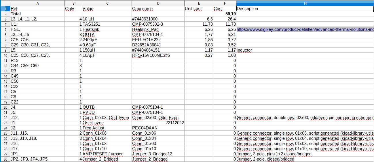

This morning, I looked at the list and cost of "remaining components" to add to the JLCPCB Assembly. See attachment below. I arrive to about 60€ for one board with ordering to Digikey (without shipping costs, remaining small SMDs, pinhead headers).
As expected, the cost derives mainly from, by importance rank:
- output coils (26€),
- TAS3251 (12€),
- Heatsink (6.3€),
- Speakers and power supply connectors (5.3€)
Ordering a batch of coils directly to Wurth helps as the price drops to around 3€ per coil for 40 ordered.

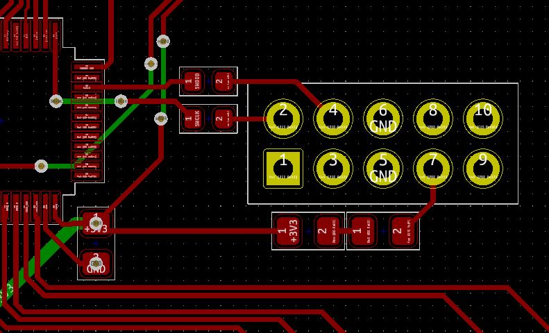

Would this pinout be correct (attached below)? I respected the pin numbers you proposed, but there is a risk that the odd/even numbering is not the same for the footprint. So I prefer to check.
Additional question: do you confirm that there is no need of conection to NRST ?

Great !
An alternative (or complement) to using a SWD pinout for the STLink could be to use the pinout of the cheap STLink V2 adapter (2$ on Aliexpress or Ebay) and to use a 2*5 pin 2.54 header on your pcb. This will allow you to connect your board through a firm and reliable flat cable which provide much better connection than ‘flying’ wires between the board and your STLink adapter. This may be particulary relevant in a class D power amplifier environment.
And this may also help DIYer playing with your amp without being equipped with a Nucleo or Discovery board to use as a STLink.

Yes pinout is ok. Picture is a layout of a working prototype. Take care of the footprint of the connector, do not install parts too close to it. Your footprint is for header only, mine is for a complete pcb connector which is larger ( https://fr.farnell.com/molex/70246-1004/connect-header-10-voies-2-rangs/dp/1392408 ).
There’s no NRST connection, I think SWD issue a soft reset, which is ok. But it’ll be very useful to have on your board a smd reset button and also a debugging and diagnostics Led on a GPIO.
I would also suggest ordering all the small parts together, it is not much difference to you. But a big difference for everyone that has to order a couple SMD's and some headers, and all of them has to pay for shipping.

I have put a jumper for reset of the uC. JLCPCB does not proposes buttons as basic parts, and I already have reached the 10 extended parts limit.
I will try to use a different footprint for the connector, to allow your standard Molex connector to be used.
