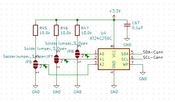

About the schematics for the Eeprom, the draft is as below.
As several boards can be daisy chained on the I2C, I propose to provide all the flexibility for Eeprom addresses via solder jumpers
As space starts to be scarce, I wonder if:
- R45, R46 are needed, or if I could have only one R45 to potentially connect A0, A1 and A2 to +3.3V ?
- Do I really need the 3 way solder jumpers to connect either to +3.3V or GND; or the internal pull down is sufficient (datasheet allows for floating pins (read as 0), but advices to have connections) ?
JMF

You don't need those resistor, you can connect directly to VDD or GND, but you have to take care of the pull up resistors in parallel on SDA and SCL line when adding slave boards.
Thanks AIM65 for the reply.
I will be happy to suppress the pull-up resistors. However the datasheet https://datasheet.lcsc.com/szlcsc/Microchip-Tech-AT24C256C-SSHL-T_C6482.pdf
states:
Device Addresses (A2, A1, A0): The A2, A1, and A0 pins are device address inputs that are hard wired (directly to GND or to VCC) for compatibility with other Atmel AT24C devices. When the pins are hard wired, as many as eight 256K devices may be addressed on a single bus system. (Device addressing is discussed in detail in Section 7. “Device Addressing” on page 9). A device is selected when a corresponding hardware and software match is true. If these pins are left floating, the A2, A1, and A0 pins will be internally pulled down to GND. However, due to capacitive coupling that may appear during customer applications, Atmel recommends always connecting the address pins to a known state. When using a pull-up resistor, Atmel recommends using 10k or less.
So ambiguous about "Directly connected" and "When using a pull-up resistor, Atmel recommends using 10k or less"
Do you confirm I can suppress ?
About paralleling the pull-up resistors on I2C lines when having several boards in serie, any advice ? Currently they are 10kR. Intention would be to have the possibility to daisy chain un to 4 boards (let's say 4 ways stereo speaker) => Any advice on this ?

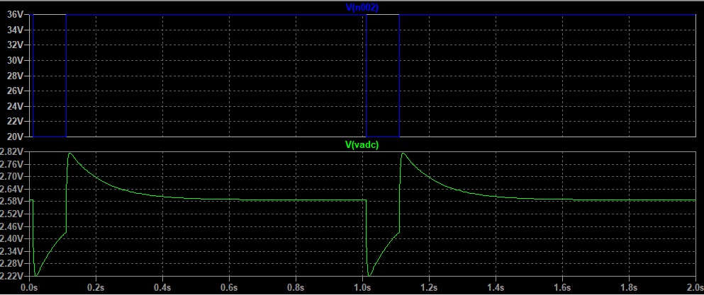

Last, about the supervisor function, I thought that TI engineers knew what they were doing. The circuit is intended to monitor +12V and VDD with one single analog input that should stay below 3.3V. I tried to understand how R40, C54, C55, R41 and R42 work together but did not succeed. Help welcomed.

Hello JM,
I usually follow manufacturer recommendations and I haven’t seen such recommendation by other suppliers of 24C256: ST or OnSemi. But this is not big stake.
You’ll have 4 I2C pullup in parallel, a quick check should be made, there’re many app notes available on Internet in order to compute min and max pullup values according to number of devices, speed, capacitive load, etc…
For the PSU monitor, no doubt they knows what they do ! , question was to understand what they intend to measure with such a circuit. Now, I believe their solution allows to monitor the value of +12 rail and only the major negative variations of VDD rail such as a VDD drop. About their circuit, I’ve no idea why they have 3 caps in // (1u + 100n + 100n) and not a single one. Resistor value are certainly calculated for +12 and +36V and also for the threshold value of the TPS3802, they should be revised for other value than 36V. It'll be interesting to run an LTSPice analysis to confirm waveform and values in case of VDD drop. It'll give you a idea of what Uc software should do in order to manage reset. If I find some time...
Chris

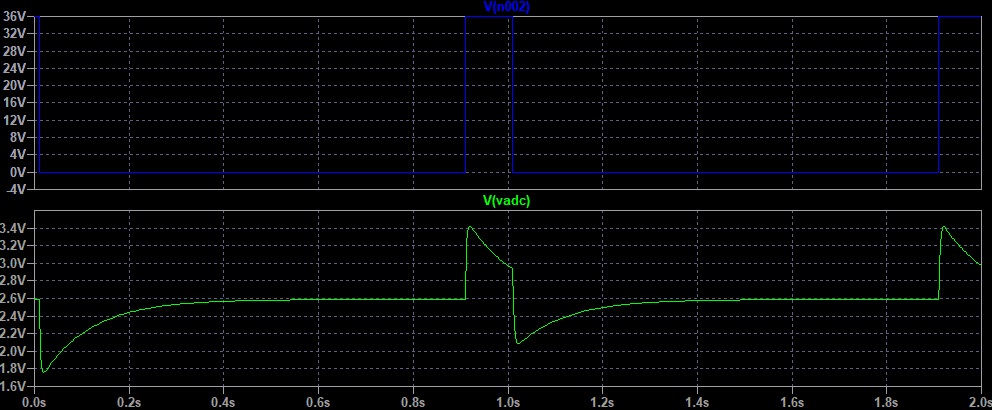

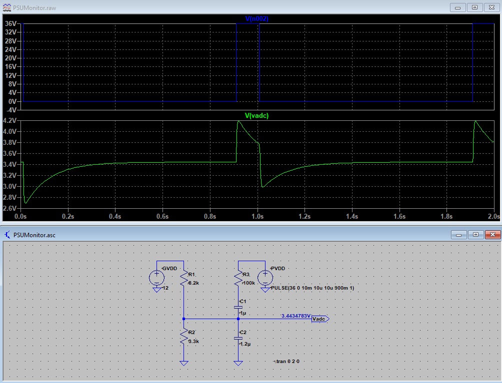

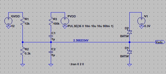

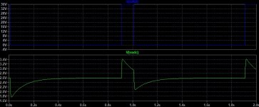

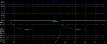

PSU monitor sim
The first sim with LTspice shows that current resistor set the operating point much too high (3.4V), any drop and return on PVDD will destroy the Uc (signal goes up to 4.2V). As proposed this should be clamped to 3.3 and GND with Schottkys. The TPS3802 is certainly protected, not the STM32
Having a single 1u cap rather than 3 for 1.2u and changing one resistor will set the operating point to 2.5V.
I ran sim for two different PVDD drop : first one from 36V to 20V during 100ms the second other from 36V to 0 during 800 msec.
If you set your software threshold to 2.2V you’ll catch them both, even in repetitive condition.And 2.2V threshold is also reached when GVDD (the +12V) reach 8.9V.
This setup should be ok, and it is not linked to PVDD value, only on the variation of PVDD.
Pic from left to right : current values, target value circuit, 100ms drop, 800ms drop

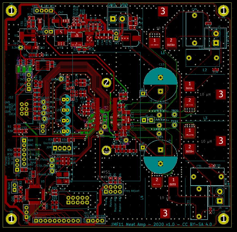

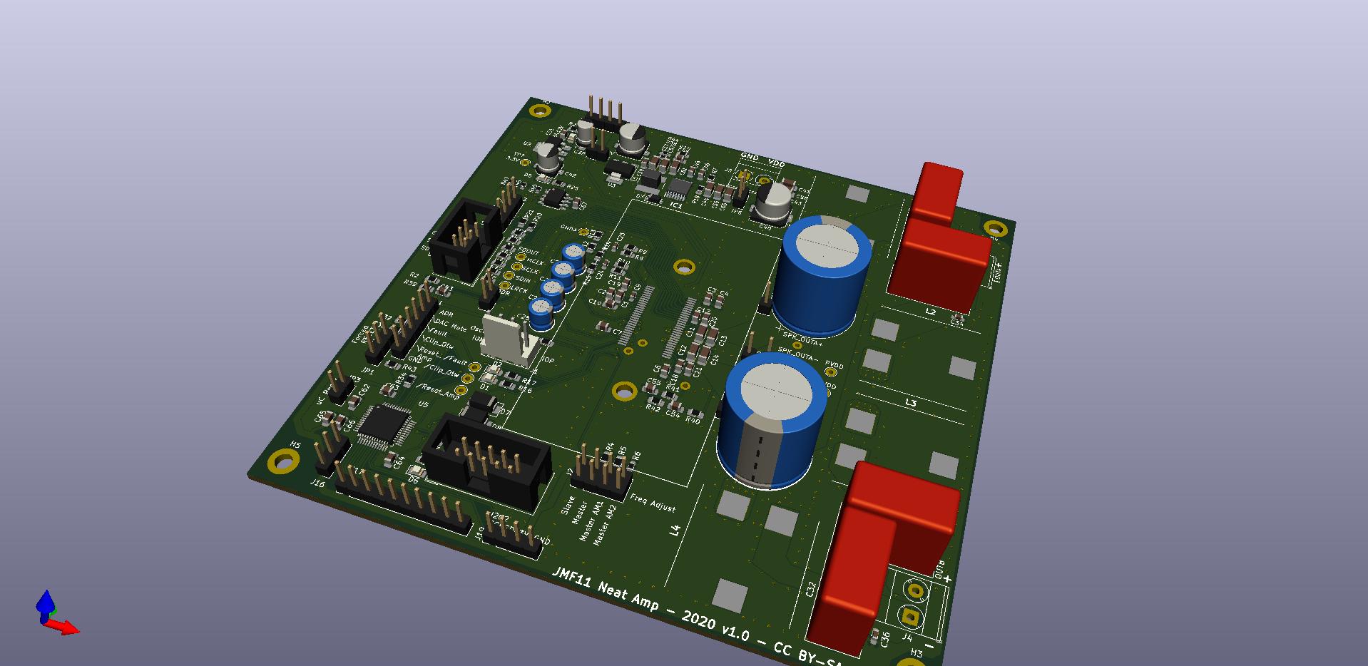

So, one move forward. I have ordered 10 boards to JLCPCB. Let's now wait for news.
I made some free space about key connectors to allow people to chose their preferred ones. The remaining components to populate are as expected. The board has the 24C246, the stm32F0, LM5010, LM2940, AMS1117-3.3, all top side 0805 and 0603 minus one, most SMT alu caps minus one.
If everything goes as expected for the taxes, the price will arrive at 15€ per board + shipping booked now (before tested and demonstrated as working).

So, the board appears "under production" on JLCPCB website. I ordered from Aliexpress some Dupont connectors, terminal blocks.
For board connectors, they are all 0.1 pitch. For my prototype, I will go for basic male pin headers. I bought a pack of female Dupont connectors of the different formats for the cables. Will work except that this don't provide keys to control orientation... For soùme of them there is enough room to use Molex_KK-254_AE-6410 which are 0.1 pitch.
I also has a look at the remaining components. The ones that seems available only in one location is the heatsink (ATS-TI1OP-519-C1-R3 Advanced Thermal Solutions Inc. | Fans, Thermal Management | DigiKey)
I had in mind that that specific model was needed because of the "shoulder" on the bottom, to clear from components on the side. However, it seems thad the bigger SMD caps are 1.6mm high, and the TAS3251 chip seems 2.3 mm over the PCB. So maybe a more basic heatsink could do the job.
Do any of you have experience with heatsinks for those chips and the best way to proceed? If the "shoulder is needed or not (I saw fome picture of "reworked" heatsink on Doctormord website) ?
