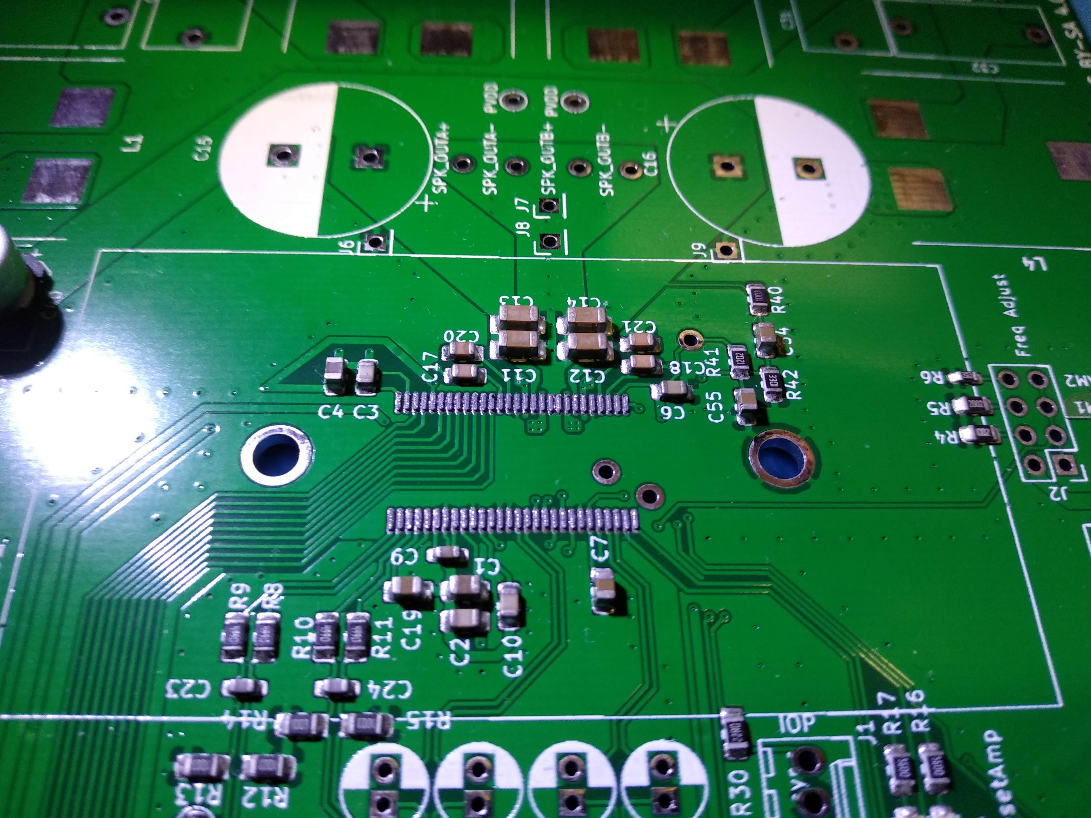

How did you soldered the TAS3251 once c17 and c9 removed ? How do you rate the difficulty ?

To solder the TAS I applied the same method I use for such low pin pitch chip:
  • Carefully apply paste with a small screwdriver, remove all excess. If paste is too dry, slightly preheat the chip area.
  • Place the chip and solder it with hot air gun.
  • Clean all the pins with fresh solder braid, section perpendicular to the pin axe (that’s why I removed the caps) and a flat soldering iron tip.
  • As my paste is a bit old and dry, it tends to form small balls so I generously apply flux on the chip and strongly reheat it applying air flow between the leads to avoid bridge under the chip
  • Have visual inspection for each step. Having good lens is required, if not some smartphone may help with lens software and their powerful led
  • Clean the board with IPA
  • Power up with current limiting supply…

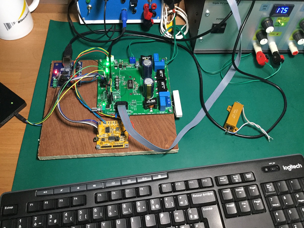

Now it produce some sound !. Basics test with a test speaker and my lab supply are very promising, the amp seems very powerful, and sounds sharp and clear.
I encountered various issues and I still have some, but this not surprising: this is a new chip, a new software and new pcb, this make a strong probability to meet issues combined with those 3 factors…
First I had some soldering issues, which generated some erratic behaviour of the DAC, DSP and power amp. I had to remove the chip then to solder it back while adding flux to my solder paste which is definitely too old and dry.
I also had DC offset on output (~500mV) : the four ecap between the DAC and the power amp where leaking because they were reverse biased due to a silkscreen mismatch.
The last remaining issue is related to the setup of the chip. Setup could be applied one time only after a cold start. If a re-apply it or apply a new one the output vanish. Only a cold start allow to recover output.
I’ll continue digging, I now have a software way to display the status register of the chip I should find an error flag somewhere…

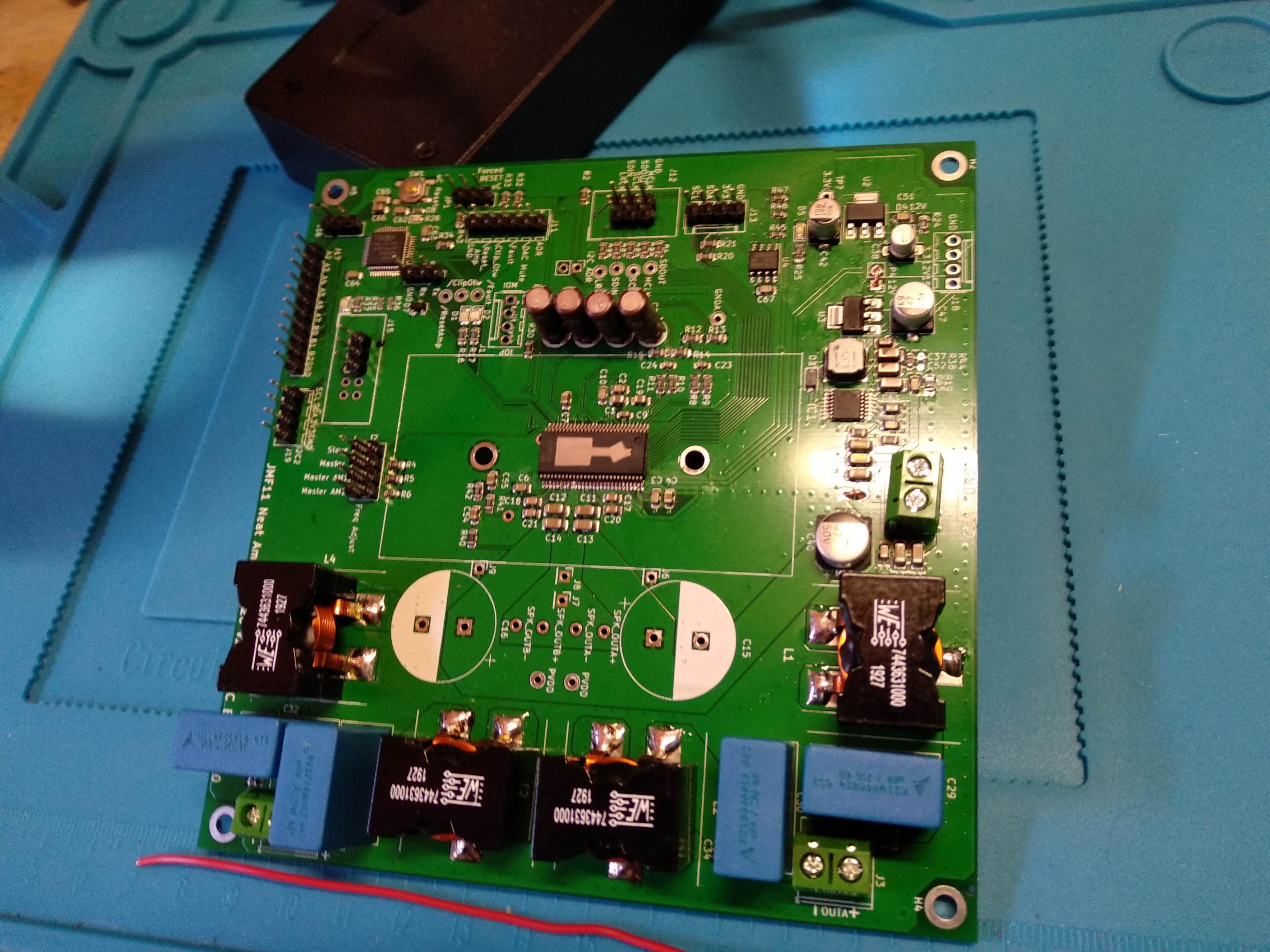

So, now a second board is on the workbench:
- additional SMD components soldered, except TAS3251 itself,
- 15V, 12V and 3.3V power supply stages working,
- stm32 operational with blink code.
Next stage is to implement a "NeatAmp variant" in the Arduino environment and be able to download applications developped in the Arduino IDE.

Today update : It works !.
The issue related to configs requiring cold boot is solved, it seems that DAC_MUTE should be set low during config update (not DSP coeff, only config). As the chip doesn’t have a hardware reset pin, having DAC_MUTE low seem to be required to have the soft reset (Reg01) operate properly.
I also encounter some software related issues regarding I2C write to TAS. TAS has to be managed as a I2C memory device.
But the reason why I lost the most time is that the default configuration provided by PPC3 I used (standard stereo 48k) doesn't work, at least on the DSP part with the biquad coefficients, the gains seem to be set to zero and it produce nothing. Besides it doesn't even match the application note on process flows (SLAA799A).I finished by writing by hand a very simple biquad config (volume control) which confirm software and TAS is ok.
Volume control using a pot has been implemented, it needs calibration: the TAS play very loud and there’re many (at least 3) volume control stage in the signal path. The analog one (0/-6dB selector) and the basic digital one (Reg0x3D-3E, B0/P0) are documented but not the one to use (Reg0x44-0x48, Page x01e) within the biquads area. Question : which balance for the best dynamique and SNR ?. For now I have -6dB analogic, -44dB digital, +24dB default TAS gain and my volume control based on Reg0x44 and 0x48 biquads.
Still few bugs to remove and first version of software is mainly ready.

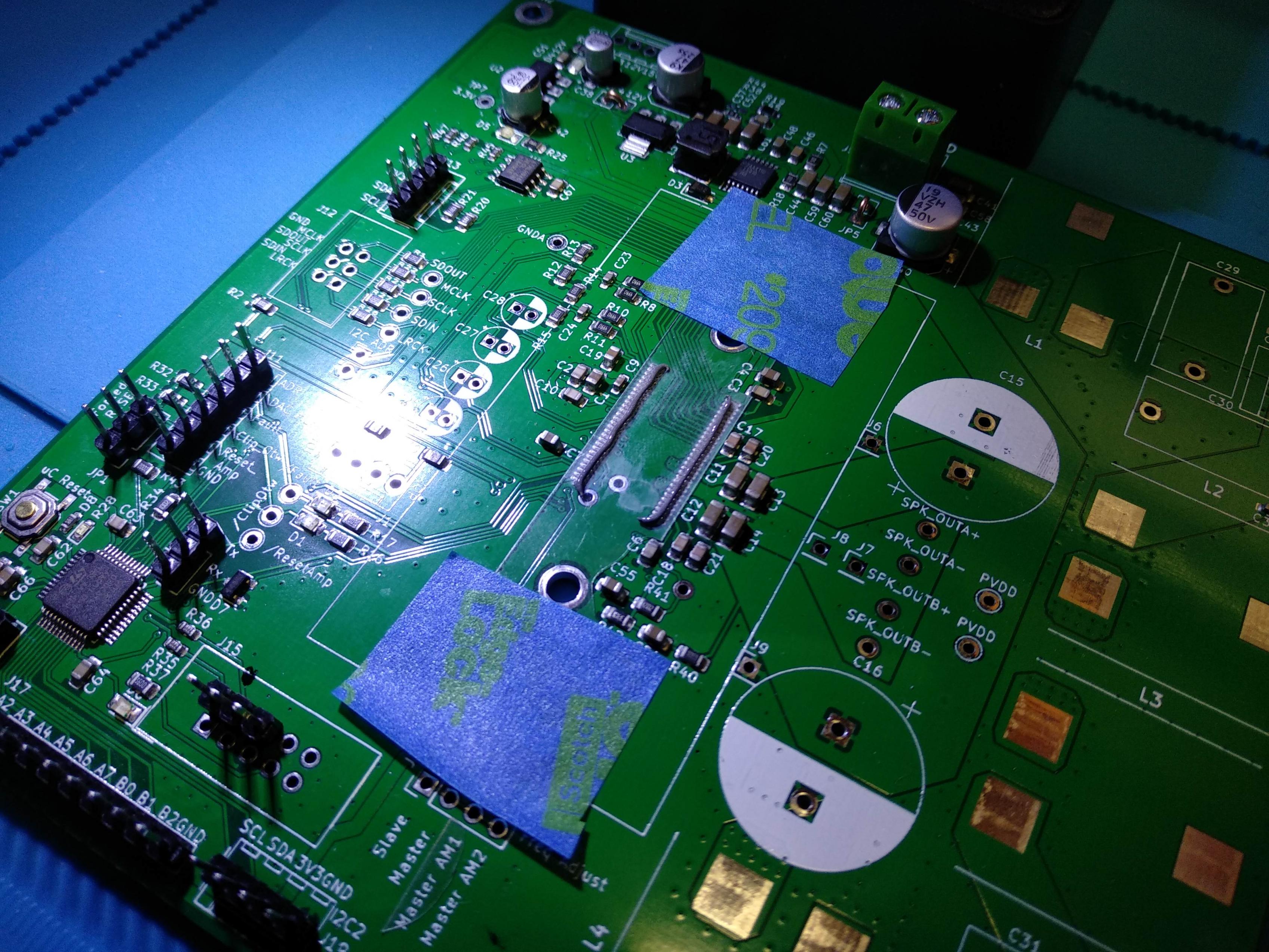

So... next stage is soldering the TAS3251. I will use a mini stencil made from mylar sheet and laser cutter.
JMF

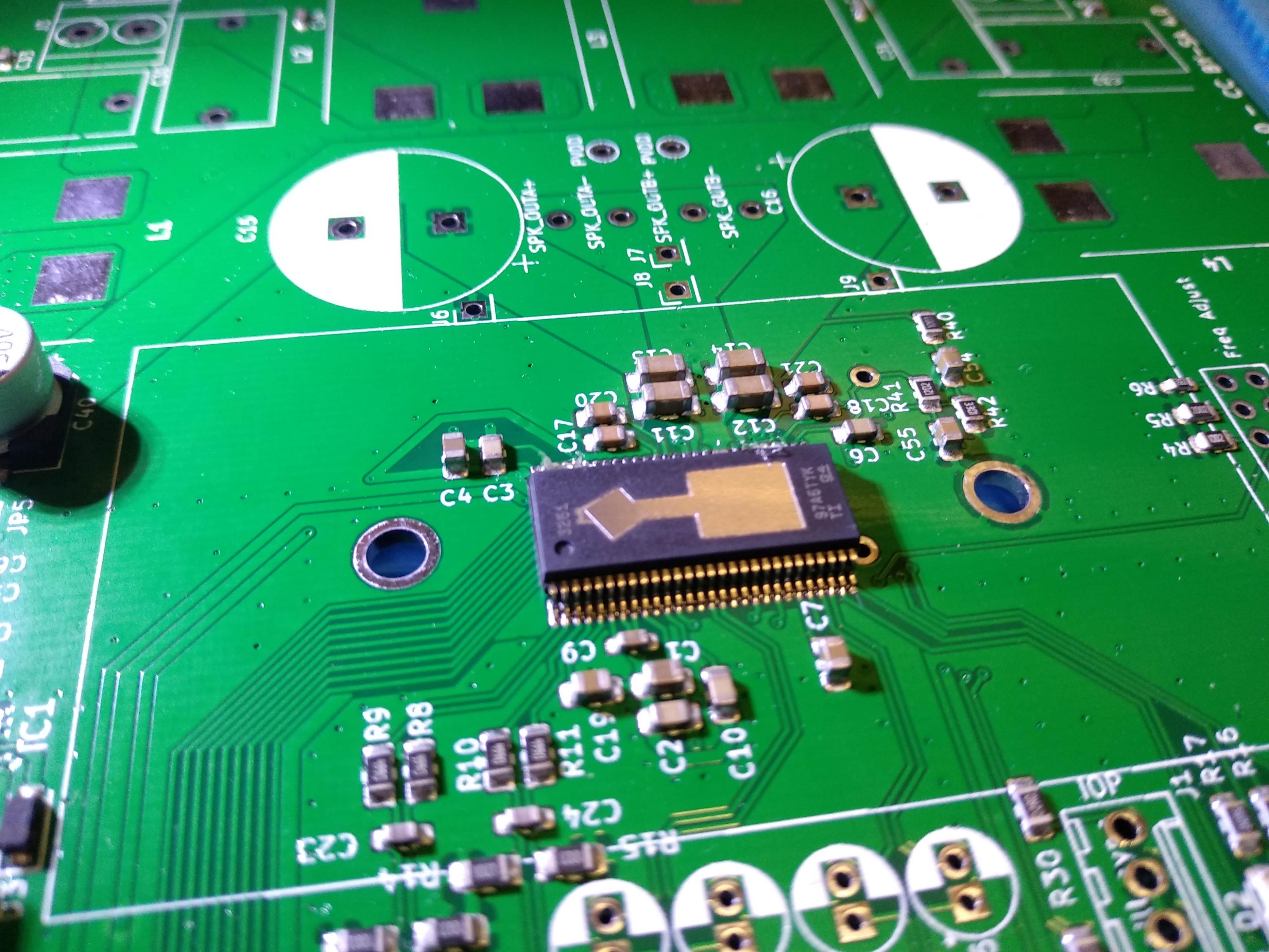

So yersterday, I soldered the TAS3251. The "mini stencil" strategy looks to have worked. Solder paste and hot air look magic to my eyes.
Have to double check before powering.

I just took a quick look on the pictures of your PCBs and the layout recommendations in the tas3251 datasheet.
On the first view that reference design doesn't really look that well thought out. I think the routing could be improved. Especially because the chip doesn't have a power pad on the bottom side.
Those vias routing the amp outputs to bottom in the datasheet are rather of a symbolic value. I think that should symbolise that there will be vias needed. Those 5 vias will not really be capable of handling 175 W per channel. I think you should use much more vias or filled ones or what would be the best, route the power lines on top without vias to bottom.
