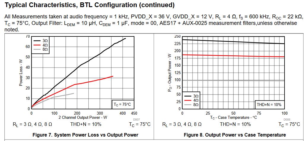

This evening, I was looking at the heatsink question. Especially because in my case I won't pull so much power from the amp. Max will be around:
- 60W in 8R
- 30-40W in 4R (about)
In Class D, most of the ouptup power is not dissipated inside the chip. Looking at the TPA3251 datasheet, there are some elements about the power losses (what is dissipated in the chip) vs the output power.
So with my max output power, I will have 15 to 20W loses dissipated in the chip. DSP and DAC power loses should fit in this enveloppe. This looks like the dissipation of a TO3 transistor (order of magnitude).
So in my specific case, the TI EVM heatsink is oversized (sized to cope with the about max 60W losses).
Junction-to-case (top) thermal resistance is about 0.2°C.
When considering continuous max power... Junction temperature 125°C. Let's say 50°C in the box, and 20W to dissipate => 3.75 °C/W
With 15W to dissipate => 5 °C/W
