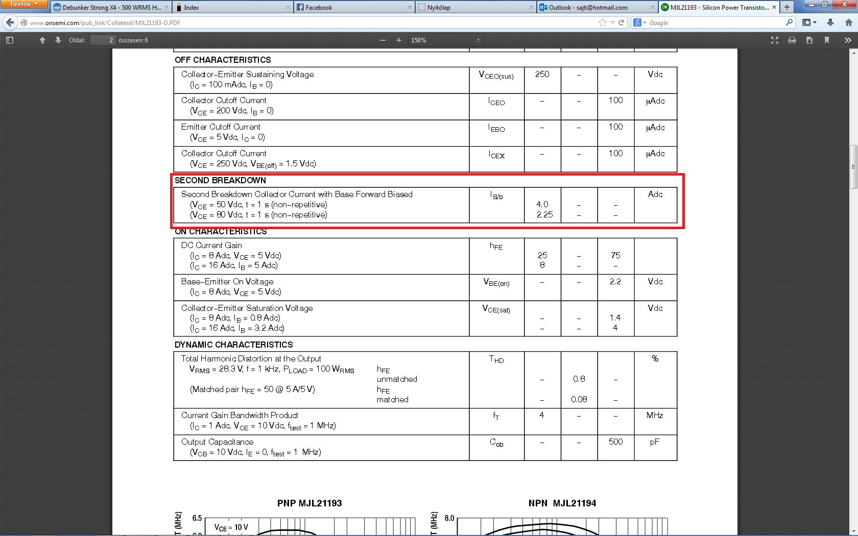

What about the current capability of the amp and the SOAR? Please be aware that if you specify an amp for 2 Ohms, real-world load might incidentally be in the range of 0.5 Ohms... At 2 Ohms (resistive) you'll need 22.5 Amps. To be stable with 2 Oms loudspeakers, the stage hast to be able to deliver 90 Amps...

But multisim does not take the SOA of your power transistors into account.
The datasheet I have for MJL21194 does not have a DC SOA curve but a 1Sec SOA Curve.
From that graph, IMO 4 pairs of MJL21194 at 65-70V per rail, won't power a 2R load with any reliability.
But then again I guess it would most prob only be used at 250W max in reality

Look to the OEM's. ALL use either low rail (40-50V) EF3 (3-4 pair for BJT)
or just use Class D for 2R reliable operation.
This applies universally for both home audio plate amps AND car audio.
An EF2 , at lower rails ... would come close to SOA and "droop" even
with 4R.
OEM's mostly don't even bother with AB for 2R - class D only.
PS -A 2R driver can have a much lower Z above and below resonance.
OS
Renat ... those specs you highlighted are at very low voltage. At 60V+
rails these devices can barely do 2A each (that is the purpose for SOA
graph in datasheet) !!
One of these OP devices used as a 12V regulated power supply could
do 15A .... that is what this spec really means.

Hi Friend,
Sorry to say, but that what you call theory is practice.
Loudspeakers are no pure resistive load. They combine resistive with inductive and capacitive components, as well as a counter EMF. Bottom-line is, that a 2 Ohms loudspeaker, under circumstances, can act like a way lower impedance. Your amplifier must be able to handle that impedance without frying the power-stage.
Since your design also lacks a minimal form of protection, I'd advice not to use it with loads under 8 ohms nominal at the rated rail-voltage.

You are absolutely right that judging something (in this case an amp) without proper testing is not correct. And I really appreciate you defending your friends design!
Testing being my business, I know review based on paper specs ought to precede actual testing. Imho the amp already failed on that review.
As I earlier calculated, the power-stage does not come close to the minimum current requirements (approx. 23 Amps peak @ +- 70V rail) to support 500W @ 2 Ohms. The 4 transistors only supply a peak of some 10 Amps at that rail-voltage, perhaps a bit more, but not the required 23A. And that is only when a pure resistive 2 Ohms load is connected!
When a real-world load is connected, the game changes completely: the dc resistance of a 2 ohms loudspeaker is likely to be in the range of 1.2 to 1.8 ohms. With reverse EMF it can (under circumstances) be even lower than 1 Ohm. So, that's my basis for questioning the 500W @ 2Ohms claim. At half power the thermal situation of a power-stage is even worse!
If the number of transistors in the output-stage is increased, the situation would be better.
