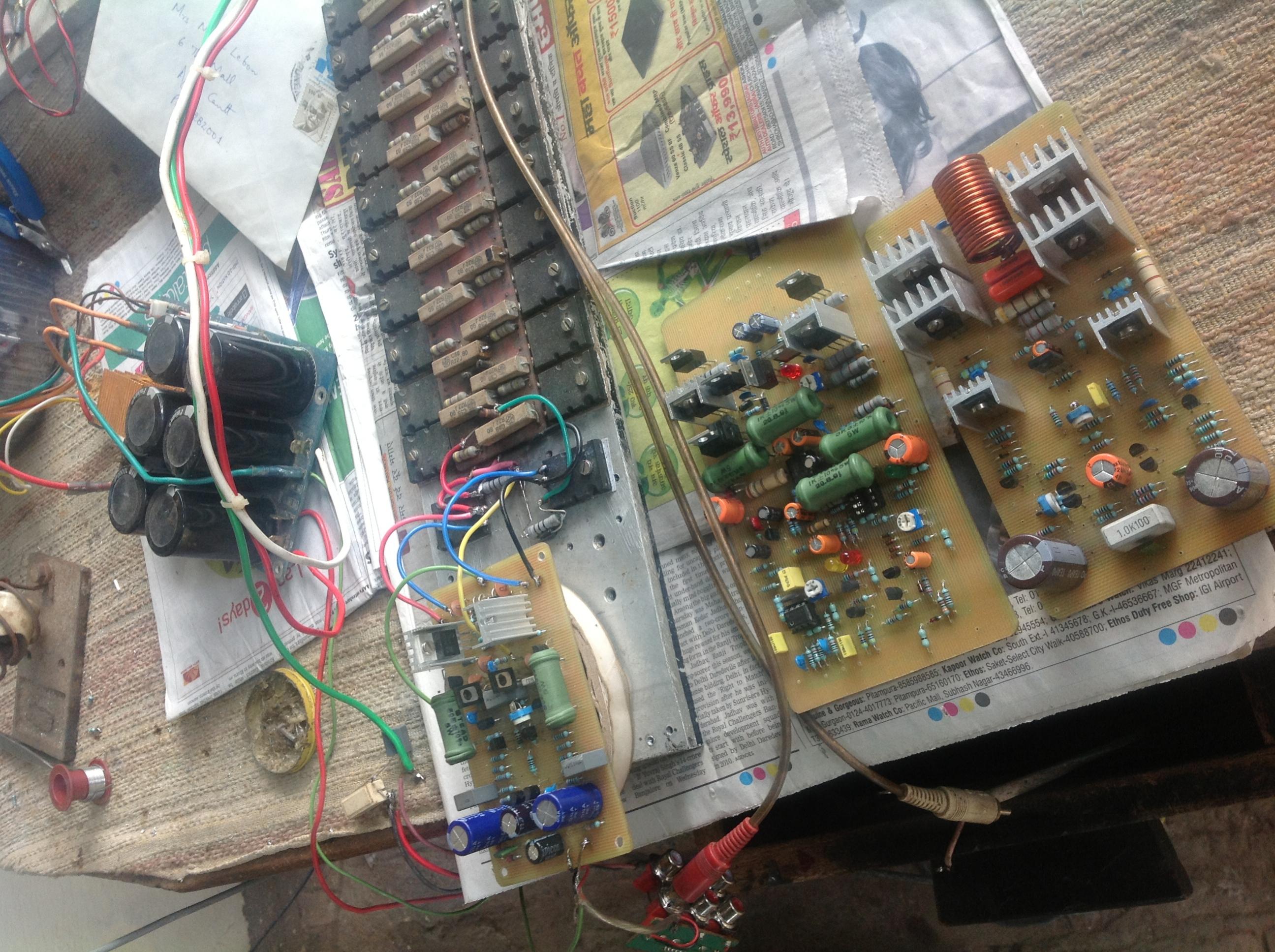

Hello gentlemen.
I rode the Debunker, and now I'm doing tests with it.
I was reading the previous pots, and tryna understand ... wondered why this amp could not use power 70 +70 with a load of 4 homs? Compared to this scheme http://www.electronica-pt.com/esque...k,34349050fc9e9c26ecbc777dada807c7/no_html,1/ which is an amplifier 750w 4 ohms.e its open source gives 92 +92?

nice start 😉preflight testing in Debunker 4r provides 380W, soon be made a test for the 500W and 2R
[flash(425,350)]http://www.youtube.com/v/ItHpJFjOGA8[/flash]
the video proves that in 4R friend Leandro reached 380W and 2R he will test in order to achieve the 500W
Another friend posting your mounting ... More a friend happy with results:
Here's to the "engineers" on duty, two videos. Really you were right, the amp does not deliver 500W, it EXCEEDS this value. In the second video, in just 4 OHMS 575W, powered with symmetrical about 74 volts. The transistors used in the tests were purposely TOSHIBA (2sc / 2SA) to prove also that no "calculation" overcomes the practice:
Debunker em 500W - YouTube
DebunKer -Strong em 575W - YouTube
Well, there it is. For those who want to build an excellent amplifier power and quality is worth it. However, for those who just pans topics for errors that do not exist, I suggest you actually start doing something useful to help people because of good intentions is filled hell.
I leave here my enormous gratitude to LEANDRO friend, who kindly performed the tests, with much appreciation and dedication. Thank you my friend!

Ai is the actual amplifier with 575 Watts:
https://www.youtube.com/watch?v=cuR78CYF02U
And congratulations for the excellent power supply. Soon we will be providing the layout and schematic for her friends. A no-frills power supply with multiple output options, a well-designed, well distributed, with no components underneath the transformer layout, finally, something very well proportioned and robust.

What's the intended use of this Debunked amplifier?
Home / PA / DJ / MI ?
Did you get to mount it in a cabinet or chassis?
Care to share some pictures?

Good afternoon my friend ...
Dimensionei this amplifier circuit based on a very dedicated hifi , but did many tests and changes with the intention of draining the greatest power ever known this circuit using the highest possible voltage , but without letting the high potency " messed up " the highest quality of sound that this circuit is capable of delivering .
So my purpose was this : An amplifier with extreme quality and extreme power , since whenever we see boards justifies your question, since most " strong " does not have quality. And most hifi are not strong ... So I tried to do a different project , for those who like a good power and does not want to give up quality.
The application will taste of each, can be mounted in a residential office , and used as needed ! The THD it is extremely low in either ( provided that well-fed ) power used , which enables its use also in small environments ...
Posted some pictures above , many people have assembled here in the forum ( DEBUNKER - Strong X4 - 500WRMS - Página 47 ) , but few post pictures , even if we ask ...

The video SMPS used in the above tests that resulted in actual 575W at the amplifier output is here:
The final layout is not ready yet, I'm waiting for the final schema Leandro, so it is in my hands finish the layout here and I can provide it personal ride.
The design is simple and functional, the friend Leandro tested for hours and made fine adjustments to achieve the best result. Uses IGBTs, semiconductors are placed side by side so that we can use only sinks (2 sinks), one of which for the primary oscillator part and the other for secondary grinding part ...
