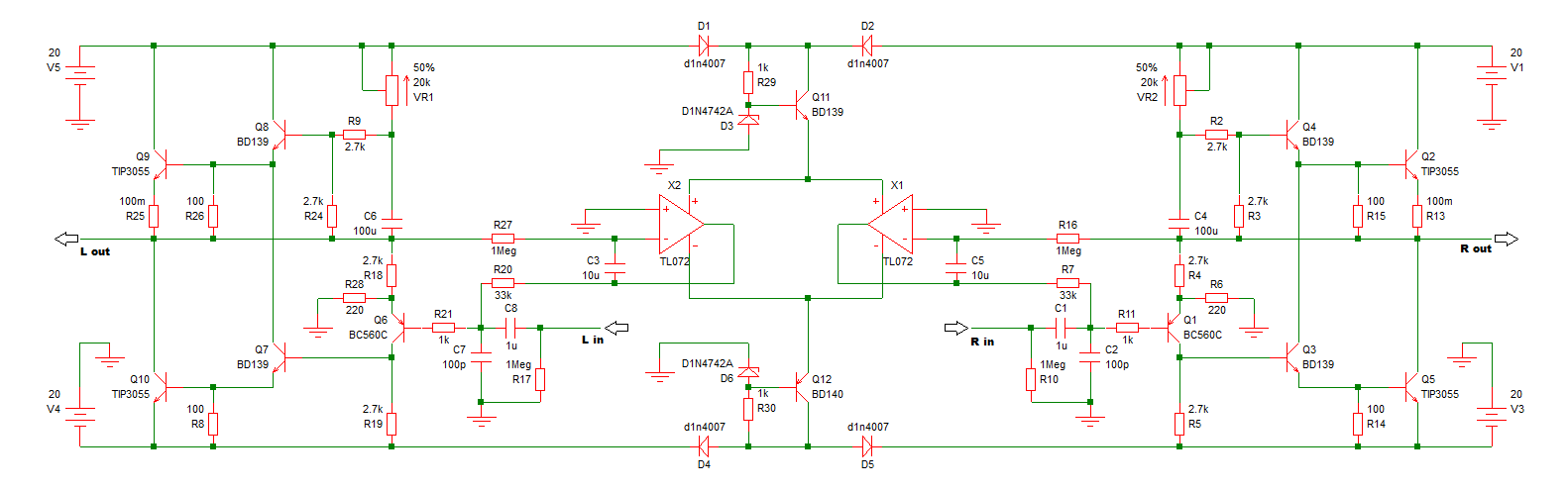

Sure, see the attachment.

kp93300,
The circuit is not balanced. The left board is capacitor coupled single supply type and the right board is direct coupled dual supply type with offset servo, both stereo. The above schematic shows the direct coupled design.
I don't know what the power output of a blanced circuit will be, but I am sure it will have less overall distortion.
For the interested.

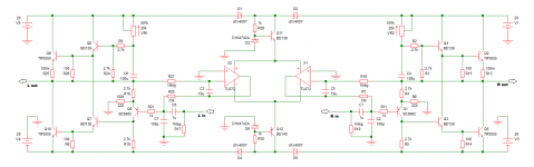

This is the exact schematic I used in the direct coupled version, everything except the power transistors are on-board. The diode-bridge+zener+bjt regulator for the opamp was a first time for me and it works well with no bad effect on the turn on/turn off event; i.e. no thump/click/pop etc..

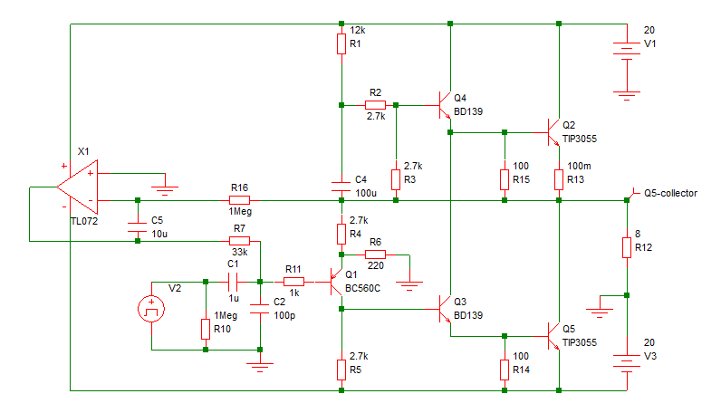

Gain of this circuit
Hi Shaan
What is the gain of this circuit ?
How do i adjust the gain ?
Hi Shaan
How to adjust VR1 and VR2? What to measure during adjustment?
Can i parallel the TIP 3055 for more power?
What is the maximum Vin ?
Sorry for so many questions?

Hi Shaan
thanks
kp93300
The default gain is 13. You can increase this by decreasing the value of the 220ohm resistor near the PNP input transistor. However, this design has low open loop gain to start with, so keeping the closed loop gain less than 15 is a good idea for low overall distortion. After all this is a low power amplifier.

Hi Shaan
Start with maximum resistance, then slowly increase bias to about 1.7Amp. I do it by connecting a 1ohm/5watt resistor in series with one of the supplies and measuring the voltage around it. In the servo controlled circuit only the bias current needs to be monitored as the output offset is nulled by the servo In the capacitor coupled version the offset varies(although by small amount) with varying Iq.
Yes, but you will need low impedance(say 4ohm) speakers or paralleled higher impedance speakers to get the extra watts.
:up:
~1.5Volts for maximum power

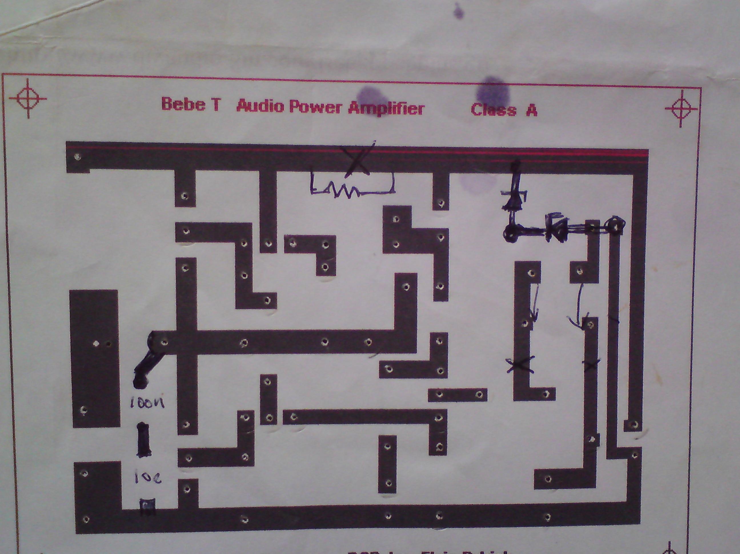

Hi all I have built the class A doz,and can confirm that it has that JLH full,rounded class A sound. The bass seems punchier and dynamic. Here are some pcb/overlay traces if anyone is interested.Good luck🙂

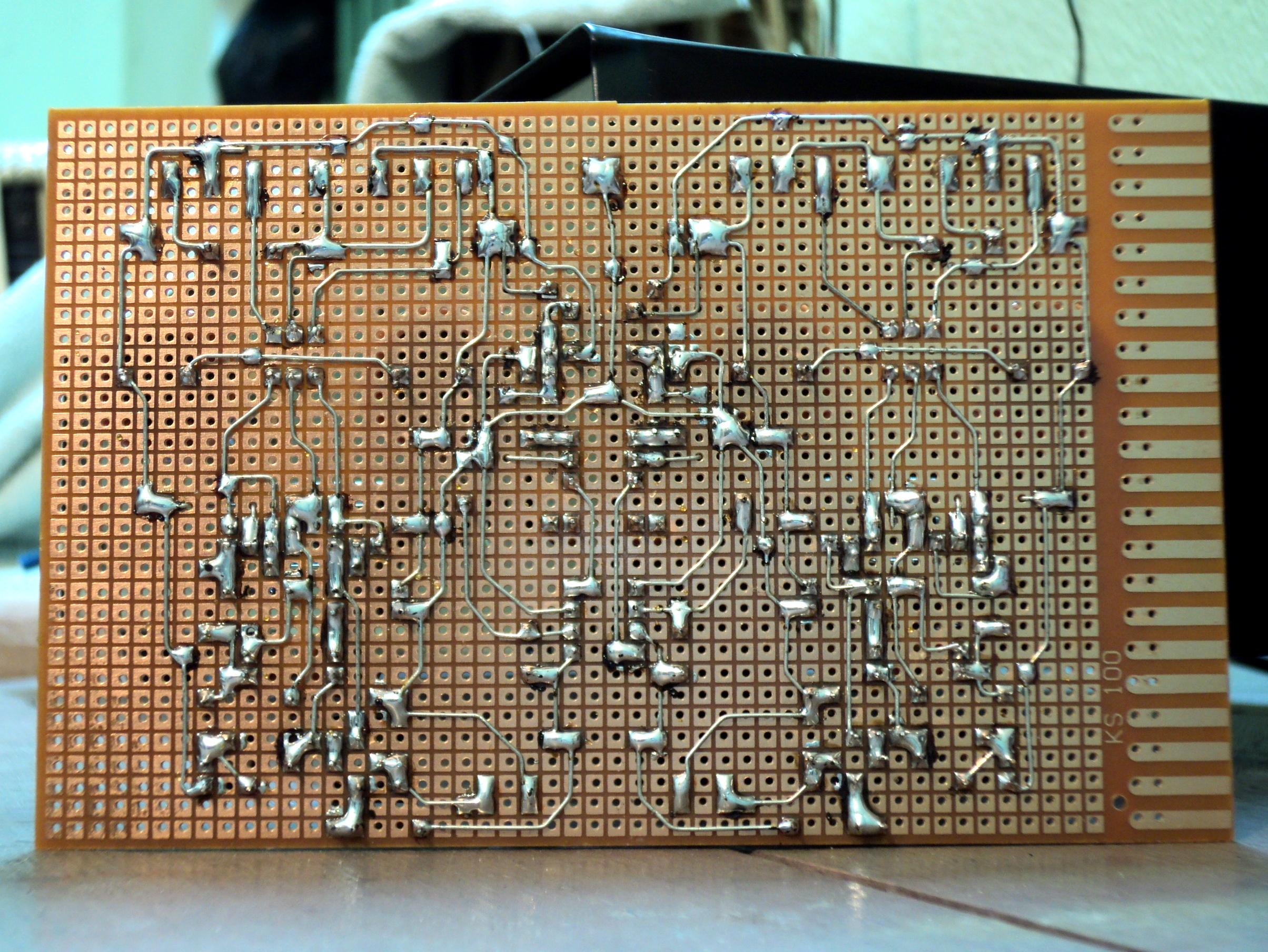

That is amazing work Shaan, it must have taken a very long time to complete!!
Thank you.
Planning/placing/soldering the parts and pins - 1 hour. Soldering the connector - 2 hours.
What do you use to hold the conductors in place while soldering, and how do you bend them like that??
With a Tweezer.
The conductors are just cut-off legs of the resistors and capacitors, 100 parts=200 conductors, so I don't have to buy wires for this task. I hold the conductor with the tweezer, dip one end in the flux, tin the end with the iron, solder it to a joint on the board, press the conductor towards the board and make it flat over the board, bend it with the tweezer to reach the joint to be interconnected, solder the other end, and the cycle repeats.
