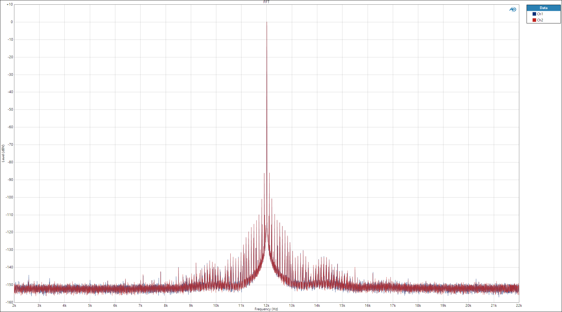

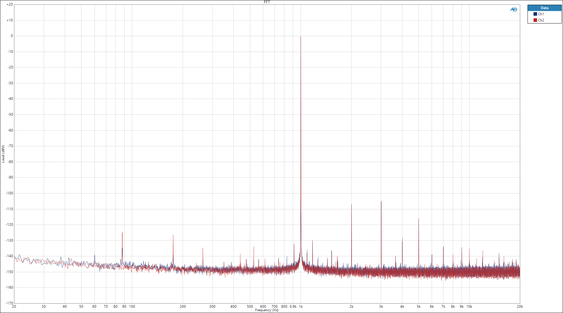

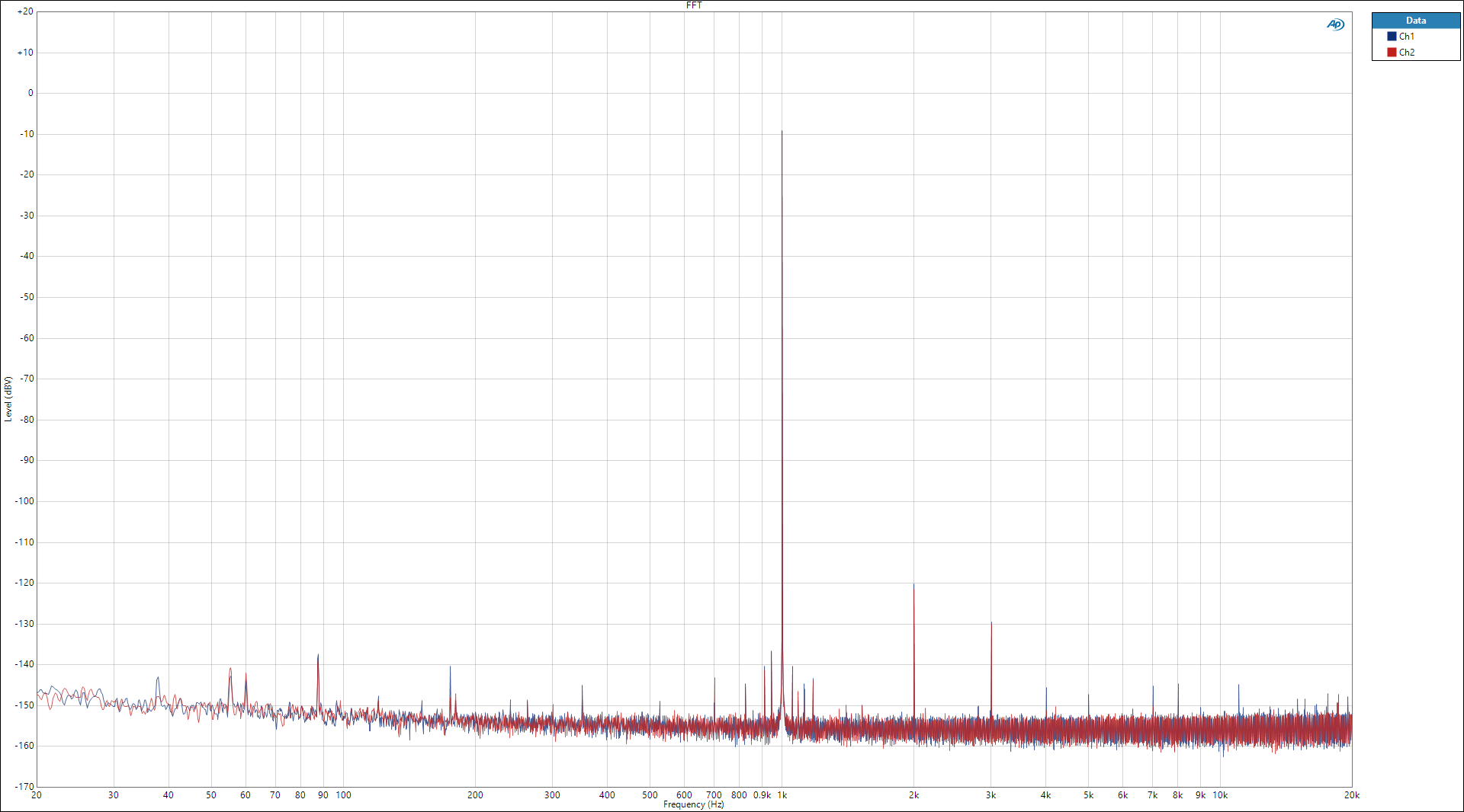

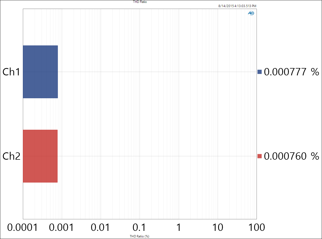

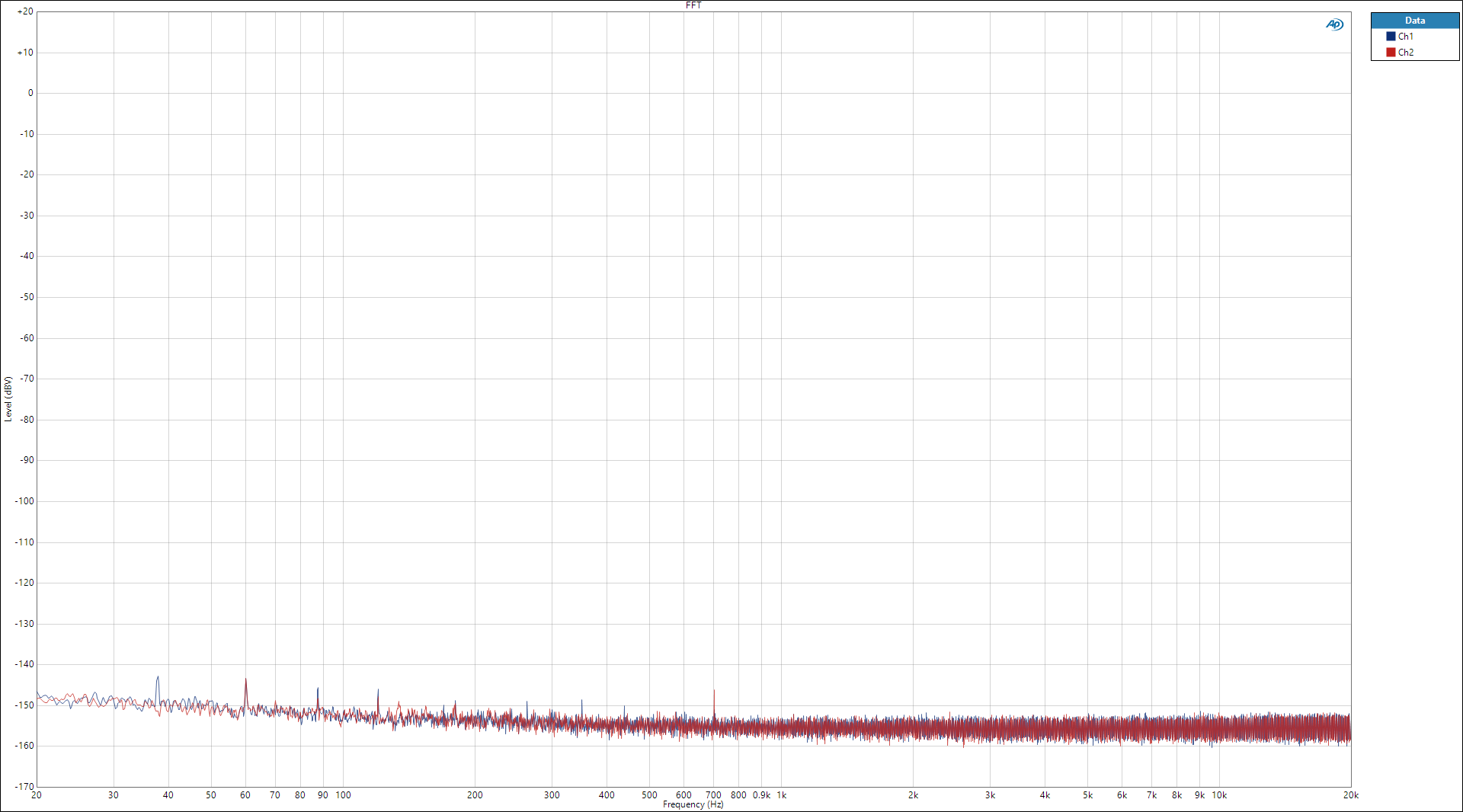

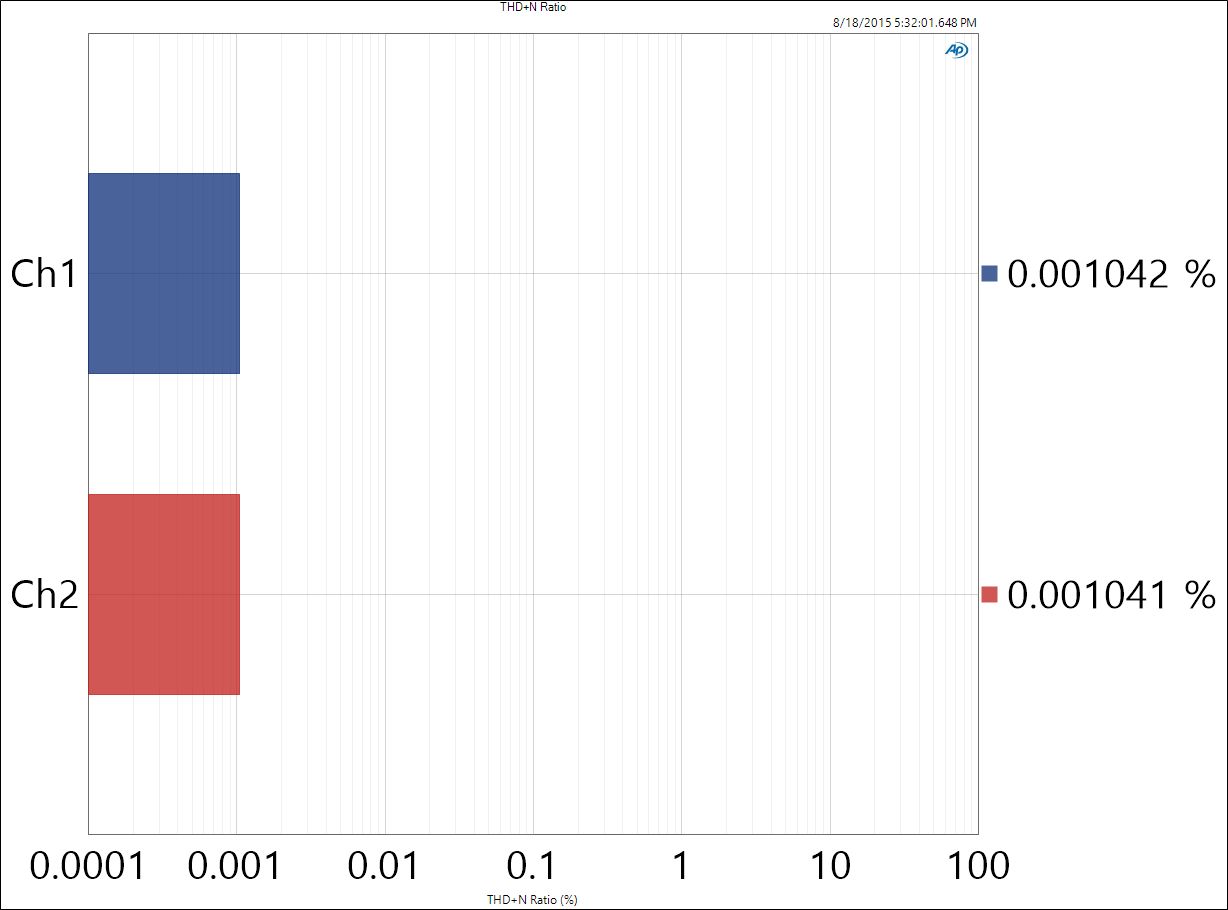

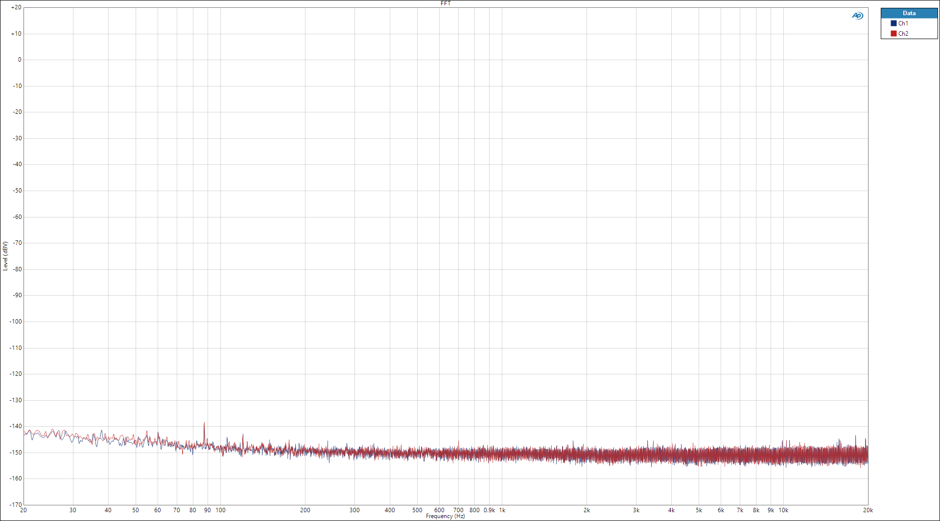

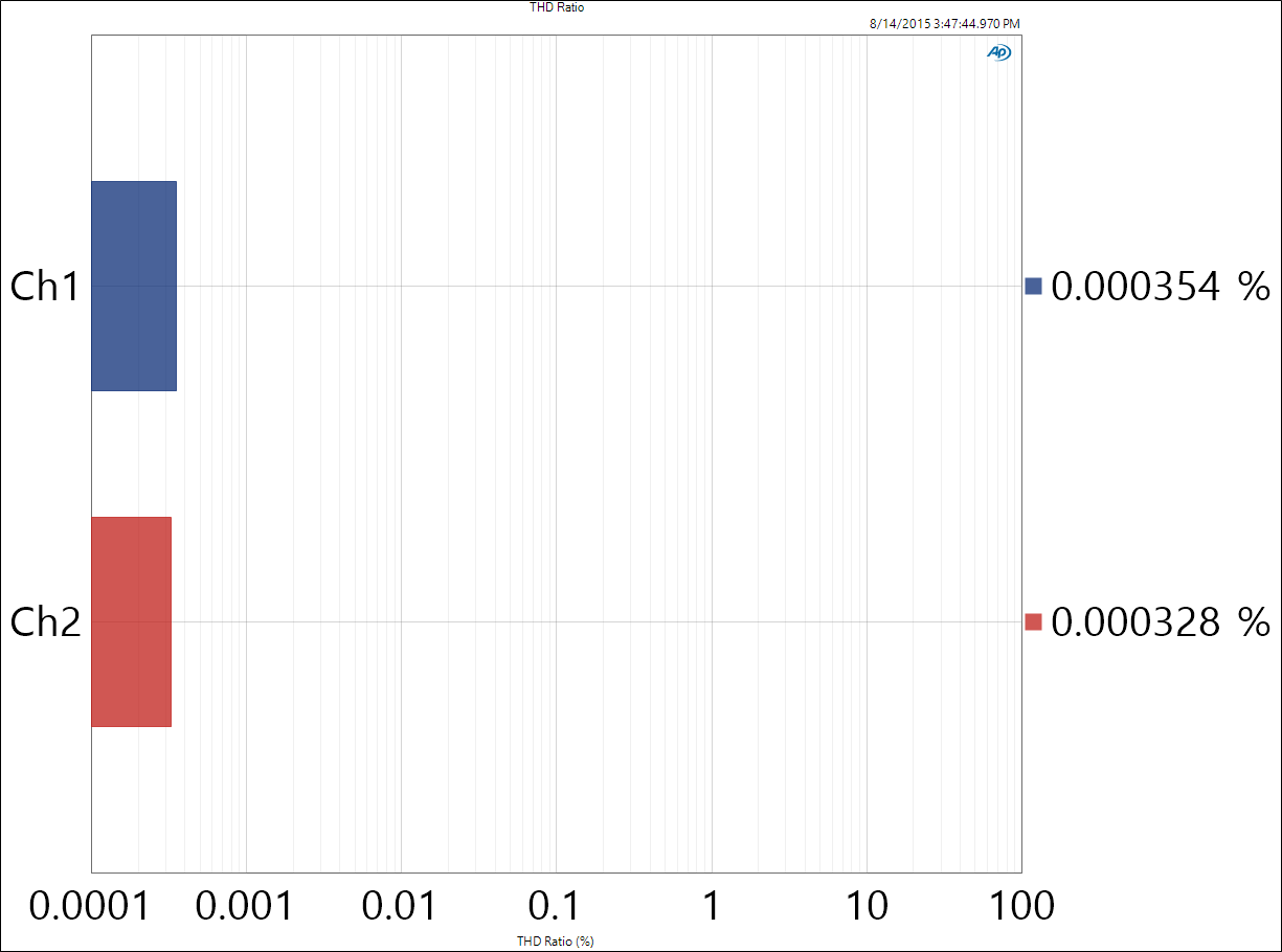

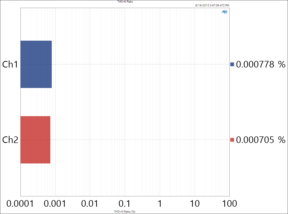

Alright... moving on to measurements!
1. Analog Input - Noise Floor
2. Digital Input - Noise Floor
3. Digital Input - THD @ 1kHz

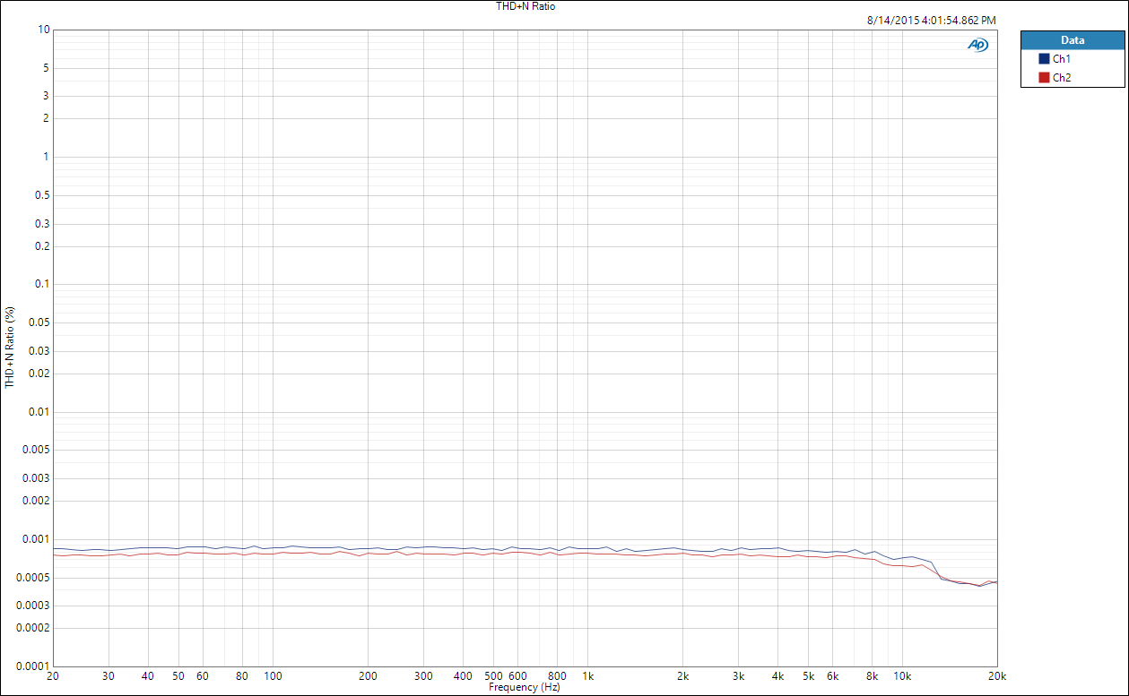

4. Digital Input - THD+N @ 1kHz
5. Digital Input - FFT 1kHz

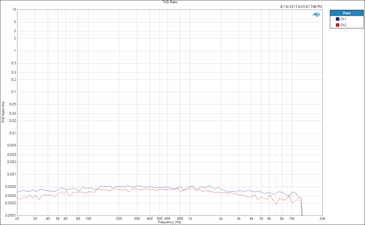

6. Digital Input - THD VS FR -15dBFS
7. Analog Input - THD @ 1kHz
8. Analog Input - THD+N @ 1kHz
9. Analog Input - FFT 1kHz
10. Analog Input - THD VS FR 1VRMS
More to come!

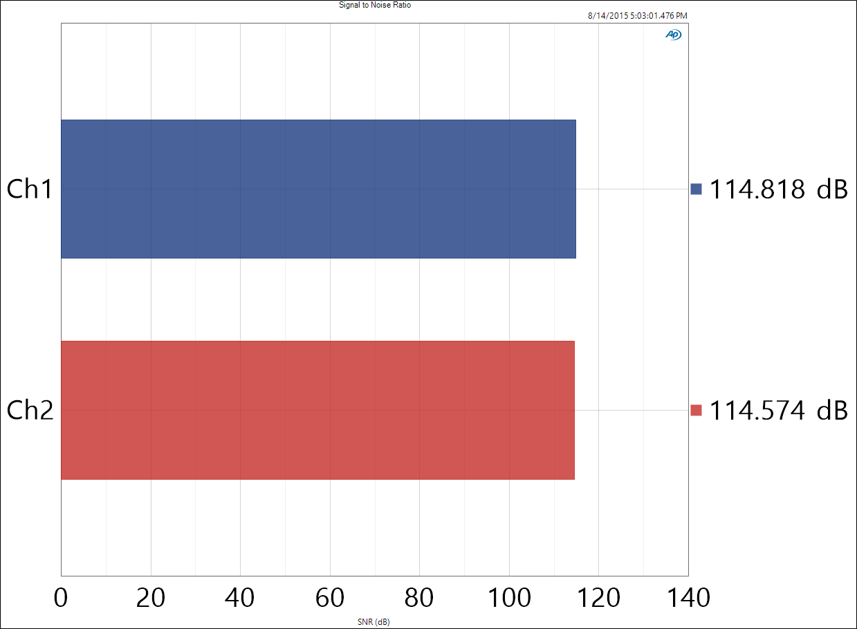

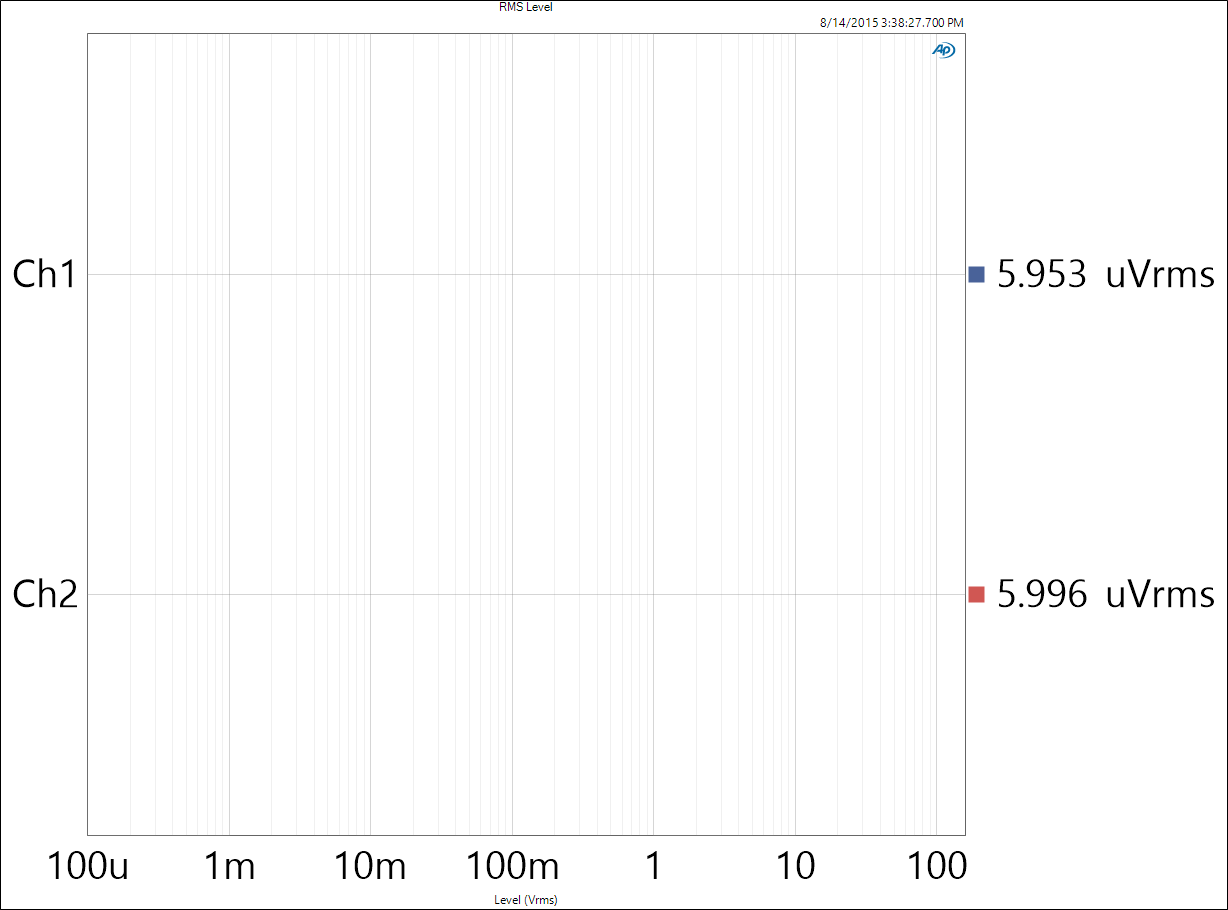

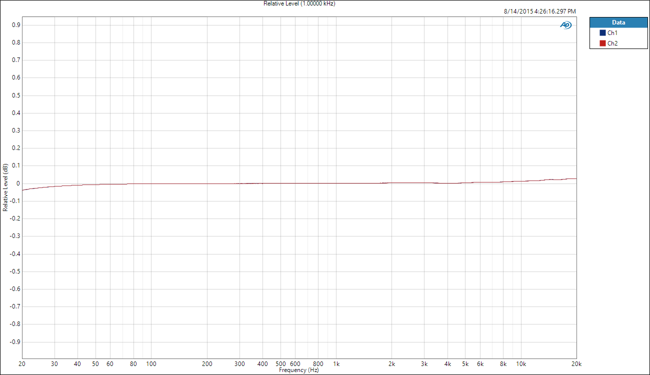

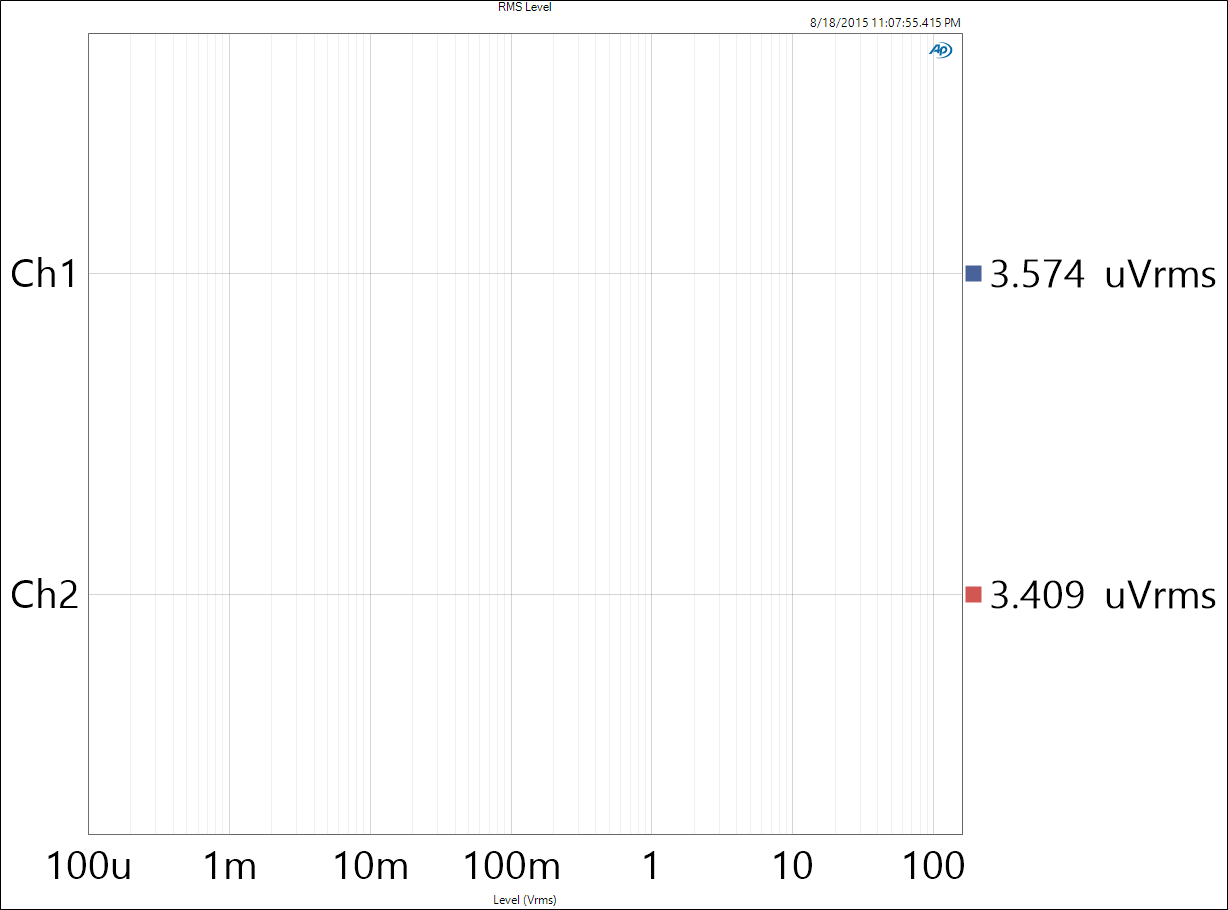

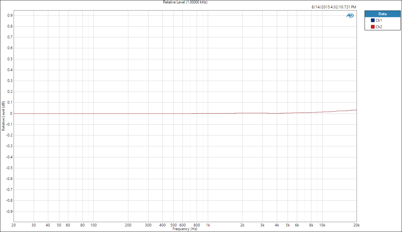

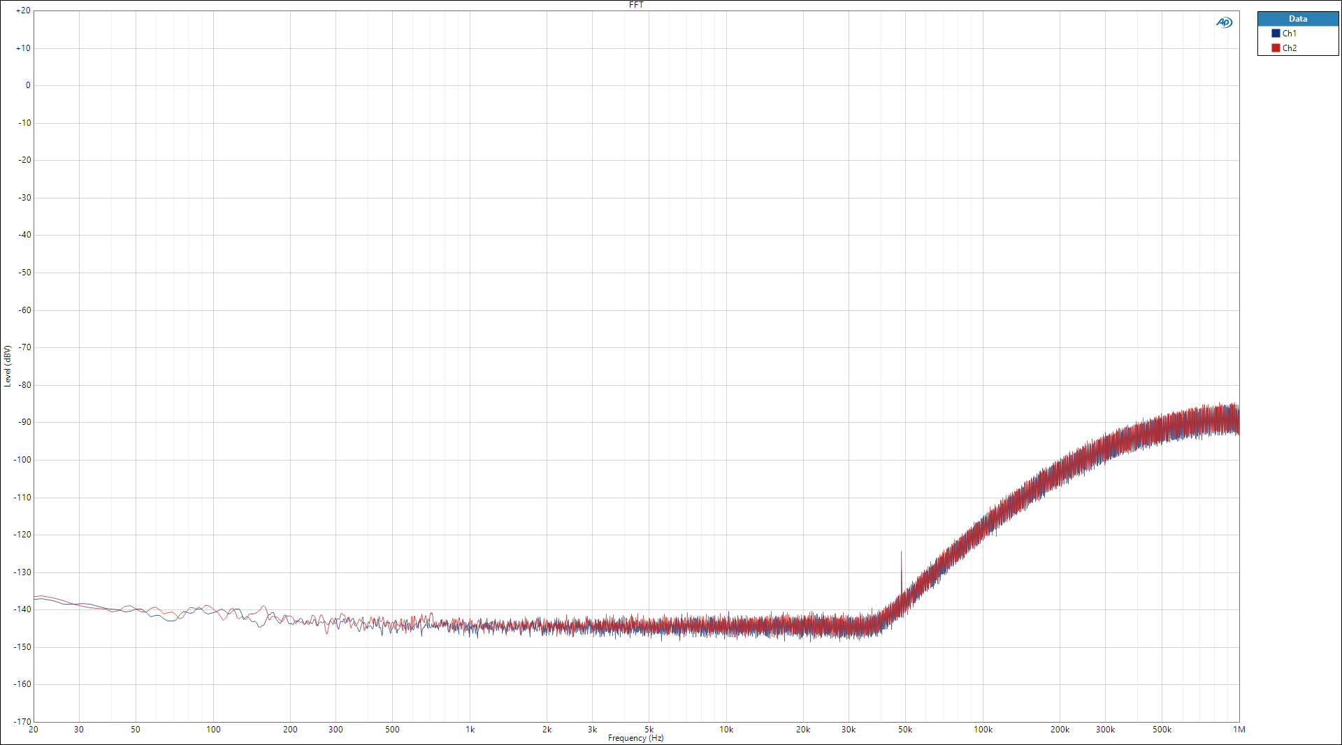

1. FR and Inter-channel matching with Digital input
2. FR and Inter-channel matching with Analog input

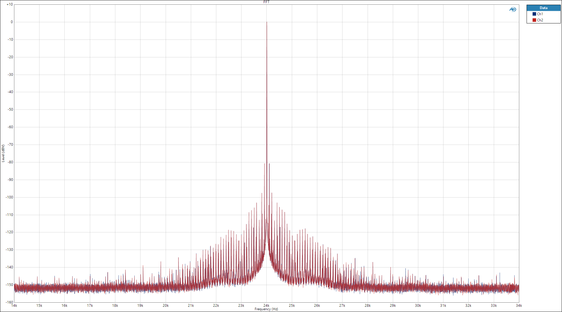

3. Jitter Artifacts - Digital input at 44.1kHz
4. Jitter Artifacts - Digital input at 48kHz
5. Jitter Artifacts - Digital input at 96kHz
6. Jitter Artifacts - Analog input at 96kHz
7. Output RMS Level - Digital Input
8. Output RMS Level - Analog Input
9. FFT 20Hz to 1MHz digital input
10. SNR at 2VRMS
10. SNR at 2VRMS

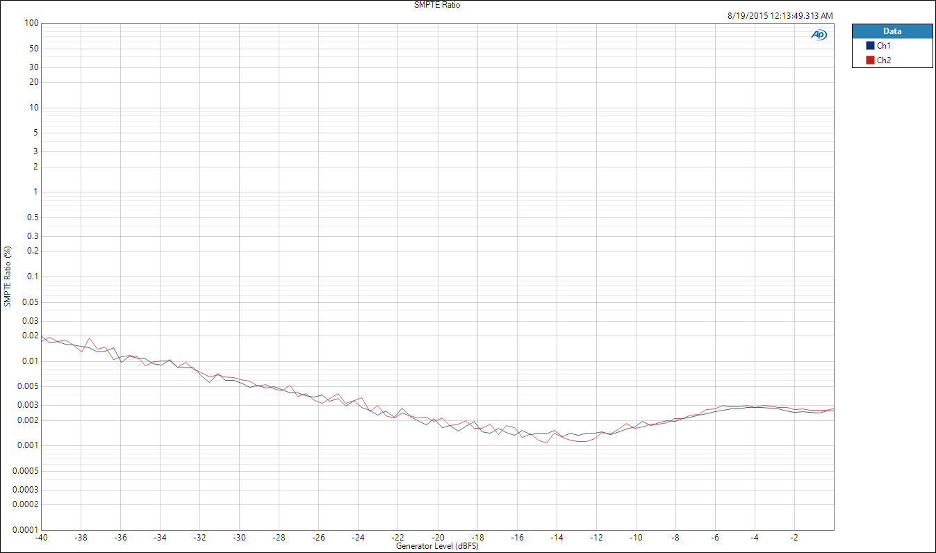

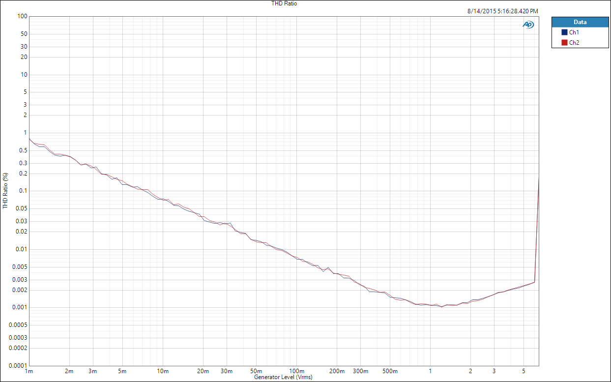

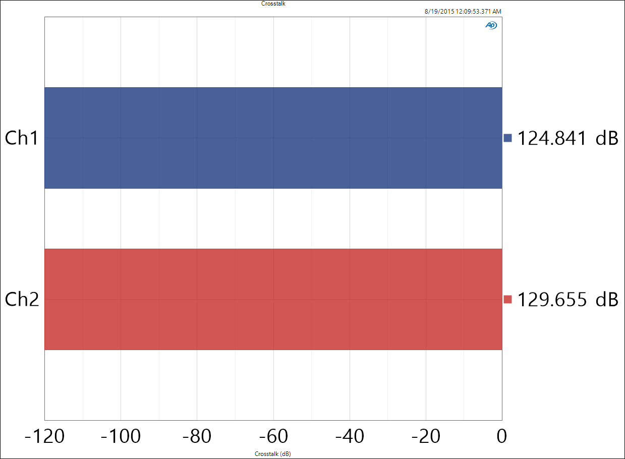

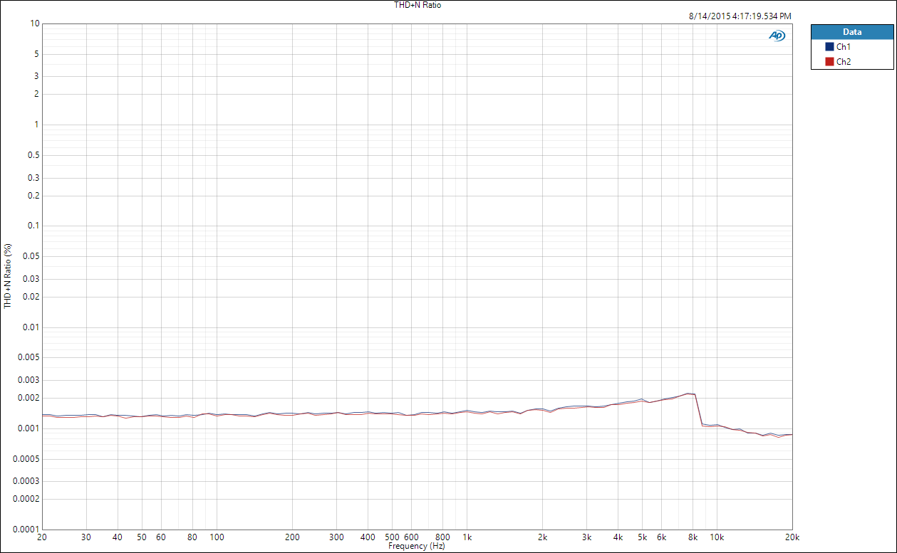

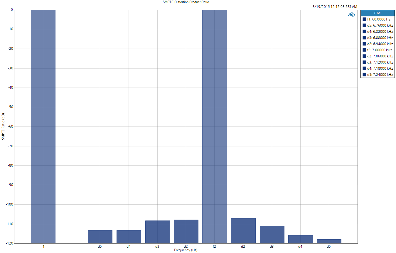

And a few final stragglers...

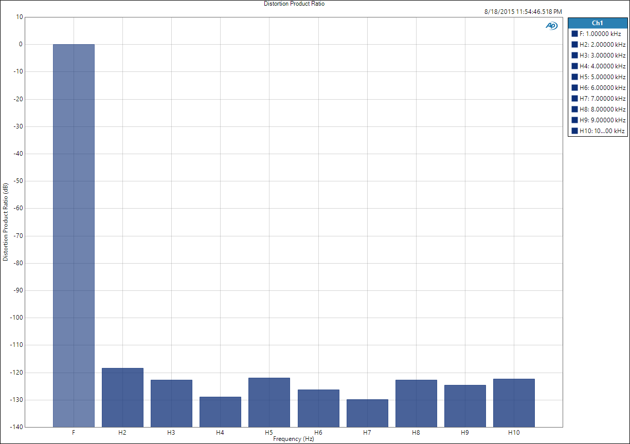

1. Distortion Product Ratio
2. Digital Input THD+N vs. FR
3. Analog Input THD+N vs. FR
4. Digital Input THD vs. Level
5. Analog Input THD vs. Level
6. Crosstalk - adjacent L and R output (out 3 and 4)

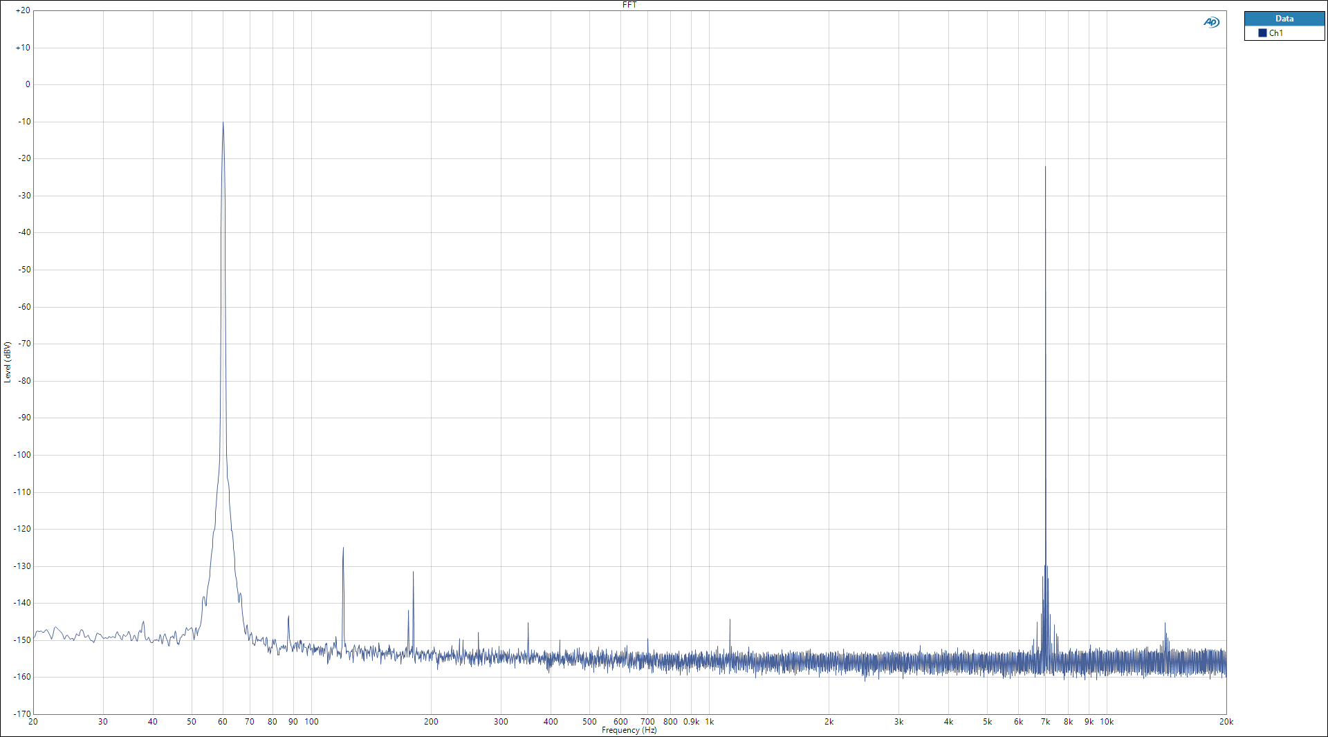

7. IMD - SMTPE (60Hz, 7kHz) vs. Level
8. IMD - SMTPE (60Hz, 7kHz) FFT
9. IMD - SMTPE Distortion Product Ratio

Well done opc. The spectral plots are impressive and noise floor is very low indeed. It seems your measurement instrument is the limiting factor here. Is it a PC/MAC-based card system? I have a question on items 7 & 8 "Output RMS Level". Since they are so low, measuring in uV, are they supposed to indicate the output level when the inputs are shorted?
Item 9 looks like the output spectrum of a DSD128 system or is it due to the switching power supply of the measurement system?
Again, your board looks and measures clean. Congratulations!
David

Hi Torgeir,
Indeed, the performance of the LME part should be identical in this particular application, so if it's lower cost, then certainly would be worth using.
The mute implementation will work with both op-amps, so that side should be fine too.
For the prices I'm seeing on Mouser / DK it's about a $25 savings per board which is very significant. I'd say go for it!
Owen
Owen
