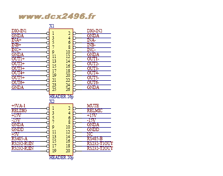

X13 is the 26 pin in my DCX and it has only GNDA,
X14 has GNDA and GNDD
opc: I can't find where the DGND is going on the schematics (J12-11 and J12-12). Is it not connected anywhere?
The same with 5V J12-13

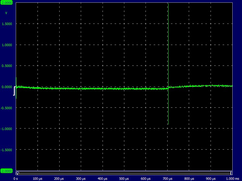

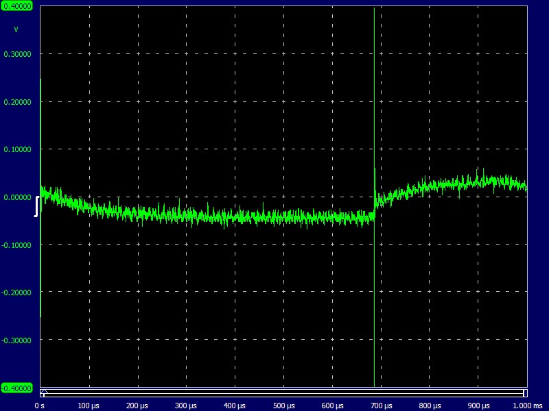

Doing some more measurements I see my problem is DC/spikes on the Vocm, in and out. mVolts to Volts that comes and goes (0.5 to 3 seconds)
Just have to search on.
Regard Torgeir
I have soldered a lot of other boards but none with this big groundplane = heatsink....
Regard Torgeir
That is some interference spike relative to the nothing happening background noise!
and the DC offset after the spike has passed.
I think it was due to caps with cold soldering to earth, but i'm not sure.
I have given up this board for a while. Can't get it stable.
And I have got a 5k ohm over R26 without any resistor. Maybe I have filled up some vias with tin or somthing. Can't get the resistance to go away.
(This is not a PCB fault, it is bad SMD soldering skills for this kind of board tolerances. Thought it would be easier to make the leap after 30 years of old fashioned soldering)

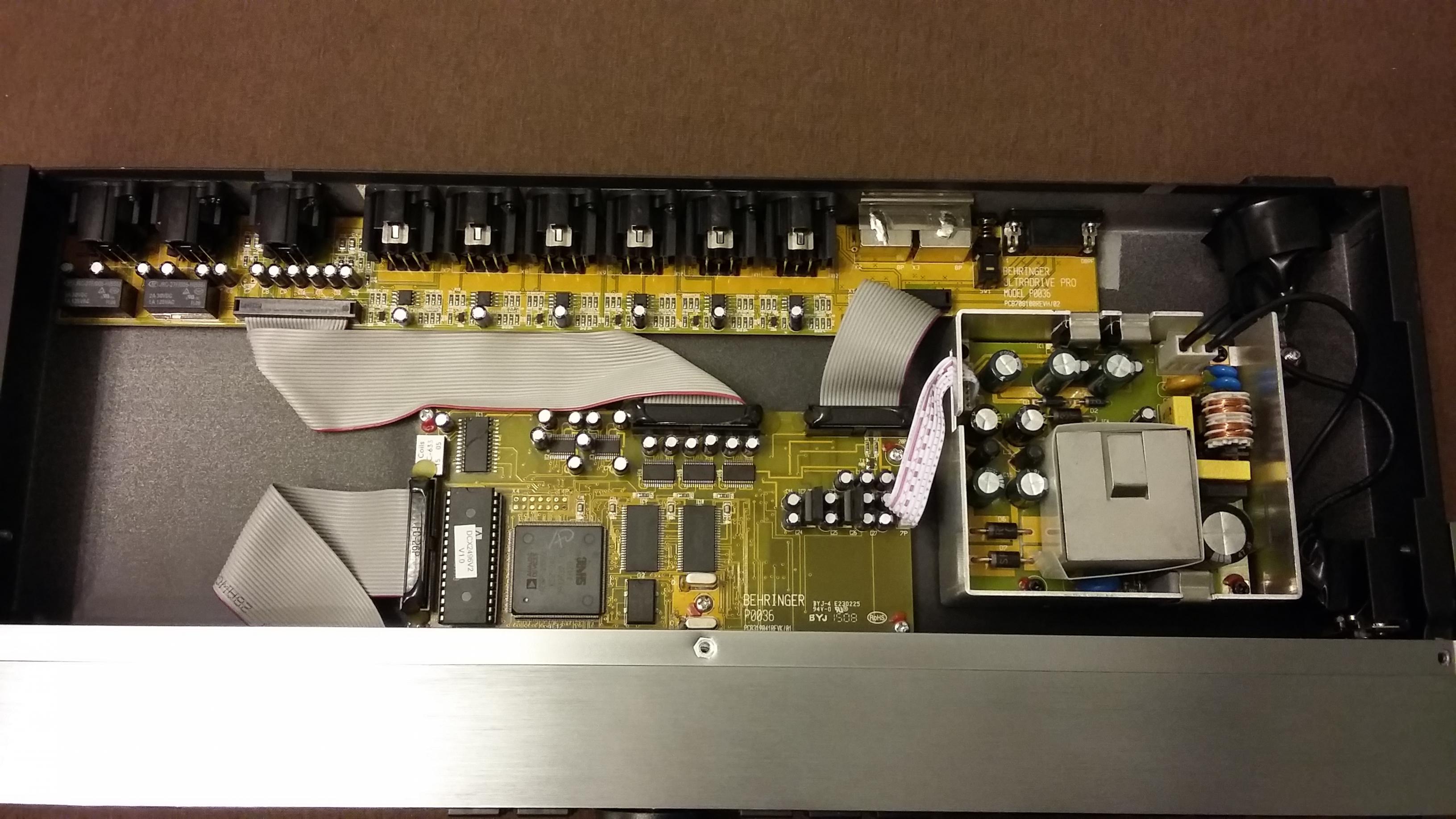

Hi, my name is Paul, I'm new to this forum. I'm from Germany and I'm a DIY-Audio hobbyist and also bought me a PA-soundsystem for private parties recently 😉
I am a new owner of a DCX2496 and I began to google about improvements of the DCX because I am not very satisfied with its acoustic performance.
1) I experience no issues with any annoying noise as outlined previously in this thread. I wanted to use the DCX as active crossover for my PA soundsystem. I have two RCF Art-712A 12" Fullrange Speakers which offer a impressively clear and detailed sound (compared to most other fullrange speakers in the same price range!) but also have a pretty high noise level even without any signal source connected to them. It made no noticable difference when I connected, disconnected or muted/unmuted the channel of the DCX to the Speakers.
Behringer seemed to redesign the DCX in some points, for example they removed the PCMCIA-slot. Maybe the also redesigned the internals of the DCX so the noise is not an issue anymore? (I will open it and post some pictures here soon if wanted)
2) I can't use it for my PA-Soundsystem. I totally agree with Points 3 & 4 of opc's entrance-post. The DCX is making the music sound dull and washy. It is somehow reducing the detail in the sound. Cristal-clearly shaped sounds sound very boring after the processing with the DCX. So the DCX is dramatically destroying all the features of high quality sound my expensive RCF Art Speakers offer. Therefore it's nearly useless for me and I think of sending it back to the merchant 🙁
My hope is now if someone can relate to this issue and can tell me if the Problems can be solved by replacing the input- or output-stage of the DSP. I really want to get high-end hifi-sound. It must not be noticable that the DCX is in the signal-path afterwards. Can anyone tell me if that is achievable (with acceptable effort) or if I'm better off sending it back, buy me an analog active crossover and abandon the features of a digital ls-management-system such as parametric equalizers.
Thanks for any help!

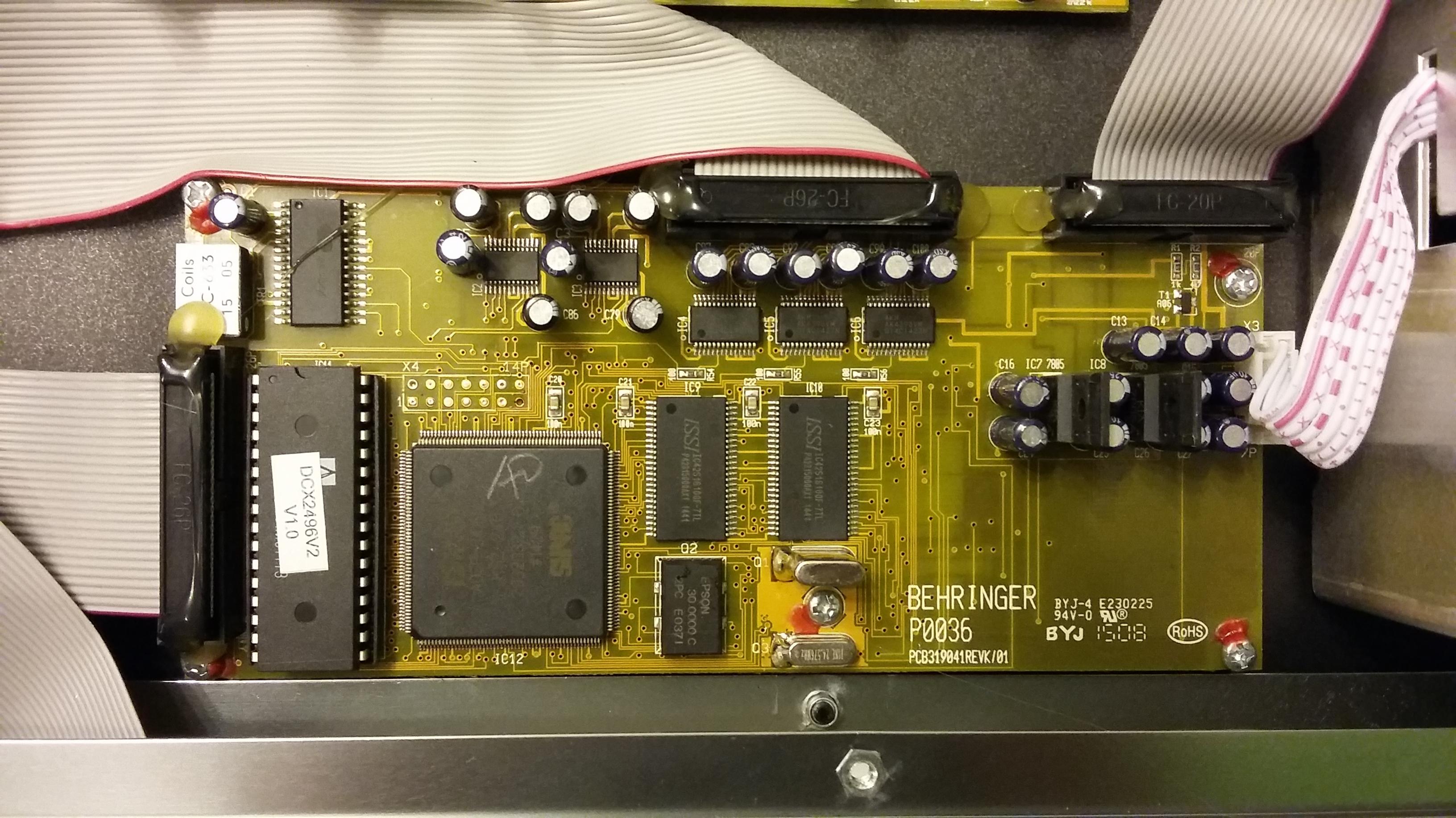

Some additional information: I am using the analog inputs of the DCX an probably never will use any digital input. So my issues can't be explained by the problems with the digital input stage.
I couldn't help and just made two photos. Looks slightly different to me than everything I've seen beforehand. They seemed to merge the input- and output-stage to one board, which makes it rather complicated, when not rather impossible to chance specific parts of it 🙁
I think i will better send this one back. What a pitty.. the features of this DSP are nearly perfect for the price but the poor sound makes it completely useless to me.
