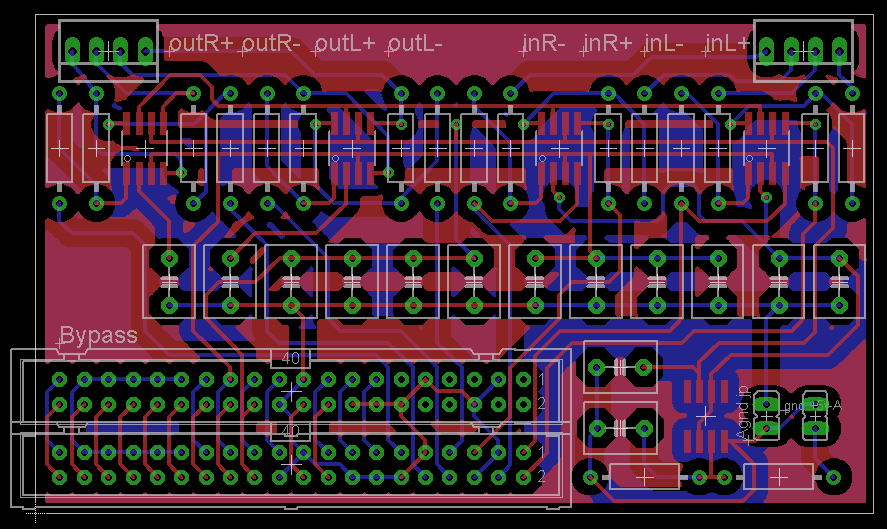

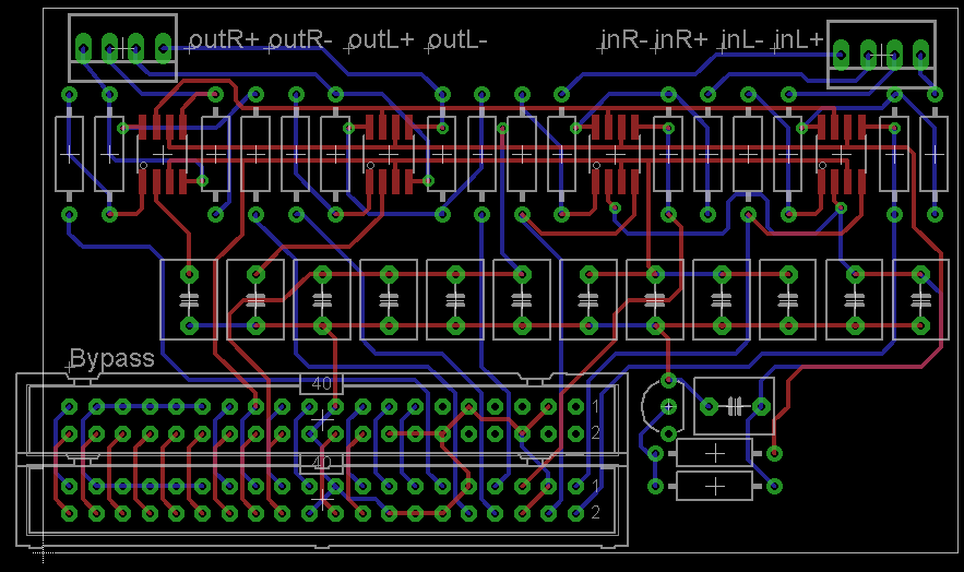

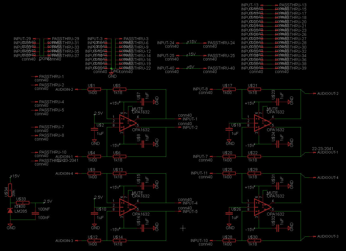

OPC, are you willing to field a couple dumb questions (since I am no EE)? It would very much help me.
I am about ready to move forward with my board. It will be a tester for a DEQ (so I only put together 4x channels rather than the full 9 for the DCX). I modified the circuit slightly. Two changes:
1. I removed the 12V regulators. I assume they are there to get that last bit of hiigh fidelity performance from the analog stage, but my environment is such that I could not take advantage. For me, a very low noise floor with no change in OEM gain would be the only need, any gain in fidelity over the OEM analog stage is bonus after that. Combine that with a not-insignificant cost and difficult package to deal with and it is an advantage to remove the extra regulation. Can I assume this is OK, and the only "cost" to my sound is (an expected very-minor) loss in fidelity? Is that a true statement?
2. This is where I really need a second opinion. I used someone else's 2.5v circuit due to requiring fewer components. It uses an LM285 with a couple resistors and a filter cap. I chose this because without the tightly regulated 12V circuit, using voltage dividers was not as confidence-inspiring for generating 2.5v. Are there any sonic costs I should be aware of going this route?
I uploaded screen caps of my schematic and planned board. The whole thing will sit on top of the DEQ, allowing me to use a much smaller chassis.
It's perfectly fine to omit the 12V regulators from the design. They may provide an ever-so-slightly better noise floor, but it's probably not worth the added cost and complexity. Just power everything off the existing +/- 15V rails in either the DCX or DEQ.
This is one area you really should be careful. This voltage is critical as it's the reference voltage for the ADC inputs, which means the audio signal will be referenced to this voltage. Any noise or fluctuation here will have a significant impact on the performance of the ADC. It's always best to derive it directly from the 5V analog supply for the ADC (which is readily available) and use a high precision resistor divider with a buffer to drive the VCOM pin on the OPA1632. This way, it tracks the ADC supply voltage, which has several advantages. This voltage is critical enough that it's worth the added trouble and expense.
Owen
Hi Owen,
One last question. The DCX has a "5V" and a "5VA1", looks to me like the DCX derived its own 5V just for hte analog side. So that made perfect sense.
The DEQ as far as I can tell does not do this? I just have access to "5V" from the power supply on the 40 pin connector. I'm not sure I can guarantee this voltage will be 5.00 volts, and assumed it was used for "digital stuff" besides. Can I use the 5v if it is designated 5v, and not 5vA1? If so I can modify the circuit right away to use your suggested design, digikey of course has all the parts.
I'm just not confident I can use "any old 5v" found with respect to the DEQ. So, do you think it would be better for me to use tight-tolerance resistors on the standard 5v to divide to 2.5 and go through a buffer, or for the deq, will the LM285 be the better choice?
(I will definitely use your circuit for the DCX's when I get there since I have the 5vA1 pin to work with)

Final board, thanks Owen.
It's huge @ 2"x3.5", but the traces are so far apart and all through hole components minus five SOIC's that even a fool (me) can put it together. Including using the toner transfer method to just make a board at home, since we're talking about a one-off. Might use a build house for a DCX version and order 3x.
Looks like $70 at digikey buys all the components to do one DEQ and two DCX minus the $6 opa1632's for the DCX processors. (and the boards of course).
Steve
Steve

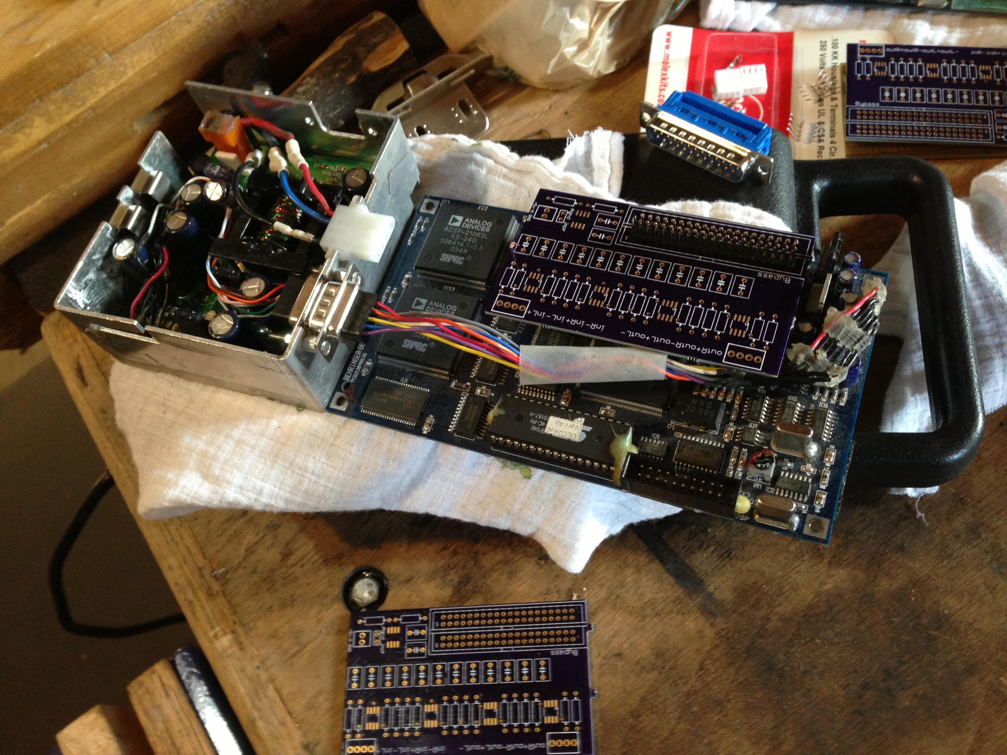

I changed the connectors a bit, but other than that, I build one board. I forgot how tough it is to align connectors when there are more than 3 pins (much less 40!) so I sent it off to a build house to make for me. I hope the performance works out without having to dig into the analog 5v supply, clock, etc. For me, if I can get the whole DEQ package into a chassis that is the same footprint as the DSP+PSU side-by-side with equivalent or better sonic performance and equivalent or better noise floor I am golden.
Will put in the digikey order late this week for the parts.
Huge thanks.

Hi Owen,
I built the board the other day. Minus some small hiccups, it works! clear sound, no noise floor (or at least, no change in noise performance compared to the original on the test bench).
Success!
(minus some odd decisions I wish I did not make, like lining all the caps up together)
Anyways, I am posting because I want to ask you, what is the danger of replacing the 1.18k ohm resistors with 1.5k? Or replacing the 1k resistors with 800 ohm resistors? Should give me about 30% more gain?
Success!
