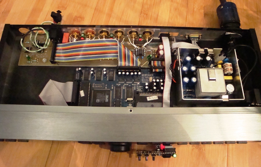

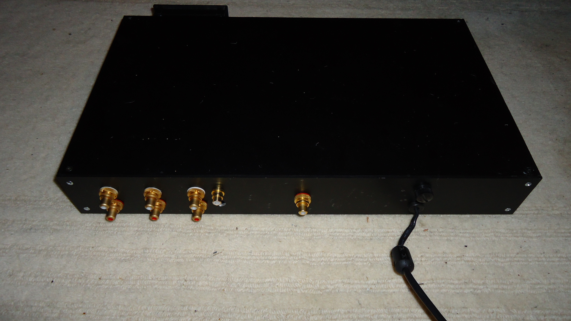

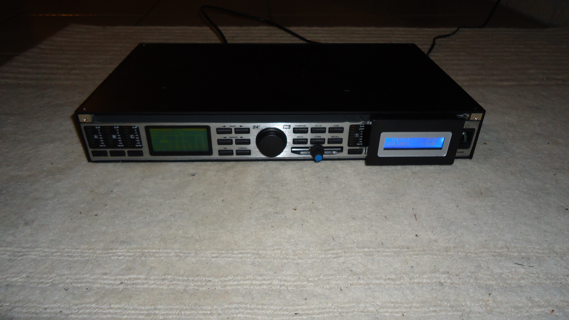

Many pictures, of course 🙂

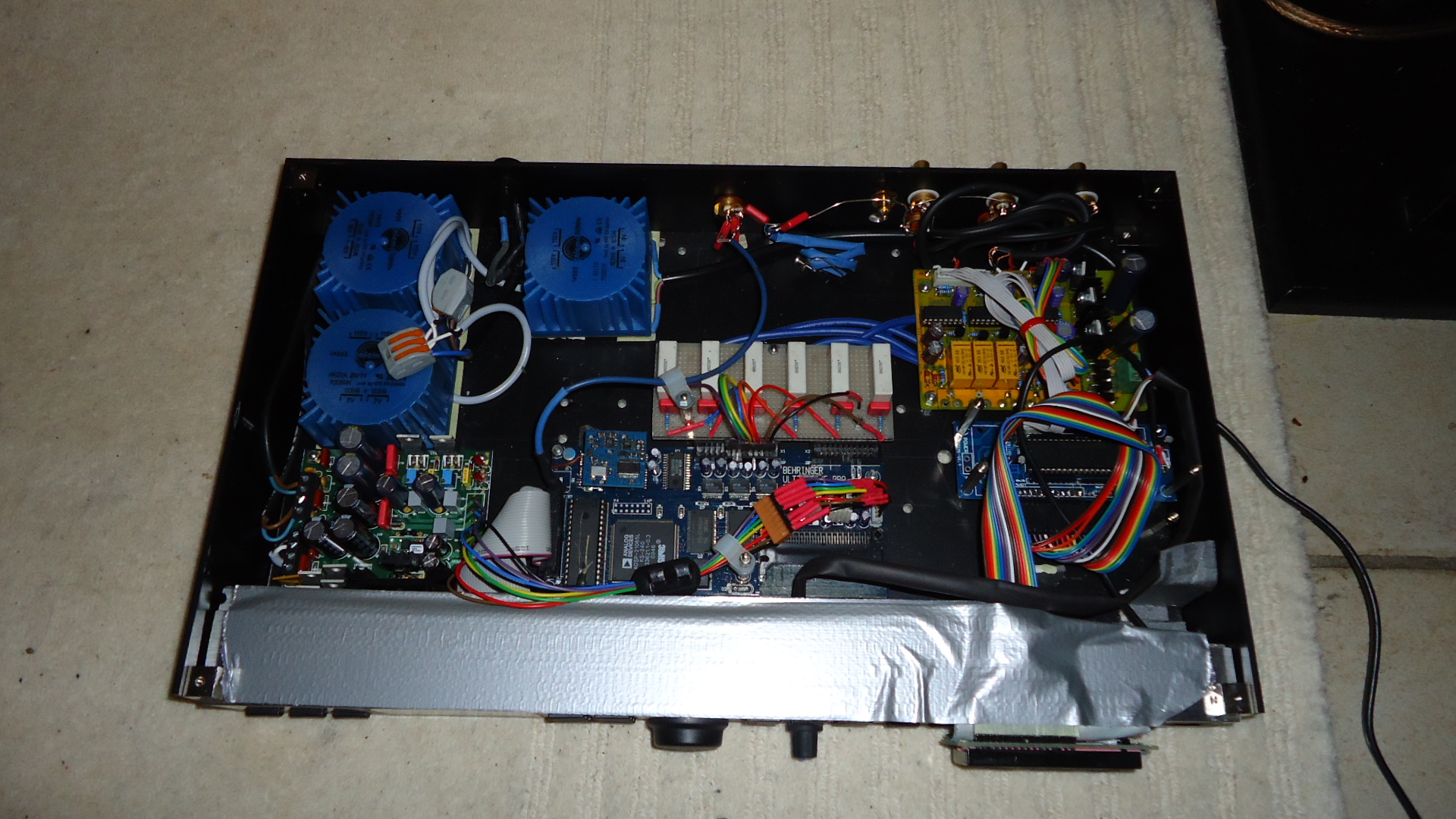

I'd be very interested to the "one of them i build in a 6 channel preamp/volumecontrol based on 3 PGA2311 (very cheap 5.1 ebay Chinese)"

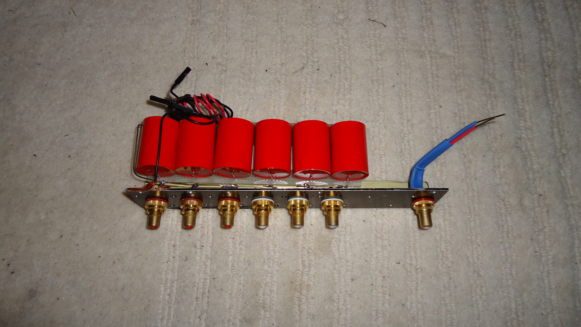

Here a pic of the 6 channel preamp DCX2496, without top..
and a passive out with digital in RCA replacement, out old board in this part, connect to DCX main board et voila, a very good sounding DCx2496

DCX2496 with 6 ch preamp remote controlled
A few more pics of closed box

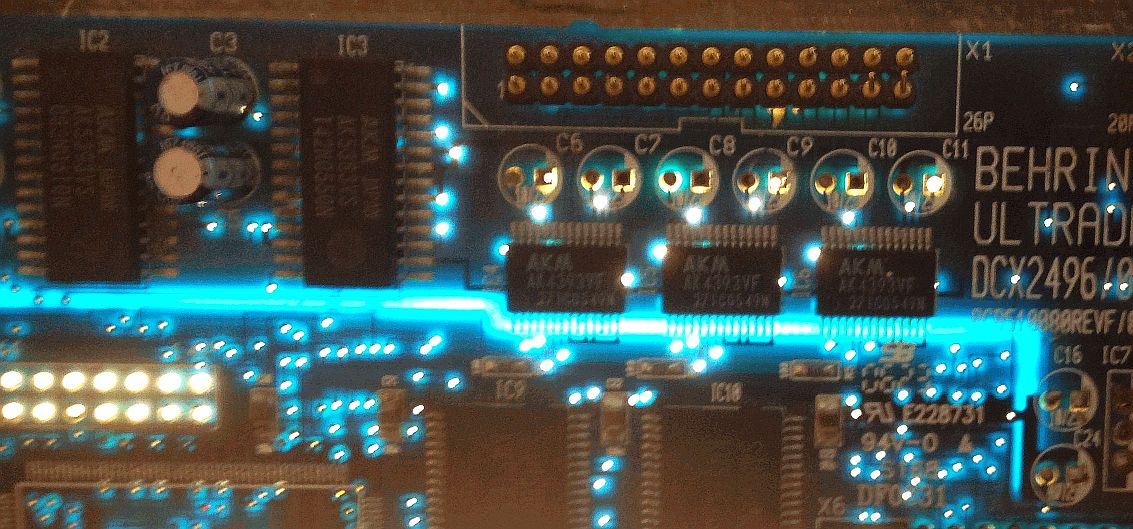

Something to think about
"If you do split the ground plane and run traces across the split, there will be no return path near the trace and the current will have to flow in a big loop. Current flowing in big loops produce radiation and high ground inductance." (More on that here)
The split GND planes on the DCX board are there by design. Although I don't personally agree with this design decision, many DAC manufacturers still suggest it.
The purpose is to split the analog and digital return paths to avoid getting the high frequency digital return currents flowing through the analog plane.
If you look closely, you'll see that they don't actually run any critical traces across the gap between the planes, but that the DAC IC's do straddle the separation.
Again, this wouldn't be my personal approach, but it is very common practice and can provide some benefits if perfectly implemented under ideal conditions.

Obviously ... 🙄The split GND planes on the DCX board are there by design.
So it is. But in this case it is made in the absolutely worst manner.The purpose is to split the analog and digital return paths to avoid getting the high frequency digital return currents flowing through the analog plane.
What lines are critical if not clock and data lines? 😕 Where is their return path in that lousy design?If you look closely, you'll see that they don't actually run any critical traces across the gap between the planes, ...
It will provide essential benefits if implemented just right.Again, this wouldn't be my personal approach, but it is very common practice and can provide some benefits if perfectly implemented under ideal conditions.

Does anyone have a link for the ribbon cable pinout to the output board? I'd like to make up some simple passive boards.
