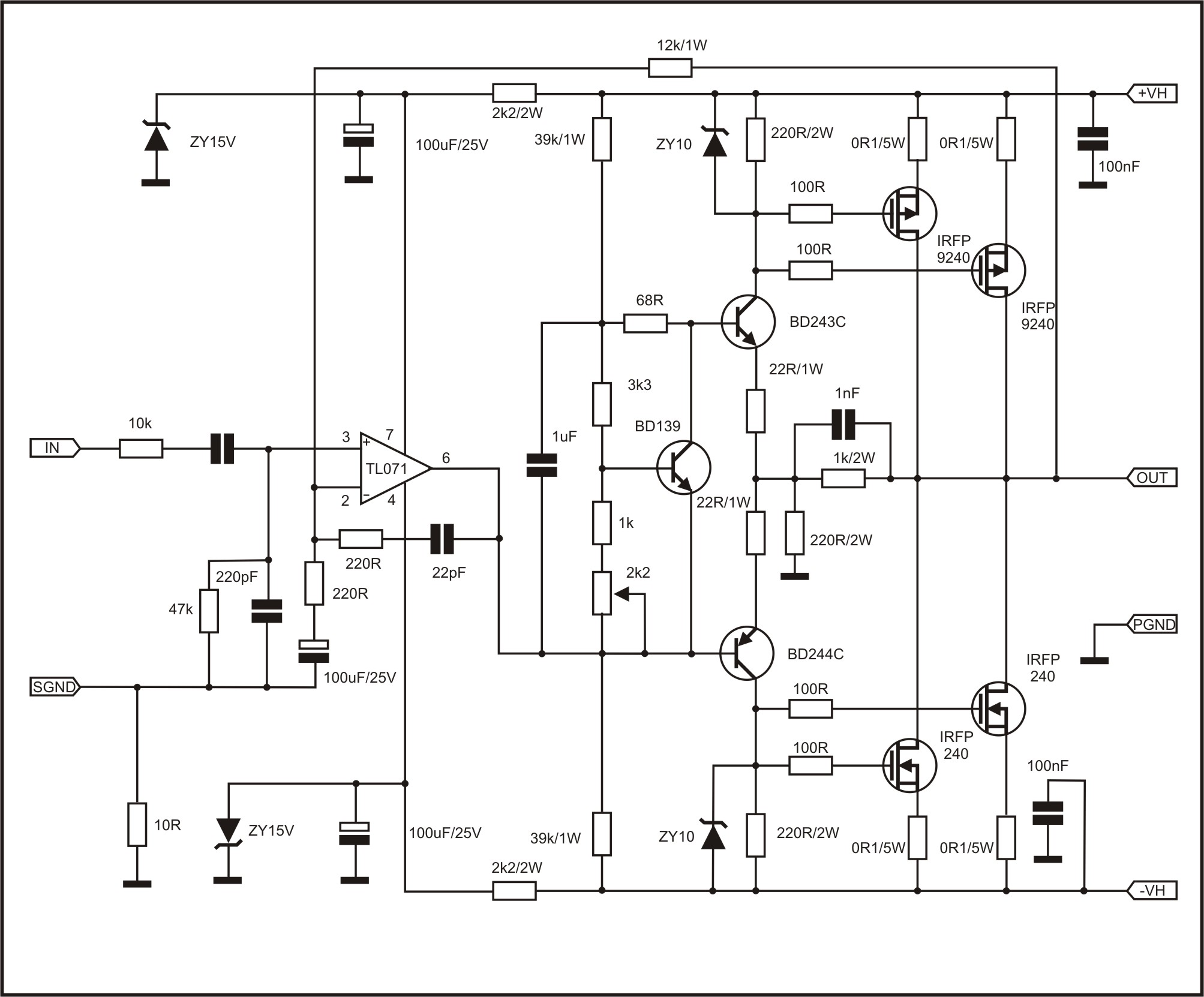

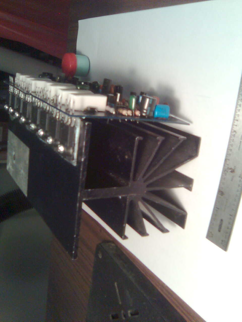

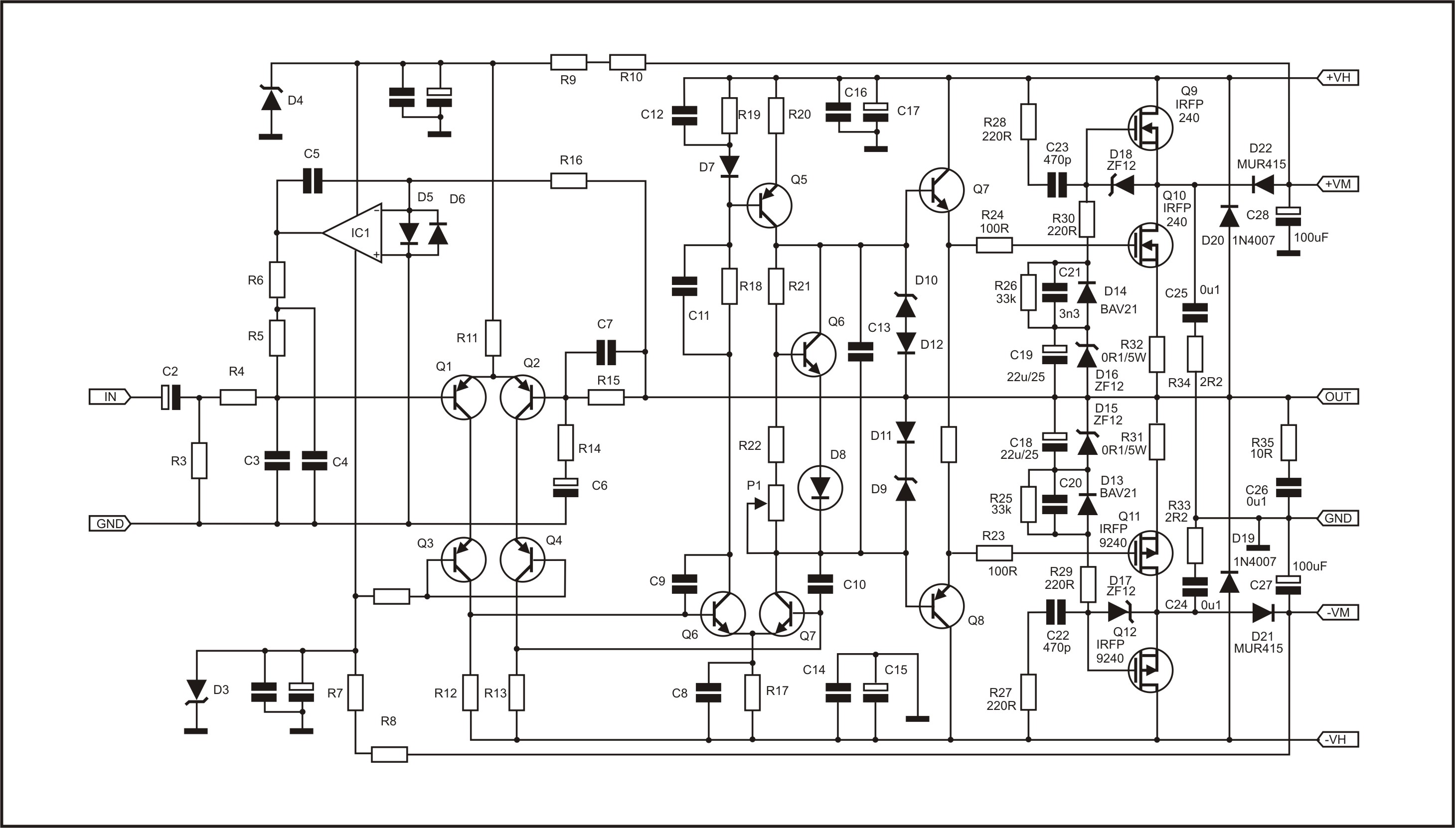

Apex seems i begin to love this amp 😀...the corrected clear schematic is this...
with different R14 values(tried 22k,30k,56k) and different supply voltage, circuit gave 50W-200W on 8ohm with great frequency response....

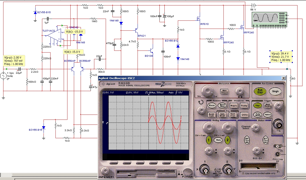

i try now to use opamp at front-end for smaller and simpliest pcb....
i tried many opamps so far (opa637,tl072....) but only the NE5532 gave a good result...60W/8Ohm
using +-50 supply and 30k(R14) on feedback...
i 'm not an expert on opamps so,any idea which other opamps to try?

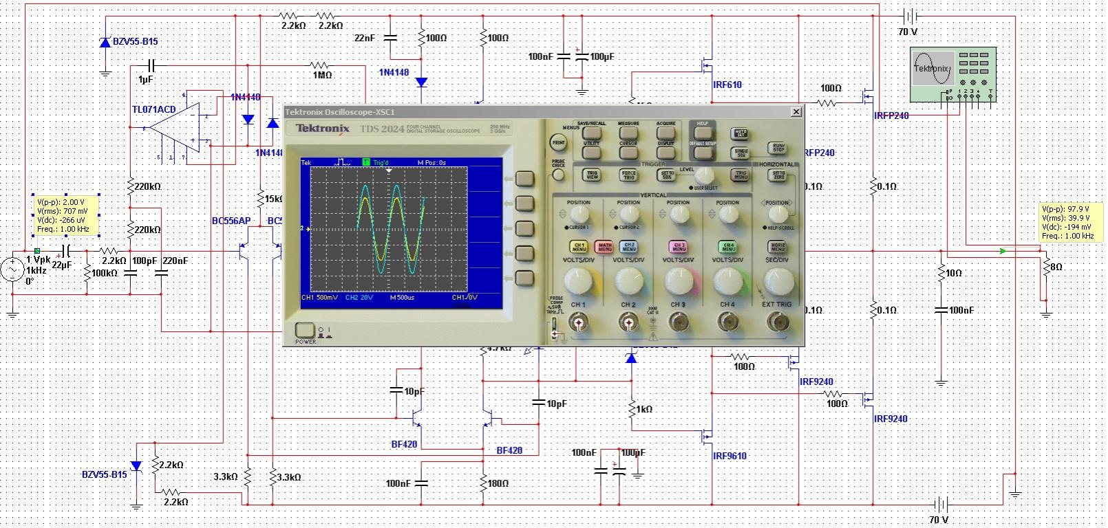

the circuit i try is this....
is there something that im missing?also the sine is not clear at output...seems to have much distortion...

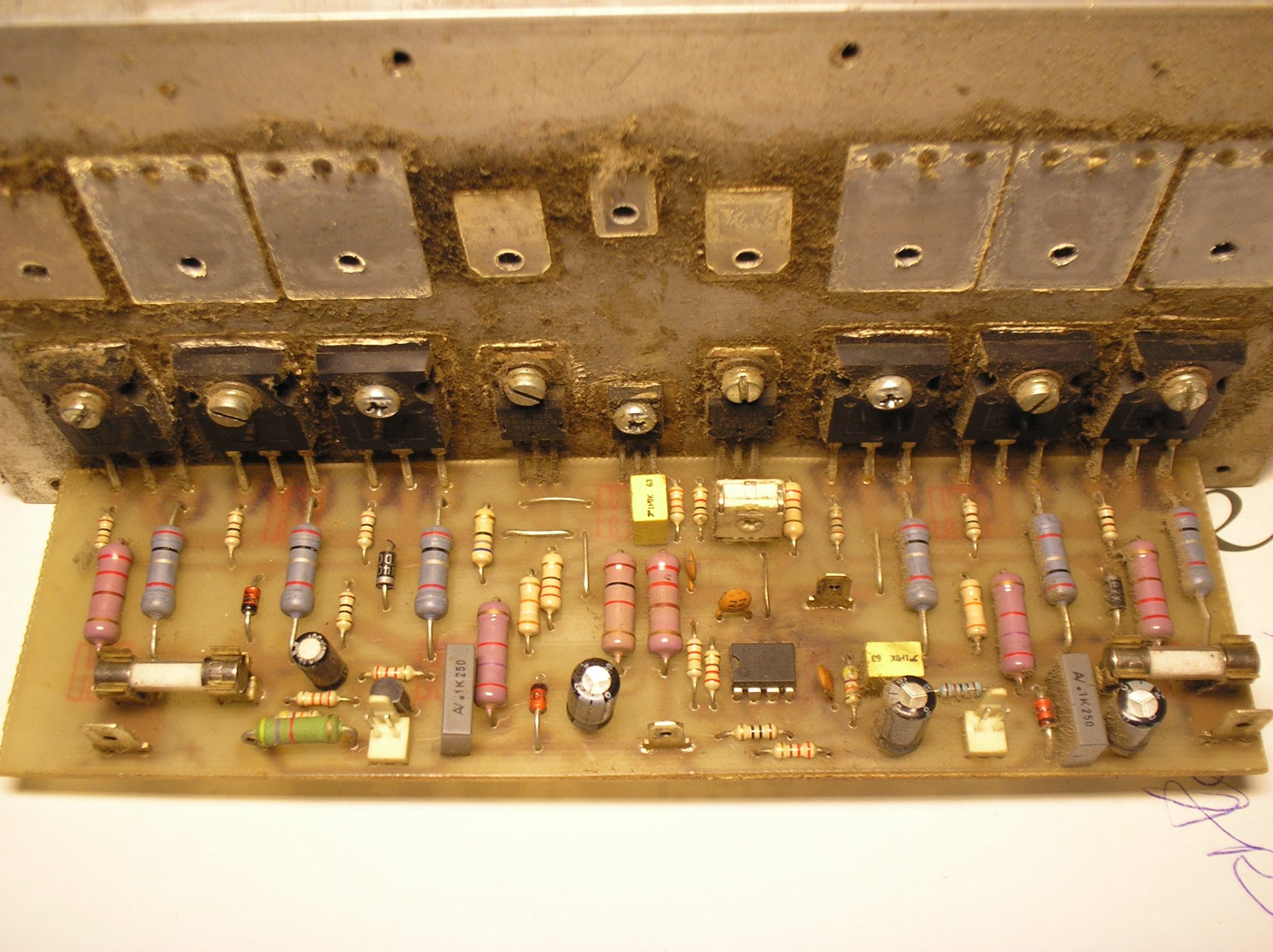

You can see PCB for this circuit in thread http://www.diyaudio.com/forums/solid-state/162043-mosfet-amplifier-irfp240-irfp9240-26.html post #253.
hmm..wasnt so easy as i though...
similated with no good results...~18W/8ohms 😕
with R12=1k...
with R12=1k...
oops....forgot it.....once more thanks for help...
fixed & worked
i changed values on R14 & R28 for ~110W/8Ohms
sine

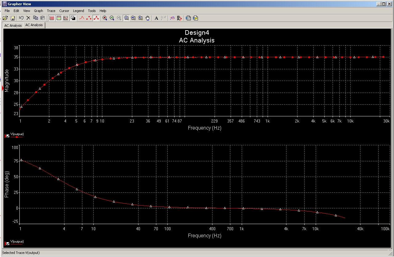

the frequency response wants a fix....and you know i got 110W at 1Khz...
fixed & worked
sine
no...nothing changed
This frequency response is to wrong to be real. In real life response is ok.
