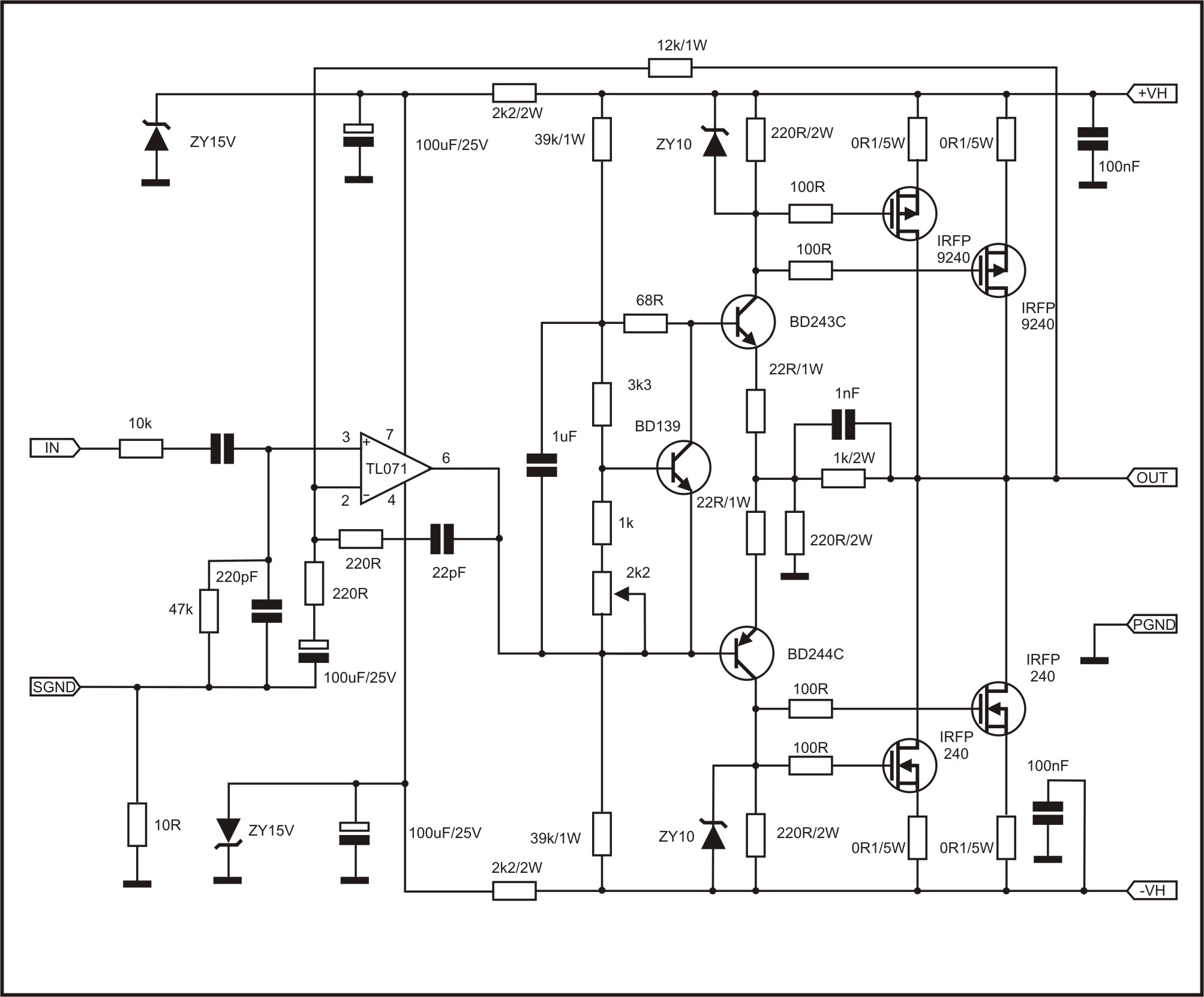

i changed values on R14 & R28 for ~110W/8Ohms
110W/8R with +/-50V rail voltage and useing IRFP mosfets is powerfull.

something goes wrong after the opamp stage....trying to find it....
Try with 100R for R8 instead 1k, and 22R for R10 instead 220R, and use 2k2 for R12...
with this setup response was very well but with something pV at output...
i leaved the R12 at 2.2k and i played with values of R8 & R10 because there seems to be the problem....
the better response i got so far is with R10=5k & R8=100R....

BD243/BD244 work with voltage gain x5 (R8/R10), with 5k for R10 there is no enough gain. Try remove C11...

PSU +/-56V 5A , bias 100mA per mosfet.

This is my very old amp (see post #99), there is no any files, but no need for new pcb design, just copy from old pcb.

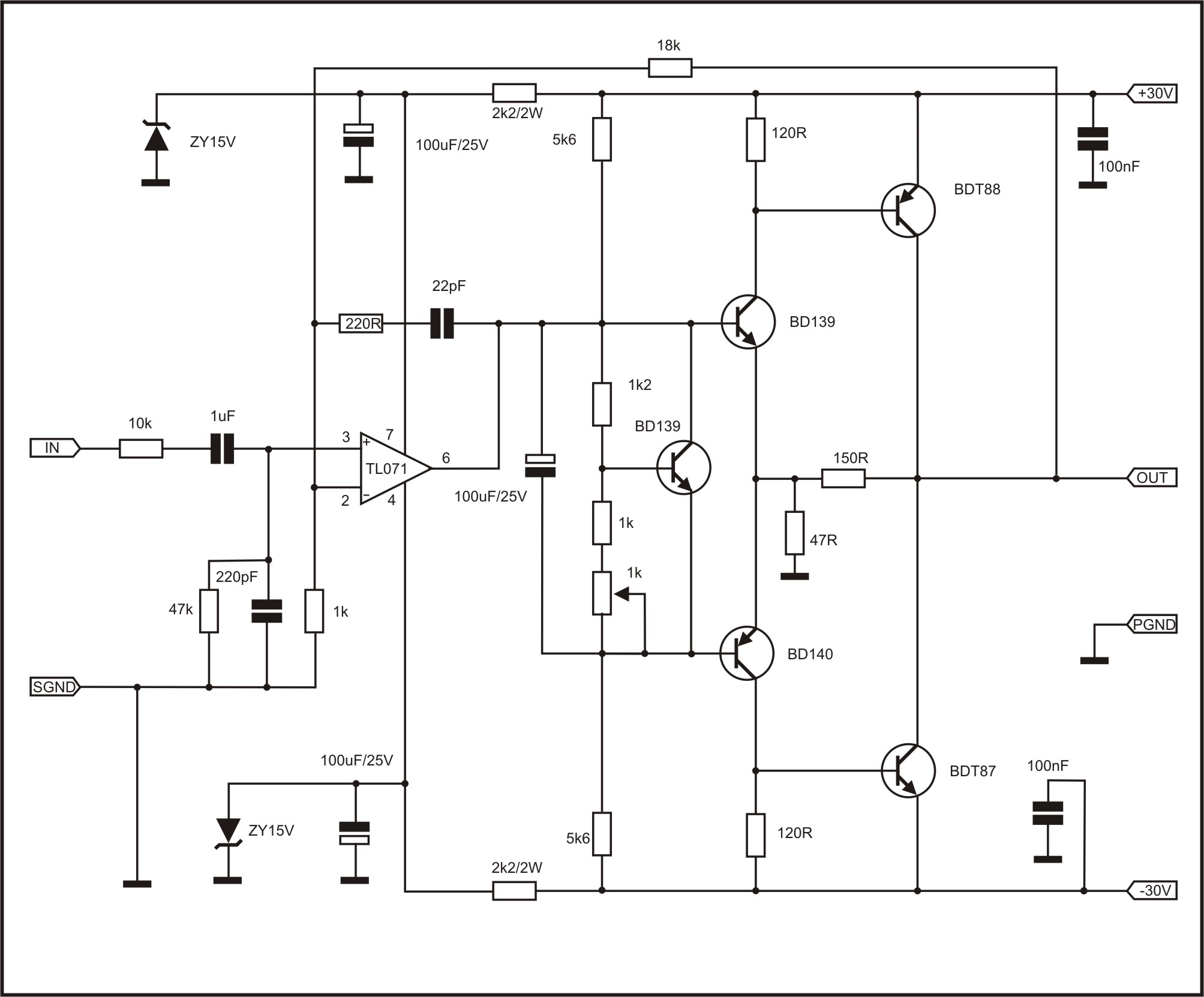

hmm..ok seems that ac analysis in this circuit cant work well or something else dont know..
i changed frequency manually from source and i got same output for all the bandwidth....🙂 i was like WTF 😕...

Actually is not that multisim doing wrong but its difficult to understand its mind and how it calculate some things...
if i find time i will seperate the schematic into stages and i will see which stage doing this low-pass filter response....
i have already tested the opamp stage and i got clear response...

Apex seems i begin to love this amp 😀...the corrected clear schematic is this...
with different R14 values(tried 22k,30k,56k) and different supply voltage, circuit gave 50W-200W on 8ohm with great frequency response....
