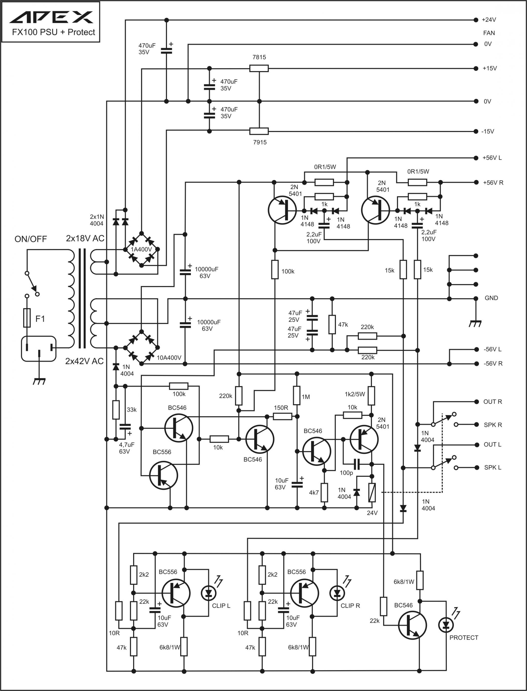

Hello Terry
greetings really fast work in picture you use 560 ohms in parallel with the 2
in4148 in series any reason schematic shows 1K on my protype build over
current protection would kick in at 70% volume on 2 pair ax14 version adding
.22 5 watt in parallel with the existing .1 solved the problems
warm regards
Andrew

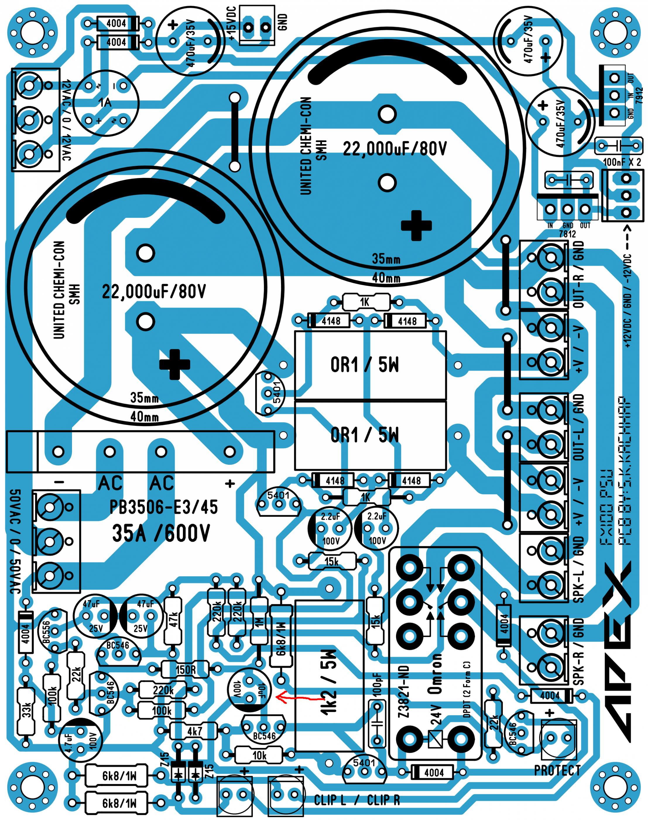

In addition to above the 4148 diode appears to be reversed.

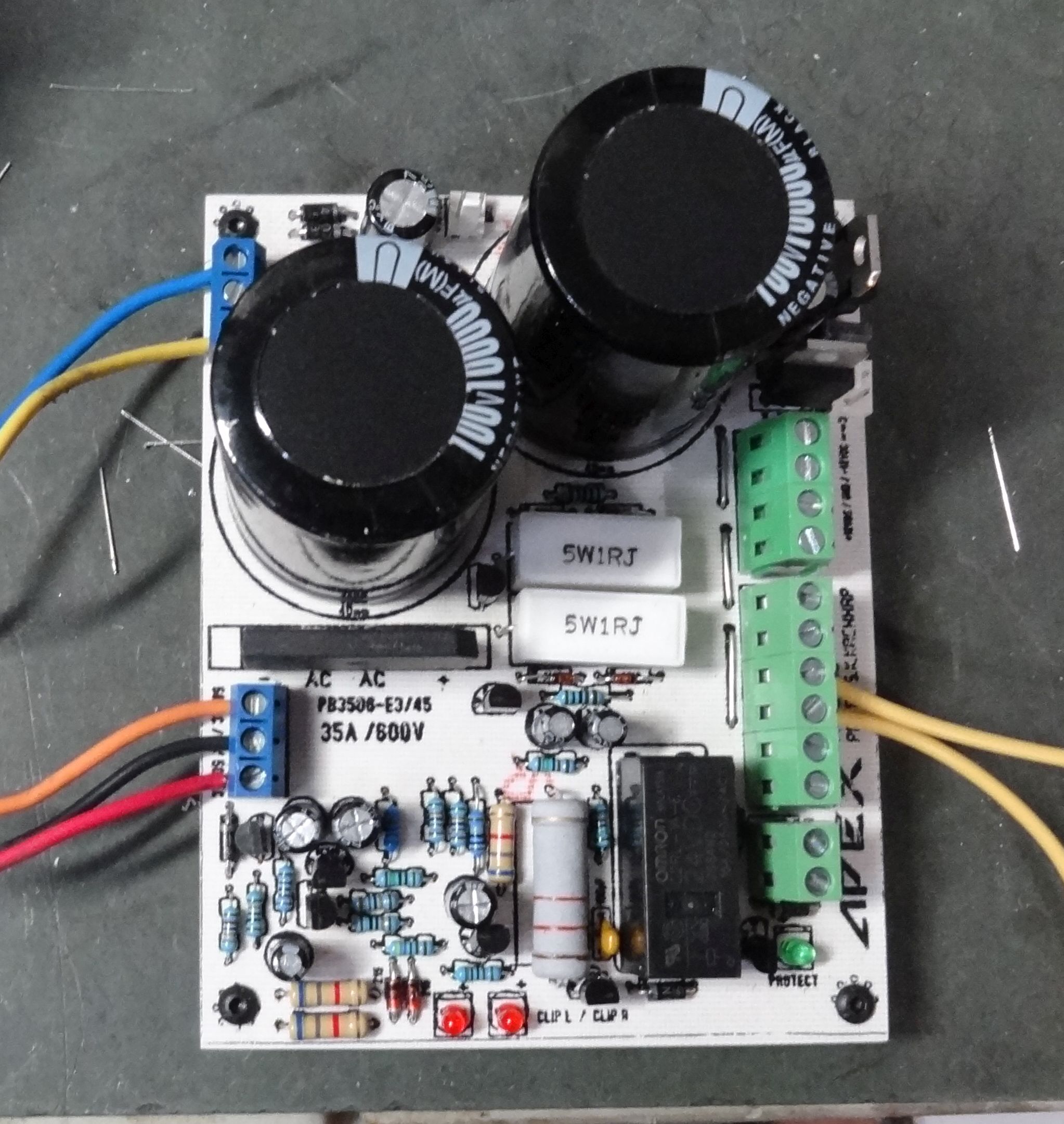

And we have very good news! the amp plays really nice. I have installed all 3 pairs and playing music thro test speakers.
I figured the problem with hum was due to me twisting both left and right channel grounds together on the i/p.
Also, it seems the amp gets better and better with bias with 3 pairs. earlier it was around 70-72 mA per pair with 32 V supply- not so good. Now its 90mA per pair with 45V supply, really nice. I would like to increase it further to try but current heatsink is limiting factor.
Thank you Mr. Mile!.
@ Andrew
Ah! why didnt I think of that!. Guess when I am building something, I miss even trivial calculations. Thanks for the tip, but its working fine with 24p in those places.😀

sorry for poor quality pic, its mid night here and too lazy to get the camera out.
