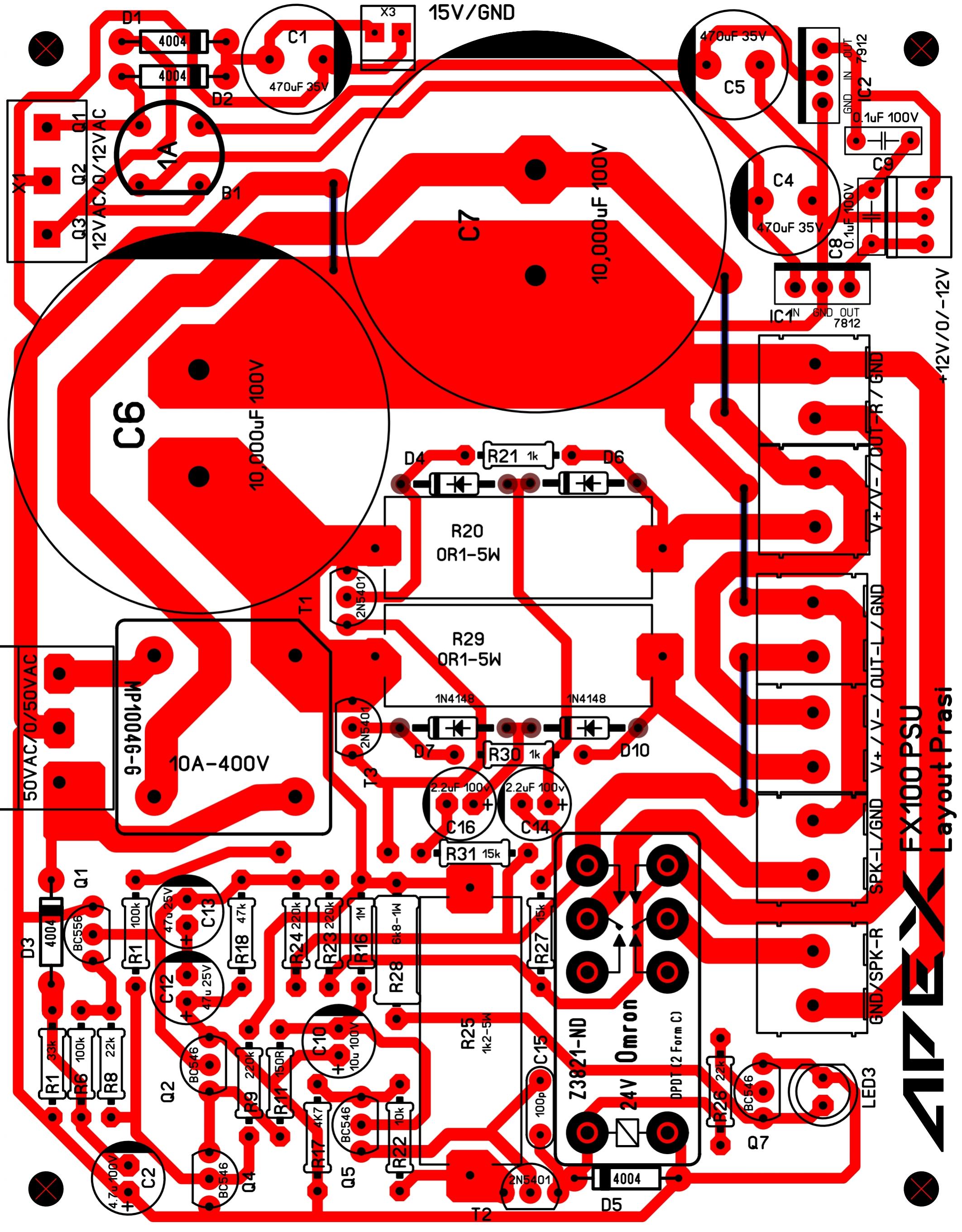

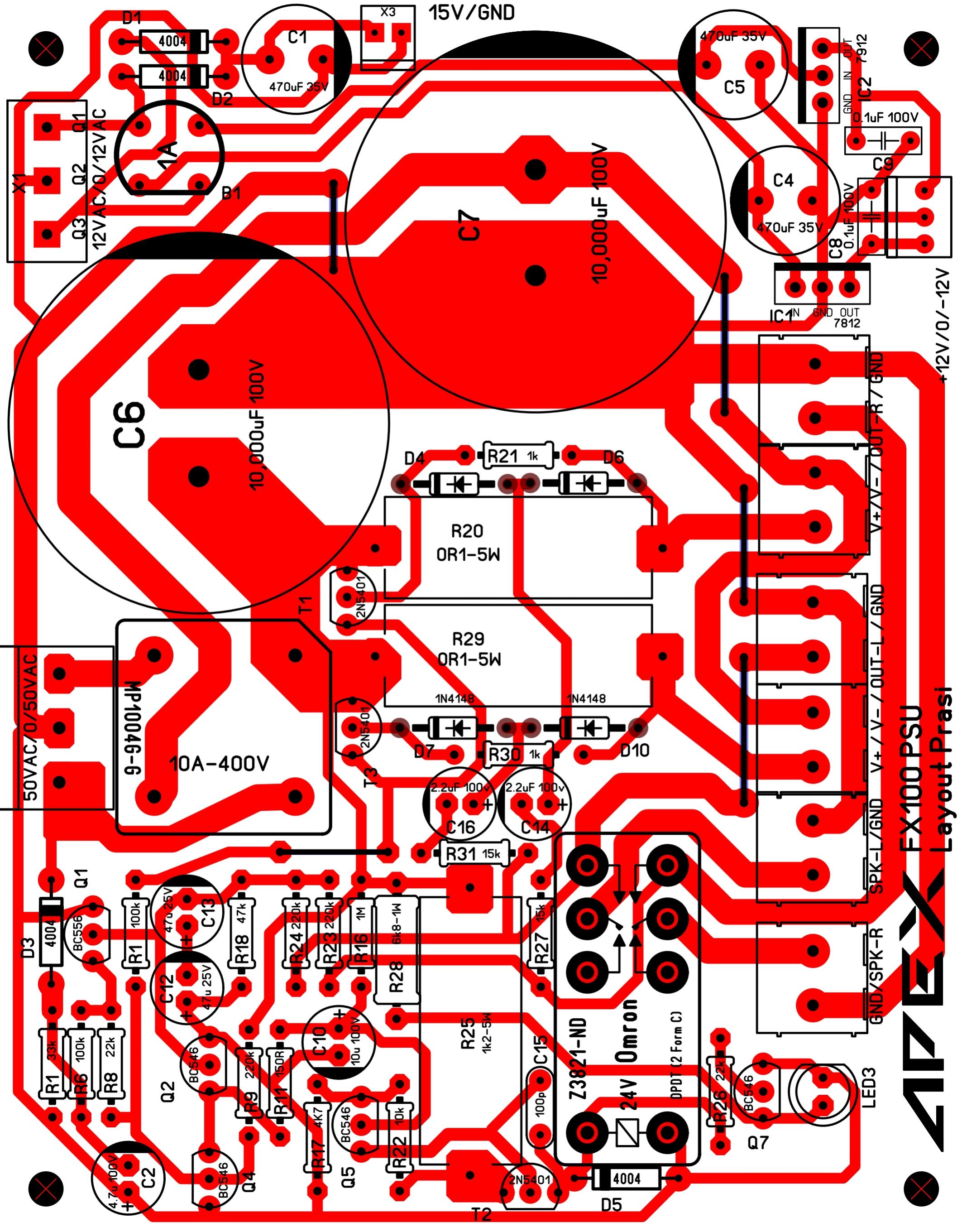

Hello Andrew,
Pl find attached the files. bottom copper is view from copper side view. The line on copper pour doesnt matter, it prints fine. Its just shows like that (lines) on computer display.

Yes, though I'm not positive it is correct.
I did a quick sprint file from Prasi's FX100 PSU layout. If someone can check it for errors I can post the Sprint file.
Hi Terry, Nicely done. I havent seen with eagle eyes, but I see 2 things. C10 orientation, missing jumper near big rectifier.

C13 polarity must be reverted...

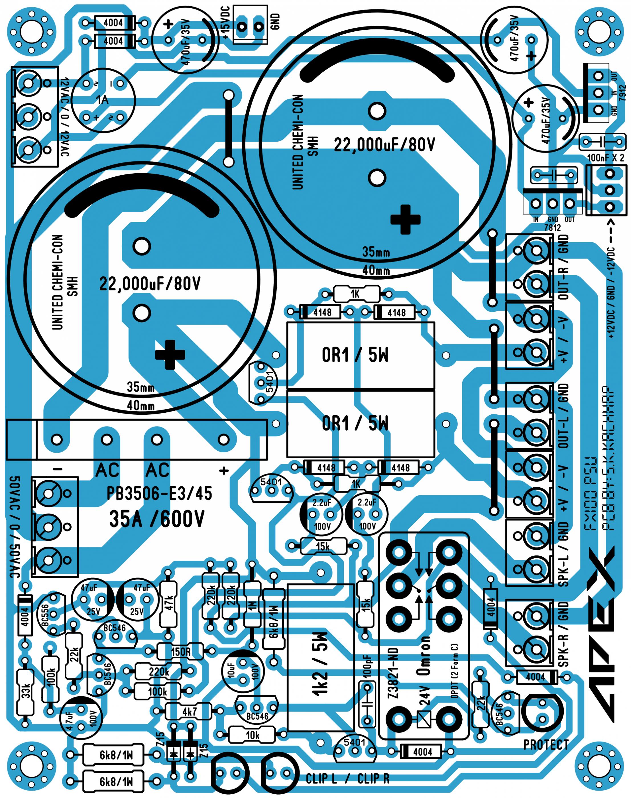

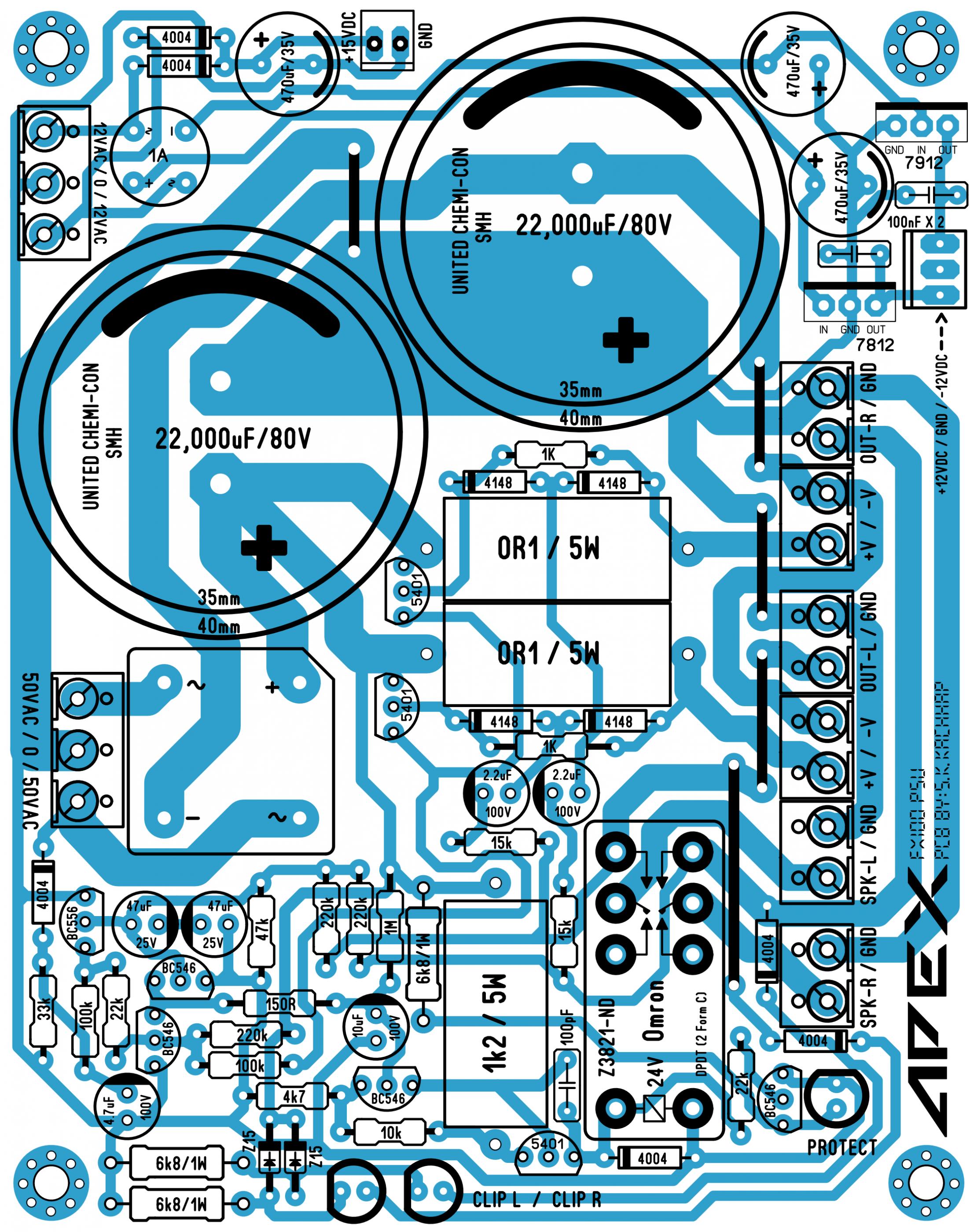

Hi Andrew, I have completed my version of FX100 PSU with space for 22,000uF capacitor and I added simple clip indicator from Mr. Miles used in his other circuits.
You were concern about increase of pcb size when using larger capacitor . PCB size is increased from 90mm X 115mm to 94.5mm X 119.5mm.

Very Very nice. I will use this one.

FX100 PSU pdf and sprint files.
