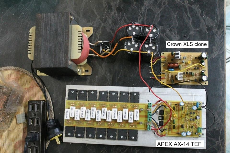

Amplifier for 1R load

High efficiency (classH), high power (200W/8R peak) on small pcb this amp will be great for active speakers...

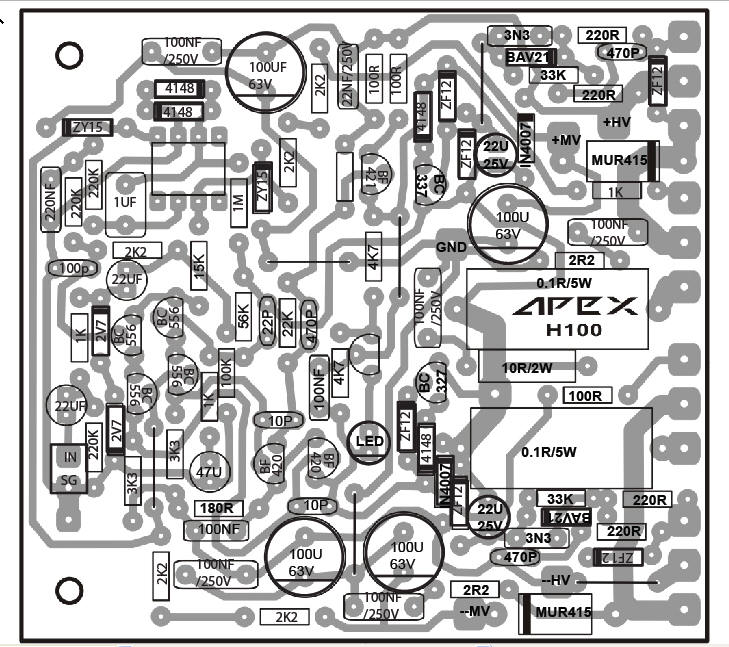

Pcb from post #53 ?

pls check this pcb for errors and mark the component value.
thank u.
This pcb is for MPSA42/92 instead BF420/421...

can u share the schematic of this pcb with component value.
what is the dc rail voltage for this class h amp?

DC rail voltage for this amp is 70-35-0-35-70

Hi Mile,
I finished the board but I using IRF640 and 9640,
also use BC639,BC640 to instead the BF420,421
I had measure the bias just 3.4mA and the LED also not lit,
I also measure the voltage between the LED just 1.2V,

Q1 and Q2 are BC556, and connect input gnd to psu gnd...

Hello sir. Can i ask anything? What is the rating watt for 2v7 zener diode? are 327 and 337 for bc327 and bc337? are 420 and 421 for bf420 and bf421? Thank you.

Yes, with 60-30-0-30-60v dc rail voltage.
