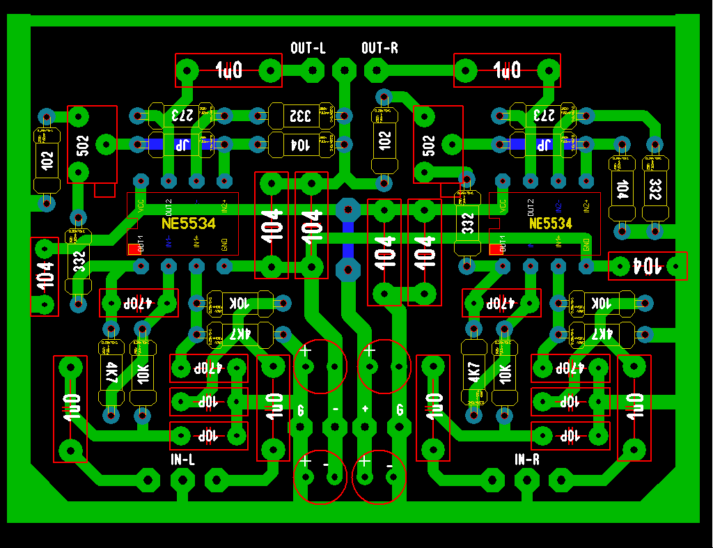

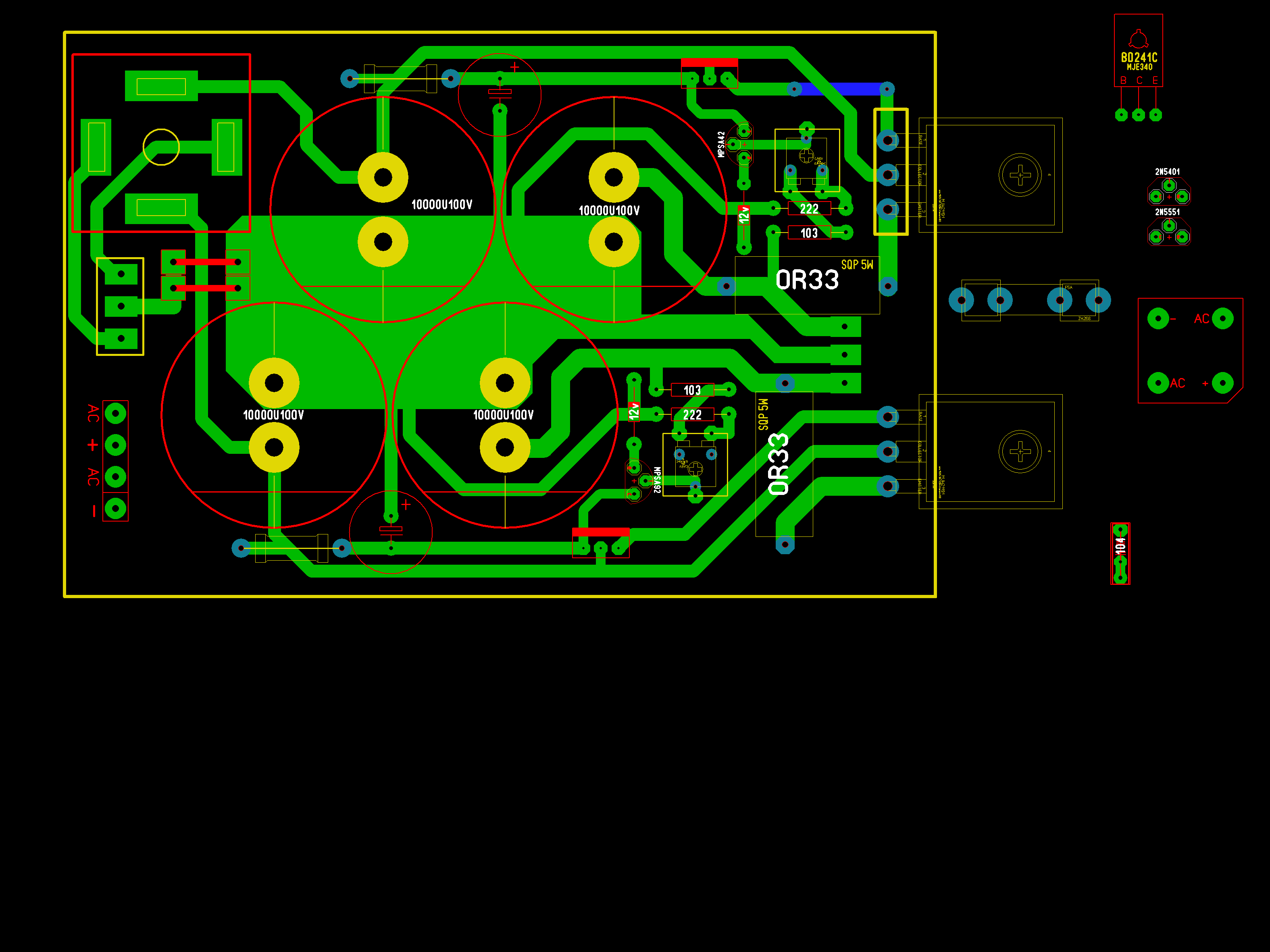

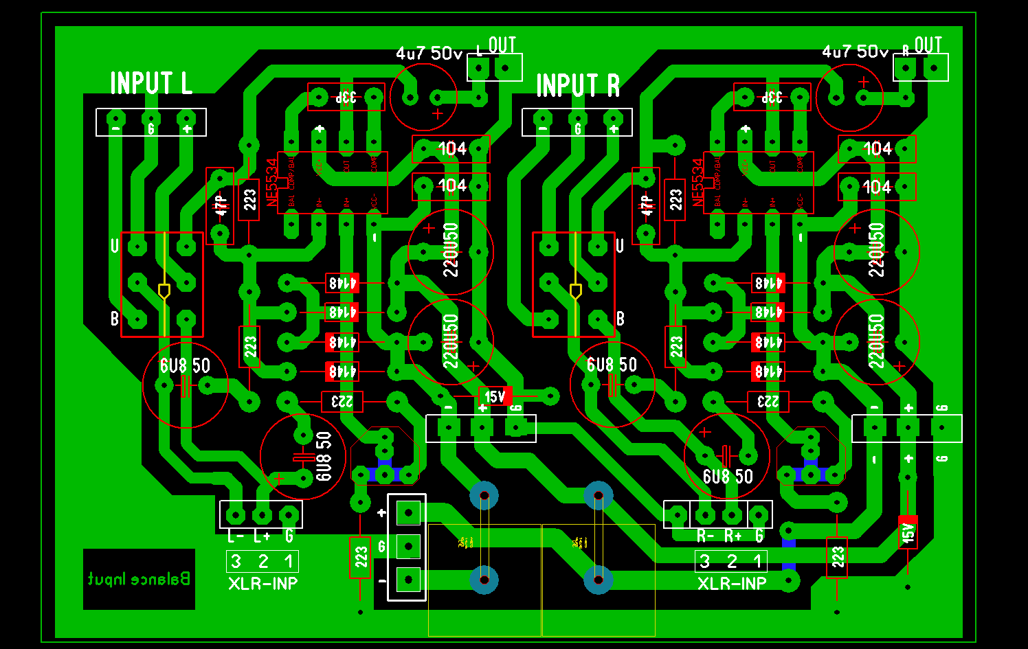

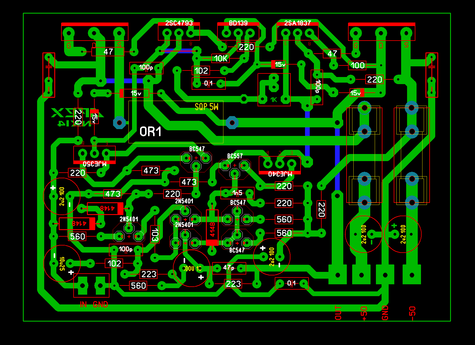

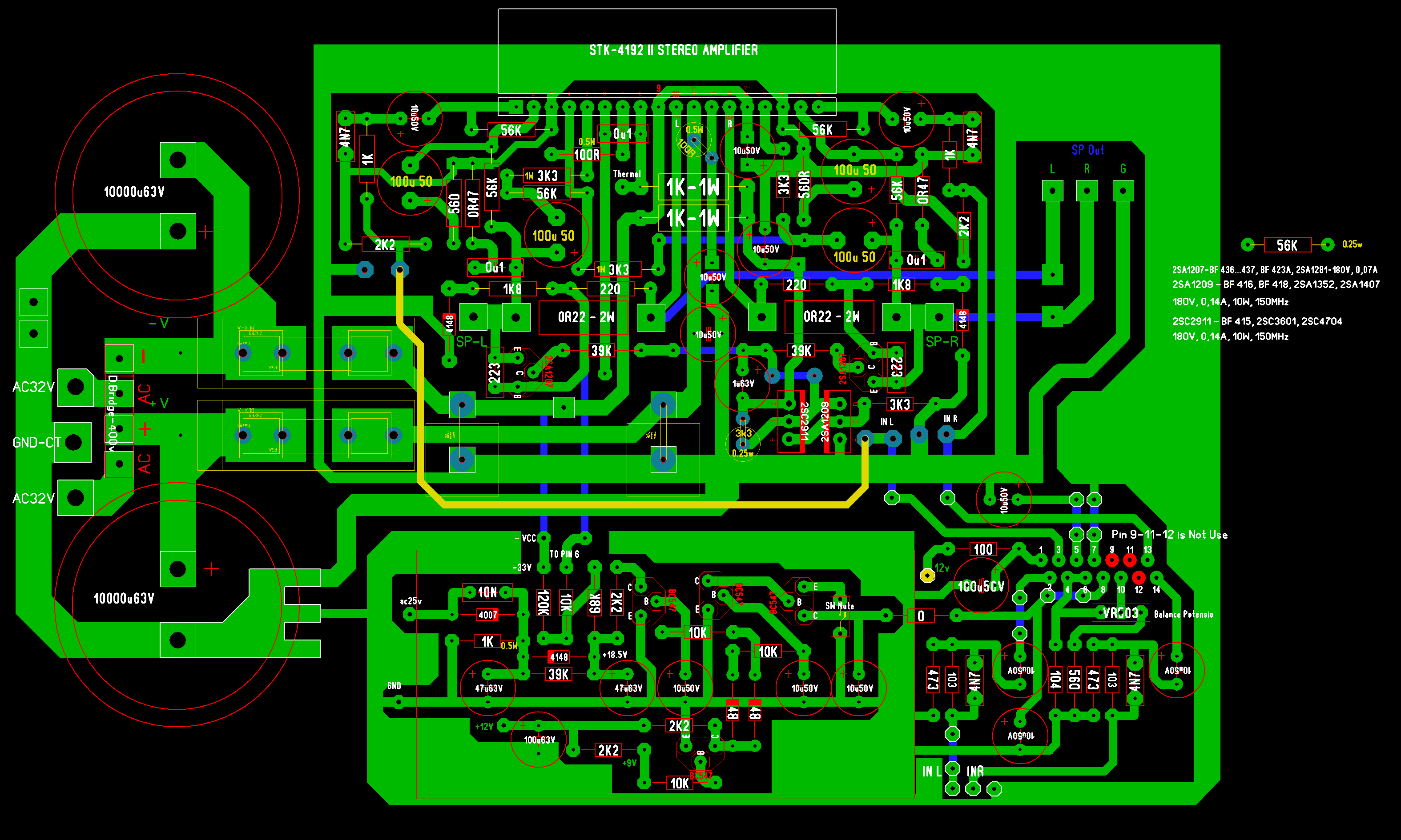

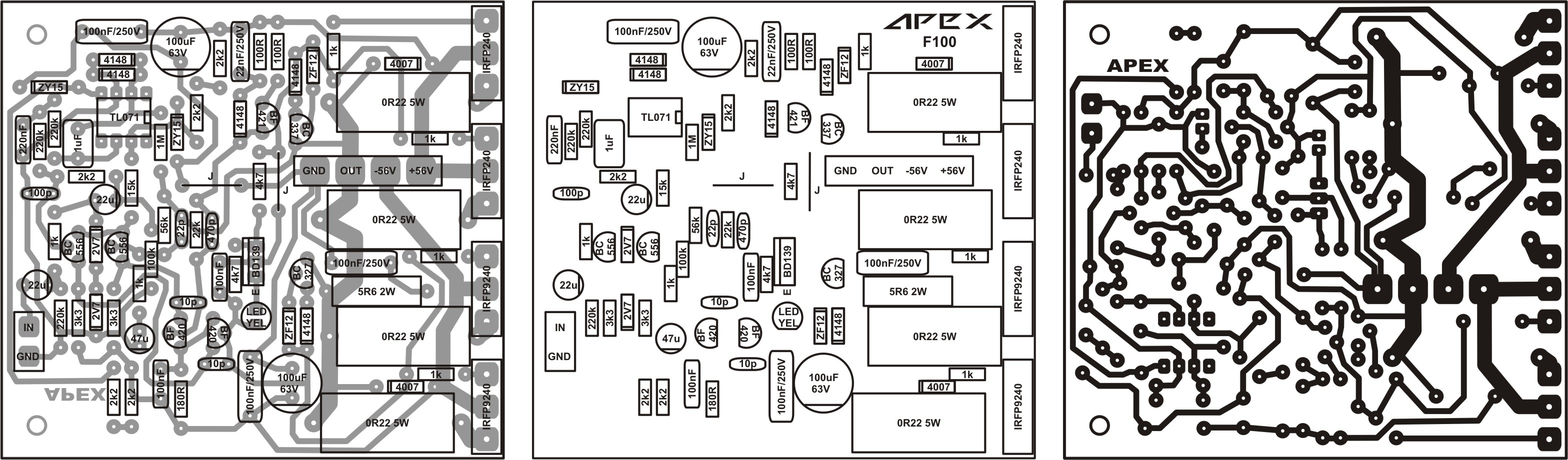

Old F100 schematic and pcb will be redesign.

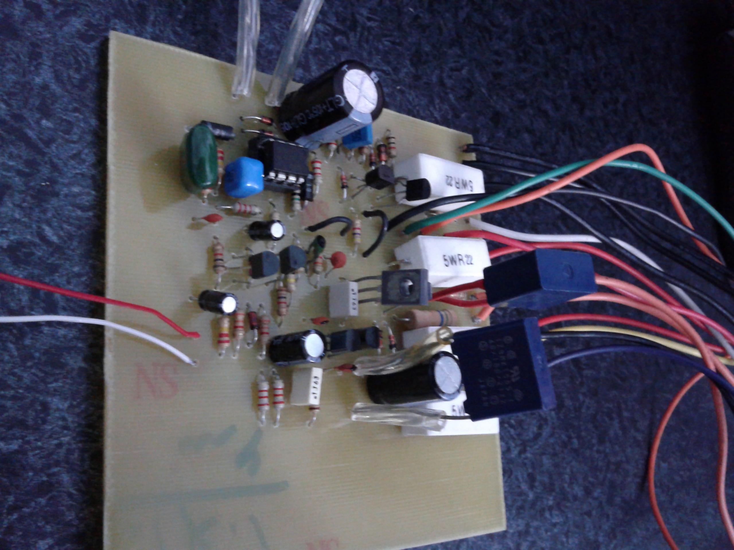

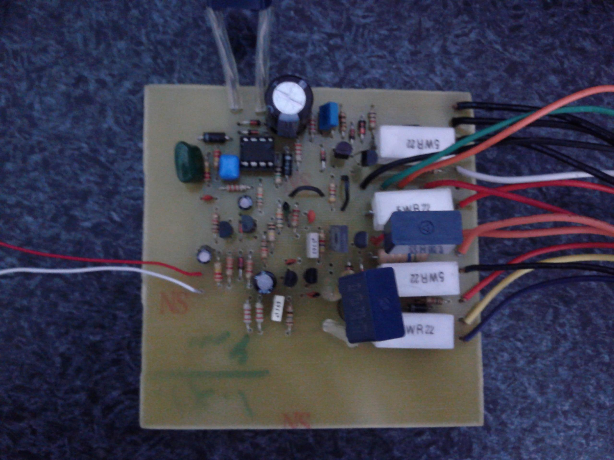

hello Apex
I am from Iran

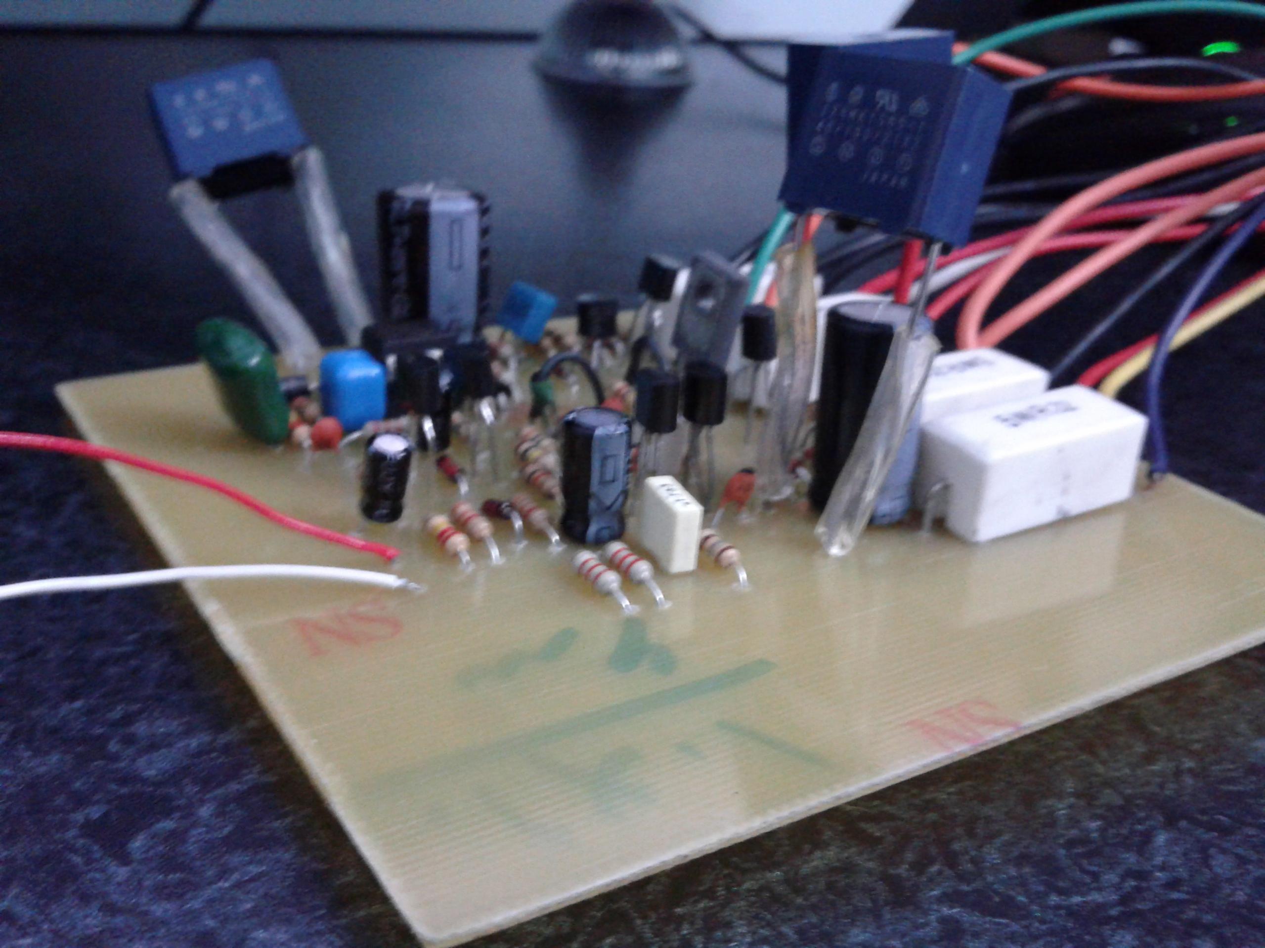

Circuit I've made you a quote.(post 122) But does not work.
PSU, but have not built the circuit.
All components installed correctly. The schematic with transistor bf420 and bf421 board printed on it is different.
In case the printed installation pieces on the board. Voice was a little boost. But with very high noise and high loudspeaker diaphragm and coil it will be hot and very hot IRFP9240 MOSFET. The power output is 17 volts.
But when the transistor base, I just installed the schematic loudspeaker diaphragm remains high and the output voltage is 45 volts
Znrhay diode circuit within a few volts and watts are they?
ZY2V7:?
ZY15:?
ZF12:?
CONNECT INPUT GND TO PSU GND...hello Apex

Dear friend, I realized. You mean is that instead of the PSU, gnd gnd input circuit connected to you?You must connect GND from transformer to input GDN signal. Understand?
How do I transistors and the base install according to the schematic or the photo on the PCB?
Thank you very much.This gnd wireing circuit from NX amp can be use for this amp.
How do I transistors installed? Like schematic or PCB?
This can help
HELP ME
PLZ........
Post better pictures both sides of pcb with psu and wireing. There is no yellow LED on your pcb, it's part of bias circuit not signal led...
Thanks, all. Especially apex.
The problem was the LED and transistor.

This old pcb with 5 pairs of outputs and protect can be redesign for FB400
