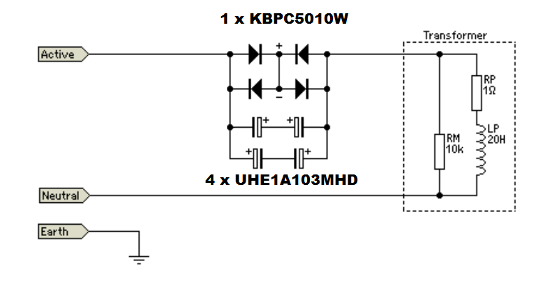

I am using four Digikey part# 493-1517-ND capacitors for my DC blocker. These are Nichicon UHE1A103MHD6 devices: 10,000 uF, 10V, 4.2 amperes ripple current, 14 milliohms ESR, 8000 hours lifetime @ 105C. I have also selected a 50 ampere, 1000 volt bridge rectifier with wire leads ("W" suffix) instead of fast-on spade connectors. I will bolt a small heatsink to the bridge rectifier to help it dump the (V x I) power it dissipates. I've annotated these part numbers onto Rod Elliott's schematic, below.
Maybe you can build an LTSPICE simulation of the incoming AC mains, the DC blocker, your power transformer, your rectifiers, your DC filter capacitors, and a load resistor that draws the maximum current your power supply will ever be called upon to provide. Then you could have LTSPICE plot the power dissipated in the DC blocker, and the voltage across the DC blocker capacitors. These might help you decide how much heatsinking you want (if any!) for the DC blocker bridge rectifier, and what voltage rating you want for the DC blocker capacitors.

The capacitors of a DC blocker pass the AC current.
The diodes are there to bypass the capacitors during overload.
The diodes should pass ZERO current during normal operation.
They will run COLD.

I have used 1n5402 diodes and they never get warm. They are always cold.
I think the aim of the diodes is for in-rush current capability, and possibly even a fault rating, such that the diodes should stay healthy no matter what the prospective current could get to from the AC mains supply.
Hence the recommendation to use the bigger bridges as a catch all, even for transformers with very low primary winding resistance and mains supplies with high fault current capability.

Cap voltage rating can be as low as 6.3 volts because each cap only sees 'two diode's worth' of voltage at most. That's only around a couple of volts even at very high current.

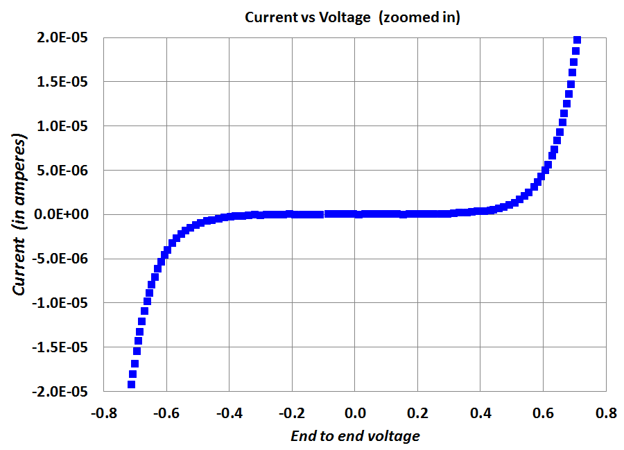

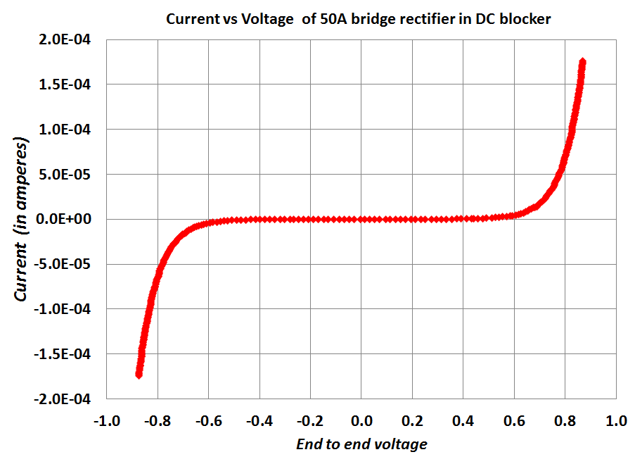

I connected the 50 ampere bridge rectifier as shown in post #151 and put it onto a curve tracer. It is pleasant to observe that for the level of mains DC offset mentioned as an example on Rod Elliott's website (275 mV), bridge current is zero microamperes, at least at room temperature. The four big ole bohunker diodes inside the bridge, seem to have negligible amounts of leakage at plus or minus 275 millivolts of bias.
