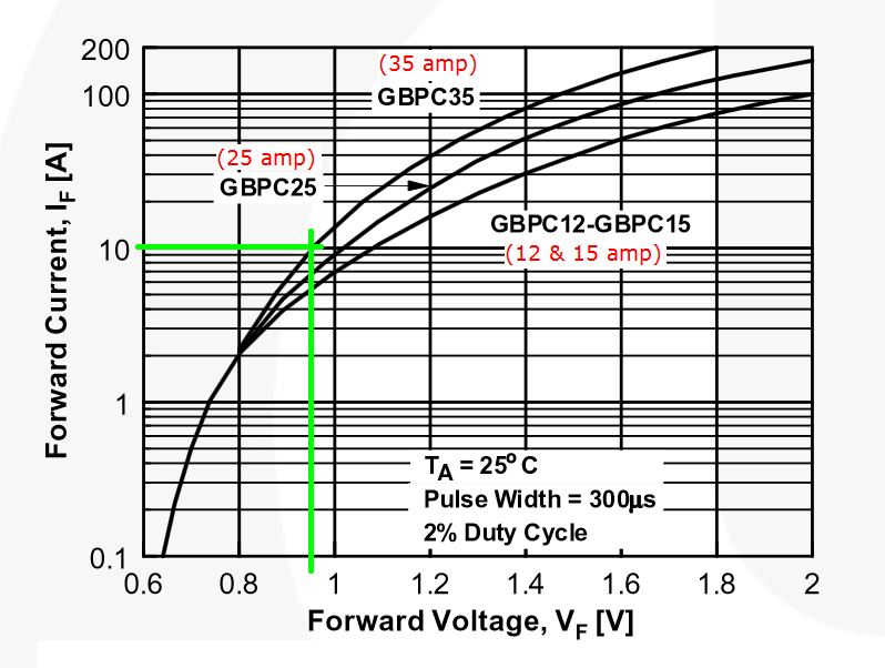

Notice that the schematic in post #123 has four silicon diodes in series; the max voltage from end-to-end is (4 x 0.95) = 3.8 volts. Electrolytic capacitors rated for "only" 6.3 volts, will work reliably in this application. Or you can choose capacitors with ANY voltage rating above 6V, basing your choice upon ripple current, size, and price. There's no special reason to use 63 volt capacitors.
0.95 volts is the forward voltage drop of a Fairchild 35A, 600V bridge rectifier, part number GBPC3506, with ten amperes flowing (in the transformer primary)

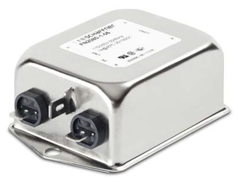

Post137 filter attenuates the mains interference.
You will still get interference that passes through and the cable from that first filter to your equipment enclosure will pick up more interference.
I would fit another "canned" mains filter at the enclosure cable entry.
Canned filter
Thanks for the info Andrew. If by "canned" you mean a brand name filter like Monster, I have one of these already.I use it for surge and filtering on my HT system. If some of the RF/EMI travels in thru the cables and this is joined by the noise from the transformer, would a CRC filter across the secondaries before the rectification take care of this. I am attempting to build as good as possible, a snubbered supply for a chip amp.
Thanks for the help,
Myles
Thanks for the info Andrew. If by "canned" you mean a brand name filter like Monster, I have one of these already.I use it for surge and filtering on my HT system. If some of the RF/EMI travels in thru the cables and this is joined by the noise from the transformer, would a CRC filter across the secondaries before the rectification take care of this. ...............
interference enters via EVERY cable that enters the enclosure.
If any of those cable are "exposed" inside the enclosure then they emit interference, especially if they are single cables/wires/traces rather than a flow and return pair.
You should trap interference at the cable entry.
That interference must be taken to the enclosure and thence by capacitance to "EARTH". It is this important route that requires the "canned" filter to be at the cable entry. This leaves no "exposed" cable before the filter and the can is bolted and/or electrically connected to enclosure to conduct the interference to EARTH.
