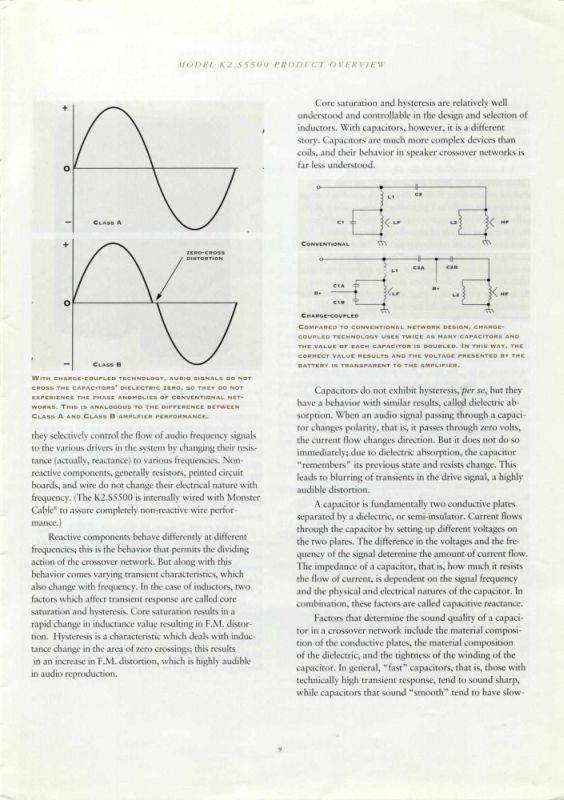

I was a little quick in saying the bias needs to be greater than the peak to peak swing. Actually all we can say is that the bias must be sufficiently high so that the force is always great enough to keep the plates against the bumps stops, if they exist. If the bias were just equal to the AC amplitude (1/2 the peak to peak) then the force goes from 0 to 4 times the no bias levels, as shown in my figure. Assuming the bias is + then we need to have Vmin = DC - AC amplitude is sufficiently large so that sufficient charge is maintained in the cap to keep the plates on the bump stops. I don't have any idea what this would be and it will likely be a function of the cap and its structure. But there is one thing for sure. If the dielectric were to behave as a linear spring I think a DC bias can only hurt. Aside from the fact that in such a case the variation in C would follow the force, which as I showed is highly asymmetric, even in the case of a symmetric force, if the spring is elastic then the change in dielectric thickness would be independent of the DC bias. We could write the spacing as d0 + d' where d' is the change in spacing. and d0 is the spacing for a given bias. Now since C is proportional to 1/(d0 + d') we see that as d0 gets smaller due to the application of a bias, then, since d' is constant while the capacitance is larger for a given bias since d0 is smaller) the change in capacitance is larger.
Now another point is that if the plates were against bump stops d would not vary at all so all distortion from forces changing d should go to zero. I.E., the application of a bias should driver the cap toward linear. If even order distortion is introduced the system is becoming more nonlinear because of asymmetries in the variation of d. So if even order distortion appears we can conclude that we have not pined the plates against the bump stops. Thus it become a question of what is the total distortion. and how does it behave as a function of bias. I don't think that, if dielectric thinning is the mechanism, a conclusion can be made that DC bias of any magnitude will decrease distortion. It may trade off odd order for even order but, and this may be a function of bias. I'll look at the paper and get back on this.
As for cap being transducers, that statement applies to cap, inductors, transistors, vacuum tubes, etc. put a resistor across a tube amp and power it up. With many tube amps I've owned it's easy to hear the tubes singing. Same with several transistor amps I've used. Were all familiar with transformer hum. The bottom line is that any time an AC signal is applied to a device we have oscillation charge which means oscillating forces which means mechanical vibrations. I guess all of these are potentially capable of generating distortion, no?
I took a brief look at the paper. I don't see anythign basically wrong with what he has done. I'd have to work through the details to be sure. He does assumes that the dielectric is a linear spring. However, he shows no evidence that a DC bias reduces distortion. That is just a stament made in the discussion section with no supporting evidence at all. This seems odd since all he would have had to do to show this is do some simulations with Vct including a Dc component. I certainly would not make such a statment without supporting data.

what is the ideal amount of positive biased curent
and why is there no diode to help prevent voltage being pushed back into the battery or using two diode with different resistors for different electron flow rates for each polarity to have a dampening effect and more precise electron flow in the other direction
"and why is there no diode to help prevent voltage"
Why would you need a diode?? You have a 2 meg path and a 8 ohm path. Where is the current going to flow?? You have a short and an open. You also have an RC time constant so the DC should be stable.
Rob 🙂
OK I had some time and worked up some code to solve for the variation in dielectric thickness for a give applied voltage using Menno's equation. I looked at the result below the cap resonance frequency. This is like looking at a driver in the compliance controlled region. Above resonance I don't think there is a problem because the cap plates will not be able to follow the applied signal.
Anyway, what I found, and it will be case dependent, is that w/o a DC bias the THD is all odd order just as I expected. When a DC bias is applied the results are strongly bias level dependent. If the DC bias is of the same amplitude as the applied AC signal then what I see is the introduction of even order distortion in addition to the odd order. There is very little reduction in the odd order distortion so basically the DC bias just adds even order harmonics. Example 3rd order when from .248% to .237%. If you plot the unbiased result and draw a line through the data points, when biased as noted the even order data falls pretty much on the same line.
If I increase the DC bias to the peak to peak voltage what I see is higher even order with very little reduction in odd order. 3rd goes form 0.248 to 0.203
Raising the DC Bias to twice the peak to peak AC level increases the even order further and there starts to be a reduction in 3rd order to 0.1%. But at this point 2nd order HD is up over 3%.
Now, I wouldn't place too much faith on the numbers but the trends are what is of interest. This really says that if the dielectric is a linear spring then this isn't a disortion reducing mechanism. In fact it is sort of a dynamic distortion generator. If the signal level is low compared to the bias (soft passage of music) then you might expect high even order HD on top of the odd order. As the passage gets louder the even order Hd will become lower in amplitude with odd order rising.
Frankly I don't think the analysis is sufficient. It should be pretty obvious that the dielectric can only be compressed so much. I think it needs to be considered as a nonlinear spring.
