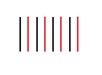

One other defect in the analysis- a capacitor is not two plates spaced by a dielectric. Not real caps, anyway. It's either a stack or a roll. So it seems that any of the forces considered here would cancel out except for the outermost layer.
no.SY said:a capacitor is not two plates spaced by a dielectric. ............It's either a stack or a roll. So it seems that any of the forces considered here would cancel out except for the outermost layer.
Alternate layers have opposite charge. Opposite charges attract.
All the layers will attract their adjacent neighbour.
The electrical attraction force/pressure is quite small.
Andrew, let the red plates in this diagram be charged positive, the black ones negative. Except for the outermost plates, the forces on each one cancel, right? The attraction to the opposite plate is exactly counterbalanced by symmetry.
And yes, the forces are small. As I mentioned several posts back, 3.5% is a very questionable assumption. Dielectrics are not soft rubber!
I don't think so.
take the middle pair of plates. They attract each other. They try to compress what separates them.
The next two plates are attracted to the middle pair and so on to the edge. The whole sandwich compresses due to the attractive forces.
I may be wrong. Correct me if necessary.
I wonder if you are confused with the net force on any individual plate. If a net force were left then the plate would fly off into space. We know it doesn't. The net force must be zero. That does not stop an attractive force across the separator.
I agree, that 3.5% assumption cannot be compression of a solid dielectric. If there is air between the plates them maybe 3.5% is reasonable, bringing us back to "how are capacitors made"?
I disagree. The net attractive force on any plate comprises the vector sum of the attractive forces between it and its neighbors. If you take the middle plate, the force between it and the neighboring plate on the left is exactly counterbalanced by the force between it and the neighbor on the right. So the net compressive force is zero. You can make the same argument on each of the neighboring plates until you get to the outside of the stack.
