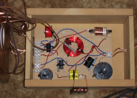

Hi Joe and any other crazy people who have added batteries to there crossovers or wonder if they should..........
To day i spent about 5 hours removing all the parts from my external crossovers to neaten them up and box them amongst other things.
So pets do not destroy them and my girlfriend does not pull strange faces at the spiders nest of crossover wiring on the lounge room floor.
any how the picture below is the result.
the four easy to see hi viz yellow caps which have DC bias present on them are 4.7uF metal poly 250V which replaced an expensive Solen tin foil (this brought a tear to my eye)
the two 9V batteries you can see at the bottom of the picture in series are in series with a 100k resistor (1W carbon) the input resistor for amp safety is 1k carbon (1W)
the battery snaps holding the two 9V batteries are easy to unclip to do A-B testing.
I did some listening after about of ambient tv noise to break in the caps this is probably unecessary but i dont know or care.
the caps without bias certainly did not sound bad the elsinores still sound excellent.
i tried the caps on a few tracks without bias listened intently to the treble which sounded very clean.
so i clipped the battery snap on and listened again...
was it better????????
unclipped the clip discharged the cap by shorting the clips
listened again - could the treble be slightly cleaner ?
clipped the cap on again... wound the volume on Metallica's "One" (sorry to my neighbors) there is plenty of cymbal crashing and guitars all happening at once.... no breakup...... tried foo fighters "let it die" no treble break up....... tried armin van buuren's album "Imagine" also good...
with bias it sounds to my ear that the treble is slightly better....
listened to a whole heap more stuff.
I dont really like A-B test after you do some work on your system, psycho acoustics play a role i think....
nevertheless. i think the treble sounds better with DC bias
the only way i can think to describe it is it sounds slightly more natural less harsh without any loss of volume. I would say slightly less distorted. it is hard to gauge with the treble already being so good with the elsinores... but at high volume i think the trebel does not break up as easily instruments dont seem muddled or anything like that.
any how i would encourage other people to have go and see what they think
-Dan

It makes the point I was going to make:
The benefits are more likely with inexpensive capacitors - I am current using Jantzen Red Superior caps as the single most important component in the Elsinore Project Speakers and no bias.
But if money is tight, here in Asutralia use the yellow 250V MP caps available from Jaycar - and you will get really good results for less expense.
The Jantzen caps are wound incredibly tight (they designed their own machine to get the right result they wanted) and thus mechanically stressed damped internally. Lesser capacitors don't have that benefit.
Cheers, Joe R.
