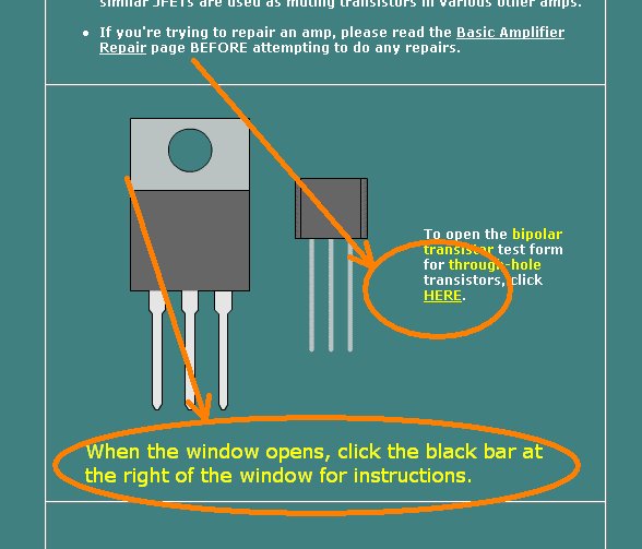

Perry the 2068 was shorted all pins , all output regulators ic voltage was 2+/- volts after removing this ic 2068 voltage on all ic went to 7-8 +/- volts . Now I have waveforms as should on ic's. Iam sorry about that ,what is the best way to mesure the output drive tranistors ?
The best way to check them is out of the circuit. If you're unsure of the readings you get, use the applet on this page.
Basic Amplifier Repair - Transistor Test Applet Link
