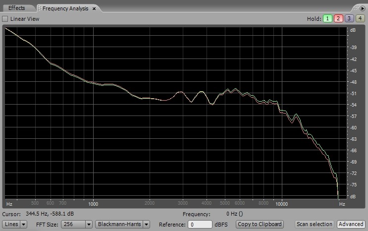

That's comforting, that you can hear a difference, I think I can but I think I was getting ear fatigue last night.The two versions sound quite different, with the first sounding muted and lacking detail, and second sounding more distorted and yet at the same time somewhat more bright and detailed. Both sound pretty bad, but in different ways.
lol, classic comment, thankyou for a good chuckle, I guess I would never know, eh! The amplifier sounds very nice into speakers!! To be honest I am not sure what I am listening to, I am puzzled by the obvious "distortion" because I am comparing 2 loaded amplifiers, the only difference is the cable, and puzzled by the way bass transients sort of sound "blatt". I do perceive some changes in the sibilant quality, I think, and that was the kind of thing I was expecting to find.Is that how your test system actually sounds into 8R resistors?
I don't, and I am less confident in the 6080 than the gain clone. This is a kind of quick and dirty shoot first, ask questions later experiment to see if I am anywhere remotely near the target with my "assumptions". Assumptions are, that the audible difference in sound of cables is caused significantly by an interaction between cable and amplifier, and that if you can hear something, you should be able to measure it, even though no one seems to have conclusively done it as of yet (to my knowledge). I know that my null has a frequency response problem, I need to try and address that first. It is quite likely the 6080 amplifiers are not working completely the same.IOW, how do you know the amplifiers are identical, and or everything else is doing what you expect it to?

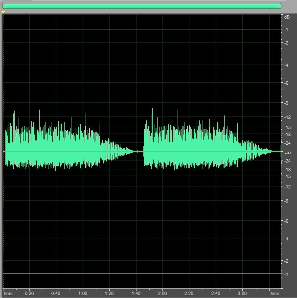

Here is a visualisation of the samples with the first one showing more highs starting again at 2.5kHz.The clip below is Dada Puzzle track 6 starting 3 minutes in. It is a null (of sorts) between a very short wire and a low capacitance (first) and a high capacitance (second) using a 6080 SE amp and 8 ohm wire wound resistors.
The waveforms are also rather assymetrical. No idea if it's the clip or the setup that is responsible.
Hugo
Thanks, It would be very easy to suggest that could be caused by the lower capacitance loading the non zero output impedance of the tube amp less. But I won't say that out loud.Here is a visualisation of the samples with the first one showing more highs starting again at 2.5kHz.
It would be quite tempting to say we are looking at all that lovely euphonic even order distortion of an SE tube amp, but I didn't say that either, because it is to simpler explanation.The waveforms are also rather asymmetrical. No idea if it's the clip or the setup that is responsible.
It would be nice to compare with the original recording.
It would give you an idea of what your setup is doing with it.
Can you post that snippet?
Hugo
Hugo
