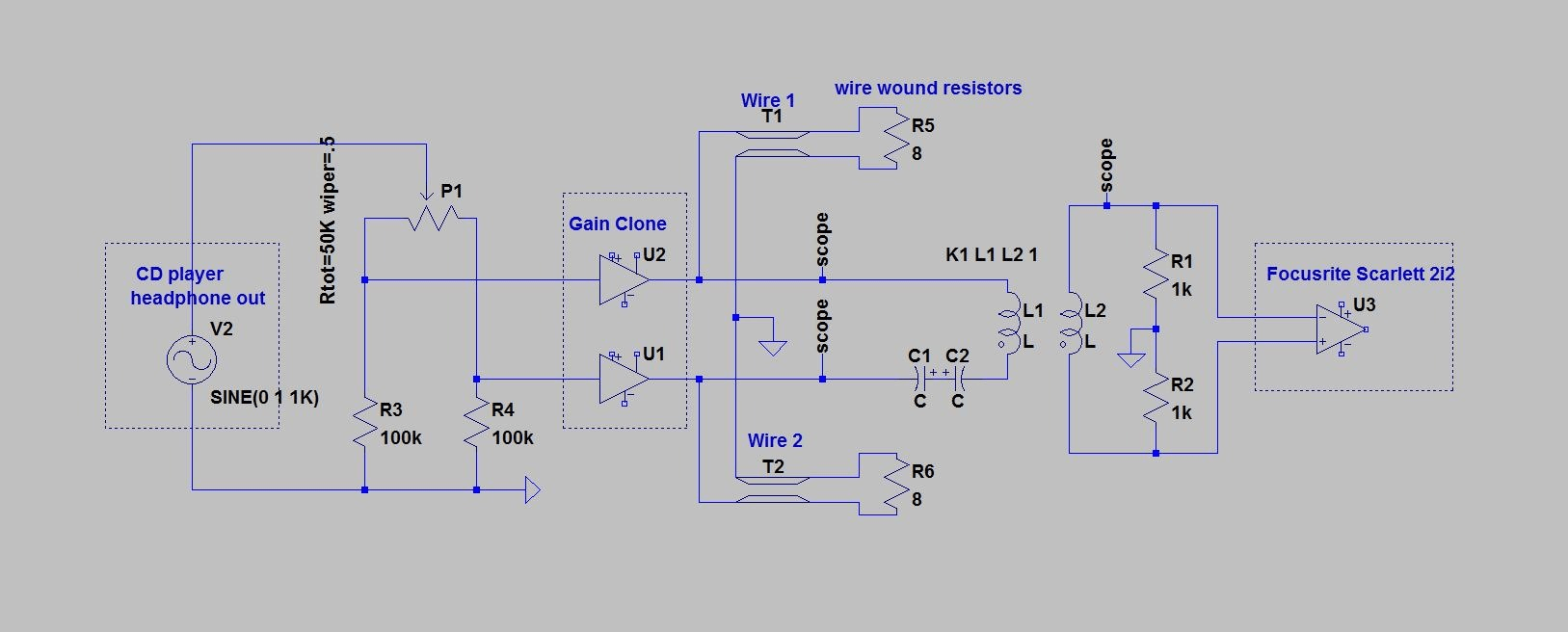

For the apparatus in the diagram below, how did you test can calibrate the apparatus itself?
IOW, how do you know the amplifiers are identical, and or everything else is doing what you expect it to?

As per circuit above I am attempting to feed an identical signals into two identical power amplifiers. I am then attempting to look for any difference between the two amplifier outputs, using a floating transformer coupled in to the "balanced" input of 2i2, from which I can monitor the null on headphones (and record into PC).@hbc : It's still not clear to me what you were testing with both music samples? Interconnects, speaker cables, or..?

Initially using dissimilar speaker cables into identical resistive loads, I was hoping to hear a difference between cables but was inconclusive. Upon unplugging one cable and load (the low output z maintains the null), what I think I am hearing is the difference between a loaded and unloaded amplifier output. Which is an interesting result in itself, and on the mp3 first is the difference between a loaded channel with wire and an unloaded channel with no wire, and the other sample is the difference between two unloaded amplifiers. Hope that helps.
I did start using speakers but they were too noisy and I couldn't hear the nulled signal in the headphones.
I am going to do some sanity checks i.e. distortion measurements now to try an establish if what I think is happening is.

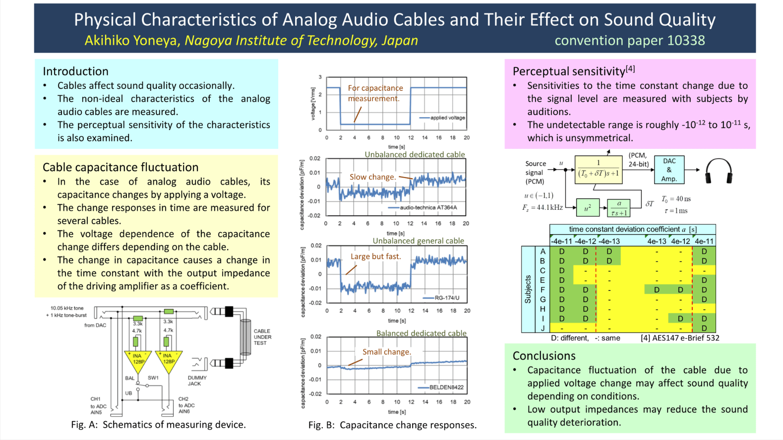

Interesting info with the square wave test showing modulation of capacity. I guess that with "Balanced" the author means differential, and what about the step size, equal but in opposite direction, or halve the step size on each side.The idea of using an FFT analyzer to measure anything should be considered carefully for pros and cons. Against the proposition is the warning given by Lars Risbo and Bruno Putzeys in their blog at Purifi:

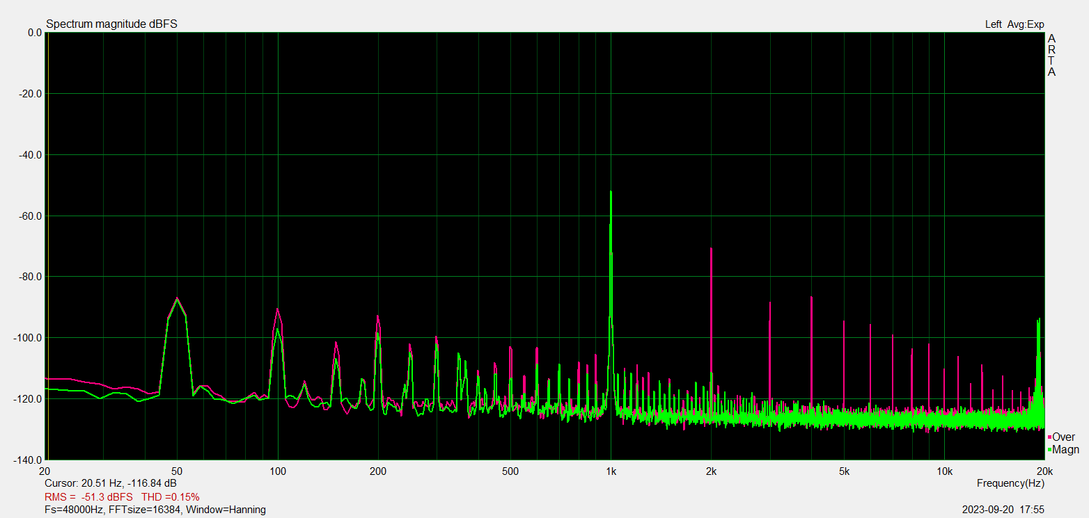

This is the FFT of the null with both channels of the amplifier unloaded at 1kHz, green, and with one channel loaded, pink. Full un-nulled output is a tad below the 0dB for reference. So this I what I could have been hearing in the two sample earlier. I have a better null now. very educational.
First provisional conclusion. My amp is more distorted under load, and I may be able to hear it.
I am not accustomed to listening to distortion of this magnitude, so my brain has some adjusting to do. I am starting to feel the floating differential probe is a handy tool and needs to be boxed and tweaked.
One vital thing to keep in mind: a cable is basically a linear system and as such cannot produce THD.
So when you see THD or IMD it has with a high probability to be the amp sourcing the cable.
But the cable like any linear system may affect overall frequency response and phase thereby causing perceivable differences.

That's why I'm rather suspicious about the Yonega paper showing fluctuating capacitances, because nothing is mentioned about proper termination.
The Capacitance Change images are giving the strong impression that reflections are taking their fair share in the waveforms.
The second reason to be hesitant is pure academic: A test that hasn't been reproduced by an independent instance, has to be regarded with care.
The third reason is that when capacity changes of 0.02pF/meter take place, the effect with a relative low ohmic source will have it's effect in the Mhz region, far outside any reasonable audio range.
