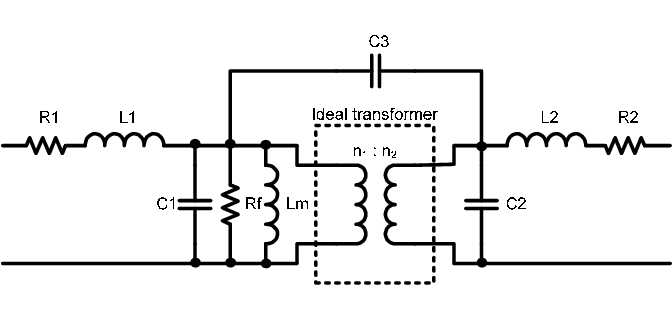

Also, instead of using two transformers, you might try one transformer with an electrostatic shield between the primary and secondary windings. Often its capacitive coupling between the two windings that is the problem. A shield can reduce the coupling substantially.
In the transformer model below, C3 is the capacitance that may be reduced with a shield:

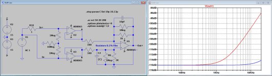

Sorry to say, but this sort of CMRR is not impressive. With balanced connections and a buffered instrumentation amp figures between 100 and 120dB in the audio band are easily achievable.I am not sure what this really means (55-60dB CMRR?), but I now have pretty even looking CMRR from my transformer, by using 2 in series, to significantly reduce the stray capacitance. Yellow trace is it doing its transformer thing with unbalanced signal between inputs, green trace is 2 inputs shorted together and unbalanced signal connected between shorted inputs and ground. I have also now got a buffered multi turn null pot.... Seems to work ok.
Hans

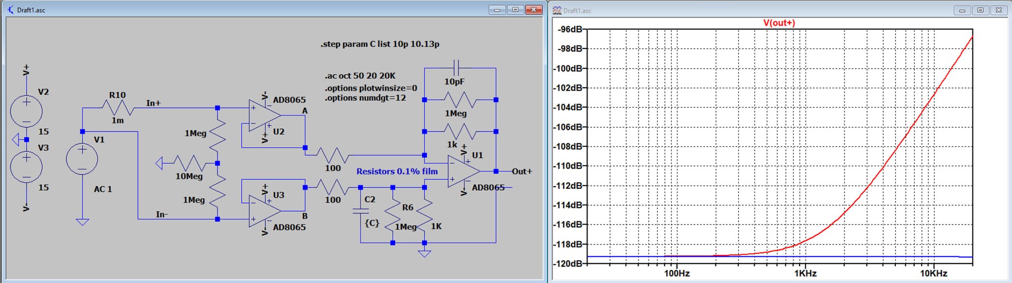

To give you some confidence in what I mentioned in the previous posting, I have made a simulation with low noise Fet opamps.
Since you have to measure CMRR with two different cables, the receiver should have a high impedance to prevent reducing the CMRR because of differing cable impedances.
First image shows that tuning R6 (not needed here) and C2 from 10pF in Red to 10.13pF in Blue makes the CMRR flat over the band to 20Khz close to 120dB,
C2, should be a 7.5pF cap in series with a 5pF trimmer, here adjusted to 10.13pF to flatten CMRR at 20Khz.
R6 should be a 953K resistor in series with a 100K ten turn trimmer to reduce CMRR at 100Hz.

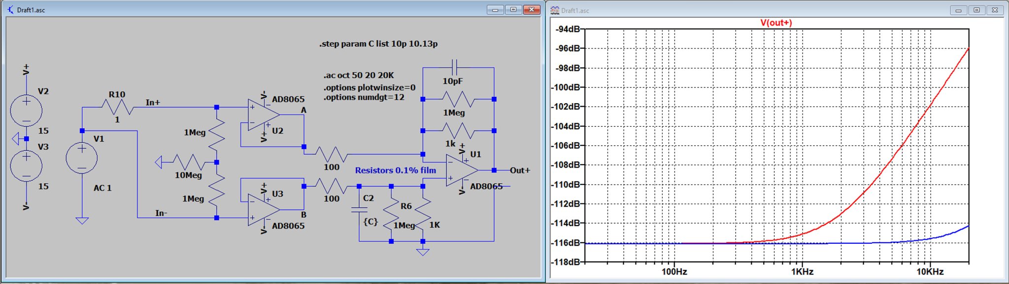

The second image shows the negative effect on CMRR when one cable has 1R more resistance as the other one.

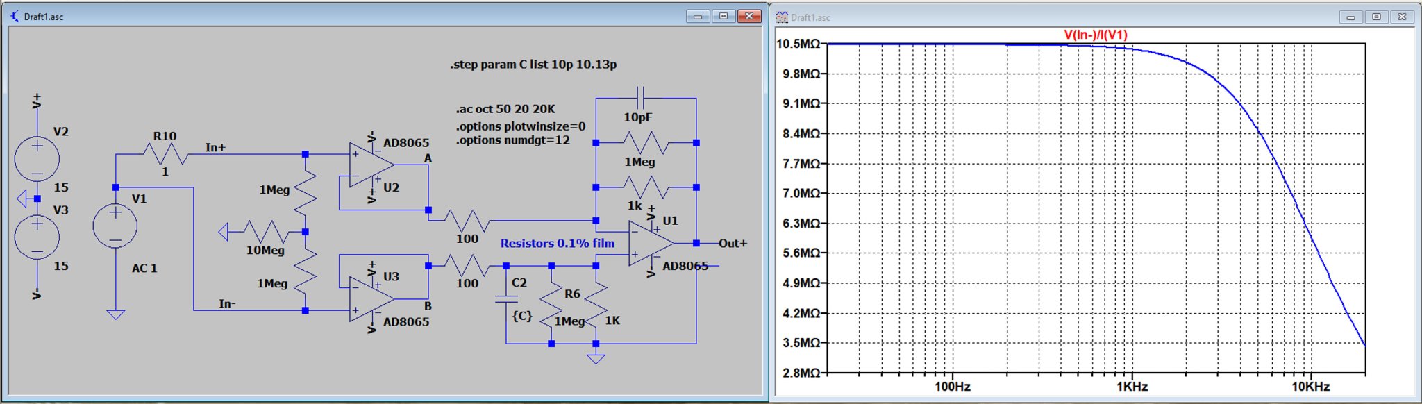

Third image shows the input impedance of the proposed circuit diagram.

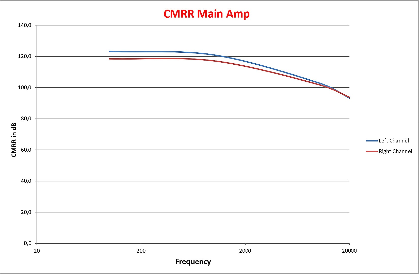

Fourth image shows the measured CMRR of my balanced main amp, modelled in the same topology, just to prove that the simulation doesn't produce nonsense.
Hans

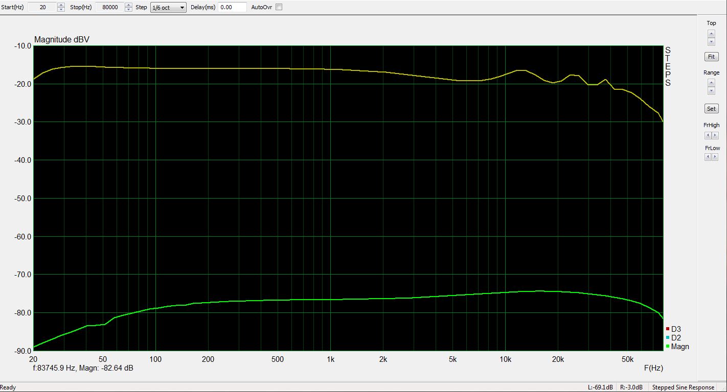

Yes, it is satisfyingly flat though, but this in itself is a problem. That flatness is noise (hum predominantly). It could be better, but it is now good enough to hear the distortion of the amplifier and also to hear it change as the amplifier heats up... It wasn't particularly what I was looking for, but very interesting.Sorry to say, but this sort of CMRR is not impressive. With balanced connections and a buffered instrumentation amp figures between 100 and 120dB in the audio band are easily achievable.
That's is quite impressive. My intellectual problem is that I am hanging my transformer across the speaker terminals of power amplifier and I worry about running out of voltage head room. The totally floating gives me comfort in that area. The opamp approach I may look into If I choose to investigate lower level signals or voltage dropped across wires.Fourth image shows the measured CMRR of my balanced main amp, modelled in the same topology, just to prove that the simulation doesn't produce nonsense.

The green trace below is pleasingly flat, but it shouldn't be. I did simulate the two transformers, but unfortunately do not seem to have saved it. What it showed was around -70-80 dB at 20 kHz, but falling off to below -100 dBs as the frequency falls. I suspect this is happening, but is masked by hum on the graph below, green trace.Hi Damon,

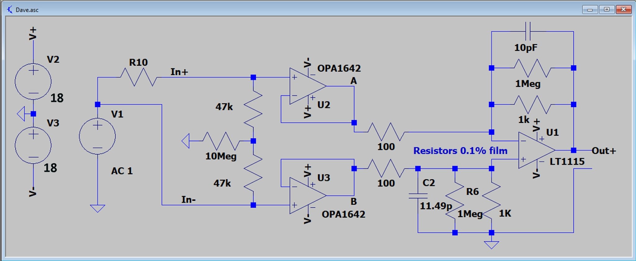

Would temporarily lowering the gainclone’s supply to +/-18Volt then be an idea ?
You lose a bit but gain a lot 😊
