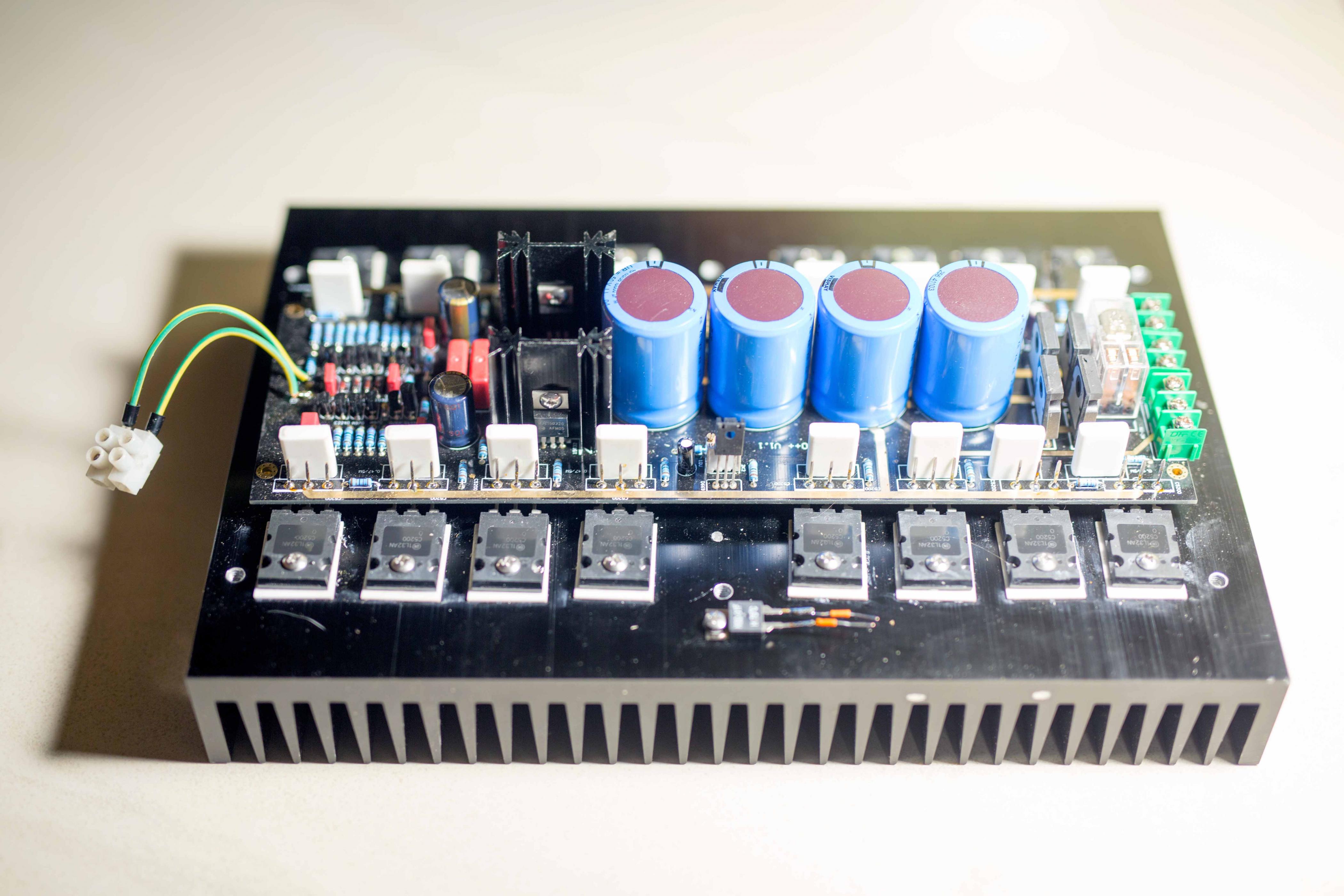

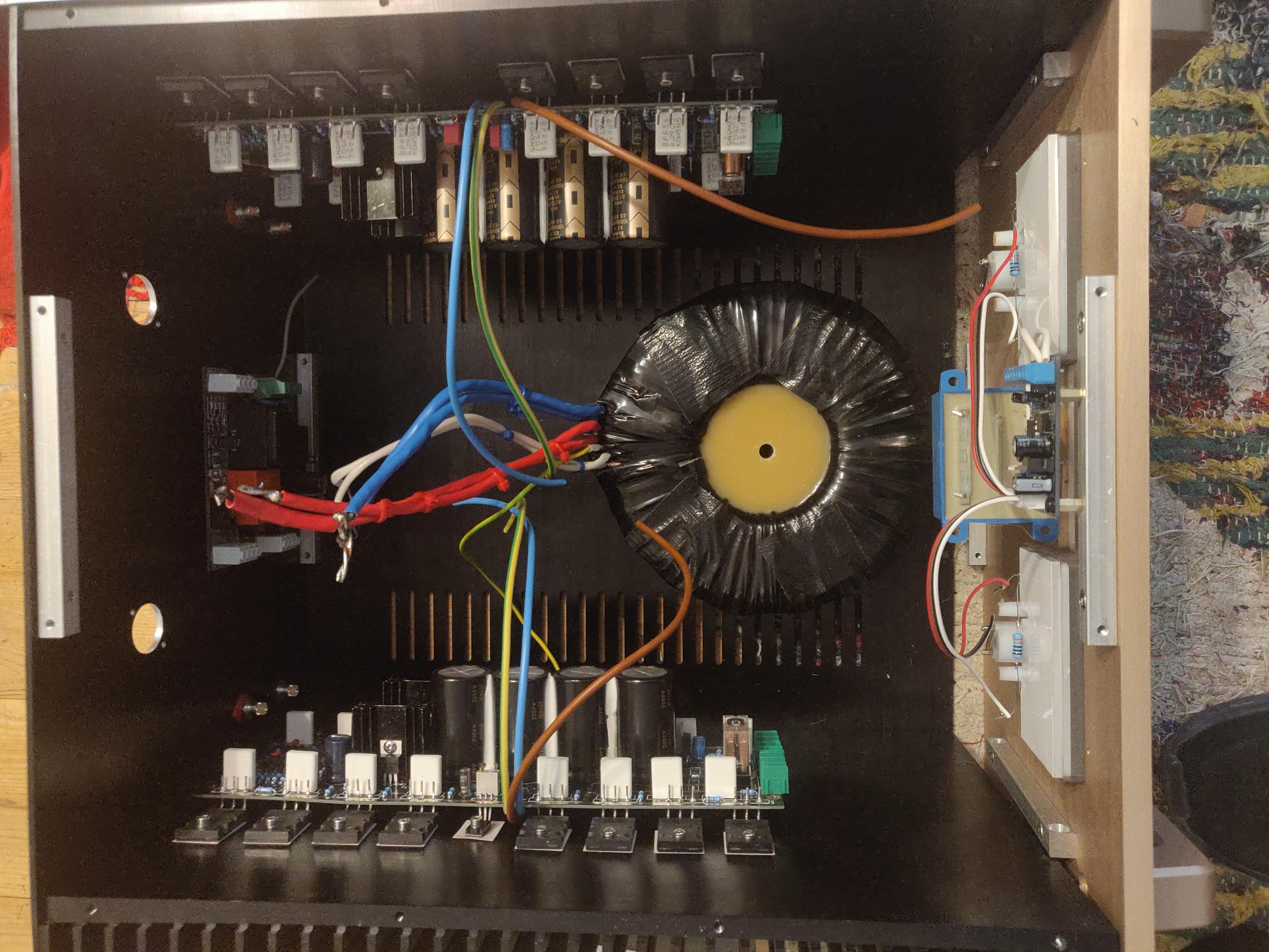

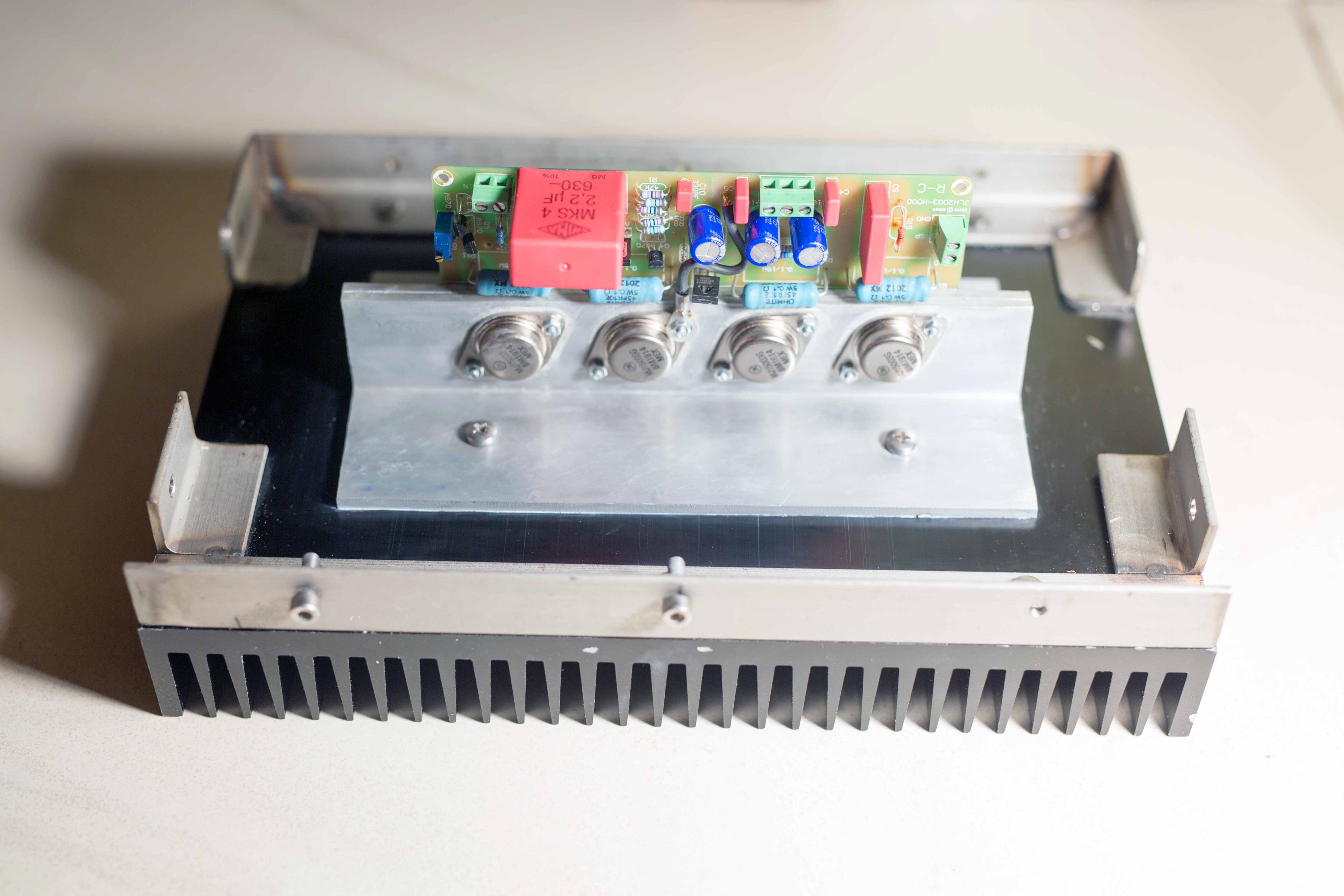

Just to illustrate what I have done. I have made several re-builds of my initial NHB-108 and every time there were a dozen of new threads. Meanwhile I had a board on aluminium plate fixed on the heat sink. Then I said: "Enough now, you never surrender and what is this? You do it properly or abandon!"
I have used some pieces of aluminium to develop skills. Then, I got back to the bemch and fixed the transistors directly on board, with alumina pads and sufficient amount of thermal paste. Now, the temperature is under control.

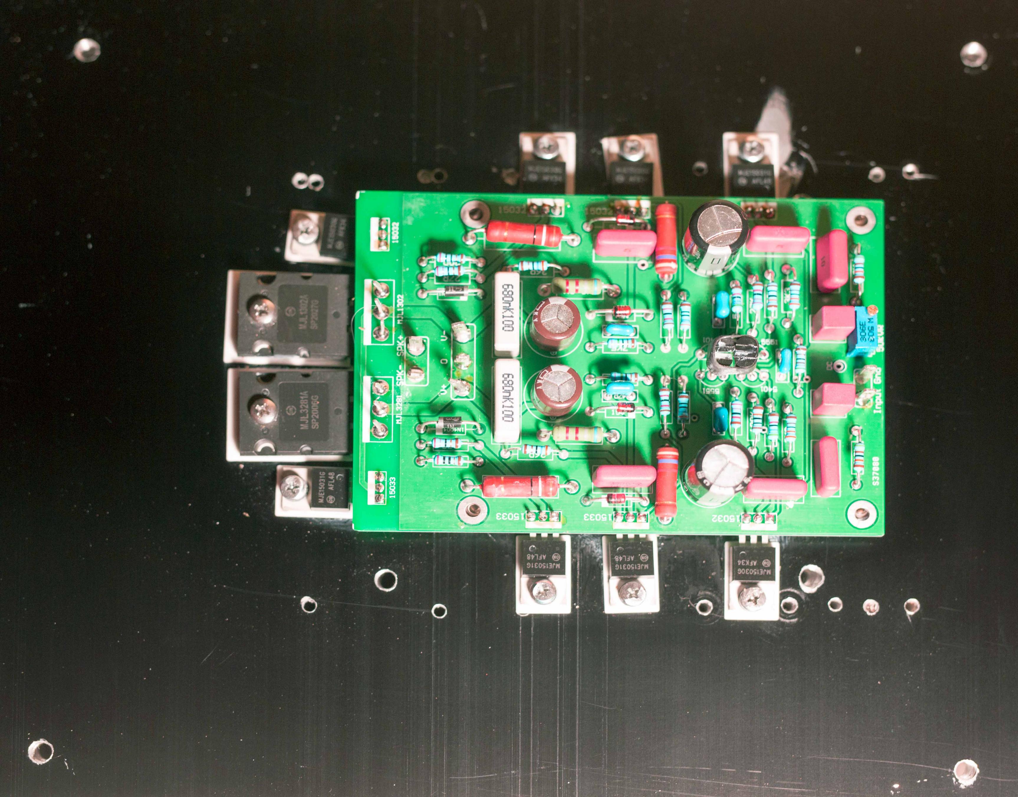

Below are two other boards,
Accuphase A60+ clone and
JLH 2005.
I have enjoyed the work with these projects.

Beautiful assembly. But you better avoid screws and use studs with threadlocker, insulator (when needed), washer, lock washer, nut (never self-locking nuts). In this way the threaded hole on the aluminum will not strip.
2. and even more importantly: LUBRICATE while making threads, profusely. I use WD40 or MIG welding liquid.
Alcohol works very well (I would say better than WD40) for aluminium. Not the alcohol you drink, it should be pure alcohol.
Thanks Marigno,Beautiful assembly. But you better avoid screws and use studs with threadlocker, insulator (when needed), washer, lock washer, nut (never self-locking nuts). In this way the threaded hole on the aluminum will not strip.
A wonderful idea, again from you. Perfect. This method provides safety for otherwise vulnerable aluminium threads.

Nice work Berlusconi!
